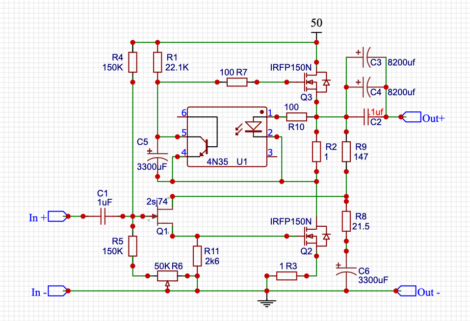

f8ish circuit with mosfet.
Having never strayed more than a few ohms away from schematics I've found on this site, I am quite proud of my effort here and wanted to share and ask a couple questions. I saw the simplified schematic of the F8 and got a wild hair. I was shooting for something that makes recognizable sound and ended up with something that blows my mind. It even does complex music well. And the louder I play it, the better it sounds. Could be I've never heard this much distortion and I love it 😛 The wife thinks it might sound better than my diy F5. Of course I think it sounds better than anything I've ever heard.
There are a couple things I haven't been able to fix and one bigger issue with the sound i'd like to get a handle on. Anything less than 1 ohm on the bottom fet and the bias starts running away. I know the drain resistor and network on divider on the gate of the jfet are out of whack, but this is where it sounds the best. Not sure if there is some other way I can tame the bottom fet.
Spice tells me the bottom fet should be pushing more watts than the top as I have it built, but its the top one's heatsink that gets really warm. Is that because the power from the bottom is being dissipated as sound and through the speaker?
There also seems to be a whole lot of bass. Could be what is called "bloom" or "bloat". . too much maybe? Not enough drive from the jfet, too much capacitance on the 150 mosfets? I have tried an entire range of feedback adjusting both resistors thinking maybe lower out impedence could help, but it doesn't sound as good and doesn't really help with the bass.
Anyway . . So So So Happy. Thanks Mr. Pass and everyone. DIYing my own has always been one of those pipedreams.
R6 shouldn't be there on the schematic. R5 is 183k to ground.

Try IRFP240 and bias it for 1.5A.
Make sure you are using either mica and goop or Keratherm pads, and you have the mosfets mounted tight with spring washers.
That should certainly make it thermally more stable as a first step.
You should be able to lower the resistance at that point.
Thinking R11 should maybe be smaller, maybe around 1k.
You don't have a gate stopper on Q2.

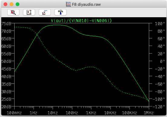

When I adjust lower OLG of about 50dB in Spice I get no more 0.012% but 0.12% distortion.
So it stays Nelson secret how he managed to get around 0.012% with the mentioned 10dB lower OLG than the J2.
I still try to solve this riddle....
Q3 is hotter than Q2: What is the voltage at the source pin of Q3?
Yes, the IRFP150s have a much higher input capacitance than the SemiSouths, which would explain some of the issue.
The power supply is 50.2. Source of Q3 is 27. Drain of Q2 is 25.8.
I'm a little limited in my stock of avail mosfets without pulling from already built. I'll order some. I have some IRFP044s. I'll try to see if there is a difference.

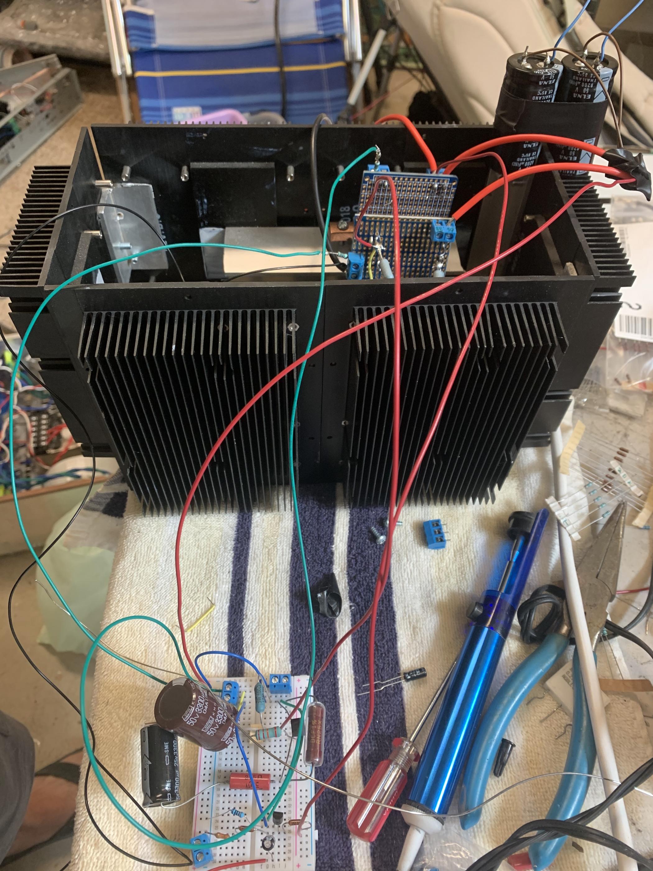

They're held down firmly with a crossbar over them on Aluminum Oxide with goop. It has worked for me so far and I value the re-usability. I have some mica somewhere in a drawer I can try.
R11 I found by listening. I have sat for several hours with a screwdriver on a pot starting at 150 and at least 3 times I've measured it has ended up about 2600.
Gatestopper ended up being bypassed because of a soldering error 😎
