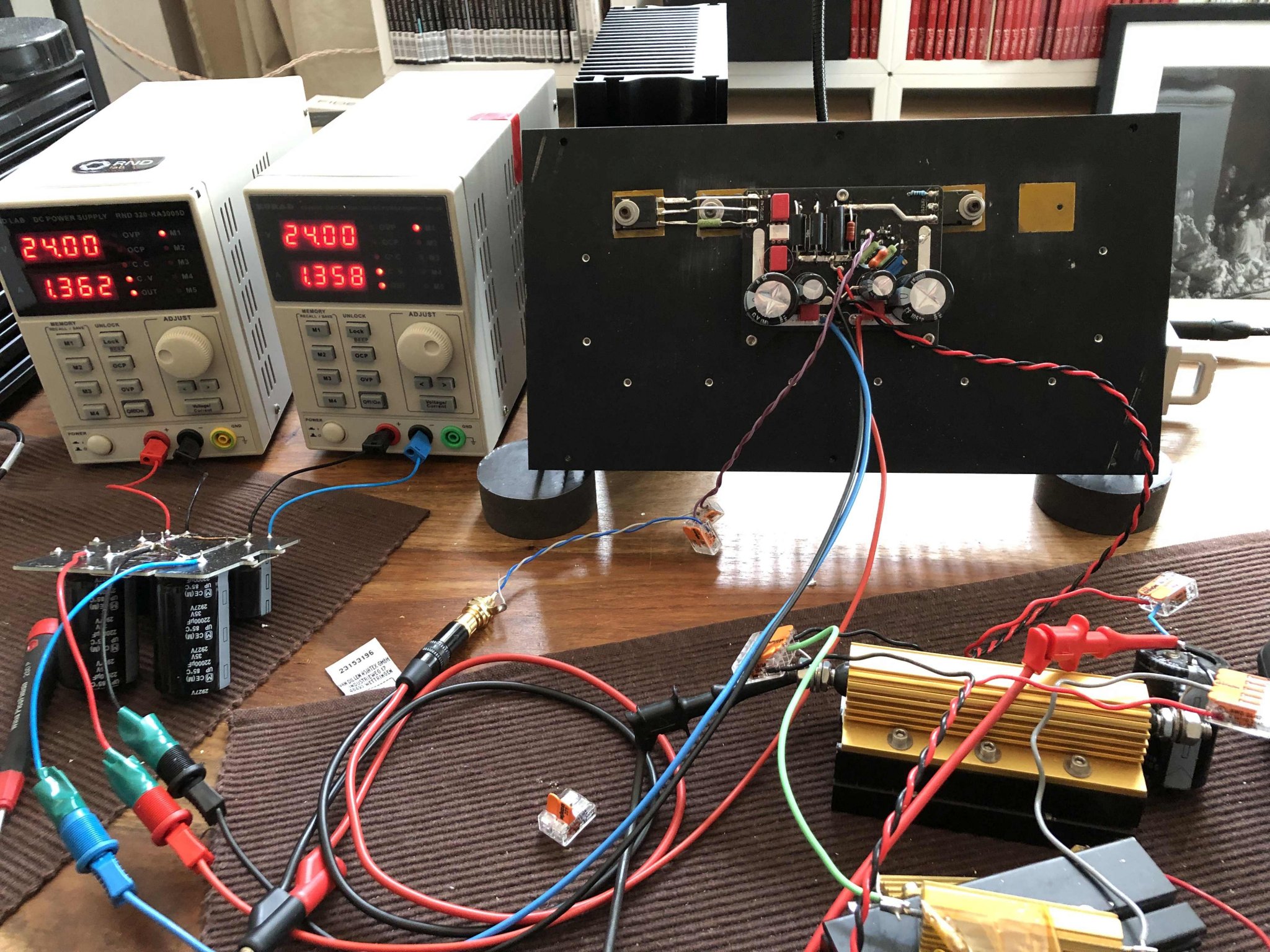

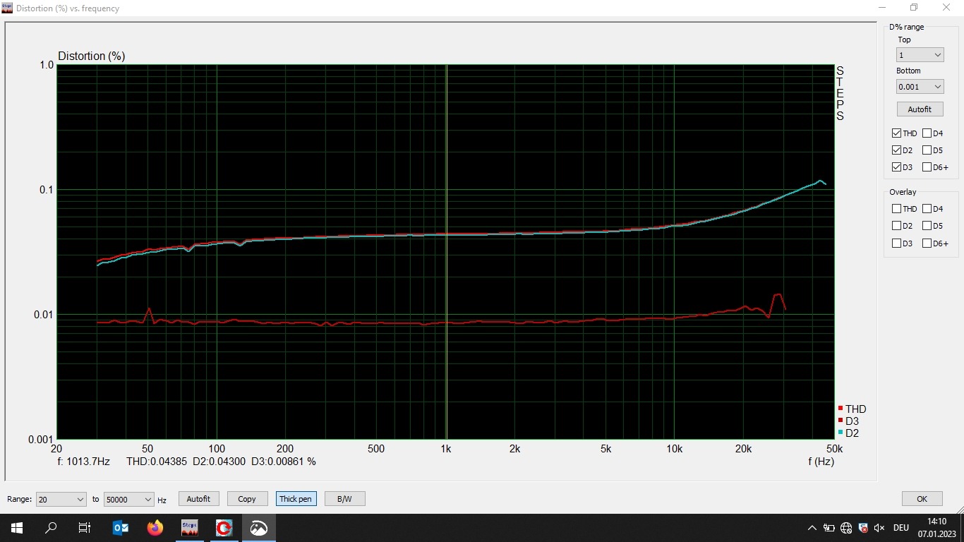

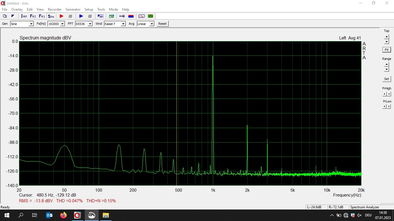

Based on Patrick's DC-coupled F8-style idea I decided to give it a try. I swapped the polarities to use SK170 instead of SJ74 and went for a latereral instead of the semisouth.
The amp is quite stable with cheap benchtop supplies:
10sec after start +27mV offset
1 minute +22,8
5 minutes +15,1
1 hour -12,7
Bias (~1.36A) changes max. 10mA after a hour (with respect to bias after 20sec). Gain is about 4.
My findings so far:
With 2SJ162/2x9240mCCS, 330R/91R NFB and 10,4mA 2SK170, 250m/687m Follower-R at 1% THD I get about 18W at 6R (10,4V) and 10R (13,5V) out of the amp (in each case visual clipping point). A later measurement confirms this points with ~ 1% THD.

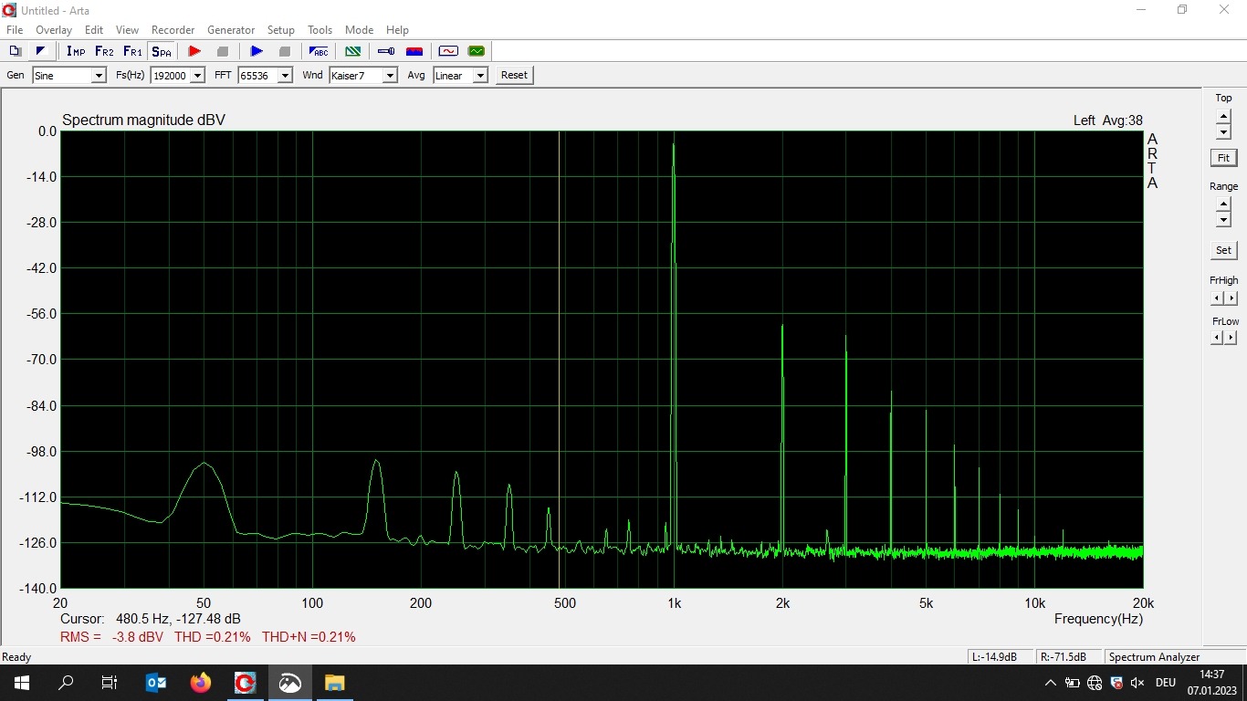

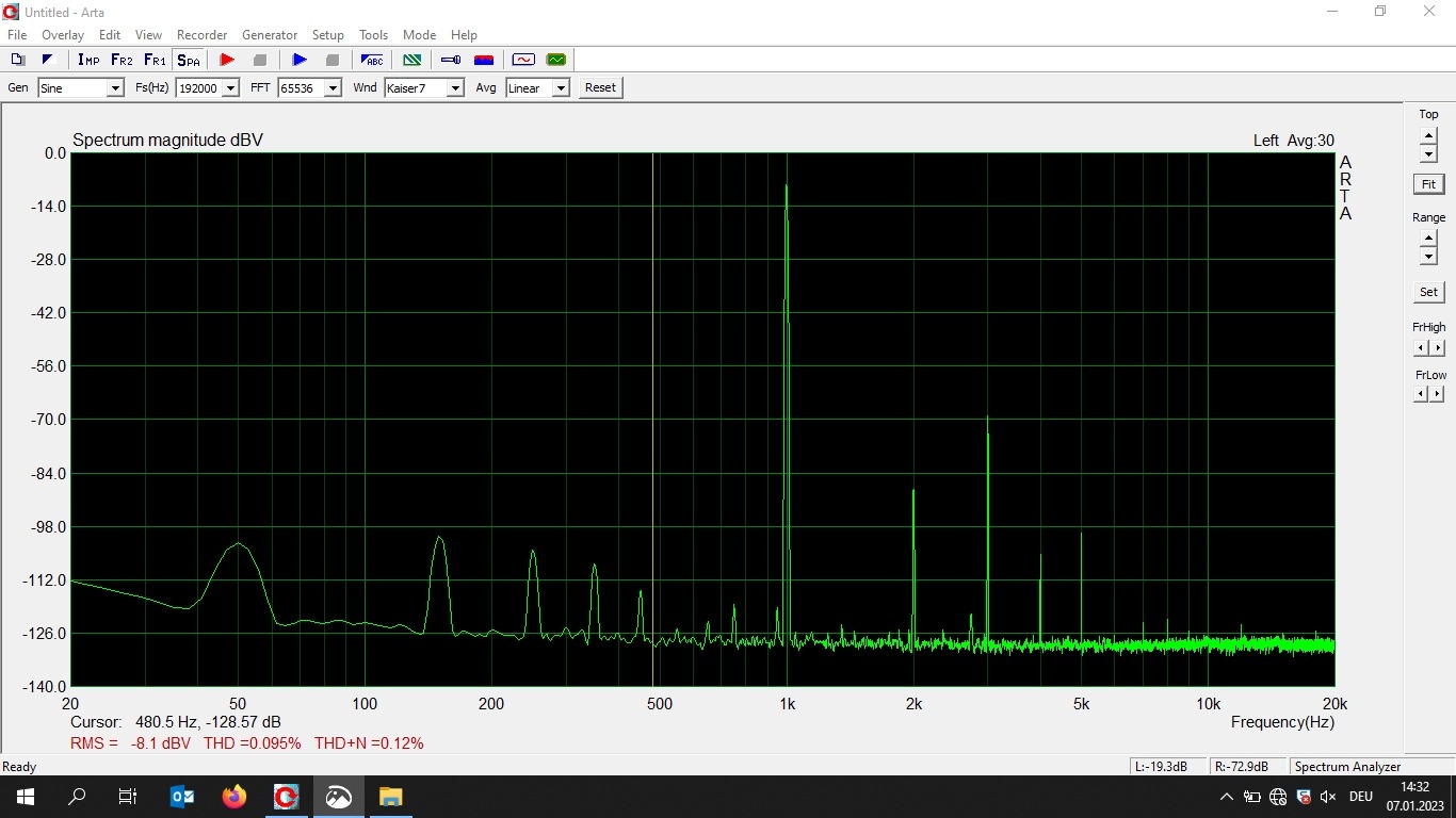

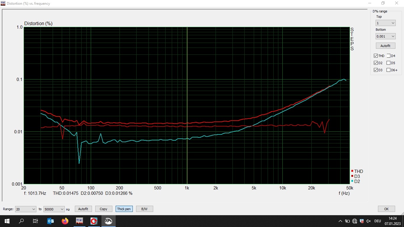

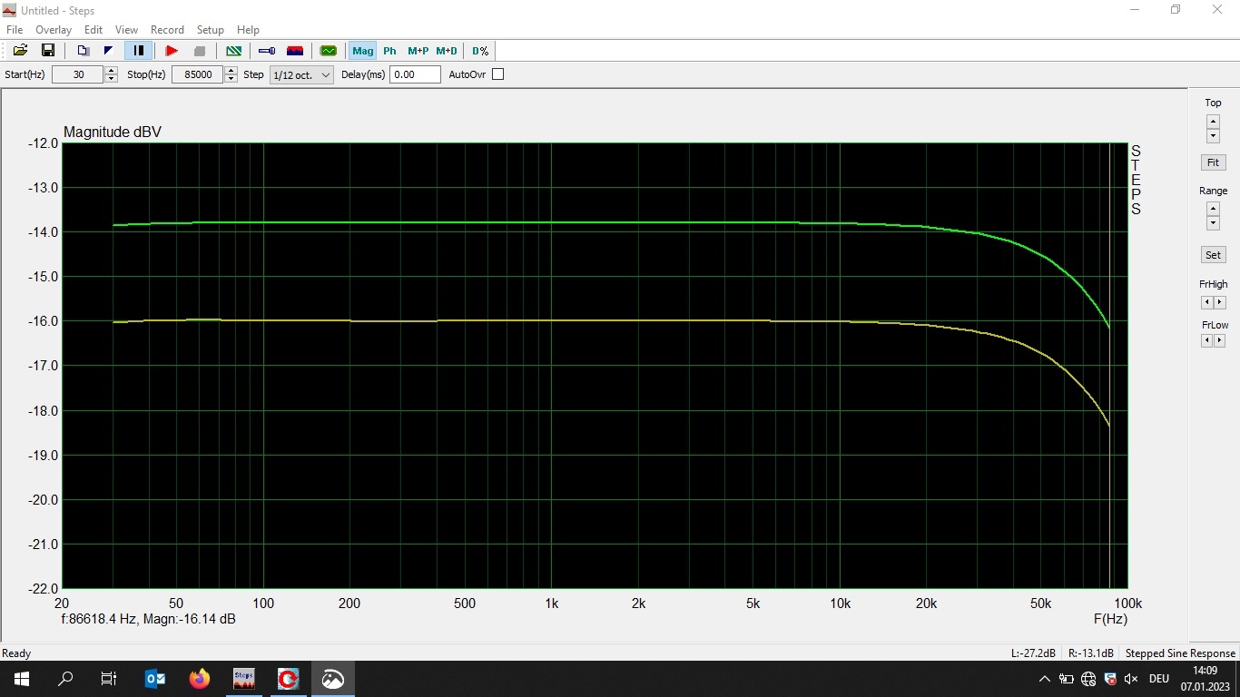

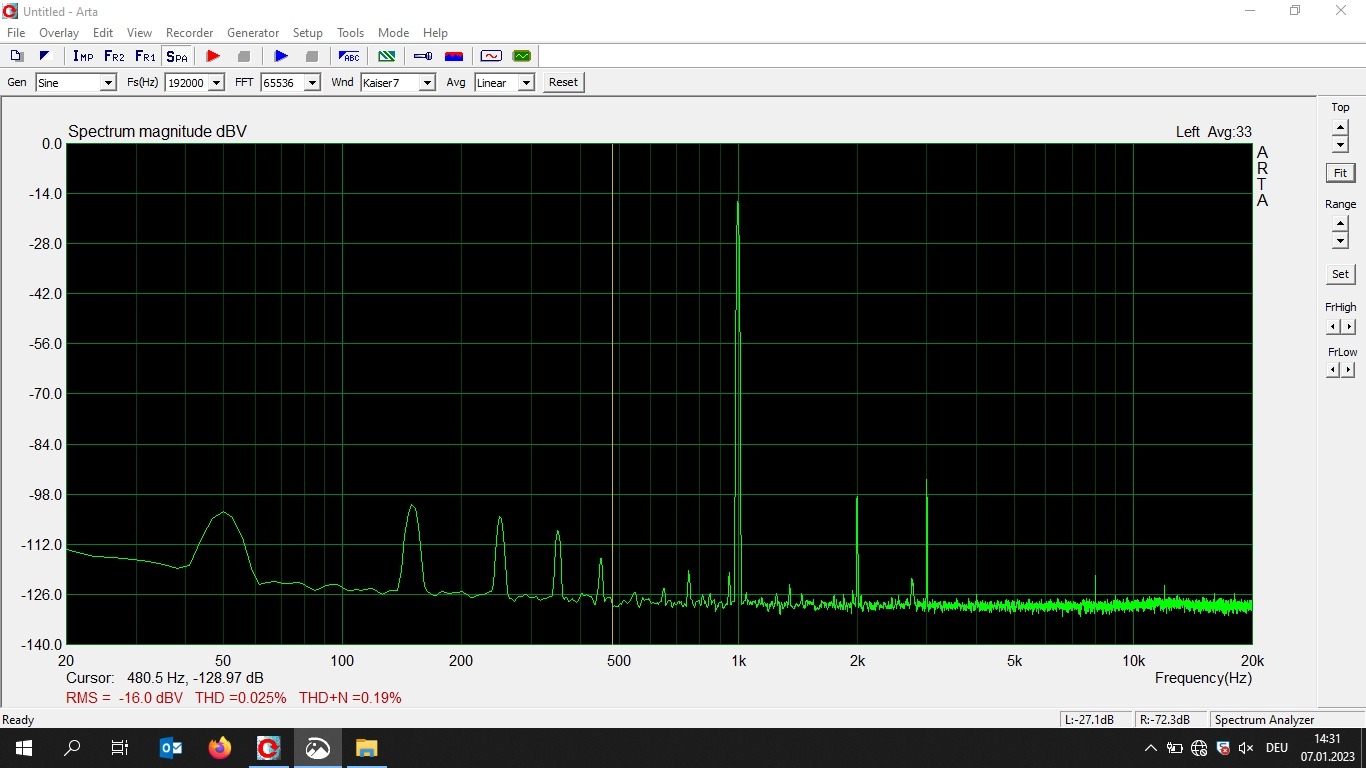

Despite my noisy open bench test setup I measured 0,025% THD at 1W/6R/1kHz and 0,047% THD at 1W/10R/1kHz. At 10W I got 0,095%/6R and 0,21%/10R. FR shows -1dB at ~ 55kHz. All measurements have been done with a not so perfect 1:10 divider. Therefore I assume the bandwith in reality is higher.
What made me curios: in this setup I needed two Fets for the mCS to get the lower impedance "going". The gain device seems to have almost no impact on lower load impedances. In Nelson's F8 only one IRF is enough. Also LTspice predicts that one FET for the mCS is sufficient. What do I miss?
Happy diy'ing & THX to Patrick

- lower Idss JFET's only work slightly better outputwise, maybe ~100mV more Vrms out (tested 3mA vs. 10mA, tested also 7,3mA) before visual clipping.
- the transconductance of one 9240 for the modulated CS seems too low. two in parallel are needed to gain some headroom. Max. Vrms rises from ~9.5V (one 9240) to ~10,4 (two 9240) at 6R. so it seems the FET transconductance in the mCS mainly determinates the maximum power output at lower load impedances (as the 10R max. output doesn't change).
- the offset is way more stable with only one mCS FET (around half).
- the gain FET transconductance seems to mainly determinate the maximum power output at higher load impedances. The change from SJ162 to 9140 brought addional 700mVrms at 10R or ~ +2Watts (with no change at 6R) - based on visual clipping when looking on a scope.
Well, it is not a F8 anymore, but an inverted one.
More like a UDNeSS without diff pair :
https://www.diyaudio.com/community/threads/udness-or-you-dont-need-semisouths.343164/post-6655510
So maybe should discuss over there instead of poluting Nelson's forum.

With 2SJ162/2x9240mCCS, 330R/91R NFB and 10,4mA 2SK170, 250m/687m Follower-R at 1% THD ....
As discussed above, lower Idss is more advantageous.
For example 6mA.
You need to check how much the current sharing ratio changes with top and bottom.
Especially also with different loads.
You can do so by inputting a 100Hz sine wave at the input.
Then use a good, battery-powered, digital multimeter to measure the AC voltage across R3,4 in the simplified schematics.
