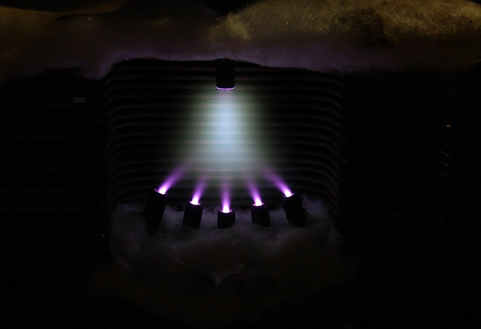

vdi_nenna: "364 degrees C" is not hot at all. I wonder if the Lansche distributor got the number wrong. The Hill plasma is about 10,000 C. The distributor is correct about Ozone being destroyed by high temps though. These cross over at something like 1.5kHz(?), but how much output? The Lansche site states: "The music signal itself is modulated and causes all points within the volume of the ion field to be accelerated exactly in unison by changes in the electric field strength" which largely of correct.
JeyDee: The Hill Type 1 goes down to ~1kHz and can output about 110dB @ 1 meter, but distortion is more like a soft limit. The notion of a sensitivity (dB/W/m) as it might pertain to amplifier power doesn't work because the plasma is the load for the built-in class A amplifier stage - it receives both the "bias" power and the audio modulation. the amplifier input is driven directly by a electronic crossover.
Btw, the Hill Type 1 is not generating sound with modulated ions or electric fields - it does it by modulating the power and thus the air density at the very steep thermal gradient present at the plasma boundary layer .
How does it sound? Read the old reviews (e.g., Stereophile), or at http://hillplasmatronics.com/
Here is a photo - the distance from the top electrode to each bottom electrode is ~1 inch
