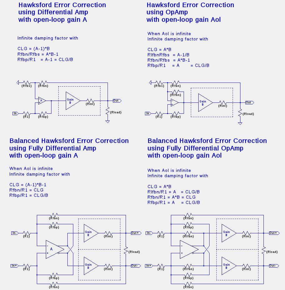

A major difference between positive current feedback (PCF) and Hawksford Error Correction (HEC) is that PCF shouldn't change the harmonic structure of the amplifier, whereas HEC attempts to remove all differences between the output and the input (multiplied by the closed loop gain), including the harmonics. I need to run some simulations to verify this conjecture. If anyone is really interested, I can provide the systems of circuit equations used to produce all of the resistor ratios shown in the circuit diagrams.
Hello lhquam. Please count me in. Thank you.
Hello lhquam. Consider the model Op Amp with diff inputs which is the top right view of your post.
1. Let B=1 with an Rint = 0.2 Ohms.
2. Let A = 21
3. Let Rsense =0.2 Ohms.
I hope the following are the correct answers after solving the equations you showed.
a} Rfn/Rfs=[A-1]/2 = 10
b} Rfp/Rf1 = A/2 = 10.5
c} CLG =21

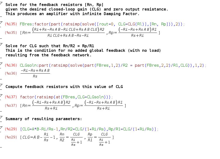

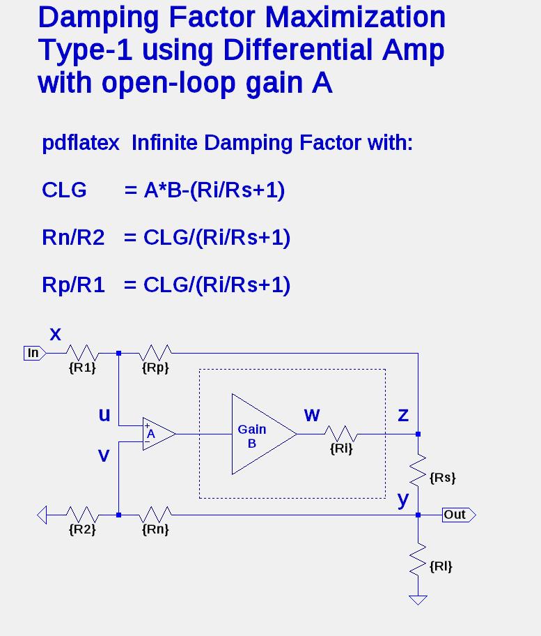

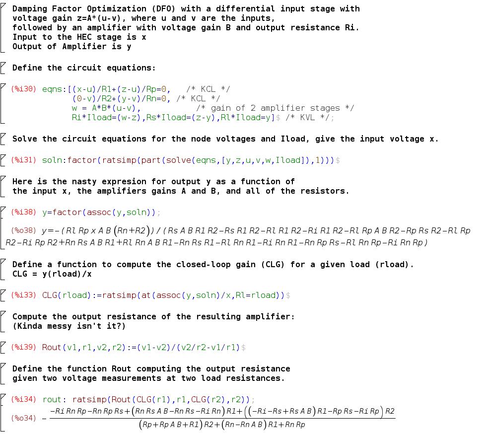

Here is the derivation of the feedback resistor values for the Positive Current Feedback implementation using a differential amplifier with gain A. To make the algebraic equations more readable, the resistor names have been shortened to two characters. What I show is the output from Maxima, a symbolic algebra manipulation system. Sorry, but I haven't figured out a good way to place all of this in a single pdf file.

Hello lhquam. The left view shows that the ratio of the resistors are exactly equal; unlike the difference of [10 versus 10.5] I calculated in the earlier example. Please explain.
Thanks for the derivation of the results.
The difference will be explained when I show the circuit equations and analysis for the PCF using an opamp with infinite gain vs. a fixed gain differential amplifier. Basically, the opamp in+ node has 2 resistors vs. the in- node has 3 resistors, resulting in an asymmetry.

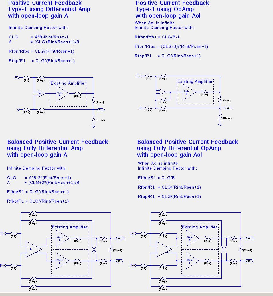

Your interpretation in points 1-4 seem to be correct. I consider the preamp with associated resistors to be the PCF (or HEC) circuit, which when wrapped around the amplifier (characterized by voltage gain B and internal resistance Rint) constitutes and new amplifier as you described on point B. The preamp or front-end can be anything from a suitably modified BA3GS (BA-3 Gain Stage) to a DIY board containing an OpAmp or some other differential amplifier.
The solutions to the circuit equations I presented are designed to have no additional overall negative feedback. That is, the presence or absence of the Rfbp and Rfbn PCF feedback resistors to not change the output in the condition when there is no output load.
The design process for the fixed-gain A differential amplifier is as follows:
  1. Determine B and Rint for the amplifier to be used.
  2. Pick Rsen, R1, and Rfbs.
  3. Choose a desired CLG.
  4. Compute A, Rfbn/Rfbs and Rfbp/R1
What remains to be understood is the stability of these feedback schemes when the underlying amplifier has phase lag. Cordell's "Designing Audio Power Amplifiers" has some discussion of feedback compensation for some HEC implementations but I have not done the needed analysis for my PCF and HEC circuits.
My experience is that intrinsic bandwidth limits are exaggerated by PFC,
so that high frequency roll-offs will occur earlier. Not much of a stability issue,
because the phase lag tends to move the feedback away from positive phase,
but worth noting.
You do have to watch simpler stability issues related to source impedance
and/or and load values. High source impedance, or a load comparable to the
sense resistor can be invitations to problems.

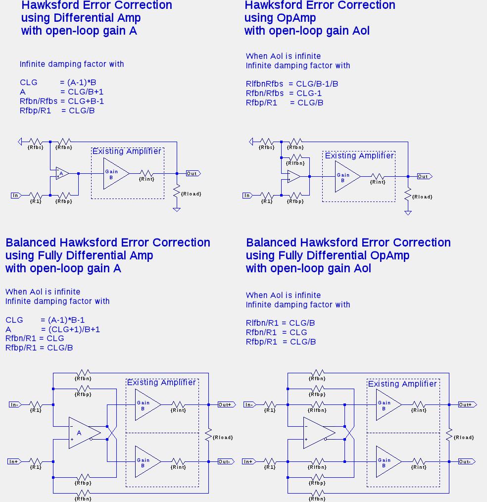

I analyzed the circuit equations with the signal input to the inverted input of the opamp and got the following resistor values:
Rlfbn/Rfbs=CLG/B
Rfbn/Rfbs=CLG/(Rint/Rsen+1)
Rfbp/R1=(B+CLG)/(Rint/Rsen+1)
I also ran a simulation and everything looks good, including the nearly infinite damping factor.
