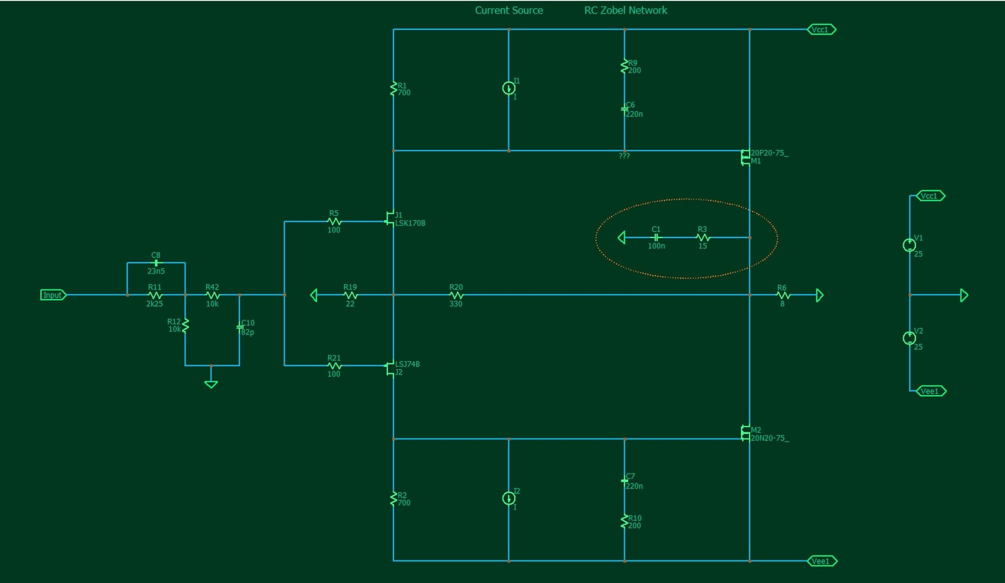

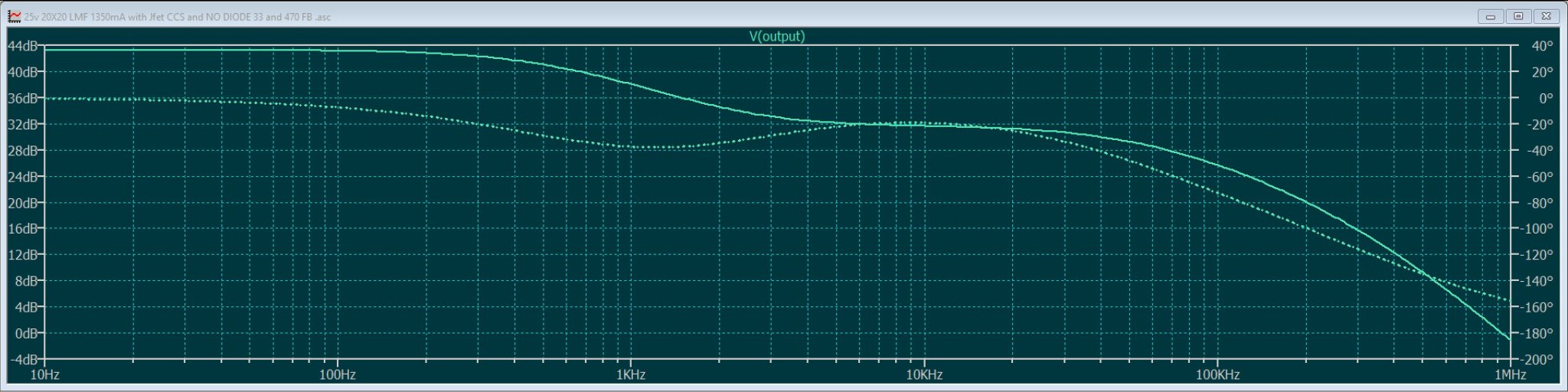

I see three corrections: also R7/C6 and C7/R10. I will try the Zobel. Indeed, sibilance I didn't call it (yet), but a slight over excited capability to present the high tones. I was pondering changing the feedback loop a bit with the intent the phase will change, but this is much simpler!I still working on an F7 type amp that has two plateaus of OLG that looks something like this:
Recently, I added a Zobel network to the O/P shown in a simplified circuit here:
My motivation for adding this was that I have noticed that this kind of amp ( F5 / F7 ) has a tendency for some exagerated sibilance ( still there despite the fact that on my latest version there are only very small amounts of feedback 5k - 20k hz region. )
Regarding this sibilance, the zobel network was not particularly effective but it had a wonderfully positive subjective effect on midrange purity, imaging and reproduction of low level detail.
Anyone that has built an F7 / F5 type circuit might like to try adding a zobel across the amp O/P ( as close to the amp O/P as possible. ) and would be interested to hear if you notice the same subjective improvement.
If I succeed in taming the sibilance I am going to very happy with this F7 type amp.
If I do succeed I will post the final circuit here.
Would the slightest coil in the output help? Transitor outputs have that a lot. Just to force compliance into the Zobel, I could understand. With my 4/8ohm non-inductives my F5 build goes flat to above 5 MegaHerz!!!!!
