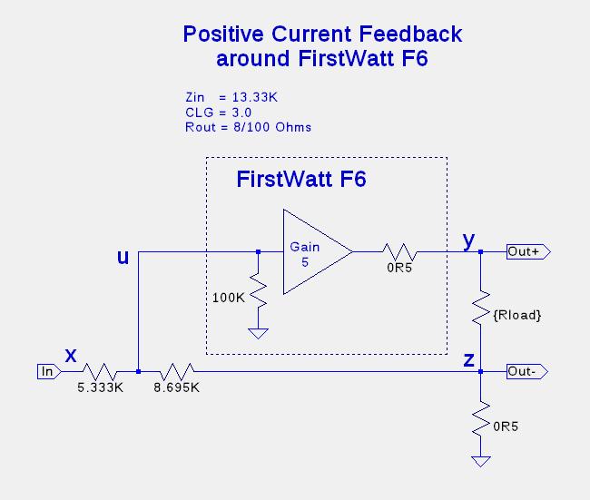

Here is the PCF circuit that Nelson might have had in mind back in an earlier post. It couldn't be simpler, but it does have some limitations such as reducing the closed-loop gain and requiring an amplifier with a gain of at least 3.
Shown is a PCF circuit for the FirstWatt F6. It reduces the closed-loop gain to 3.
Be sure to look at the pdf file.
Hello and thank you lhquam. Will the calculations in this pdf apply equally to the Class AB variant of diyF6?
The damping-factor (and thus Rint) of a Class-AB amplifier often changes with power level, so the resulting amplifier Rout will be be constant. Otherwise the PCF should be fine if the amplifier parameters are realistic.
