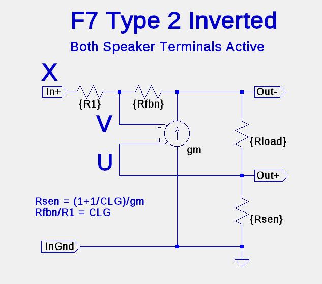

I finally got around to considering the inverted case. Yes, it has 2 fewer resistors and very simple equations.
Hello lhquam.
What is the relative signal phase at the inputs [u and v]. These signals seem to me to be 180 degrees out of phase, and thus problematic.
Hello lhquam.
Look at the opamp input polarity. The input X goes to the opamp negative input, and the polarities get flipped. U = -((1+CLG)*X)/(gm*Rload) V = -X/(gm*Rload) The negative feedback factor is NFB = (gm*Rload)/CLG

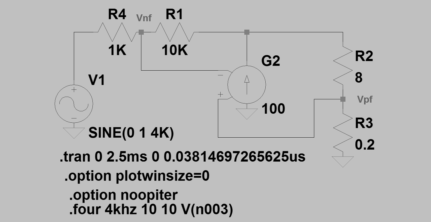

Thanks lhquam. Maybe you and/or the software that you are using can populate the schematic with sine wave symbols for a comparative visual.
Just enter the circuit into LTSpice and run a simulation. It shouldn't be that hard.
Great advice, and not hard at all; provided I got the commands right in the attached asc file. U and V signals are in phase, but LTspice finds their numerical difference [U-V] to be quite large.
Hello lhquam.
The asc file of your attached model schematic shows that at least a Gm =100 is needed to minimize the numerical difference [Vpf-Vnf], and have both feedback signals in phase. I have minimized the aforementioned difference because both signals are presented to the front end differential amp [of the power amp] and are normally almost equal in magnitude. But; it may be possible that the deliberate application of PCF dictates that a certain minimum difference exist. This is done [in the attached asc file] by decreasing the value of Gm to the desired difference [Vpf-Vnf].

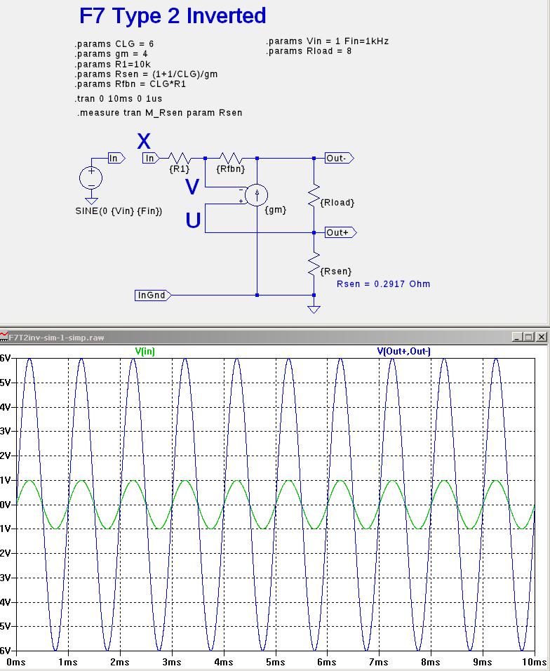

Here is a simulation of the PCF Type 2 Inverted circuit. You can play around with the circuit parameters such as gm, CLG, R1. The calculations for Rfbn and Rsen create a infinite damping factor, i.e. Rout is zero. The waveforms show a realistic example with gm=4 and CLG=6. With Rload=8, the open-loop gain is 32.

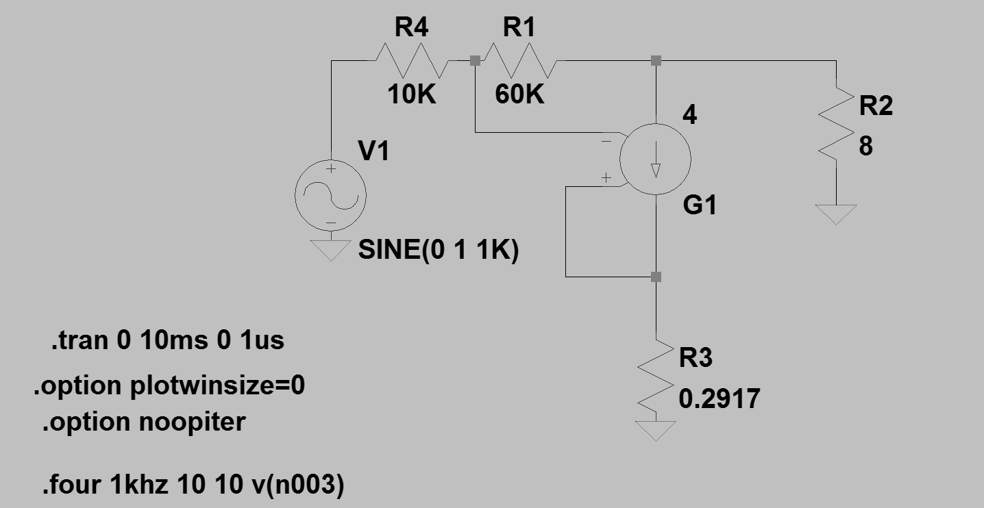

What does the simulation show? That circuit would be equivalent to tying all 3 of the ground points (including the input ground) together and moving the ground point to the top of the sense resistor.Hello lhquam.
Is the attached schematic viable and/or has potential? Practically, the 8 Ohm load is a reactive loudspeaker coil. The 0.2917 resistor still senses load current.

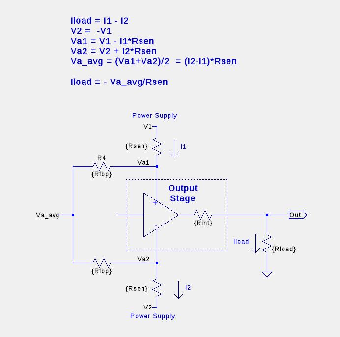

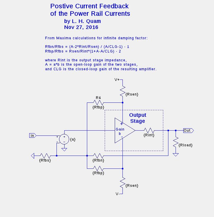

Yet another PCF topology
Here is an interesting PCF topology that avoids disturbing the input path to the amplifier by generating a PCF feedback current that is of the opposite phase of that generated by having a sense resistor in the path of the amplifier load as in the Type-1 and Type-2 typologies that I have previously described. This topology assumes that the V+ and V- power rails have equal opposite voltages. A sense resistor is placed in the path between each rail and the output stage. The figure on the left shows show the load current feedback is generated by summing the voltages on the amplifier end of the sense resistors. The figure on the right shows the analysis of the complete feedback circuit and how to compute the resistor values.
