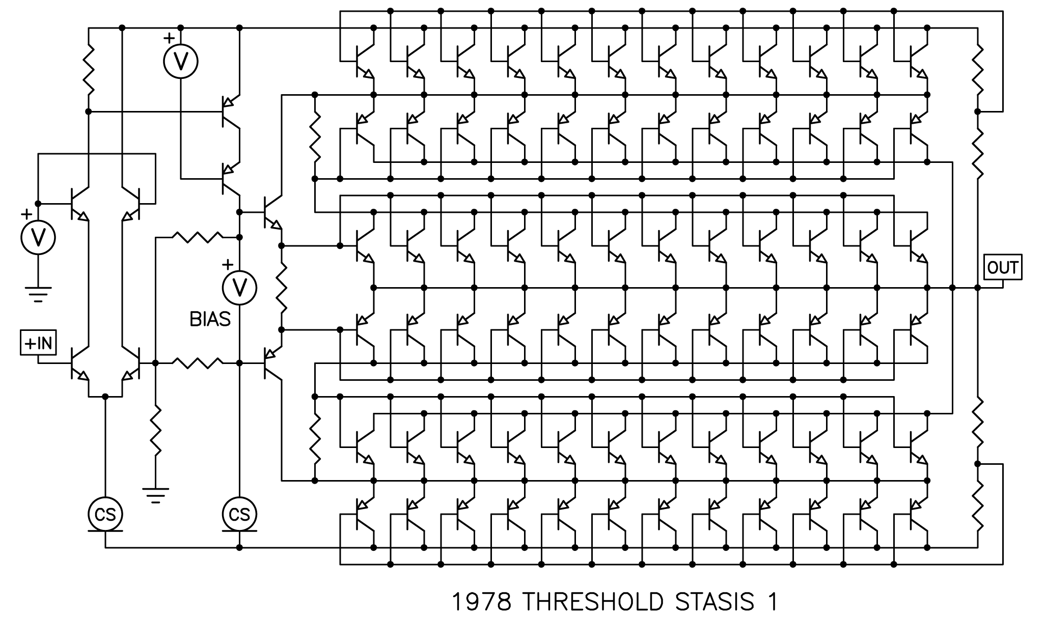

Hello lhquam. Your idea suggests that a STASIS power amp is amenable to use positive current feedback. It does not use overall negative feedback, and its power output stage is complementary common collector. The damping factor of 80 [e.g for S/150] may then be further increased.
I found a schematic for a STASIS-1, but I haven't spent enough time studying the circuit to fully understand the output stage. It actually appears to be a common-emitter BJT output stage, not common-collector.
without even looking at previous post etc, that sounds a lot like quads current dumping.
I referred to it that way, but I got lots of static from Lipshitz and Vanderkoy
about it not really be feed-forward.
I don't see their point, but perhaps they are using some official or proprietary
definition of feed-forward that I have overlooked.
Here is the simplified schematic for your entertainment.

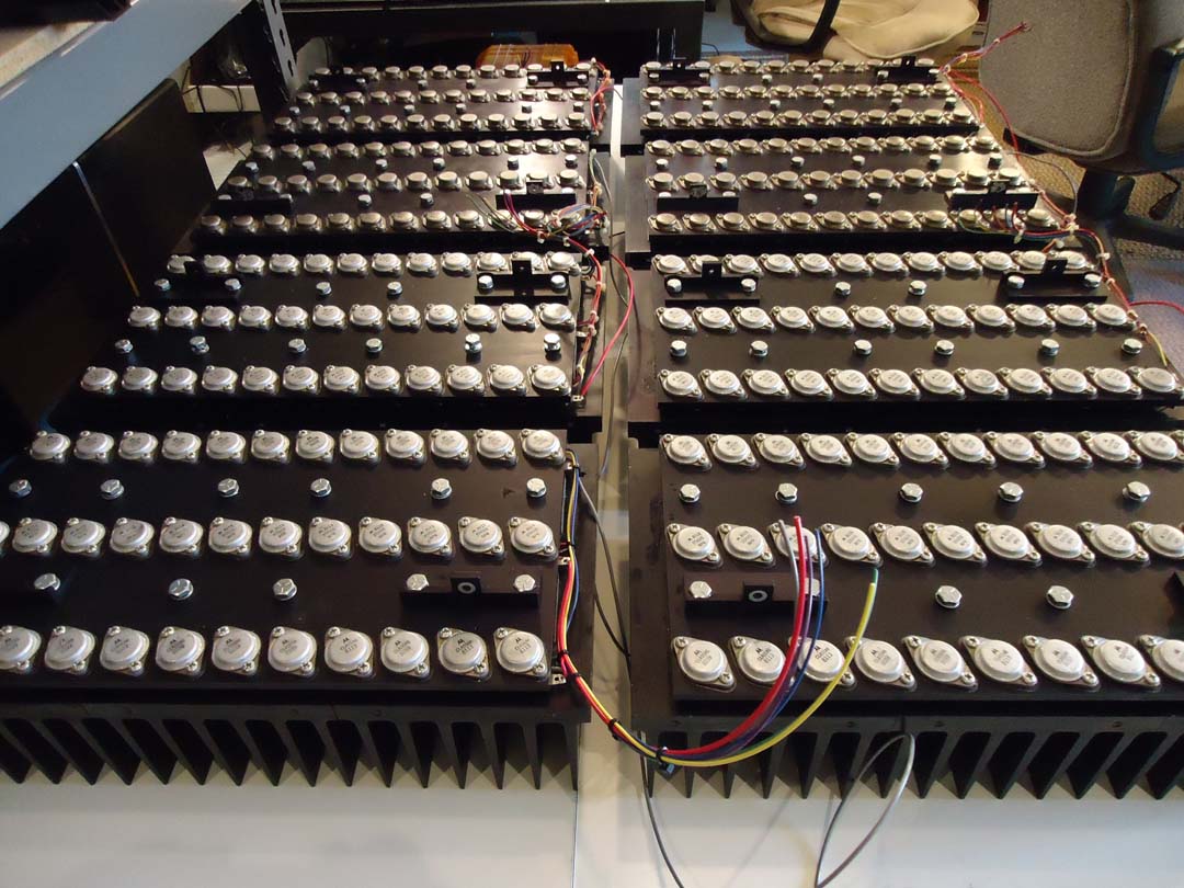

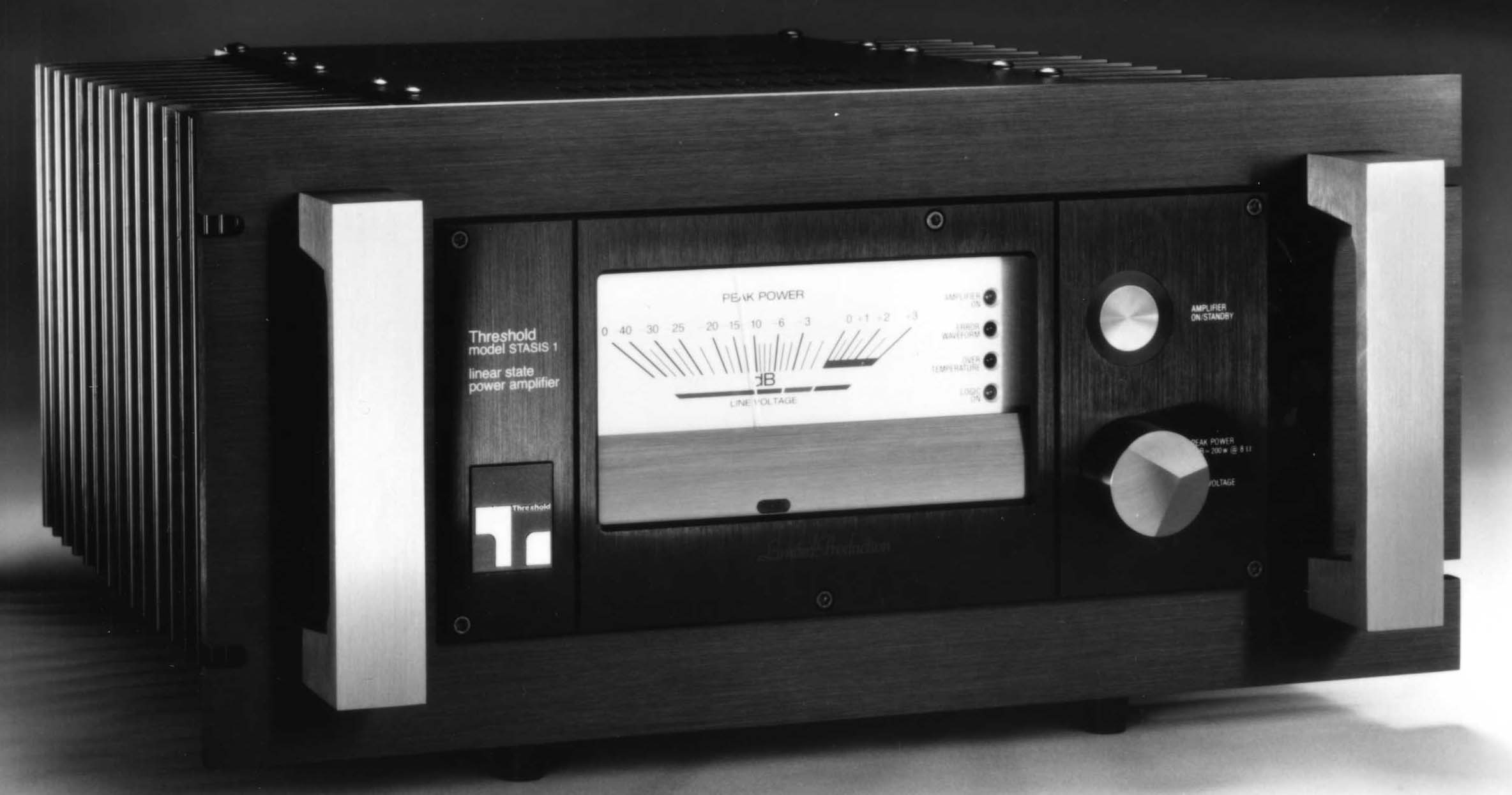

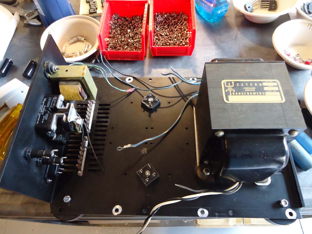

Since we are strolling down off-topic memory lane,
Here is a photo, and also a couple of photos of four Stasis 1's being restored
in my shop. You can see the output stages and the stripped down power
supply part of the chassis.
