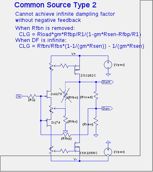

I finally decided to perform some mathematical analysis of amplifier typologies having positive feedback but no negative feedback.
The first example was the F7 topology candidate that I designated as "Type-2" in earlier posts. When I attempt to remove all (global) negative feedback, the resulting amplifier has an zero damping factor. This is because the F7 has a (push-pull) Common-Source output stage and is essentially a transconductance amplifier requiring negative feedback to achieve any significant damping factor.
The image below shows the circuit and some related equations.
In order to control the da

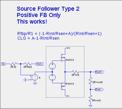

Having determined that (pure) Common-Source output stages require negative feedback to achieve a damping factor I decided to try a Source-Follower output stage, preceded by a differential gain stage with a voltage gain of A. The resistor Rint characterizes the internal resistance of the output stage.
The image below shows the circuit which has only positive global feedback, and the parameters for achieving an infinite damping factor of the resulting amplifier.

Hello lhquam. Maybe diyF4, and those with the asymmetric output stage? diyF5, and diyF6 are out of contention. Thanks lhquam.
Yes, the F4 and other source-follower amps preceded with suitable gain stages are candidates for damping factor control using positive feedback without global negative feedback.
The F5, F6, and F7 are not candidates, since they have common-source output stages.
Here is an example for a source-follower output stage: The FirstWatt F4 specifications show Rint=0.2 Ohms. If we choose Rsen=Rint, and CLG=5 (closed-loop gain of the combined front-end gain stage and the F4 with positive feedback), we get the required gain of the front-end gain-stage to be A=7, and Rfpb = 2.5*R1.
Having determined that (pure) Common-Source output stages require negative feedback to achieve a damping factor...

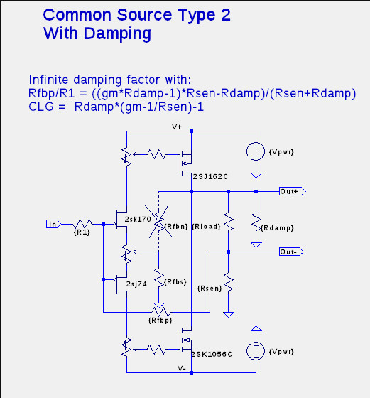

I guess it would depend on what you mean by pure. If the amp has a
non-zero damping factor, then it is conceptually, if not practically, possible.
For example, imagine a Common Source output stage loaded to ground by
some resistance, that resistance providing the damping factor.
Practically speaking though, we would use a Common Drain output stage for
a no-negative-feedback version.
Yes, with some (resistive) damping, a common-source amplifier can exploit positive feedback without needing negative feedback. Below is a the circuit of post #645 http://www.diyaudio.com/forums/pass-labs/275921-first-watt-f7-review-65.html#post4732415 with a damping resistor added. Shown are the equations for positive feedback resistor that achieves an infinite damping factor, and the resulting closed-loop gain (CLG).
Here are a couple of example sets of values:
gm=4, Rdamp=10, Rsen=.5 => CLG=19, Rfbp/R1=.905
gm=4, Rdamp=80, Rsen=.5 => CLG=159, Rfbp/R1=.988
