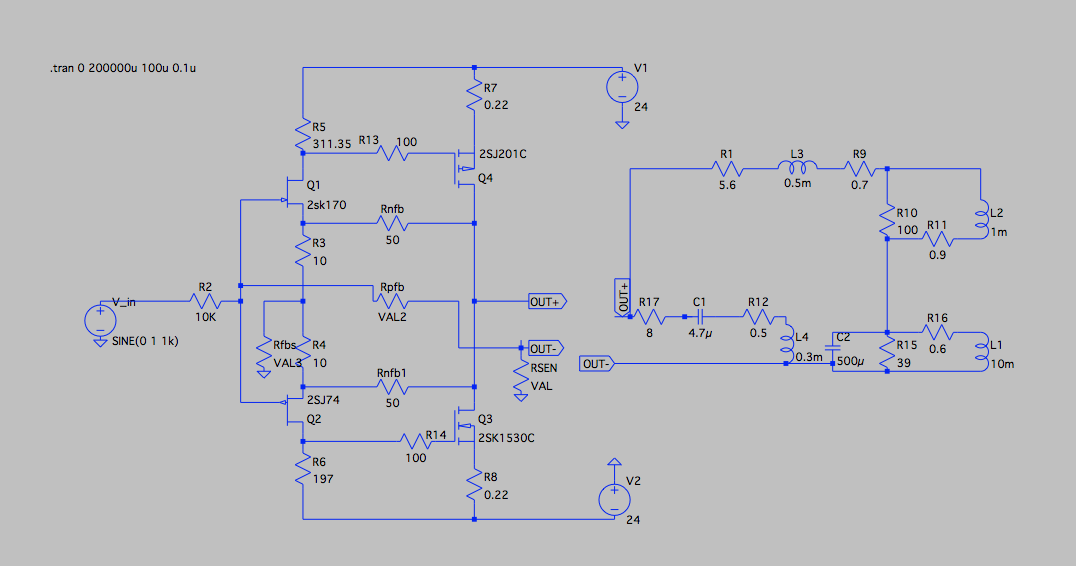

Dear All,
I am trying to simulate the Type 2 feedback scheme applied to a DIYF5. Please note that the value in the pictures are of the F5 adapted to the different mosfet.
I must be doing something wrong, as I would expect the overall gain to increase when I decrease the positive feedback resistor and I get exactly the same behavior.

It might seem counter intuitive, but the closed-loop gain decreases as the positive feedback resistor is decreased. To understand this you must consider the voltage produced on the JFET gates from V(In) and V(Out-) through the resistor network. If the target closed-loop gain of the amplifier is 5X (F7 spec) and Rsense=0R3, then V(Out-) = 5*V(In)*.3/(8+.3) = .18*V(In). Now compute V(gates) resulting from the resistor divider (10K and Rfbp) between V(In) and V(Out-).

I get the following:
Vg= {[ R1/(R1-Rfbp)]*[ (CLG*Rsen)/(Rload+Rsen) - (Rfbp/R1) ]}
Basically Vg (as you said) increase when Rfbp decrease and go to infinite when R1=Rfbp.
So Rfbp=47k will give me 1.22 for 8 ohm load.
Then the game is to solve all the problem to get at a point where CLG and gm are not dependent on Rload any more (If I got all the story right)

Backwards. I get:
Vgate = Vin * (CLG*Rsen/Rload*R1/Rfbp +1) / (R1/Rfbp +1)
Let A=Rfbp/R1, B=Rsen/Rload then we get
Vgate = Vin*(CLG*B/A+1)/(1/A+1)
= Vin*( A/(1+A)*(1-B*CLG) + B*CLG )
The term 1-B*CLG is positive for all cases of interest, and A/(1+A) is an increasing function for A>0.
Thus, Vgate increases as A increases, and A = Rfbp/R1.

The piece that I am missing in the puzzle is how I calculate gm, that I expect to be also a function of the feedback arrangement and Rload.

Estimating gm is indeed a juzzle since it depends on many variables, the most important being:The piece that I am missing in the puzzle is how I calculate gm, that I expect to be also a function of the feedback arrangement and Rload.
Thanks,
D.
- JFET drain load resistance
- JFET source degeneration
- JFET gm
- Output MOSFET gm
Is there a way to have LTSpice compute gm ?
I understand that it is imperative to remove Rload from the equation, mostly because the real load is frequency dependent.
D.

I am still puzzled by your calculations: let's say that Vgate = F(Rfbp) * Vin
For positive feedback shouldn't I have F(Rfbp) > 1 ?

The only requirement for positive feedback is that 1/Rfbp>0, i.e. that Rfpb is non-infinite. What you are failing to consider is that the input voltage V(In) is attenuated by the resistor divider formed by R1 and Rfbp, and that the positive feedback signal from the top of Rsen is the highly attenuated signal V(out)*Rsen/Rload.

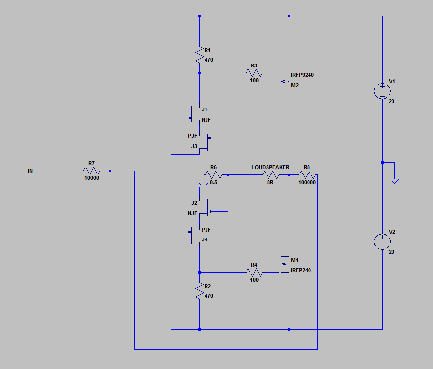

This would be a simple way to build a F7-"ish" amp.
I guess this is not the way Nelson Pass builds the F7 since he does not write anything about using 4 JFets per channel. It seems like a simple a neat way to implement some positive current feedback in a F5 inspired amp though.
I know he does not use IRFP parts. I just choose them for a quick simulation.
Johannes

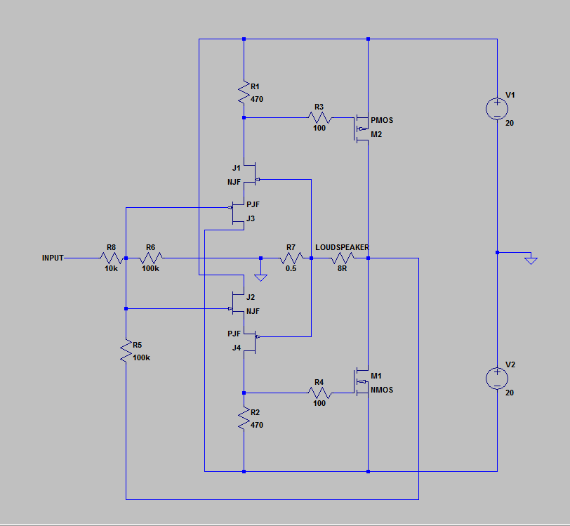

This should be better.
I forgot about which input was inverting.....
Johannes
I assume the same mosfets, IRFP9240 M2 and IRFP240 for M1. Jfets J74 and K170?
The IRFP240 and IRFP9240 have a to high Vgs which forces the use of to large values on R1 and R2. There is to much gain with those transistors. I could not simulate the amp with JFets, but with a properly bias mosfet input stage the amp had way to much gain. It became very touchy and wanted to broadcast AM radio for any excuse.
I guess Nelson Pass uses the vertical fets partly to lower the value of R1 and R2. They also drift less with temperature which is important if you want to remove the source resitors.
Seems like a reasonable choice. You might need some resistance between the sources on those Jfets to tame the gain down a bit. I don't have any models for for those Jfets in LTSpice, so i could not simulate them in this circuit. I just pulled the values out of my head. Think of that schematic as general example only. It is not optimized in any way.
