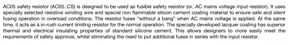

Vishay AC05 series for the big greenies.... 🙂
Thanks for response Generg
Interesting greenies 😀
That statement belongs with the AC05xxx-CS series resistors that are only available in the 10R to 100R resistance range. http://www.vishay.com/docs/28894/ac05cs.pdf
Next reference of resistors are Vishay AC05 simpler version without CS options ( fuse, in rush current protection )
http://www.vishay.com/docs/28730/acseries.pdf
Start with 0R1 resistance range.
