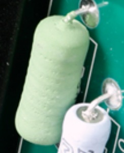

What technology type of resistor are this fat green : metal oxide , wirewound or ... ?
...based on texture ...wirewound for sure but maybe it's important to know the manufacturer....there are many wirewounds...some good .....and some bad.
