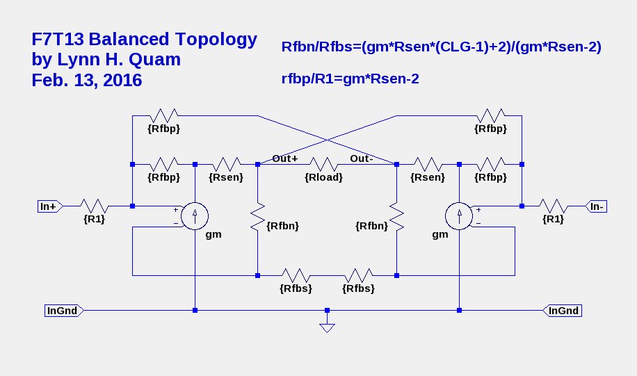

The circuit in post #541 has several problems. The + and - inputs to the amplifier have large voltage swings, due to the feedback topology.
Here is a balanced (bridged) topology that avoids those problems and has inputs to the amplifier that are comparable to those in the unbalanced Type 2 topology.

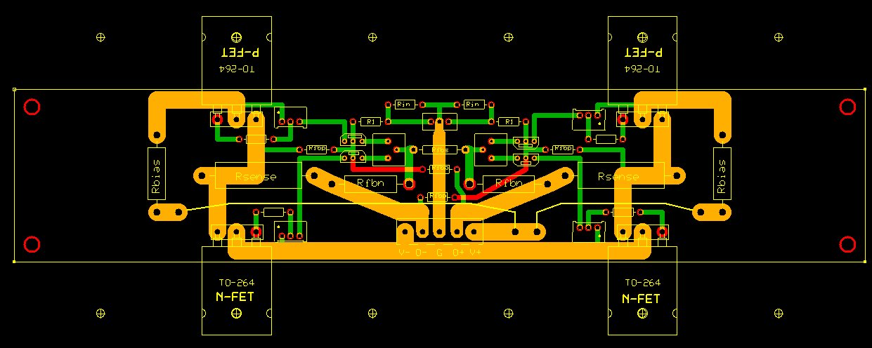

And here is a PCB layout using the DIYAudio Universal Mounting Specification.
Looks good, Ilquam. It is a very tempting build. What does the gain look like on this version, is using balanced inputs.
The closed-loop gain is 10X. Yes, balanced inputs to the 3-pin connector at the top middle.Looks good, Ilquam. It is a very tempting build. What does the gain look like on this version, is using balanced inputs.

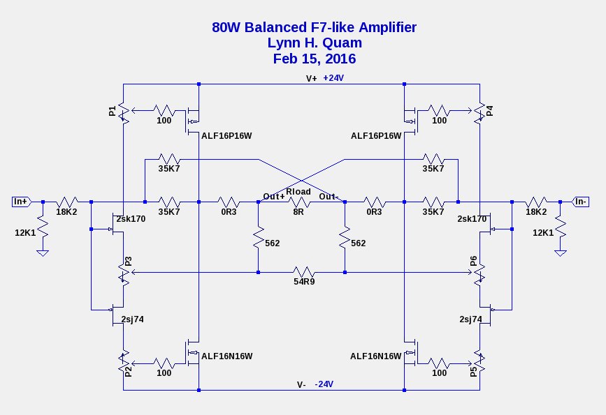

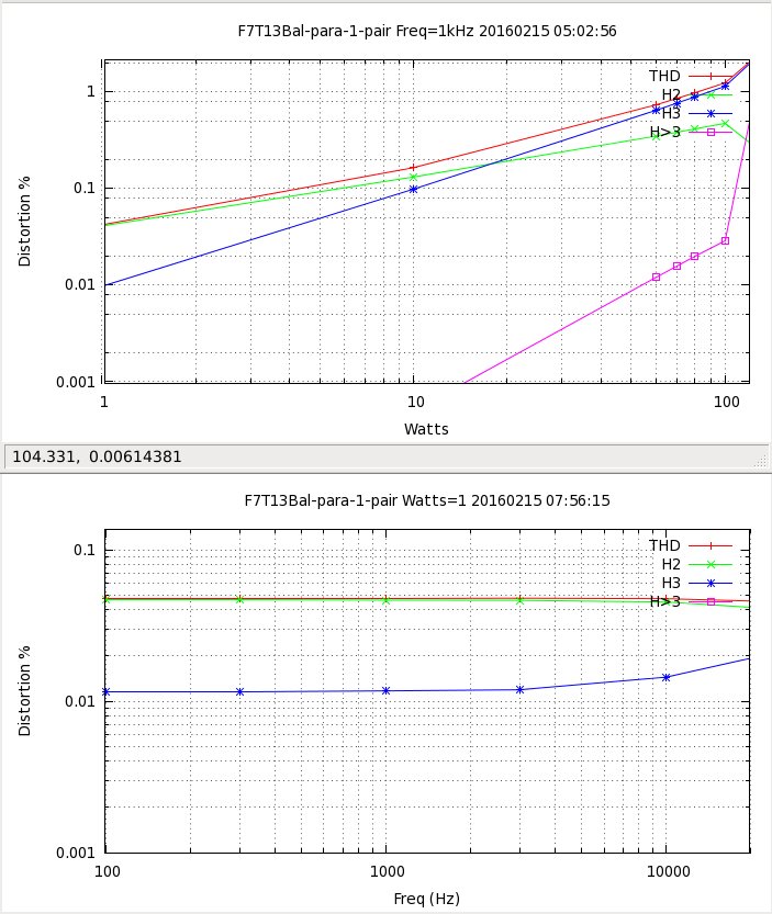

Here is an actual (LTSpice) implementation of the topology of post #542, using double-die ALFETs. It simulates quite well, with THD<1% at over 80W.

Since the main objective of using positive feedback is to increase the damping factor, can you share what is the DF on your latest circuit.

The damping factor is around 100 and can easily be changed by minor adjustments to resistors and/or the output FET bias current.

Then you have the same DF as advertised for the F7.

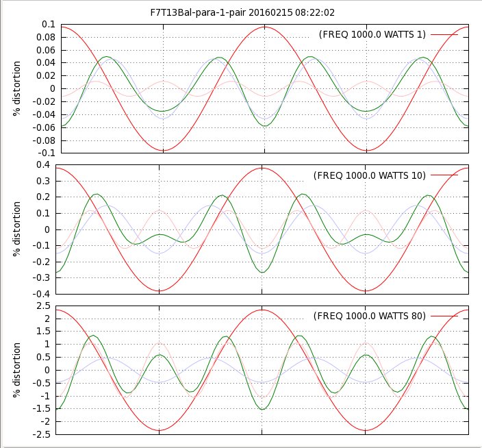

Have you confirmed by simulation that more positive feedback increases DF but also THD?

More positive feedback increases damping factor, until you reach an optimum value where the internal resistance is zero and the damping factor is infinite. Beyond the point, the damping factor becomes negative and the output level increases with lower output load resistance.Thanks .

I have not observed an increase in THD with higher damping factor.

Here are some simulation sweeps and distortion waveforms.

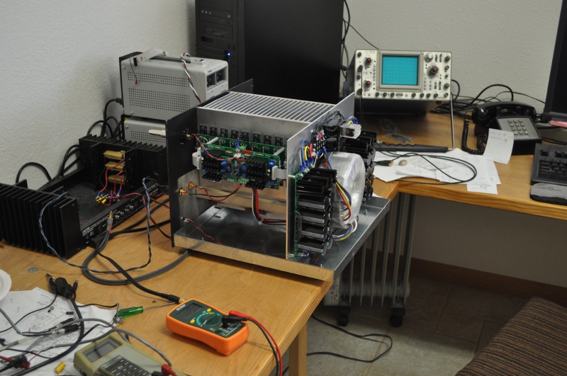

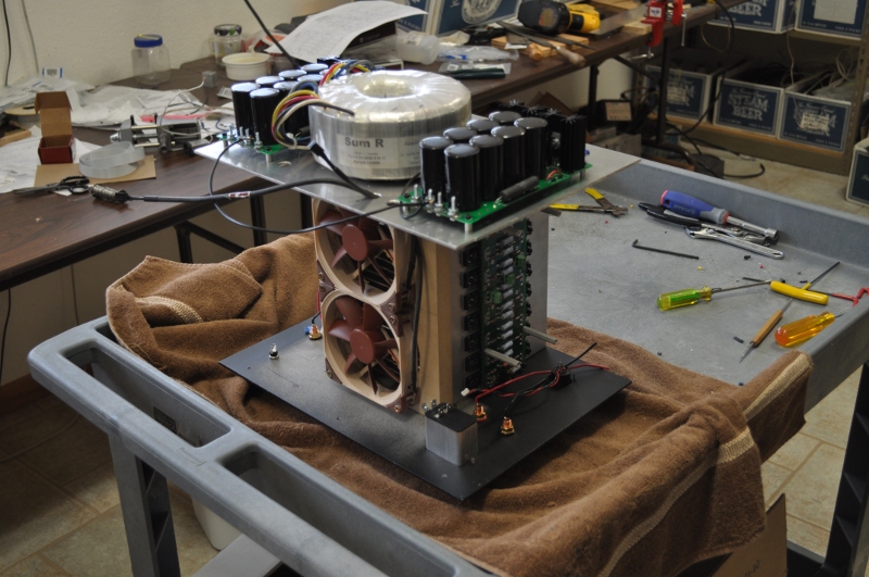

While the PCB layout conforms to the UMS, the power dissipation of about 200W/channel requires fan cooling or much larger convection cooled heatsinks. Here is how I accomplished it for a XA30.8 sized amplifier.

This balanced amp could be build as mono-blocks and "normal" sized heatsinks and should not require active cooling. It would require obviously a different PCB and two more connections on each board for the positive feedback and the "X" connection. It would be a very simple PCB.
