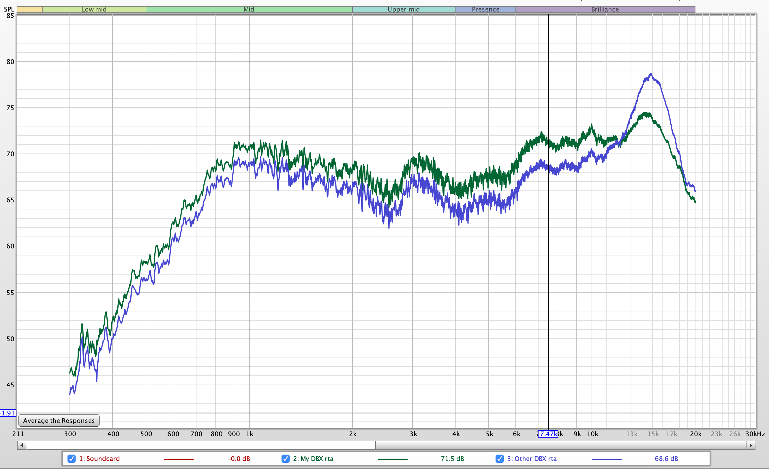

So, I got another measurement mic from my church, which unfortunately is the same exact mic. But I still got it to see if there was any difference. And, yes there was. Theirs is actually worse. Attachment below.
That same area where there is a problem, the churches mic is even worse just there. It is all very odd.
I am assuming that the DBX mic is not great at these frequencies and that the calibration file is not correct at all.
In that case, I do not know how to calibrate my own mic and from looking it up it seemed that most people just recommend to buy a new mic. Lots of people also recommend the Dayton mic that you linked, so pretty unfortunate that it is out of stock.
I also tried these tests on my Windows side with the same exact results. I re calibrated the sound card and SPL meter on both sides. Same stuff.

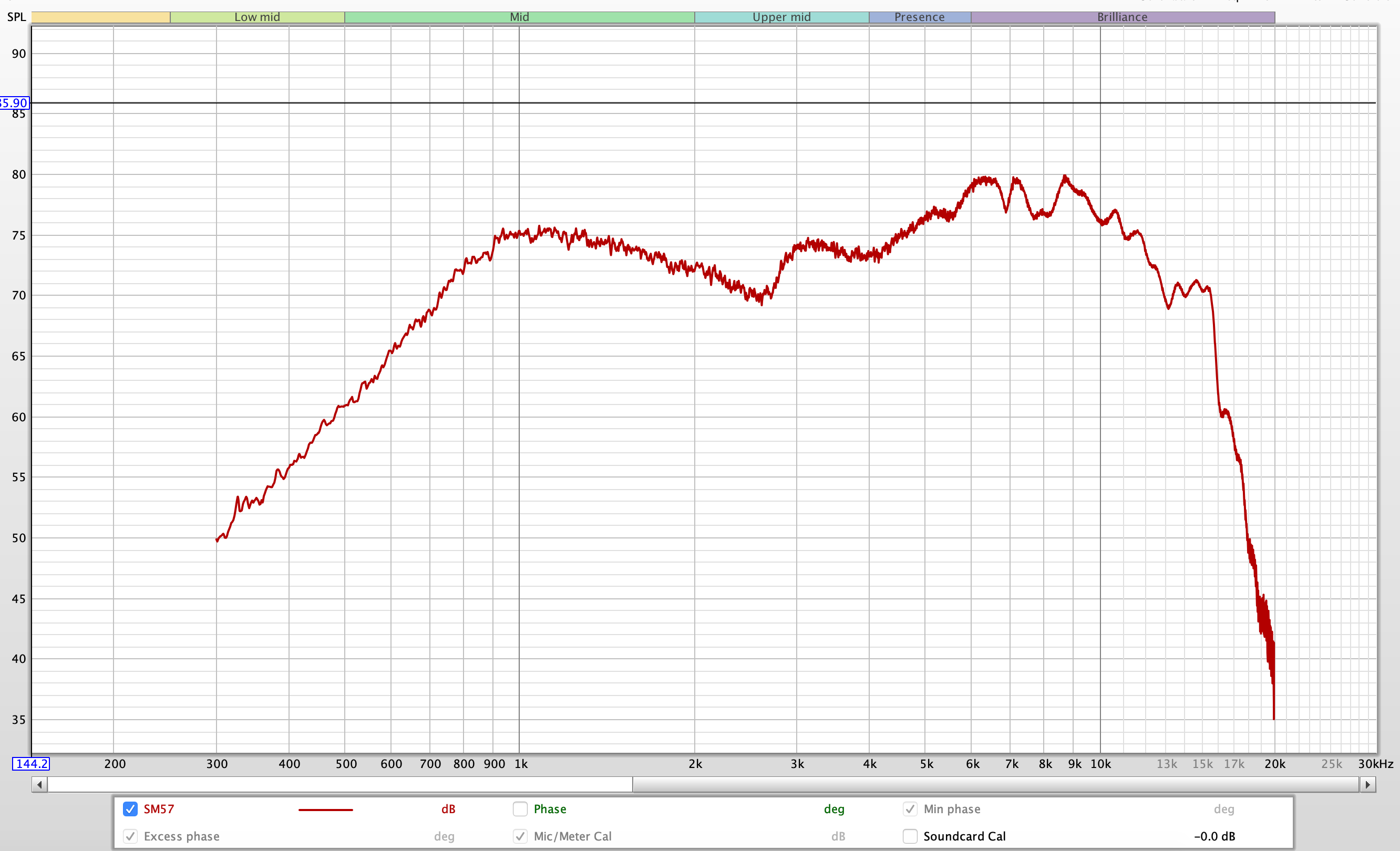

I tried measuring with a SM57, picture attached below, just to see if I am getting the same effect as the other measurements. I know a '57 aint going to actually work for measurements, but still wanted to see if anything other than the DBX rta was the problem.
Sure enough, I do not have the same effect. So it very much seems like the mic is the problem and that for sure needs to be replaced.
