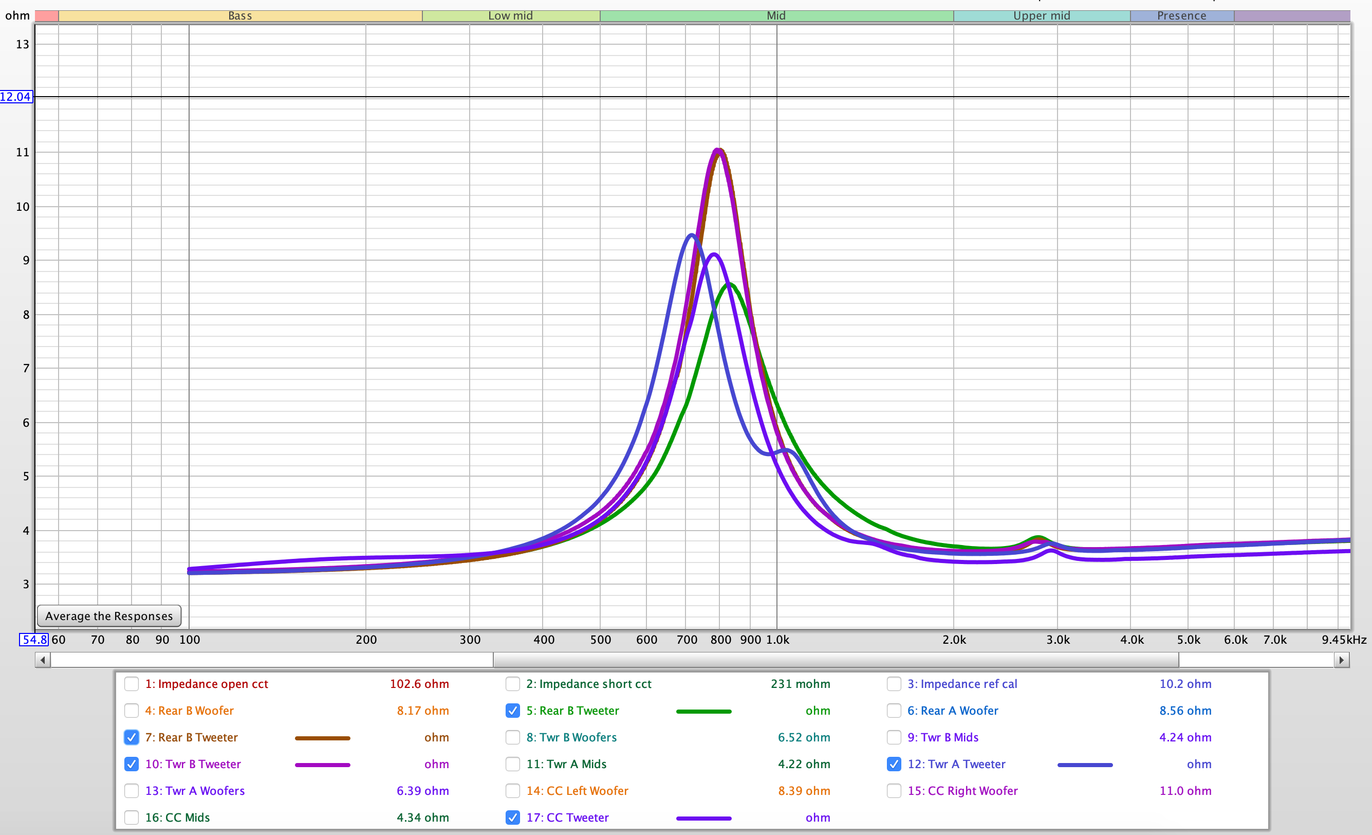

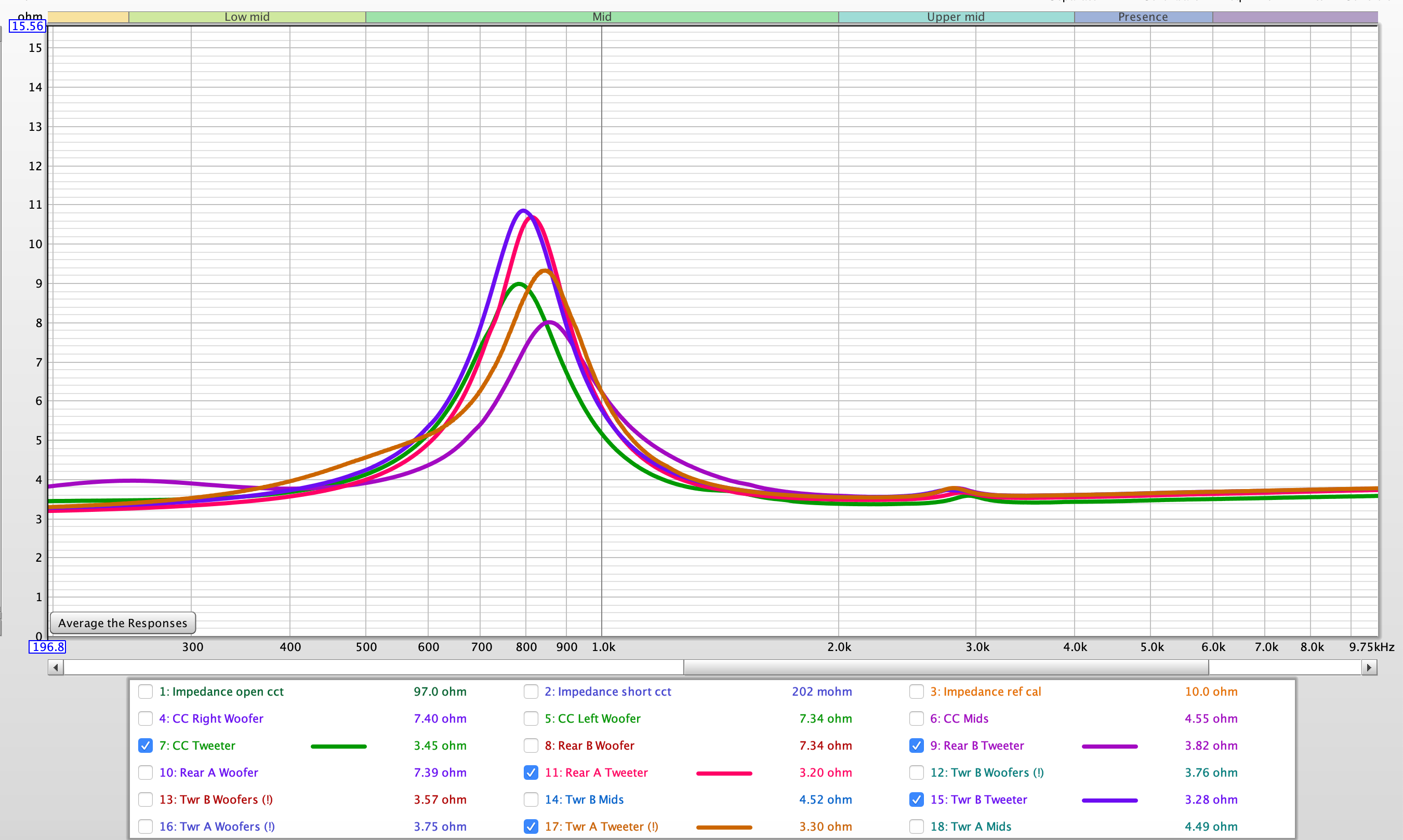

But I have finished the impedance measurements and wanted to shoot them your way. Im going to be doing the FR of the CC here soon. But here are screen captures of all the speakers.
Capture 1: The tweeters.
Looks like I should move the tweeter on Rear B to Tower A since those match so well. Then the tweeter on Twr A can go to the CC since that one seems like an odd ball out. Then the CC tweeter can go to Rear B.

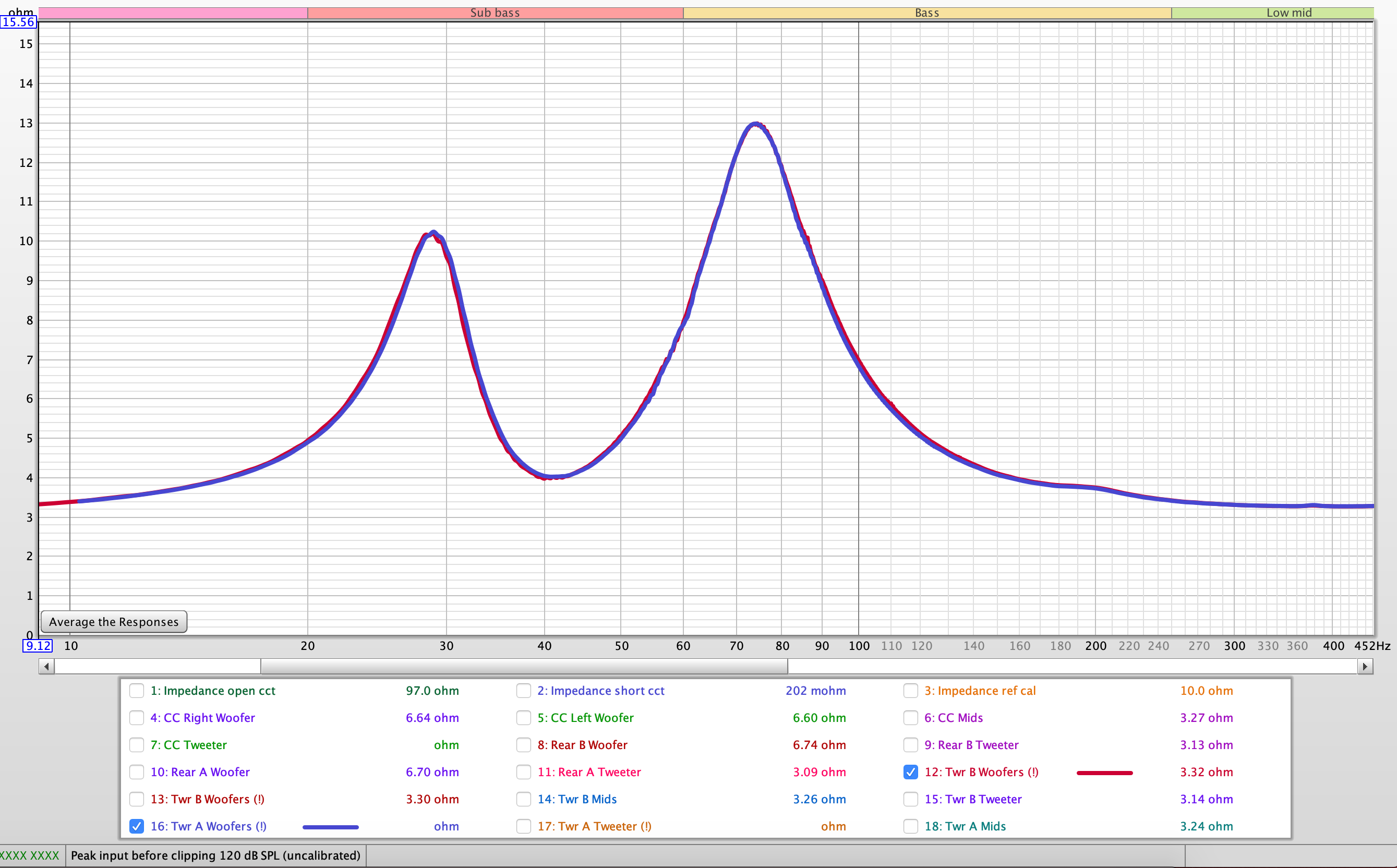

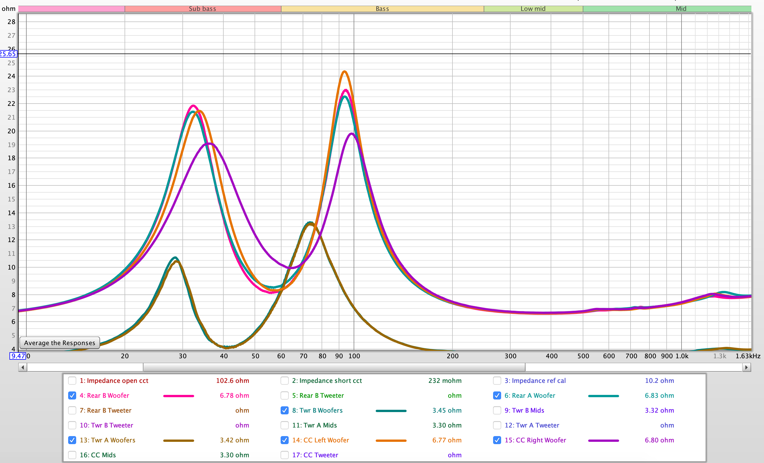

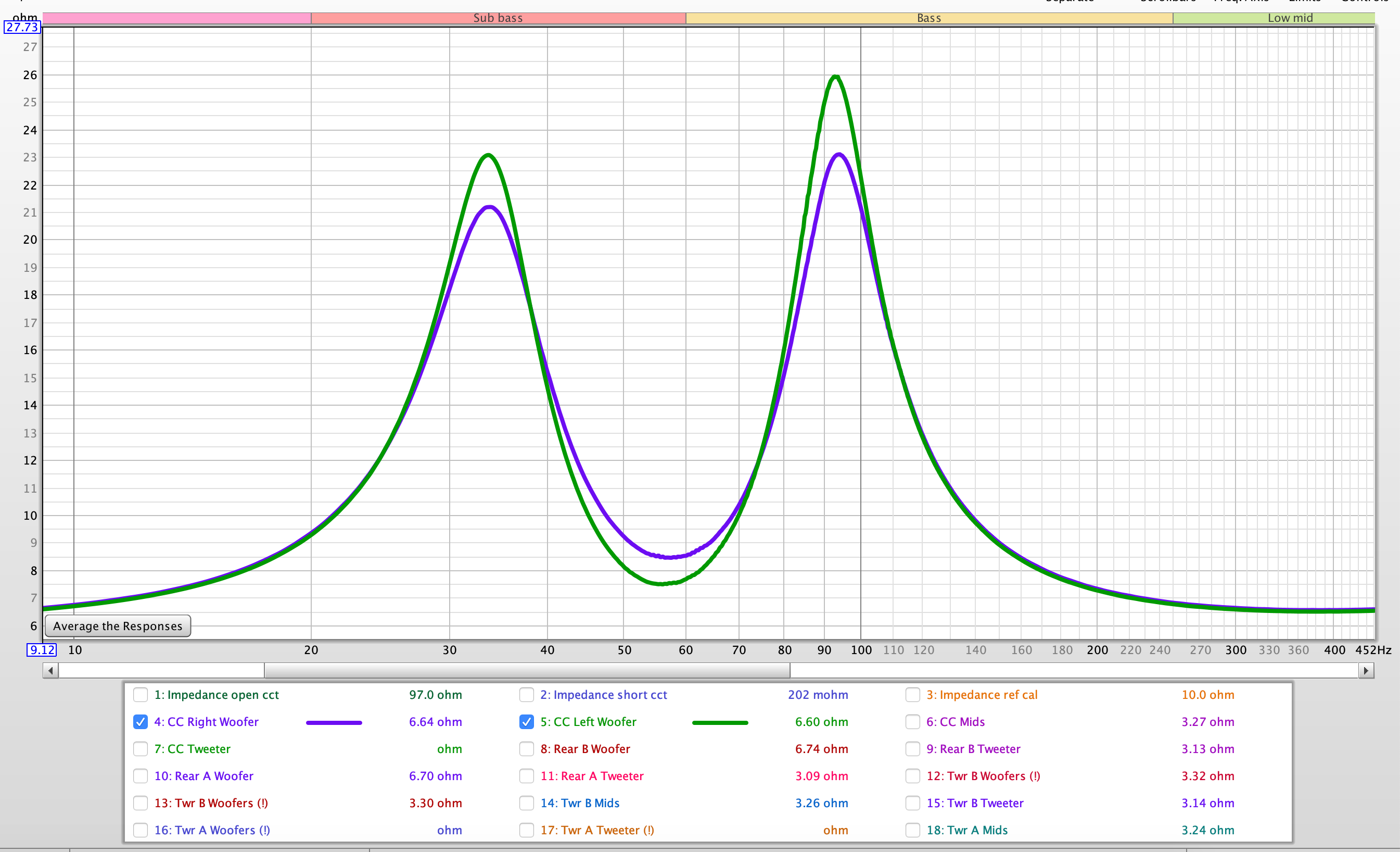

Capture 2: The woofers
These actually look pretty good except the CC right woofer. That one is like the lonely one out. Do not know about that.

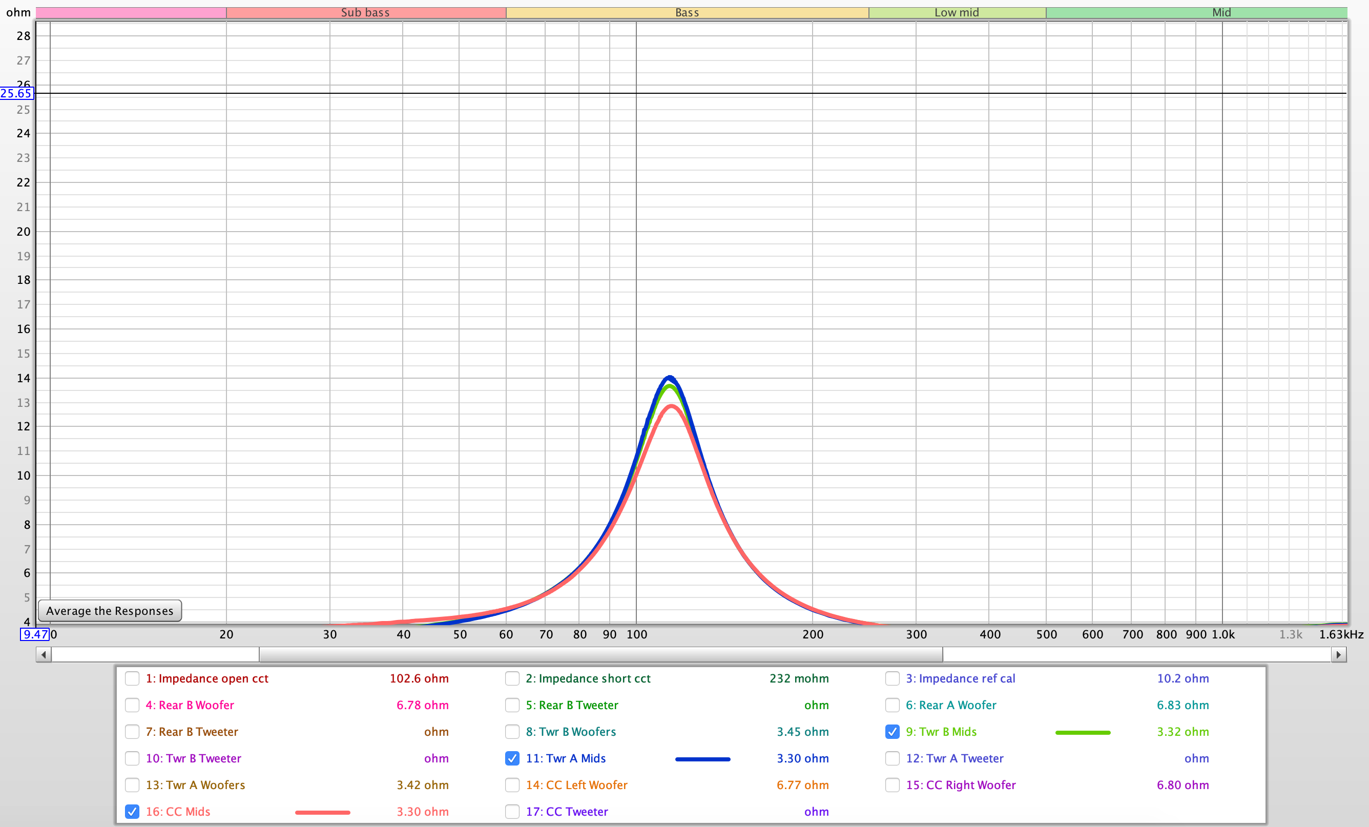

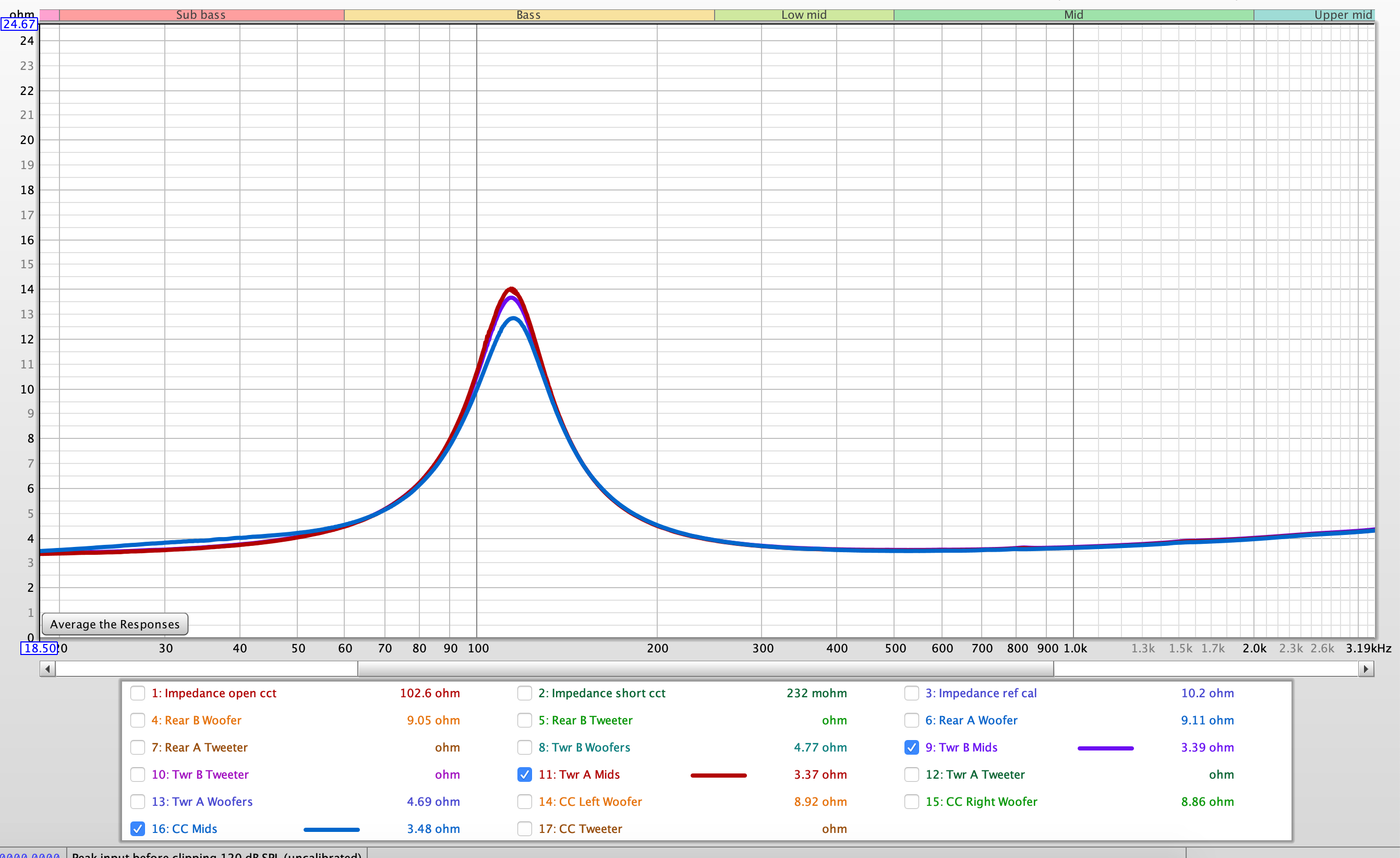

Capture 3: The mids
They look good and consistent to me.

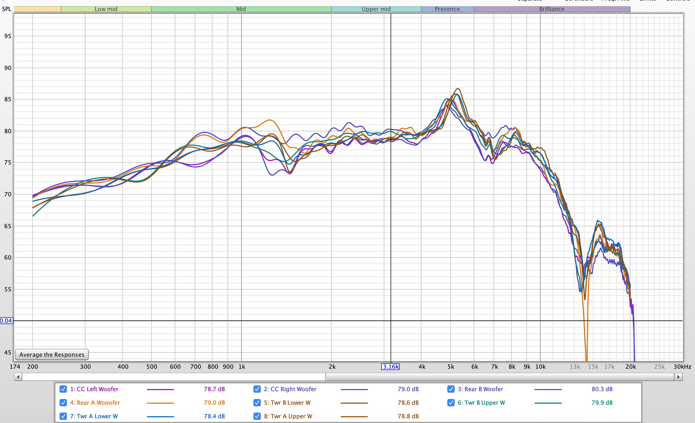

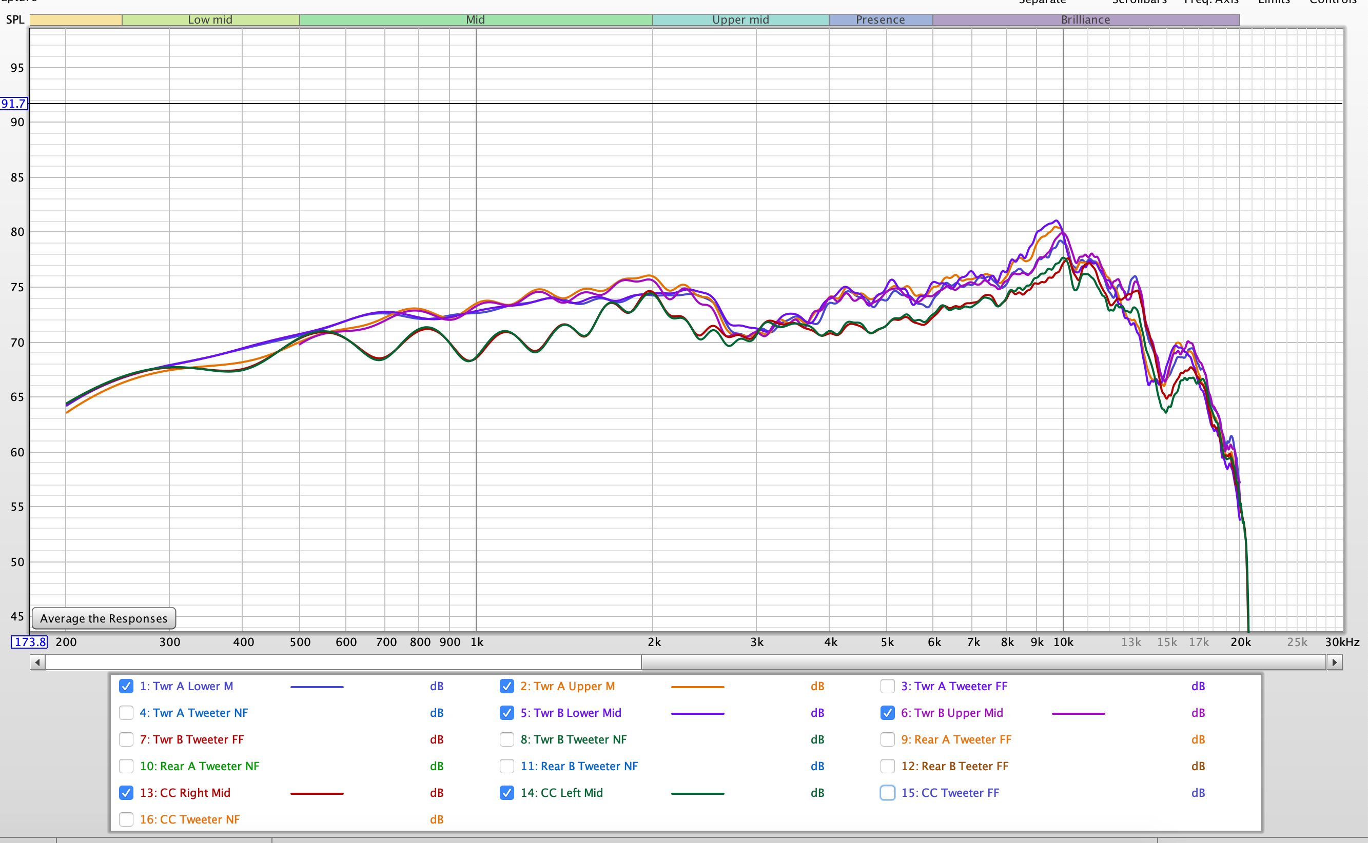

Alright I finished the FR testing and have screenshots for you!
Keep in mind I did forget to remember the volume my computer was at for the headphone out. So for right now, the dB on the CC measurements might be slightly off. For now, trying to look at the shape and curves to see how it matches.
Capture 1: The woofers
Honestly all pretty consistent with their given enclosure they are screwed to, I dont have much to say about those.
Capture 2: The mids
Once again they seem very consistent from each speaker and placement. Like both Upper Mids on the towers look that same, as well as lower. Also the CC mids look the same.

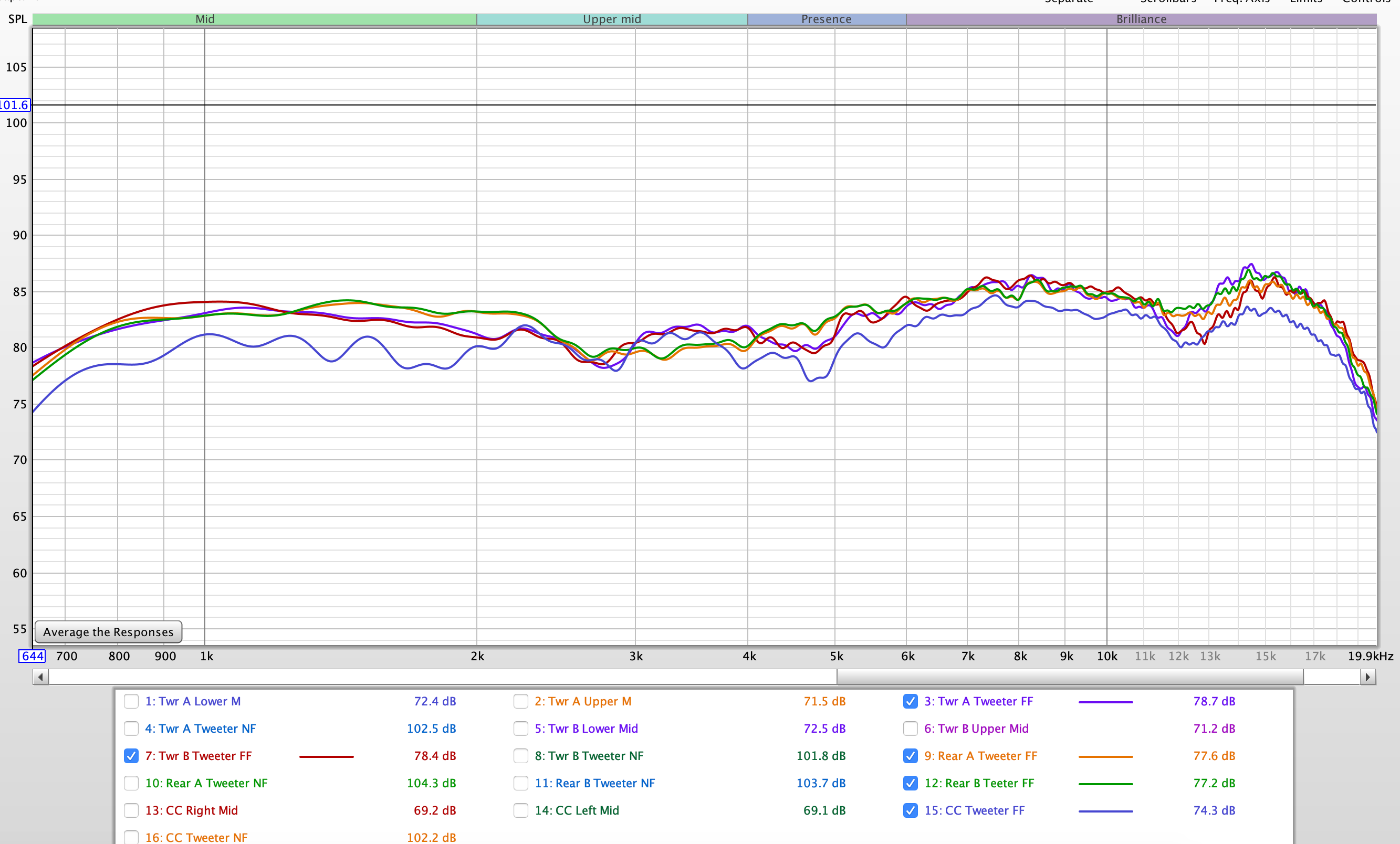

Capture 3: The tweeters FF
Honestly super small differences from what I can see. Looks good to me.

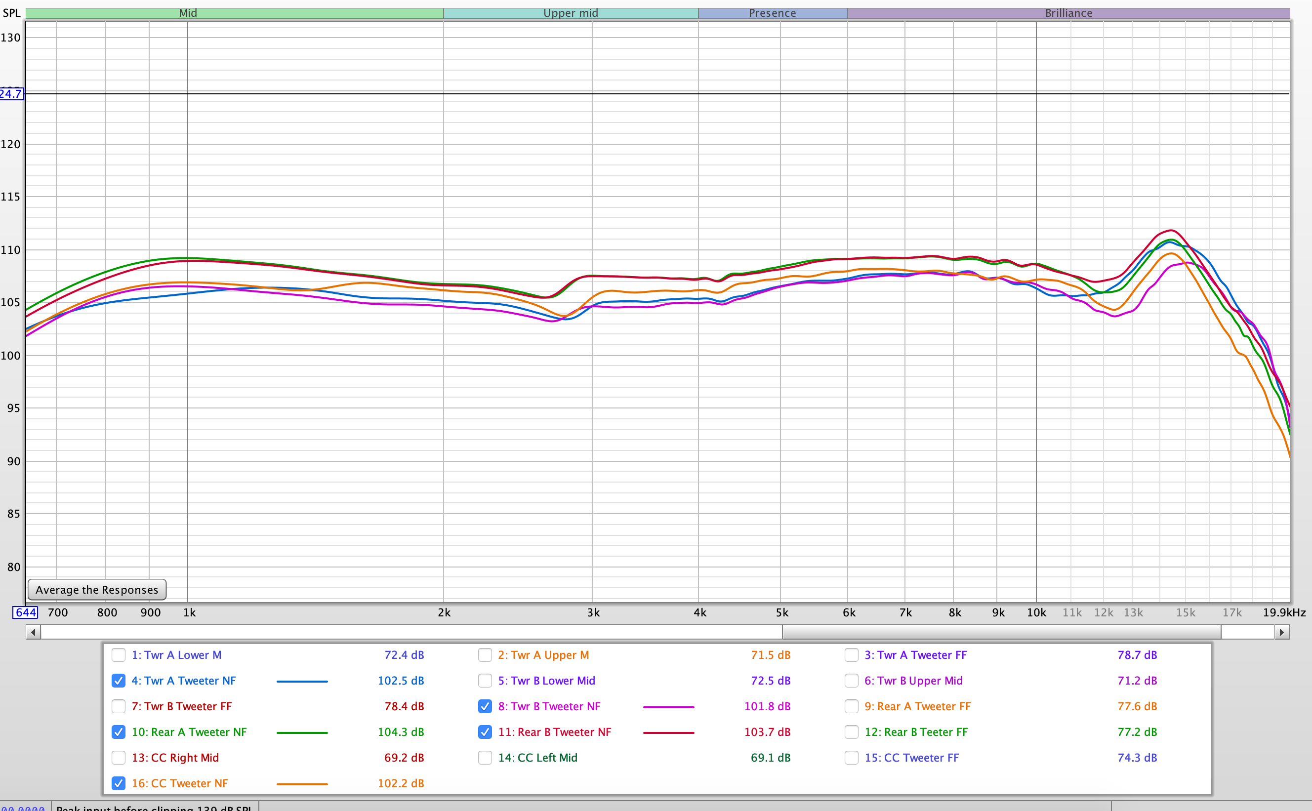

Capture 4: The tweeters NF
Same thing as before with the FF for me.
Lemme know whatcha think!

Just fyi about REW - you can change trace colors when the program is creating too many lines that are too similar in color. Click on the paintbrush icon in the left side smaller windows/boxes. And you can add or subtract dB from any trace if it helps for comparison's sake. Click the Control icon near the top right and manipulate the offset button. You can choose to permanently add this to the data file or not as well.
Looking at impedance, for the tweeters and mids I'm not too concerned by any small differences at the resonant peaks because those frequencies won't be in the passband. They'll be rolled off probably by at least 25-35dB by the xo's, maybe even a little bit more.
So for the tweeters, I'm more concerned about any differences from about 1200Hz and up (I'm assuming a xo point somewhere around 2500Hz) since it's the interaction between the xo and the driver's impedance which creates a change in the FR. So in that regard, the CC tweeter is already the outlier - impedance is sitting below all the others from about 1000Hz all the way up, albeit it is still just a small amount. The best matches look like tower A and rear B (you've got 2 tweeter Z's labeled rear B, I'm assuming the one with the lower ohm impedance peak is rear A) and I would put those up front in the 2 towers. Tower B and rear A tweeters would therefore go in the surrounds.
For the mids, I can't see the impedances above about 300Hz which is where you will be using them so it's hard for me to comment. But the FR's all look good and so I suspect the impedance do too.
For the woofers' impedance, first thing to note is that the valleys between peaks correspond to the tuning frequencies in ported alignments. So towers look to be tuned lower which is actually correct.
For that right CC woofer, you've got a higher tuning frequency for some reason. Could be a result of a woofer with a different resonant frequency than the rest or it could be the result of some kind of difference in any factor that affects vented tuning, ie. box volume, port length/width, amount of stuffing or possible air leakage. If any of those are different than the right CC chamber that may account for that impedance anomaly.
Otherwise the woofers look fine for matching in the 3-ways (although to be honest, NF measurements of the woofers are needed for the best accuracy there) but for the 2-ways I would still just try to match those 2 up a little better between 1000-3000Hz. Granted it is a little hard to find a good match due to different baffle diffraction effects but I think there is a better match than what you've got right now. It's a bit difficult for me with so many lines on 1 graph but you can turn them on and off in REW and should be able to match something up better than the current ones I would think.
I actually did change the colors of the traces so you could see it better, but yeah it is pretty populated.
And yeah seems like we got the same idea on which tweeters to move around. And yeah thats my bad about two Rear Bs. The more closely matched one is Rear A.
So actually the two best matches are Tower B and Rear A.
As far as the right woofer in the CC, I really do not know what is going on. I looked back at my old testing and it wasnt that off. The ports length and everything about each chamber is exactly the same, I made sure to take extra detail to that. But I will open it up and see whats up, cuz there could very well be a part of the absorption that feel close to the woofer or something. Ill take a look for sure.
Also my bad about the mids impedance screenshot, I included a new one.

So I looked at the FR in REW, looking at the factors I know and the ones you have suggested. There seems to be no large differences in FR between all the drivers in their respective speaker and location. The only slightly off thing are the woofers in the rears. Like you said, I would want to try and match them close also up to 3kHz. Which the actually do, the only difference is from 1.1kHz to 1.4kHz they are off in gain and shape. But, all the other drivers pair so well together that this does not seem like the biggest deal to me. Also, I could have been slightly off axis for one of the rear FR measurements. But overall, it seems really good.
So, the only thing I need to do is swap the tweeters in Rear A and Tower A.

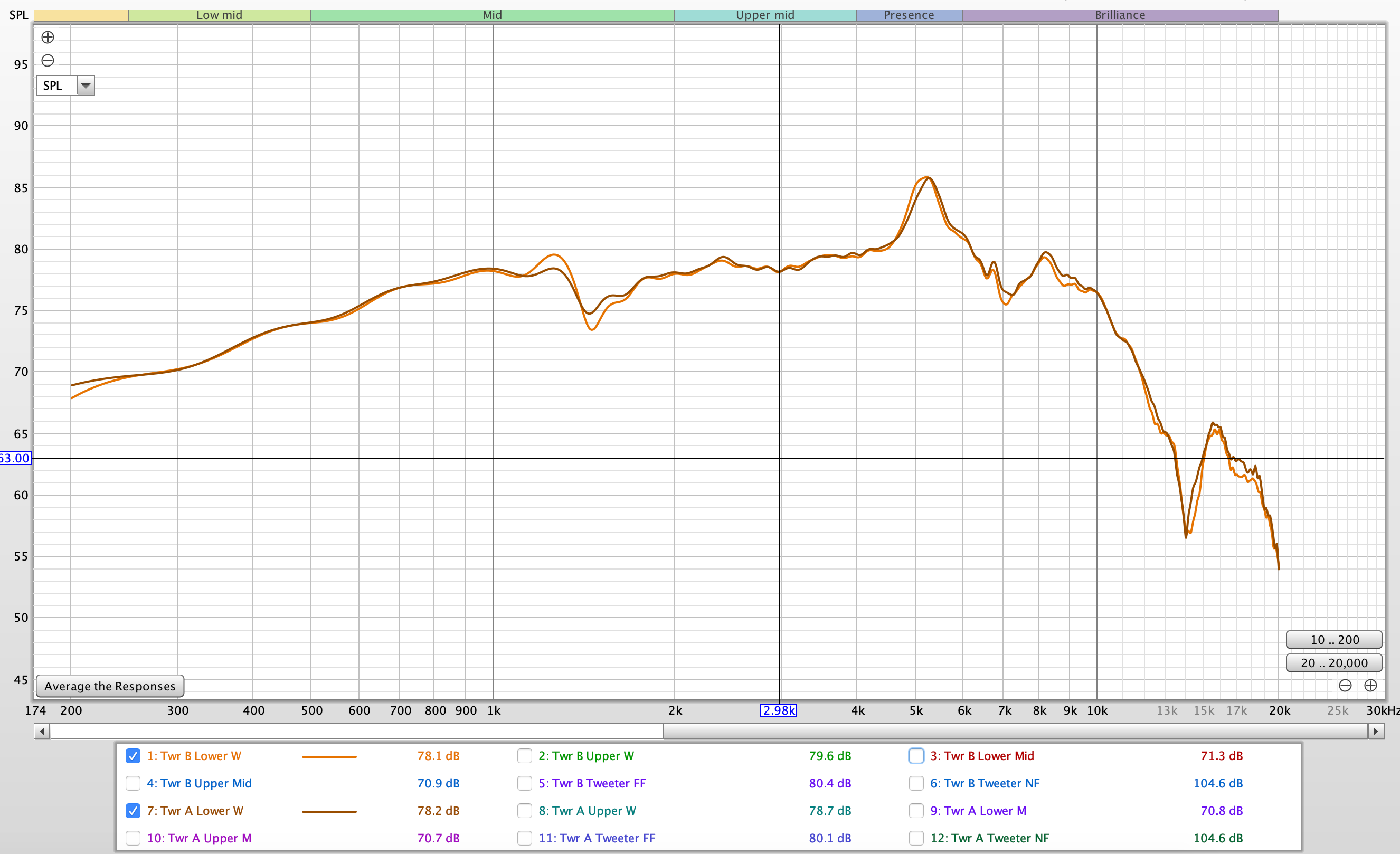

I made for damn sure that the tweeters in Rear A and Tower A were switched. So that Tower A got a more closely paired tweeter to Tower B.
But as you can see in my first screenshot, that didnt happen from the tests I just took. I mean how can that happen?? I literally switched them around and I am still getting the same responses as before.
Also, the woofers in the towers are not giving my trouble. From my second screenshot they look pretty fine. That is only because that is the Average of about 5 different tests I did that looked really shaky. Which looked exactly as if I had an air leak, which I did when I first tested these earlier in the week. But I noticed it was the screw on back to the speaker and I fixed it. After that the results were good. But somehow now Im getting shaky results when all I did was change out the lower woofer?? So weird...
I even spent extra time fixing any worn out screw holes for a tight fit and double checked every screw to make sure they were all hand-tightened as can be. I also didnt take the backs off at all.
Just ODD!!!
