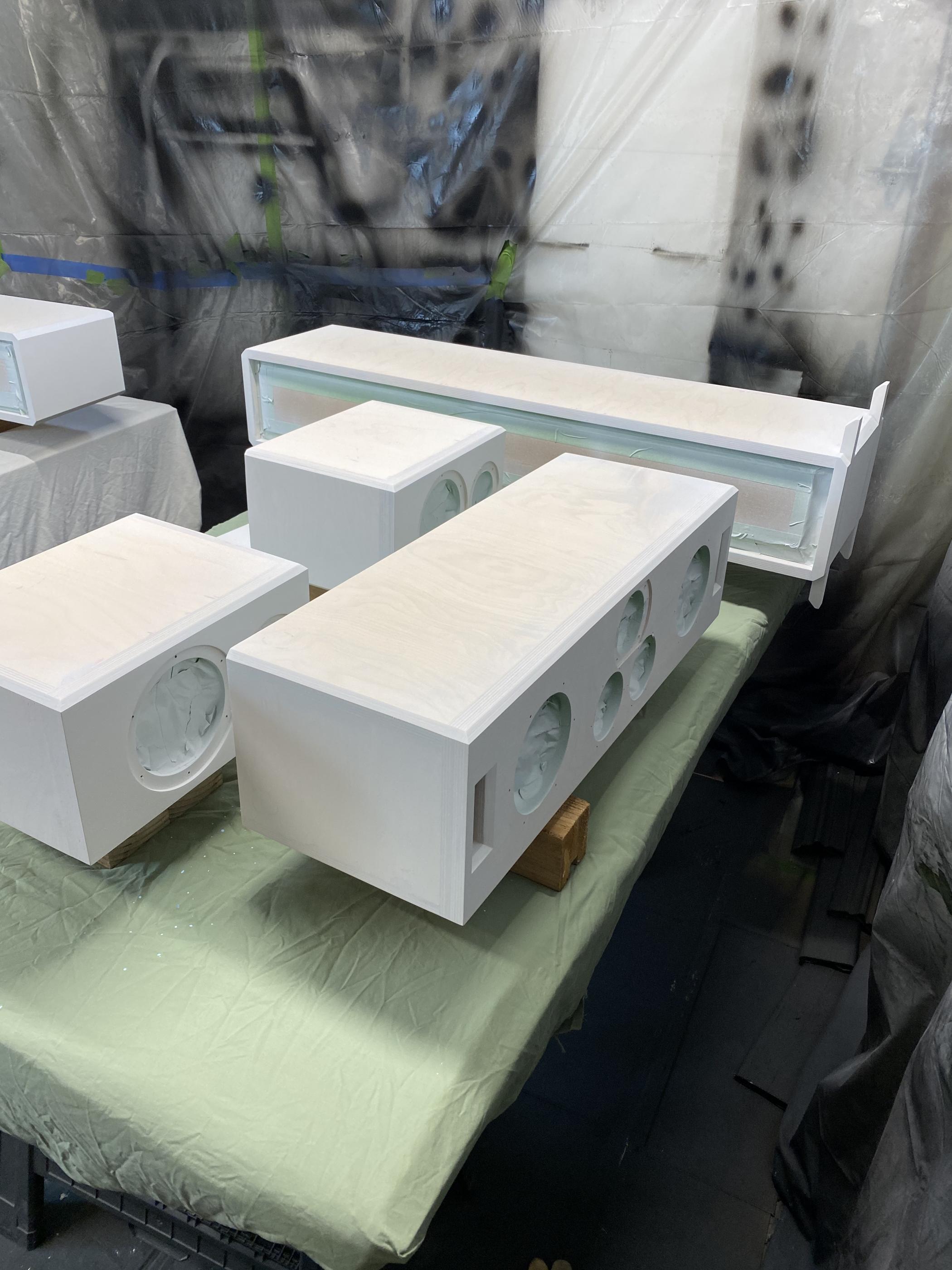

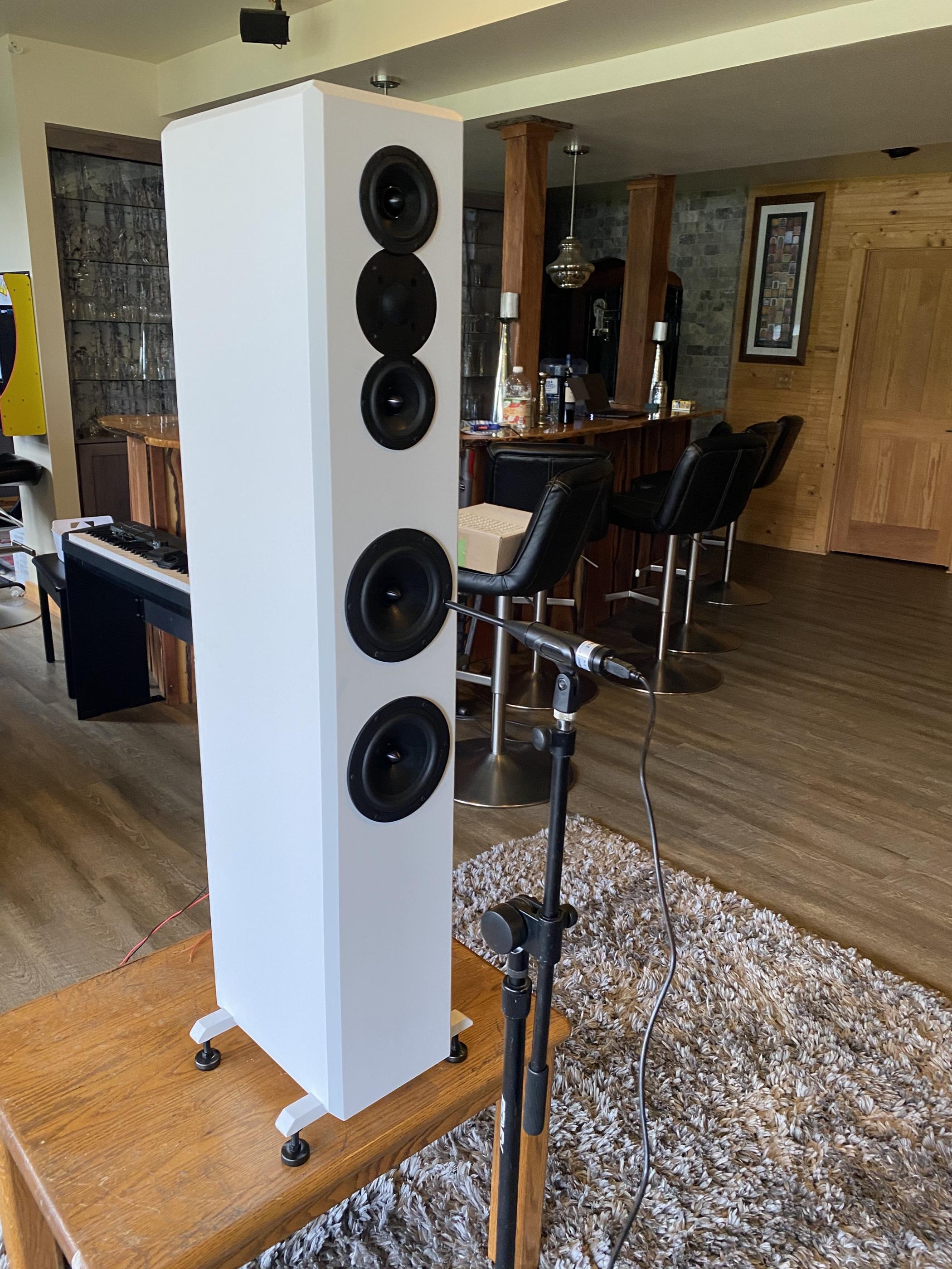

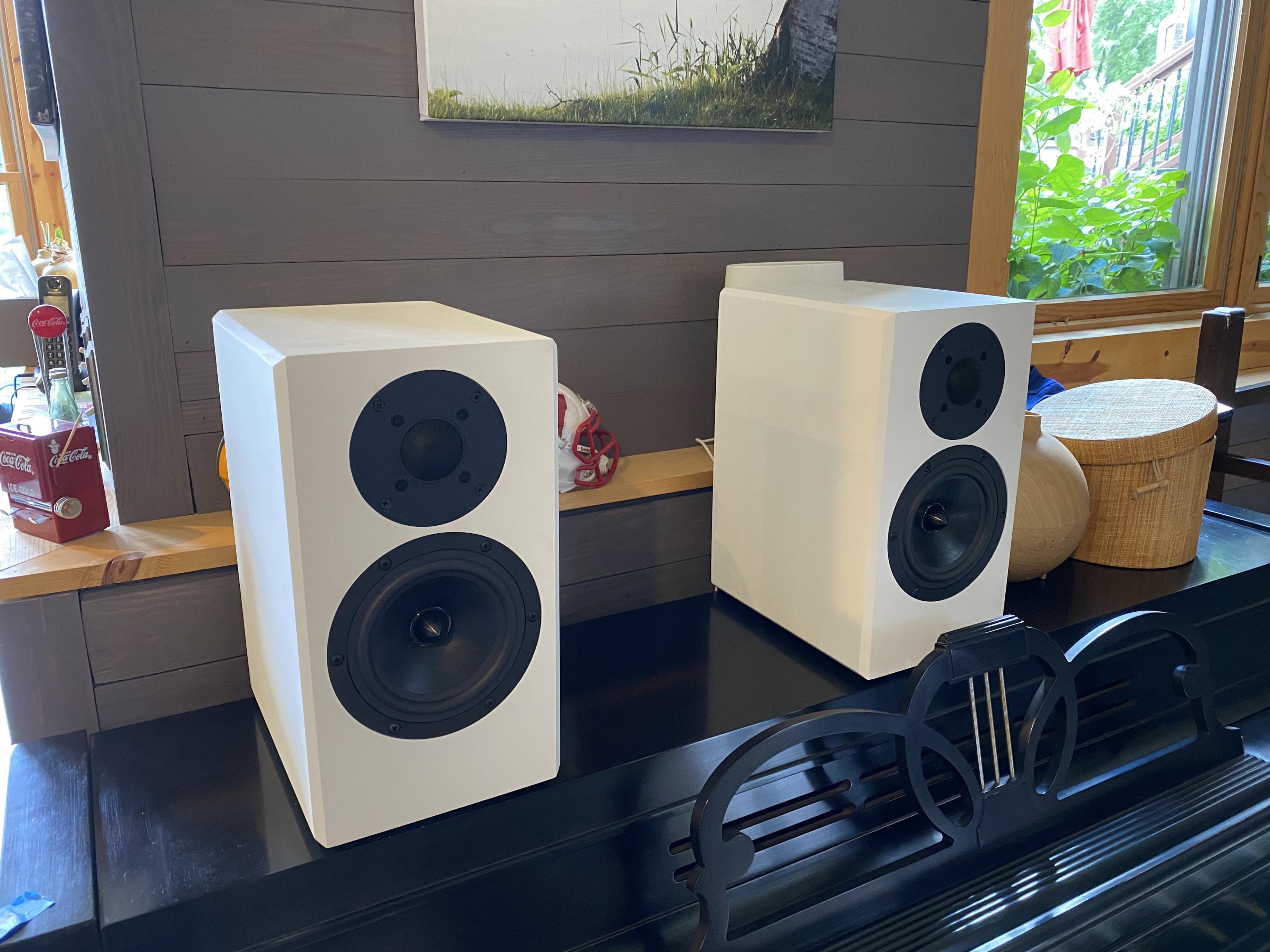

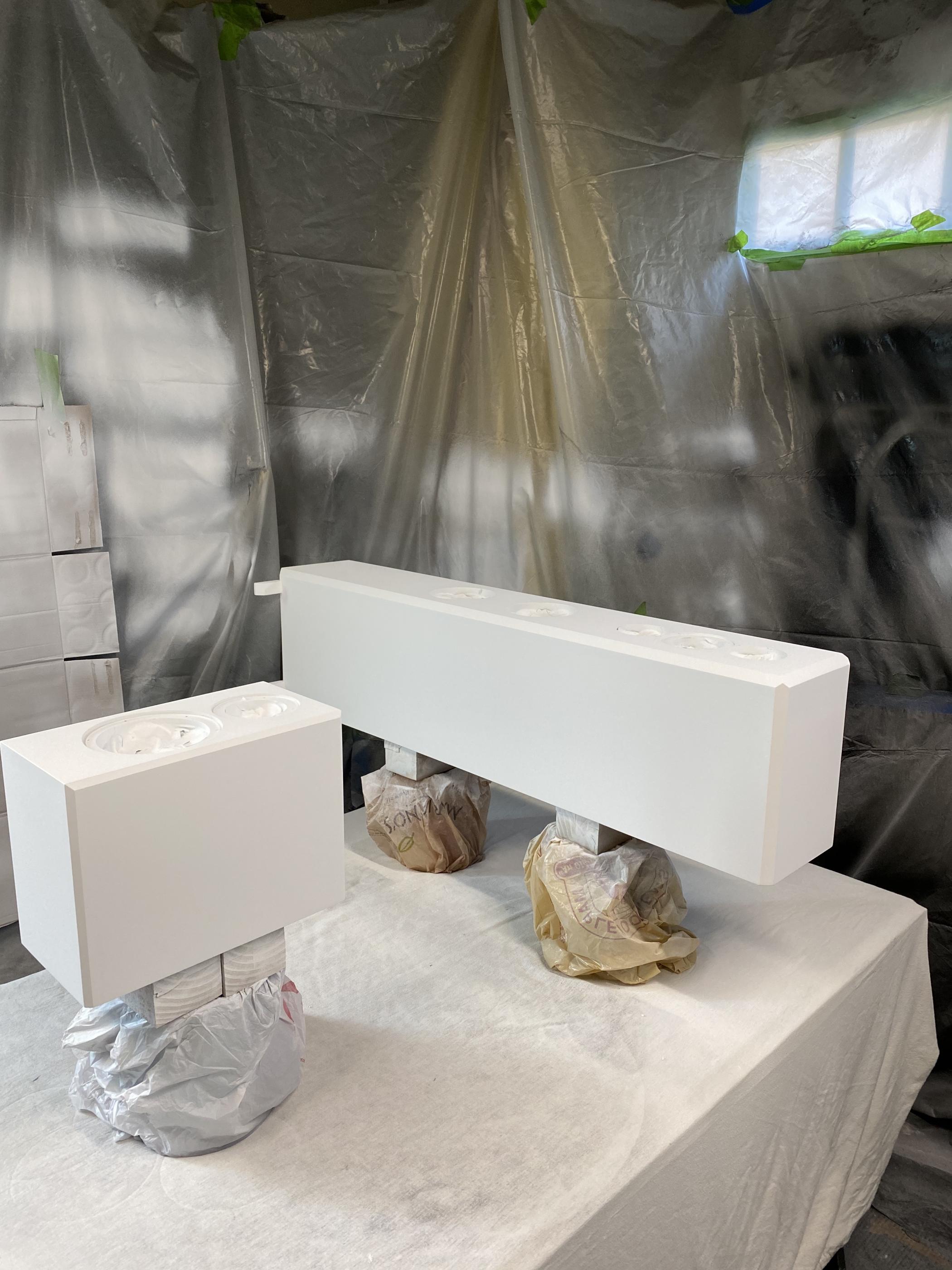

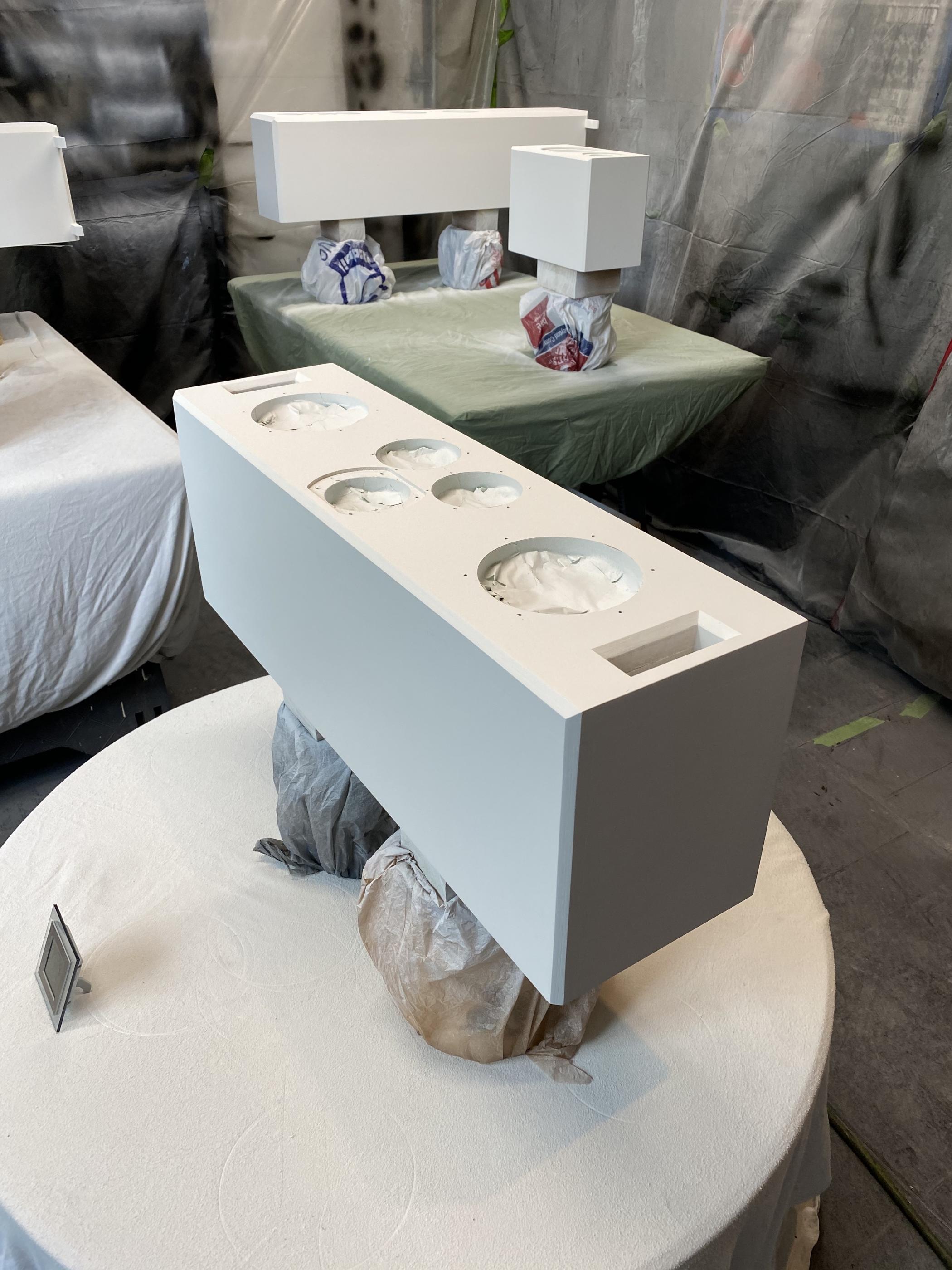

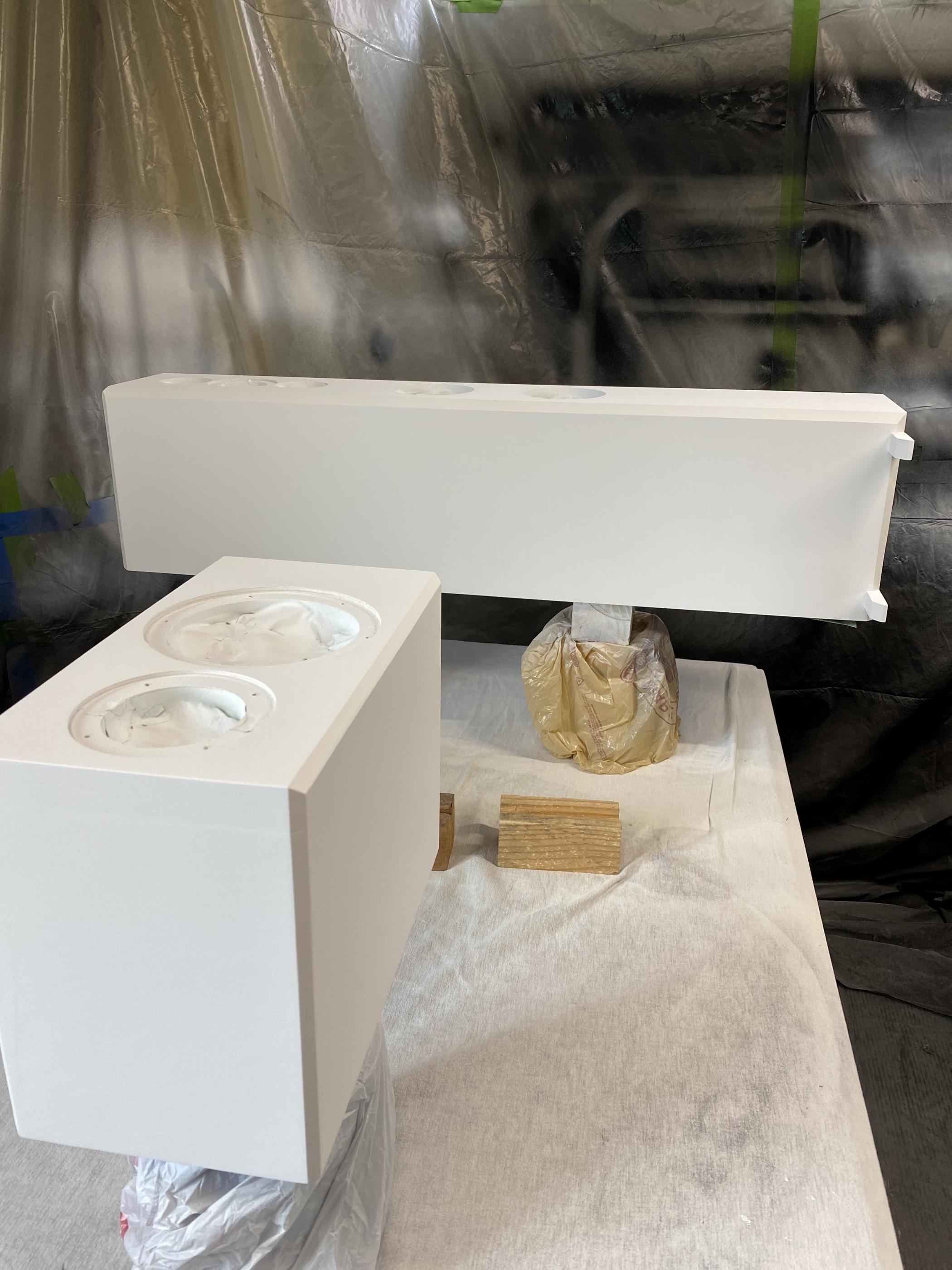

I have finally got the speakers painted and am now back into the testing phase! Within the next couple days I hope to get back to you on my results, I gotta look over everything again and make sure I am doing it right.
But here are a couple pictures from the progress!
I am excited to dive back into the final stages!
Oh very nicely done, although I have to admit that I was not expecting white.

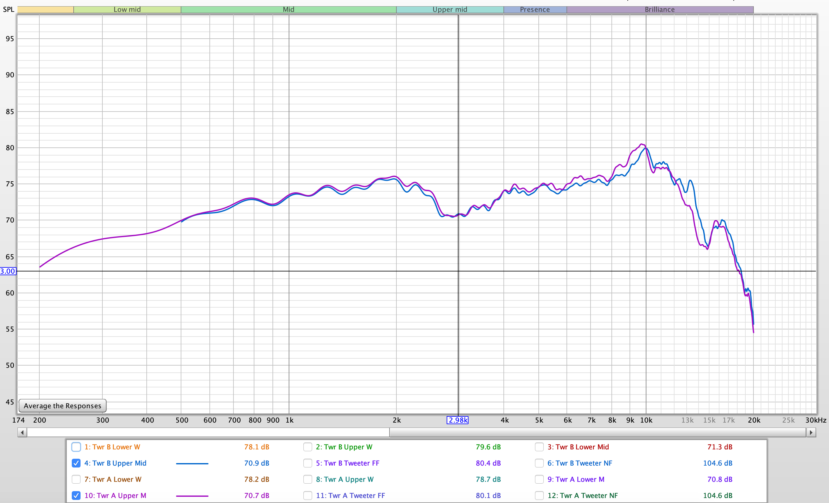

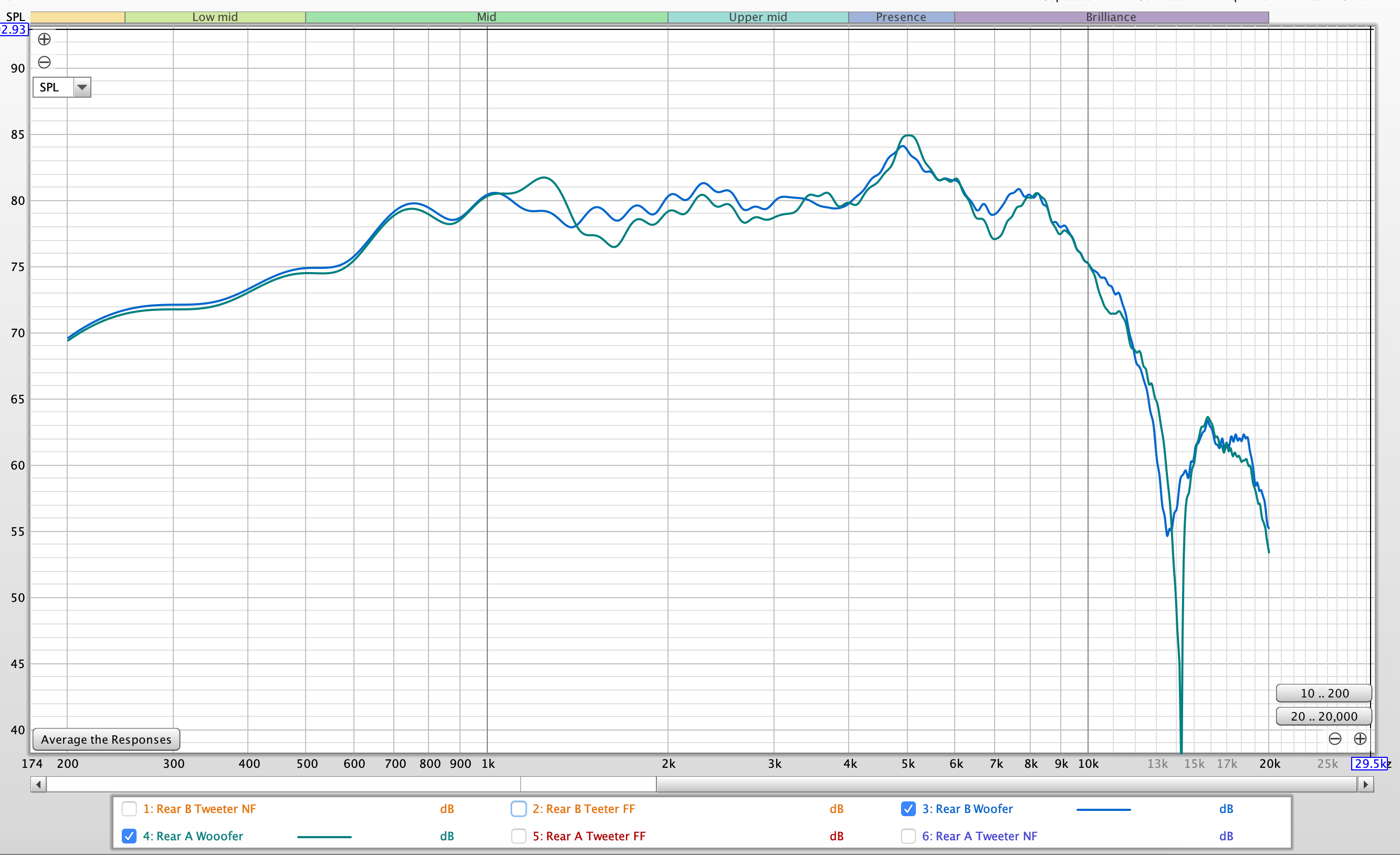

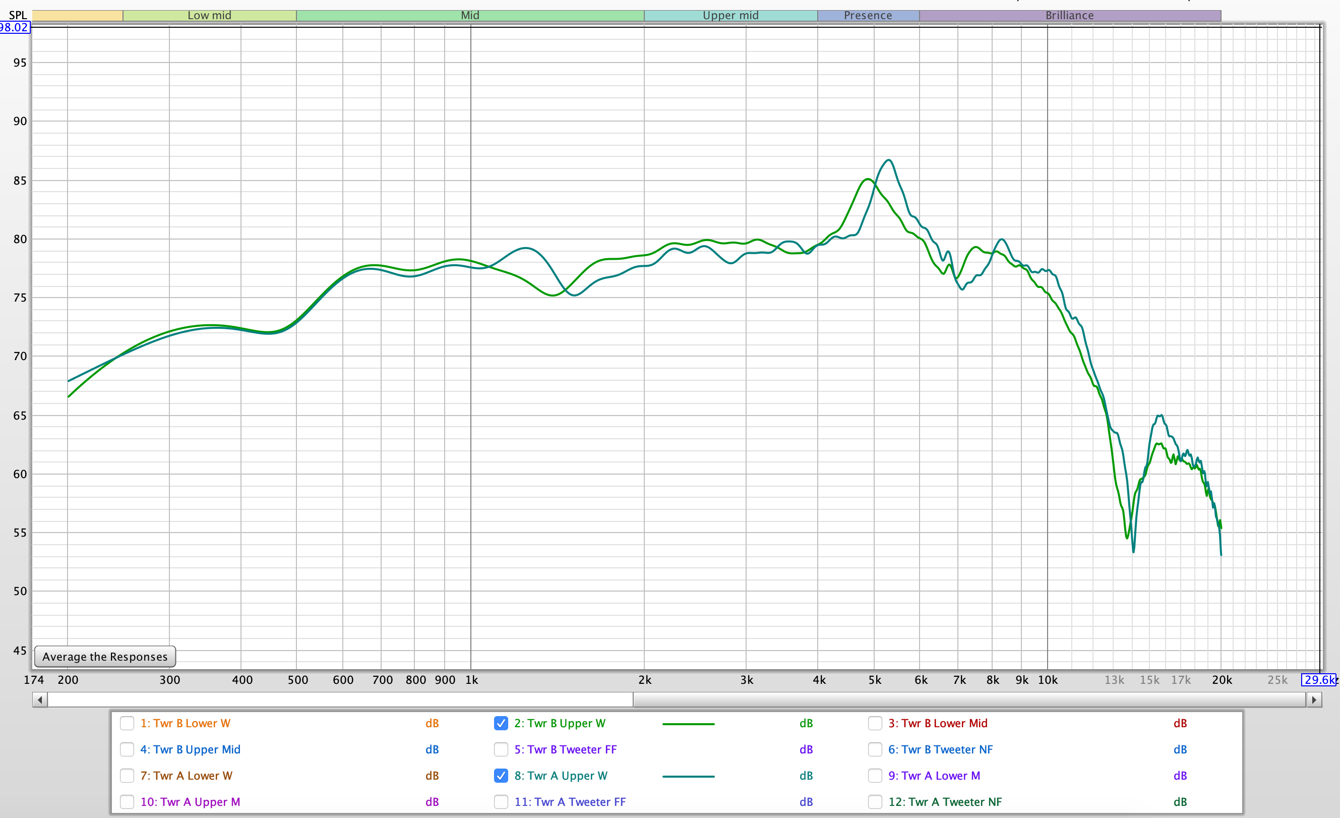

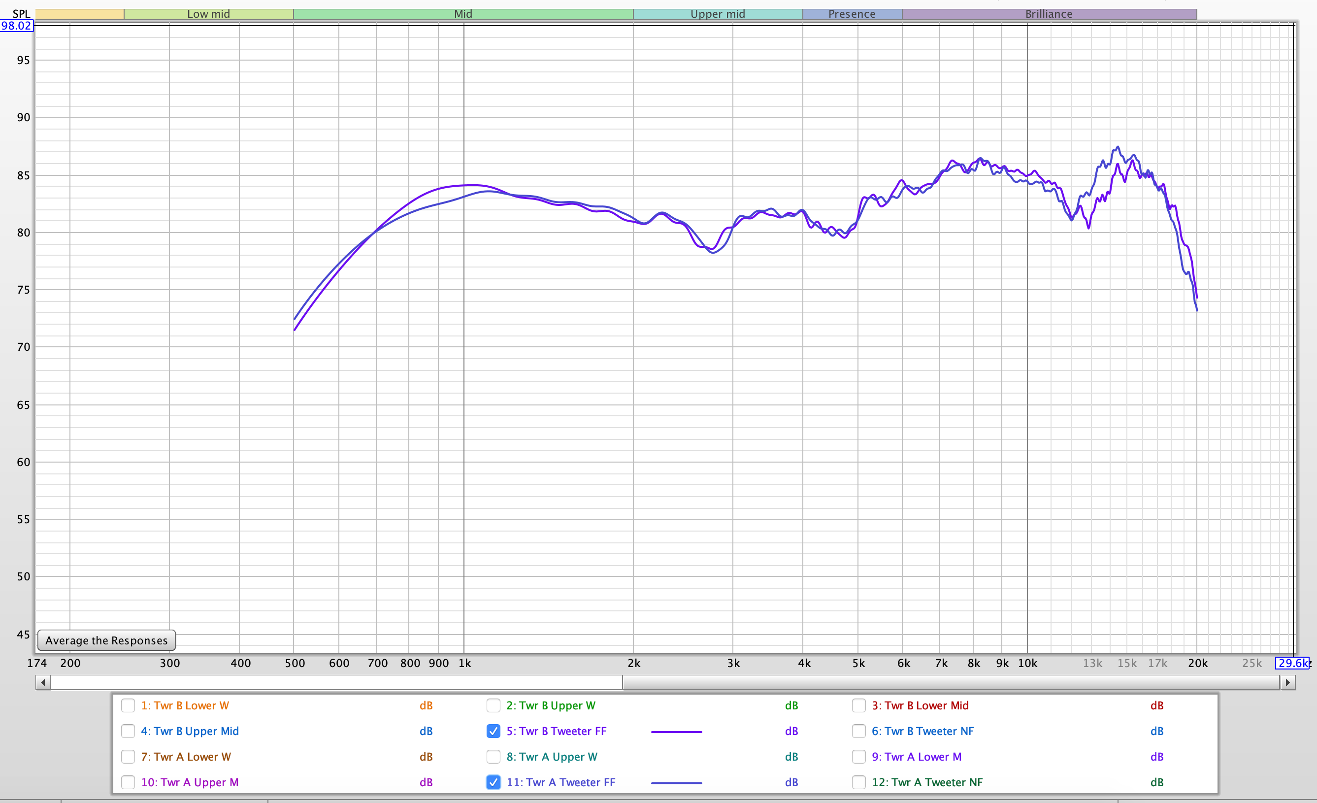

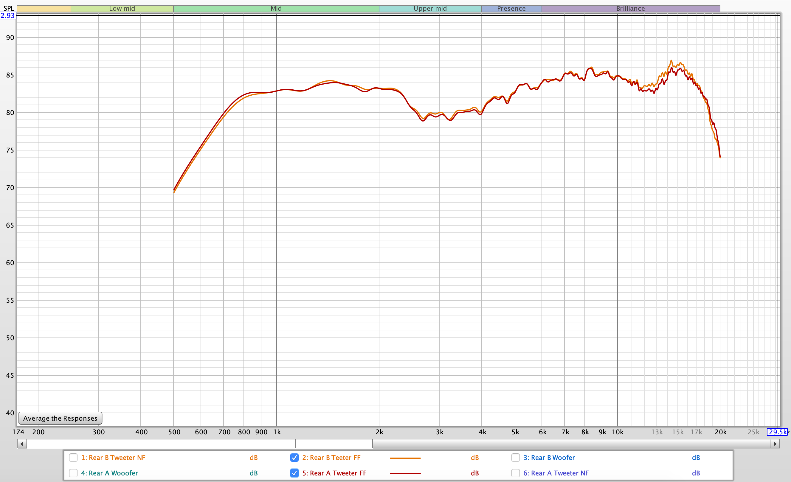

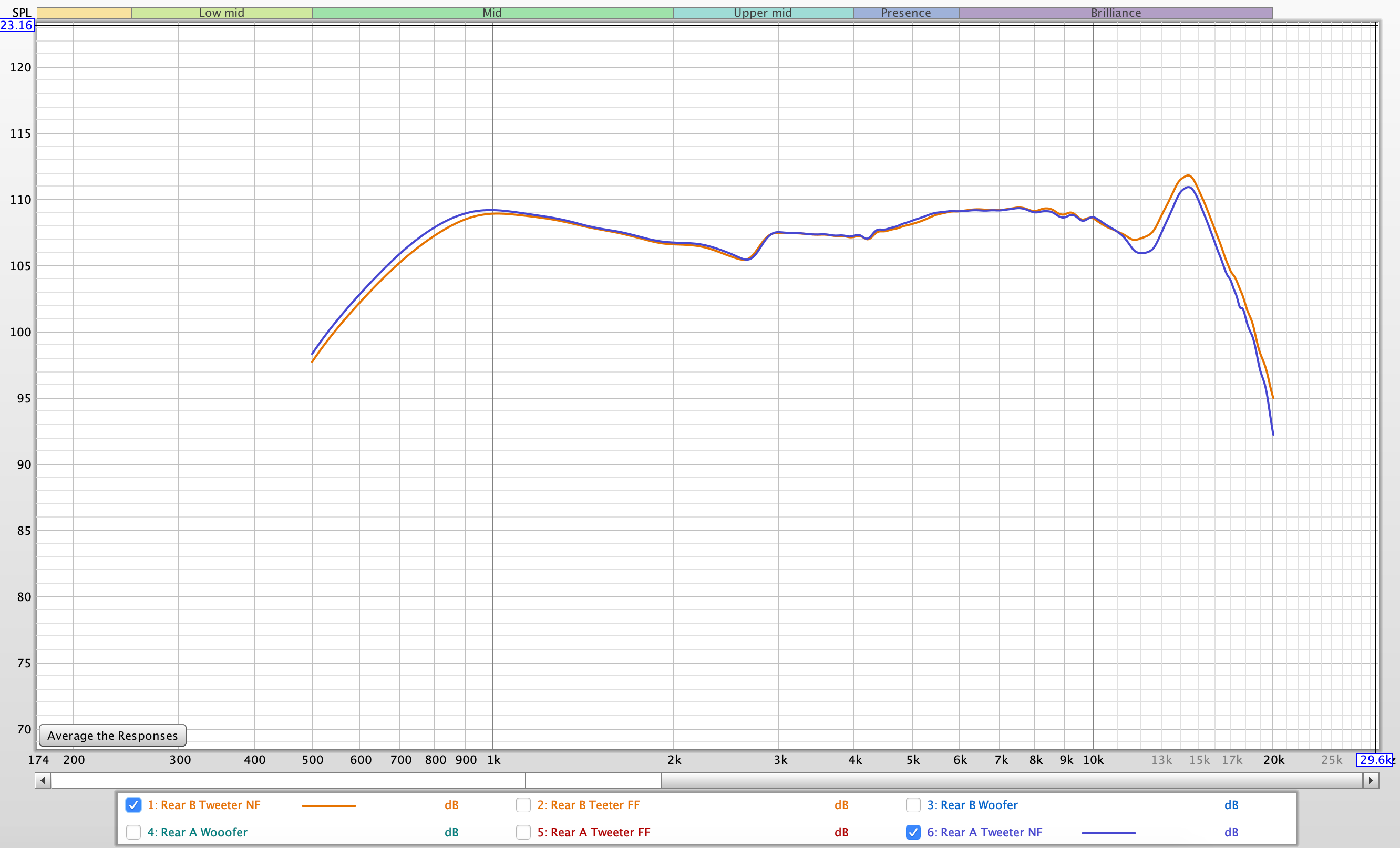

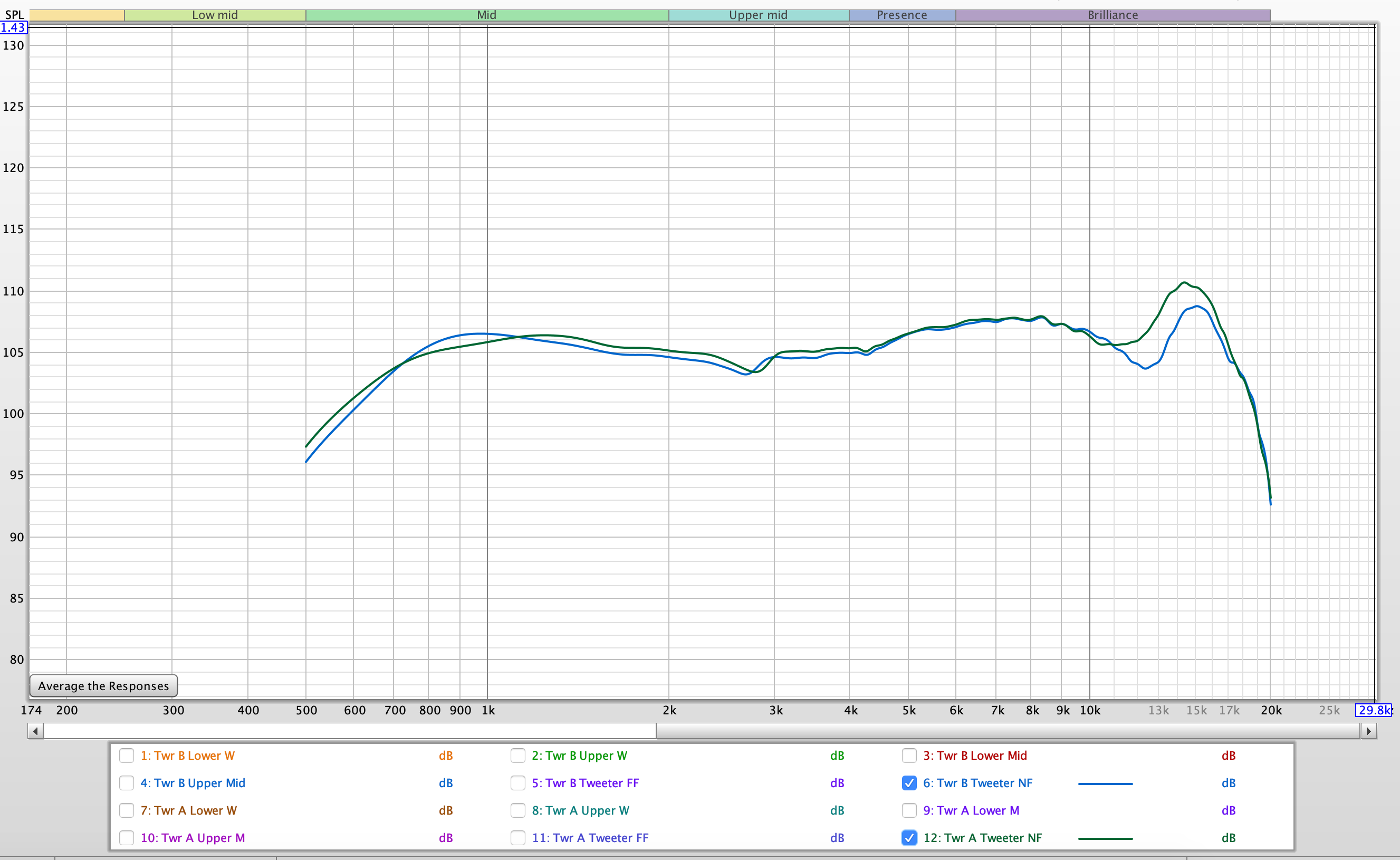

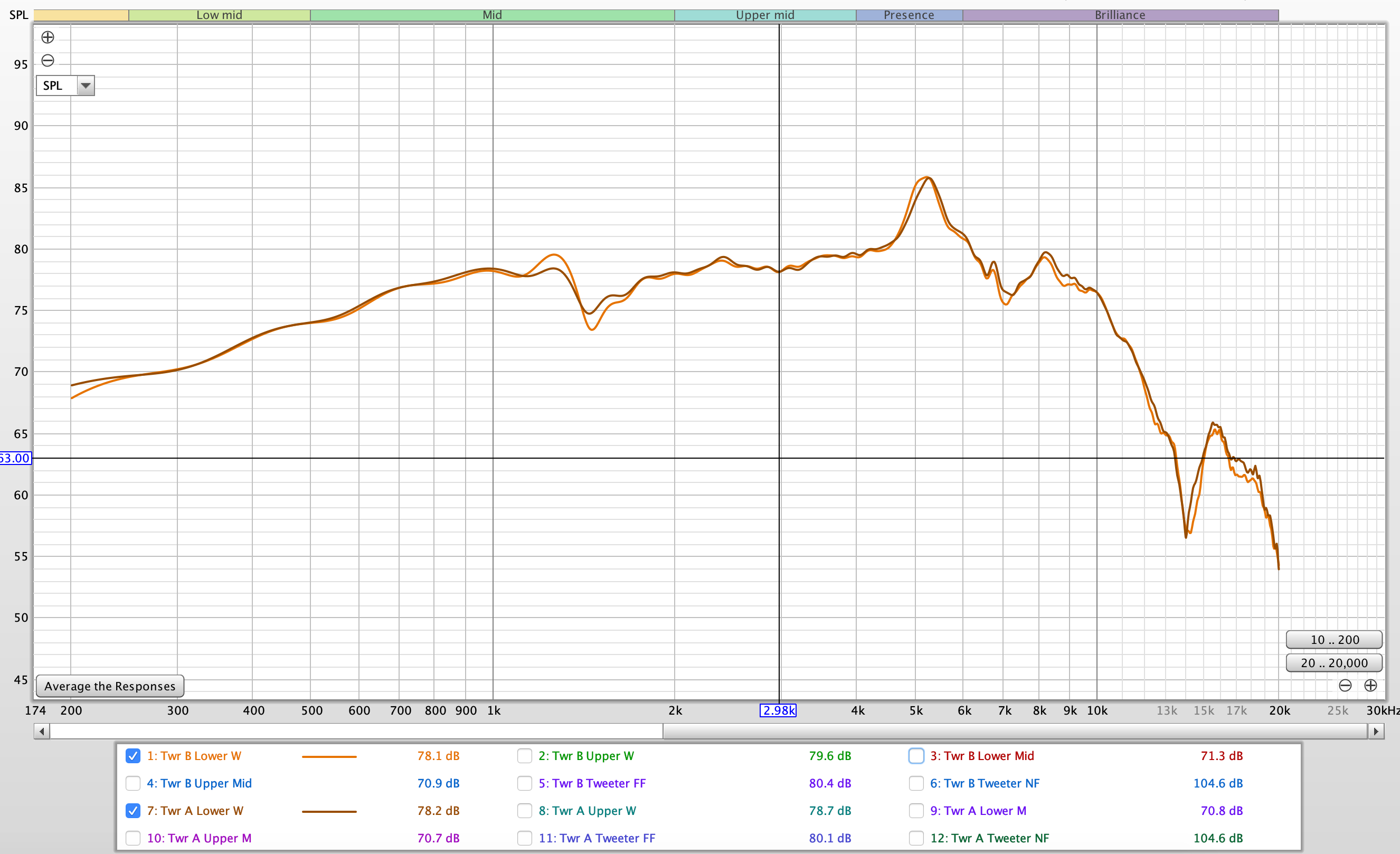

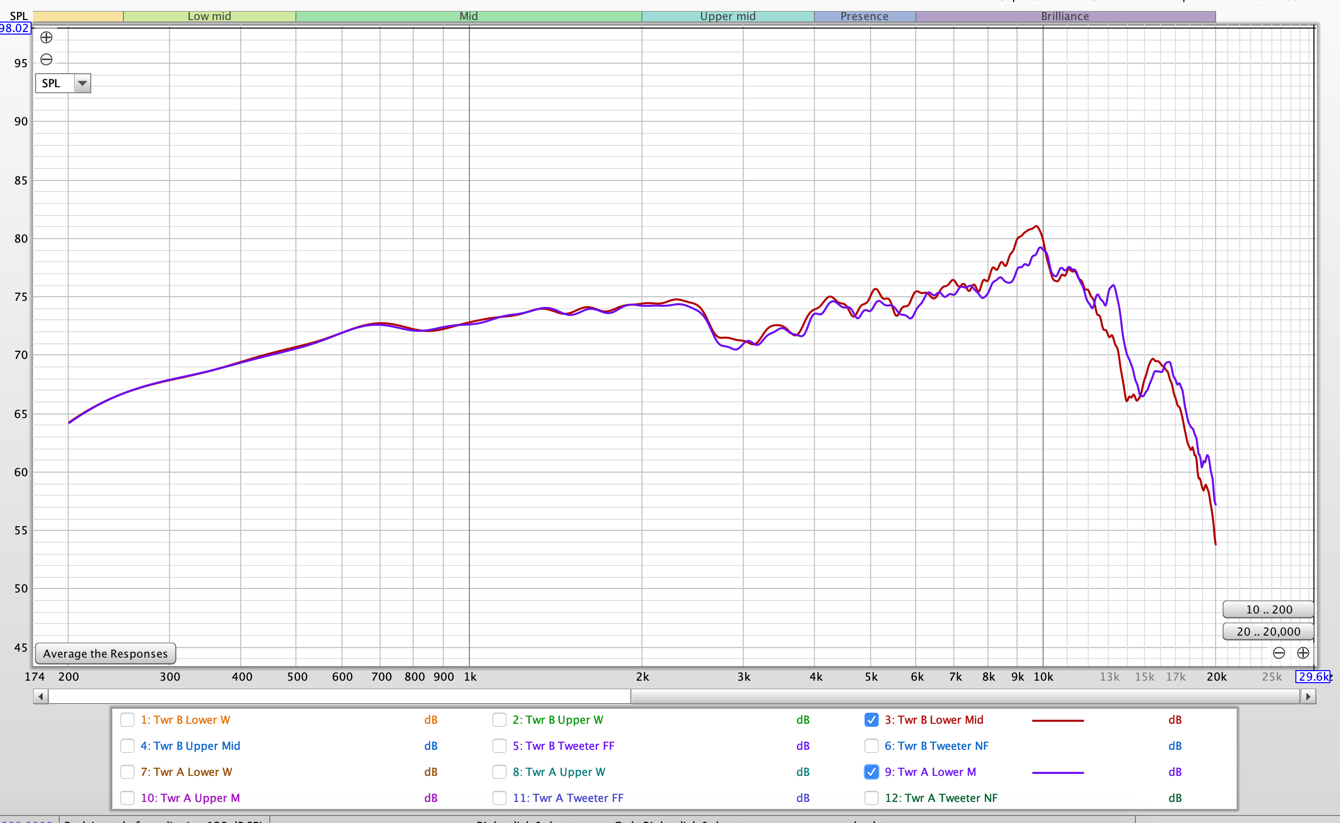

I did the FF measurements for both the rears and the towers. Also the NF of the tweeters to check that out. I have to go do some chores and other things right now. Hopefully I can get back today to do the impedance responses as well as the center measurements.
For right now tho, here are the screen captures of the FR's of each respective driver on the matching pairs of speakers. (ex. the lower woofer of Tower A with the lower woofer of Tower B)
The labels for what you are looking at are on the bottom of the screen captures. I just wanted to put these here so you can take a look if you'd like.
These are my respective lengths I measured at, according to that white paper you sent me a while back:
Towers:
- Woofers: 18" away
- Mids: 16" away
- Tweeter: 16" away
Rears:
- Woofer: 16" away
- Tweeter: 16" away
Please let me know if the lengths look good to you.
Note: The baffle step was not incorporated into these measurements, these are just the raw measurements from REW.

I'm pressed for time today but I do want to say - finally, look at that consistency in your tweeter measurements!!!! That's 4 out of 5 that are looking good. What a relief.
I'll look at them in more detail tomorrow.

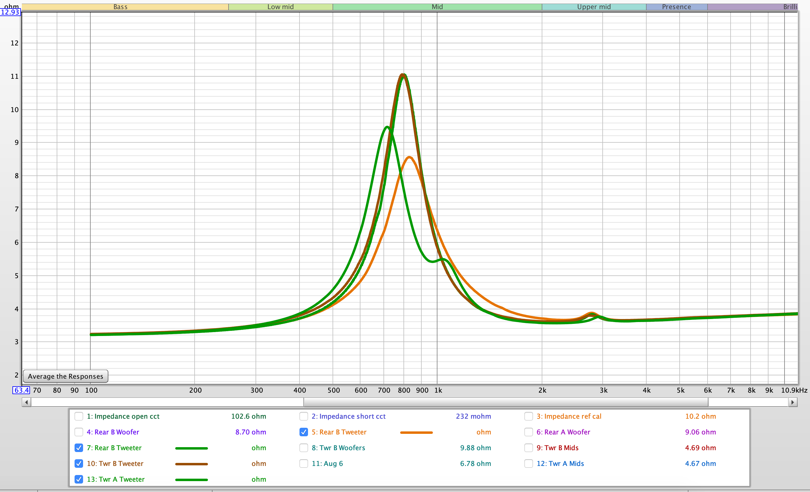

Yeah the FRs are looking nice. But I am pissed because I just did impedance tests on my tweeters and this is my result.
Fyi, all other impedance tests are looking consistent atleast. But yet AGAIN! the tweeters are just weird.
Could this possibly be due to when I solder on the wires? I know good soldering practices and am quite good at it. Yet soldering on the inside of the pin sometimes requires a little more time to make sure the wire is in the right spot, but not much more time. Do you possibly think that soldering could somehow hurt the tweeters to this extent?
I should probably wait to see the CC driver measurements before making any suggestions but here's a couple of preliminary ones anyways:
Woofers:
- lower tower W's look good
- upper tower and rear W's look to have a similar small discrepancy
- for the towers in a 3-way where only the lower frequencies are being used, I wouldn't worry about the W differences you're seeing
- but for the rears where the xo is going to be much higher, you want a better match through the midrange if possible
- so I might try matching the tower B upper W with the rear B Woofer together for the rear woofers. Maybe see if those 2 measure any more similar below about 3kHz when they are on the same baffle. Or maybe the alternate pair, the tower A upper W and the rear A Woofer.
Both sets of mids show good similarity in the crucial midrange region.
Tweeter FR's are matching well with small differences down near resonance and up above 10kHz. Impedance measurements are a little more variable but don't freak out over them. They still look workable. This is why I wanted you to go through this little process because these kinds of small inconsistencies are not unusual. Right now you've got 2 tweeter Z's that match well, 1 that's off a little and then 1 that's fairly different (rear B). That latter one is asking right now to be used separately in the CC but again we need to see how the current CC tweeter measures too. Hopefully it will be closer to the others. Maybe you might try matching tweeters so that the small differences between pairs above about 10kHz are reduced. Again let's see what the last set of measurements show us first.

Okay thats good to hear, the tweeters being off feels like I'm back to where I was 4 months ago haha. But yeah Ill get the CC measurements today and get back to you!
For the impedance measurements I am trying to find a 0.5% tolerance 100ohm resistor. I cannot find one with 5 minutes of googling and looking around. Do you have any place you buy yours?
