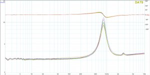

Also, I am curious. So, with the FR tests. Yesterday at the end of the day I took measurements for one of the tower. I had the mic at the height of the tweeter, 25in away. I also had the tower on this padded wooden box I found which I also stuffed with pillows so that it did not resonate much, if at all.
Without touching anything but the connections to the output, I took the measurements of all the speakers individually and then the pairs of WT(top), WT(bottom), MT(top), and MT(bottom).
So, the individual measurements for both the woofers just look weird, of course because it is off axis.

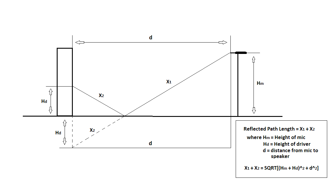

* I posted a formula for the reflected pathway length the other day which I discovered today wasn't quite the right one. That formula gave you the direct path length between 2 points instead of the reflected one . The correct formula for the reflected pathlength (RP) if you are interested is as follows:
RP = SQRT[(Hm + Hd)^2 + d^2]
A more explanatory diagram is attached below.

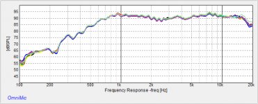

So, they sent me screenshot of what they got, attached below.
Everything seems to be in order for them. So, they think it is my baffle design, room reflections, or test procedure that it making me have inaccurate results. Which is odd, everything seemed to be in order.
One thing I did forget to do is break them in, so I will do that today and see if things change.

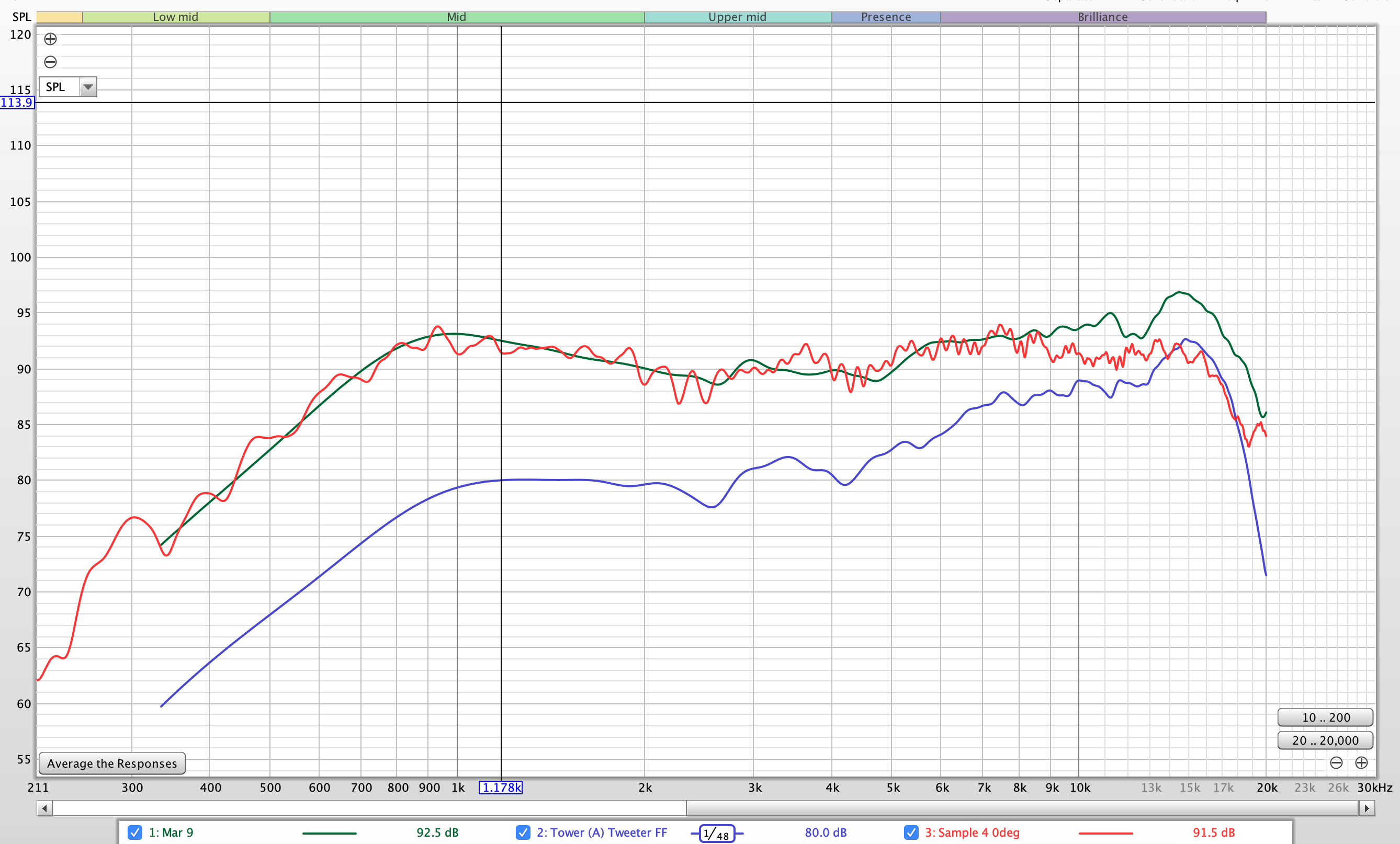

So after a week out of town, I am back to it and I have the new tweeters.
Yet, unfortunately I am getting similar results. The screen capture is attached below.
The green trace is what I just measured. The blue trace is the measurements from before. The red trace is the .frd file I got from PE.
The comparison seems to be good until around 9kHz. I do not know what is going on, but maybe my mic isnt good around that range, which would honestly be weird since it is a measurement mic and I have a calibration file for it. I am really at a loss here, do you have any suggestions?
Do we take these measurements as true and design around that? Thats what I am thinking personally.

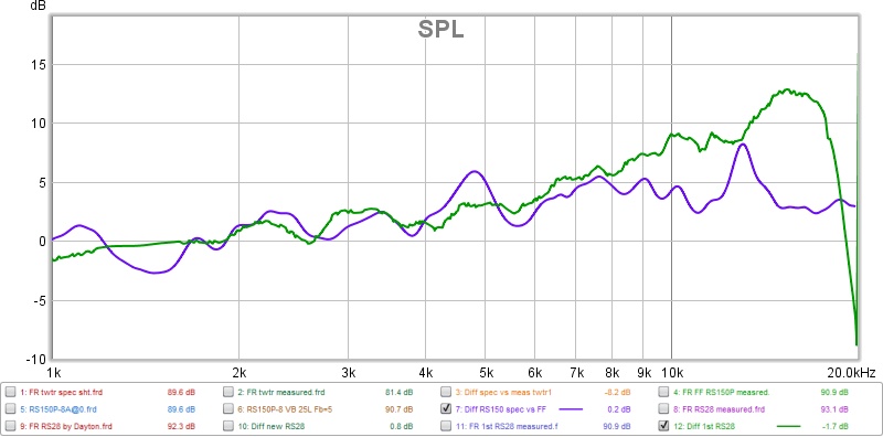

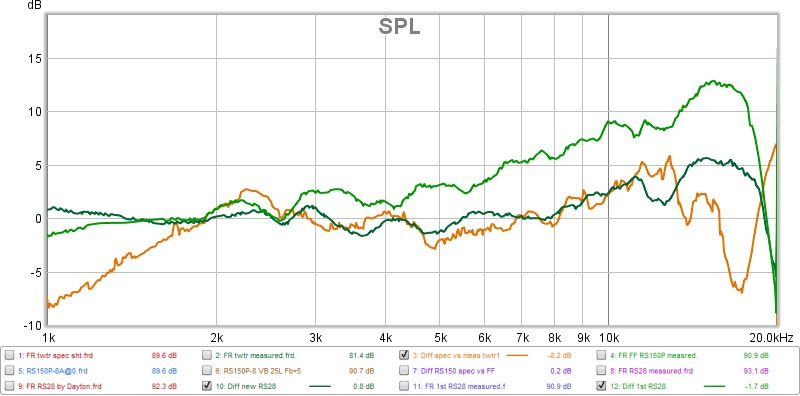

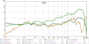

Hey Keil, good to see you back at it.
Looking at your results, they are in fact much better this time but there is still some discrepancy as you note. So I took a deeper look at all of your measurements to date. I had just eye balled them before but this time I traced them and then subtracted one from the other to get a closer look at the differences. Here's what I looked at:
1. the RS150 FF measured vs spec sheet with baffle diffraction added in
2. the first RS28 vs the measured FR by Dayton
3. your previous tweeter measured vs the spec sheet
4. the new RS28 vs the measured FR by Dayton
You can see the results below. These are the differences between what you measured and what the spec sheet data suggest. Note that if the measurements were a perfect match, the differences would be zero, so just a flat curve at 0dB. The 1st pic shows cases 1 and 2 above. So the green curve is the difference between the original problematic tweeters and the purple is the RS150 and you can see that both of them actually were actually measuring hot above about 2000Hz although the tweeter definitely got worse above about 8kHz. Way worse. That latter difference may have indeed been the tweeters fault. Not really sure. Sorry I didn't notice all of these discrepancies before btw, but I didn't look at them in quite enough detail.
Now in the 2nd pic, we've got a look at the differences bewteen that other tweeter of yours and the new RS28 plus I included the 1st RS28 difference as well. This time there is very good correlation between the 2 sets of comparisons. Both are pretty similar up to about 8kHz again and then they take off just a little bit. So the problem between about 2-8kHz seems to have been solved but the rise above 8kHz remains.
It's a little hard for me to form a solid conclusion because I was hoping that all 4 measurements might show a similar pattern which would imply something wrong in the measurement set up but they don't quite do that. Close though if we discard the RS150 measurement and assume the 1st batch of tweeters was faulty. Then it would seem to me that you've got a measuring error somewhere above ~8kHz or so.
Your mic would seem to be the most likely culprit but there is also an outside possibility that it could be some kind of hidden audio setting in your computer, an eq setting in the amp you are using or something to do with soundcard interface. That covers the whole measuring chain. Swapping each of those out one at a time and seeing if there is any difference would be the way to hunt the problem down I guess but somehow I doubt you have replacements for each of those sitting nearby. So you could double (or triple) check your computer and/or amp, maybe assume the Focusrite is ok and then conclude it's a mic problem. Maybe try with and without the calibration file. And/or maybe try a different mic. Any chance you have a measurement mic that comes with most AVR's these days sitting around? I guess you'd need a 1/8" to 1/4" connection adapter but that would give you another good piece of data for the sake of comparison.
That's the best I've got at this point anyways. Or you could just proceed and we can kind of ignore what's happening above about 8kHz. That might be ok though I'm not quite sure. I'll have to see how the rest of the measurements look to know for sure.
