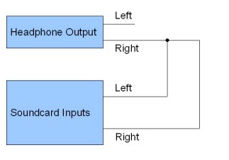

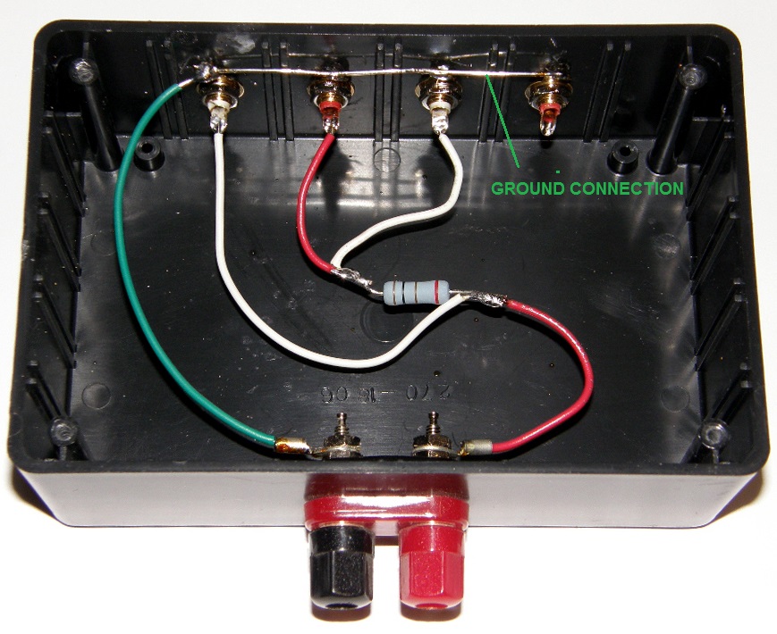

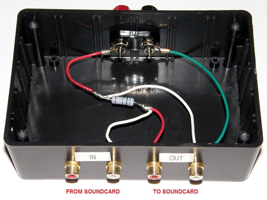

Let's go over things. Your headphone output should consist of 3 wires - L, R and ground and therefore needs a stereo jack which is separated into 3 segments. If your Focusrite input 1 and 2 correspond to the L and R inputs then they will each only have 2 wires, positive and ground although I'm confused on that because it looks like the Focusrite inputs are stereo 3 pin XLR connectors.

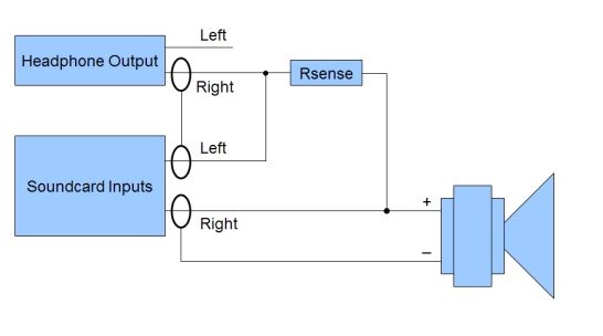

To do the impedance measurements and/or the impedance calibration, you have to use the impedance jig (pic 1) which only uses the Right side of the headphone output. The Left channel remains unused. And importantly, the Right channel gets split and sent to both the L and R input channels. If you just use a normal cable from the output to the inputs, this isn't going to work properly.
So first, grab whatever is necessary and make yourself up a nice little box that has the correct wiring and that you can repeatedly plug your input and output connectors in and out of and attach the 2 leads for a driver connection too. Pics 2 and 3 are a good example of the wiring but the connectors you use are going to be dependent on your Focusrite I guess - maybe a 1/4" stereo female for the headphone input and then any 2 female connectors that you want to put together on the jig end and then XLR connectors on the other. That wiring is going to be dependent on if the Focusrite inputs are single channel or stereo.
Now for the jig calibration, bypass the resistor and don't connect a driver to it and then run the test. That means that the right channel only from the headphones will be running directly into the L and R channels of the inputs, that's in pic 4. Notice that the ground wiring has unhelpfully been left out of this diagram, as well as the resistor and the driver connections.
Does that help?
Does that help?
My bad that was unclear, should have said for sure to save you from an explanation. But, yes I got it to work!
The Focusrite has their channel to be either XLR or a 1/4" jack. There are the little switches that are form either Line or Inst. I think when you plug in a mic though it automatically reads the three pins. But yeah I have two 1/4" jacks wired to speaker wire that I used for a project a few years back, so that works out very nice!

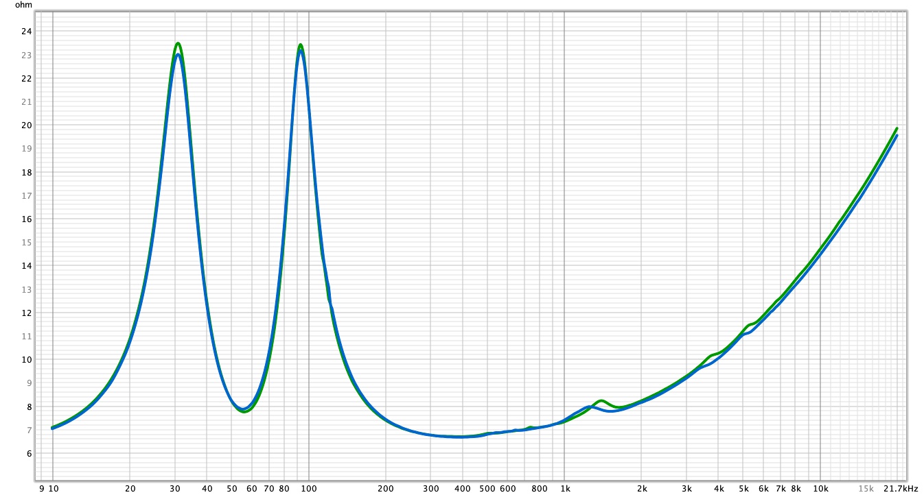

Alright so here are screen captures of the tests I have already done.
In order:
(1) CC Left Woofer AVG
(2) CC Right Woofer AVG
(3) CC Mids Parallel AVG
(4) CC Tweeter AVG
(5) Rear (B) Woofer AVG
(6) Rear (A) Woofer AVG
(7) Rear (A)(B) Woofer AVG Comparison
(8) CC Right-Left Woofer AVG Comparison

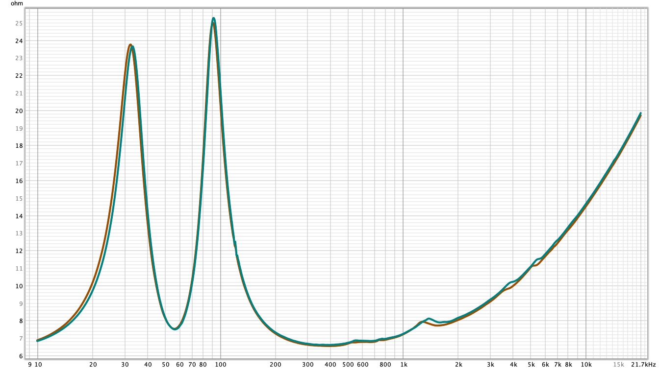

So, for all the graphs you see (except the tweeter) I did 5 tests back to back and then took the average to get a larger sample size on the results. For the tweeter I did 10 samples then took the average.
For the Rears Woofer comparison capture:
-> Rear (A) = green
-> Rear (B) = blue
For the CC Woofer comparison capture:
-> Right Woofer = brown
-> Left Woofer = teal

Much better this time. I think all of those are good enough to work with.
Very often driver resonances may be just a little higher than what the spec sheets say. But often they will also drop down some after they are broken in. In either case, it's not enough for me to worry about. Let's see what the other ones look like too.
Completing all the impedance measurements next looks fine now. For the FR measurements, just start with the surrounds just to make sure everything is working out well first. Take a measure of the port nearfield too. We don't really need it to add it into the nearfield woofer measurement as described in the measuring paper (unless you want to try it), but it can give us some insight into whether or not there are any unwanted resonances coming through the port as well.

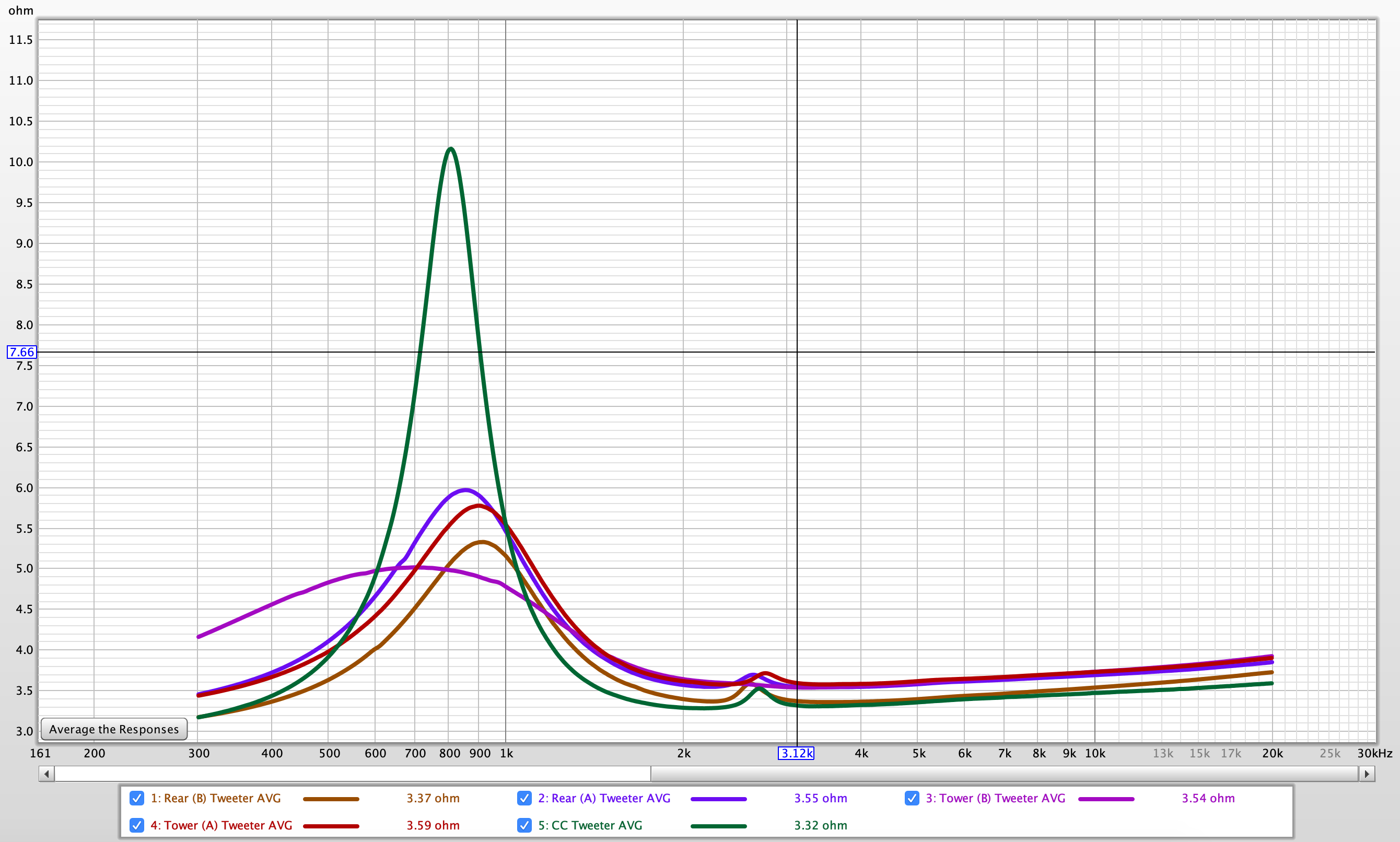

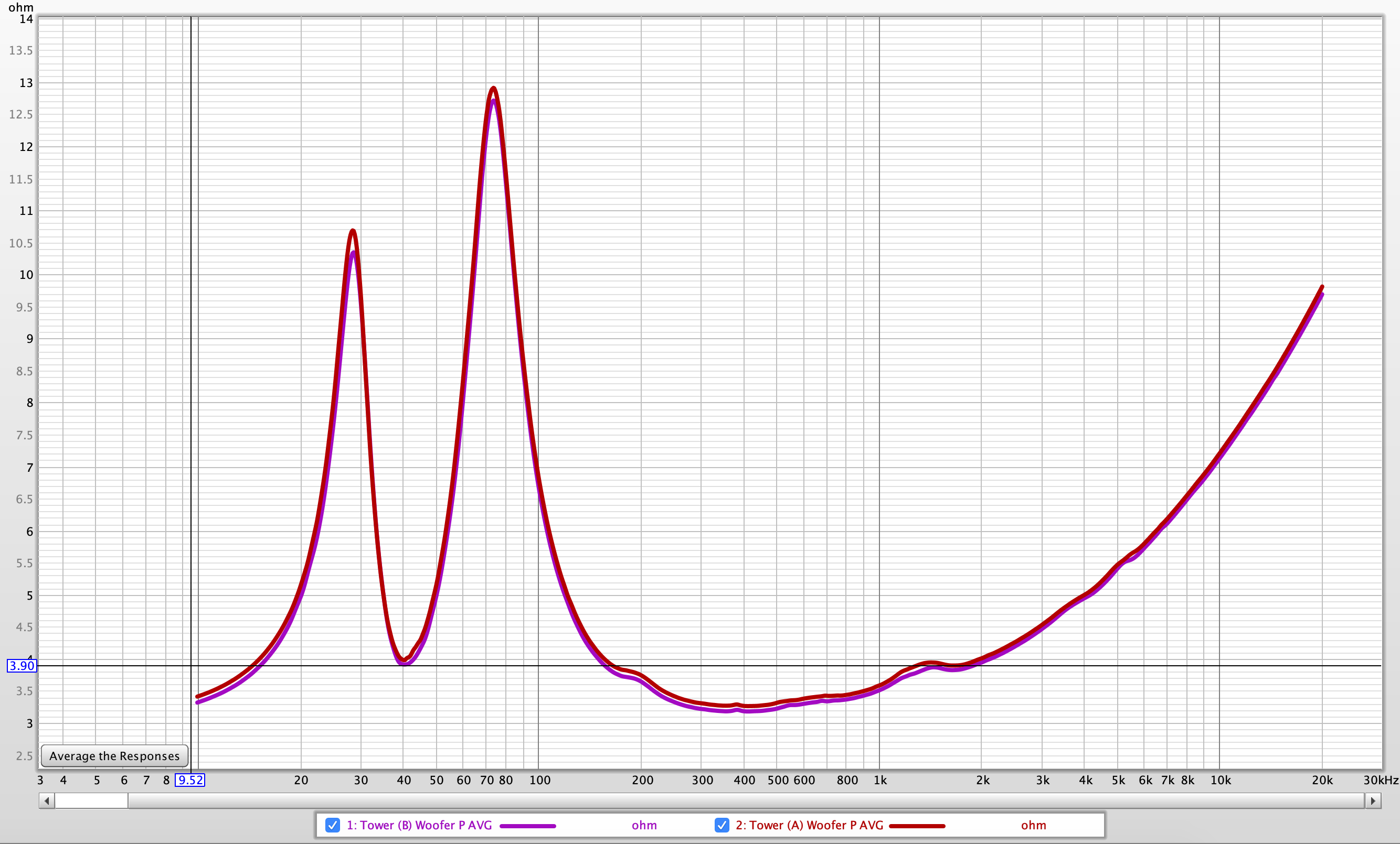

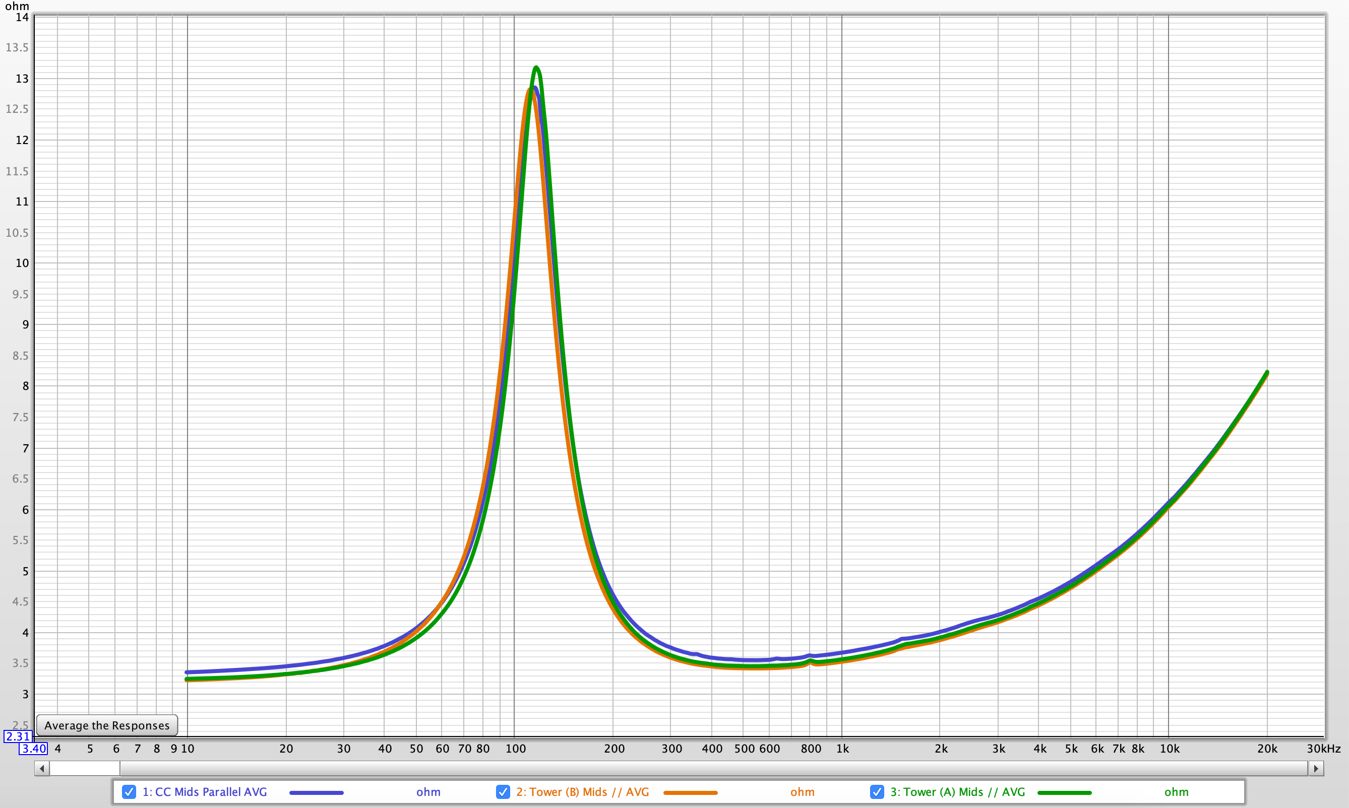

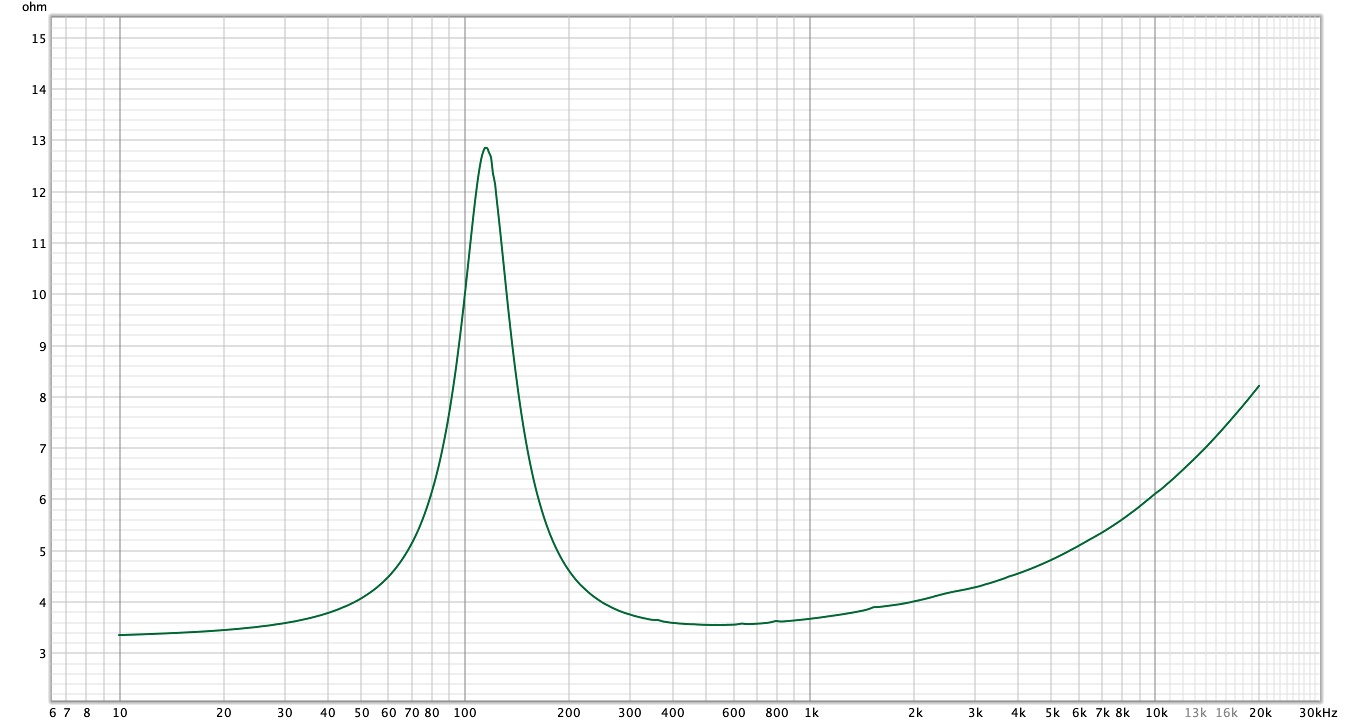

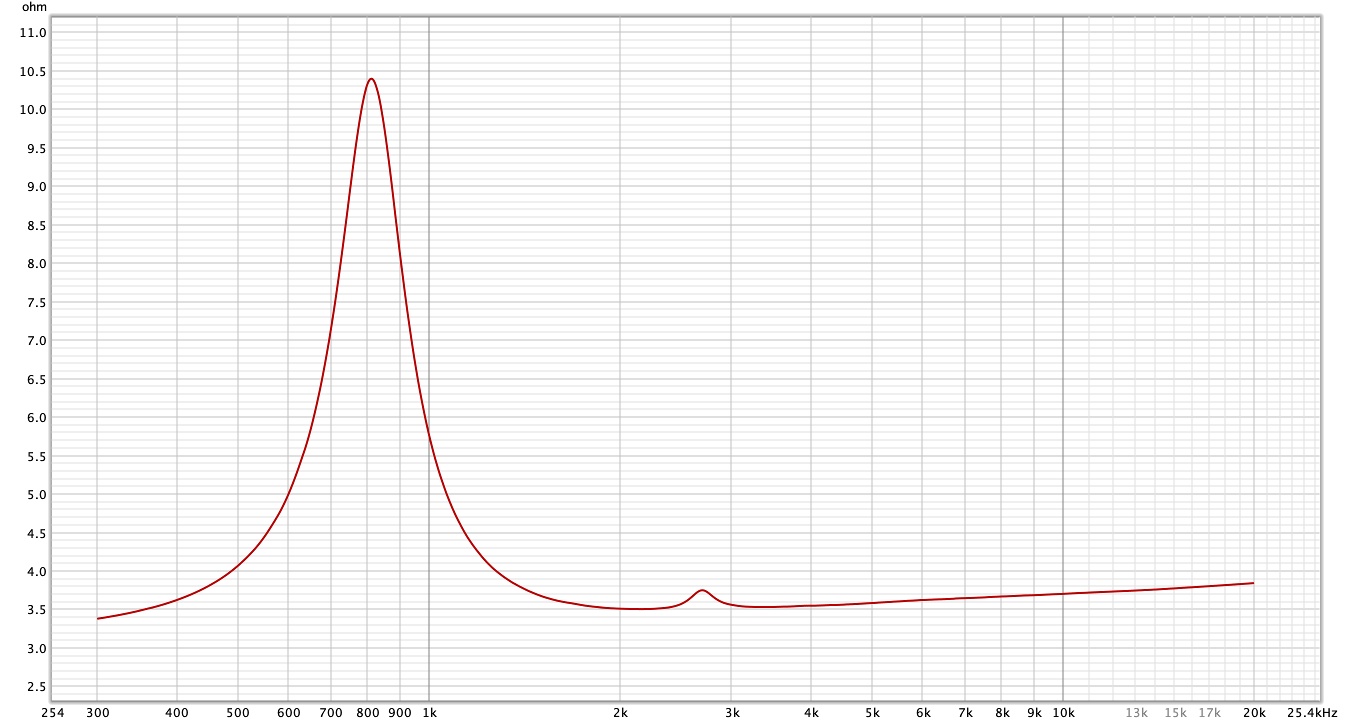

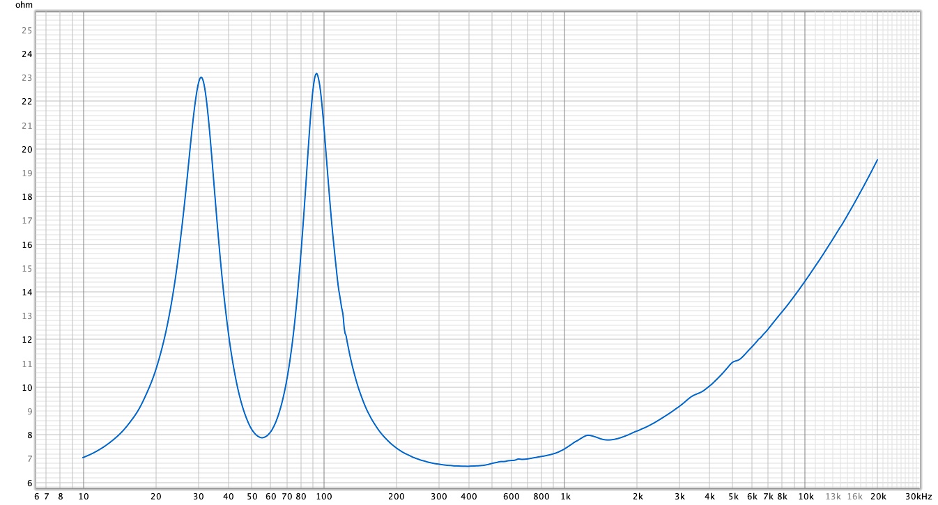

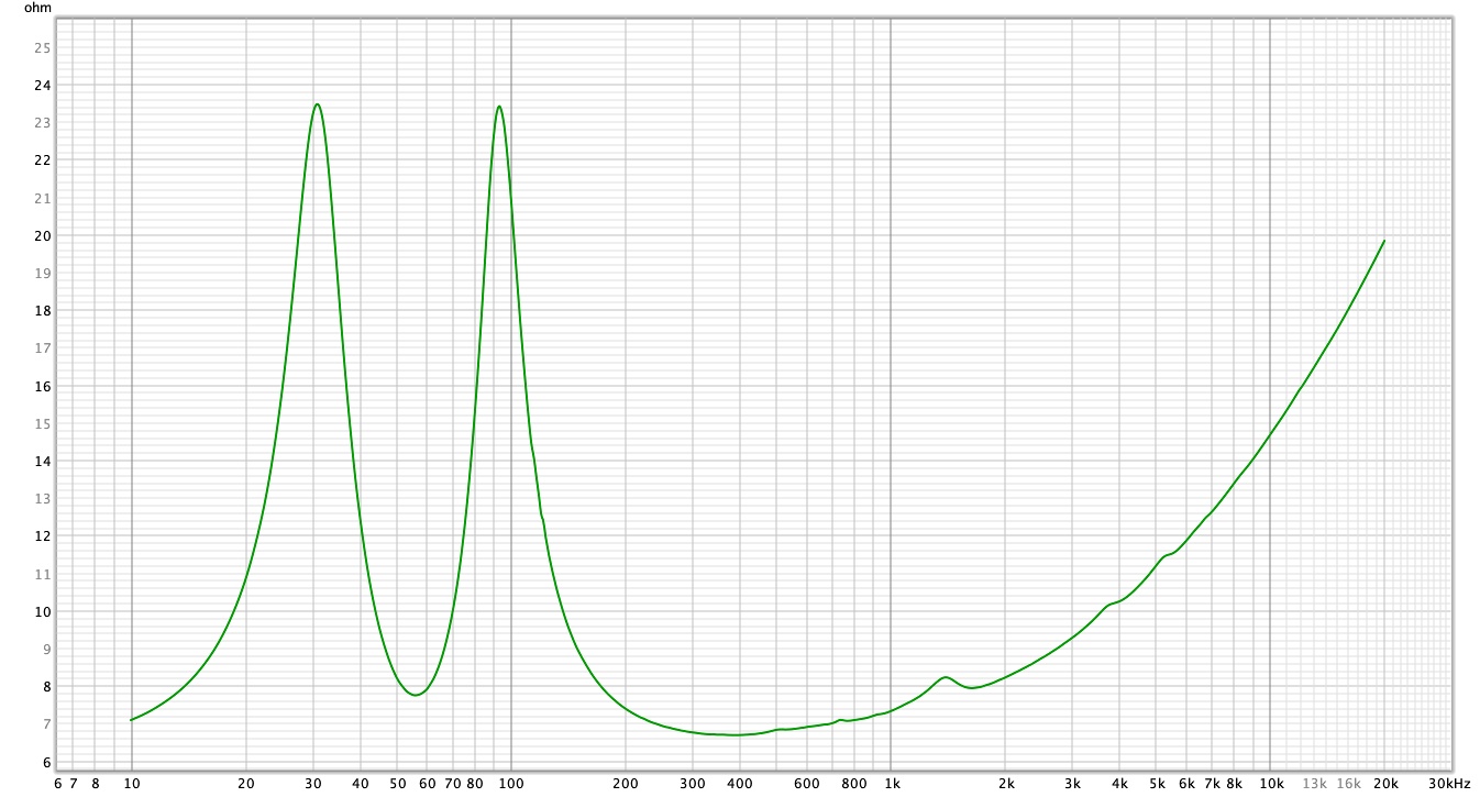

Alright so I got all of them done. For the most part everything is looking good and consistent, except for the tweeters. Which is very odd.
Here are the captures in order:
- Tweeters from all 5 boxes
- The Mids in Parallel from the CC and Towers
- The woofers in parallel from the towers
- The woofer individually from the CC and Rears
The thing that is really sticking out to me are the tweeter differences. They are all just so off. The Rears and Tower (A) all have kind of similar results, yet still off. Then Tower (B) and the CC are so different from the rest.
I made sure all connections were really good and tight, also tested each one 10 times and took the average. Each time I tested it always looked the same, there were no outliers. I even went back and tested the CC and Tower (B) a second time, ending up with the same exact results.
I haven't broken in any of the tweeters, all the same. I have also been very careful when building and fitting the tweeters on the boxes that no dust gets on them, and if so just a tad that was blown off. I had let one of the tweeters stay in the garage for a couple days in the box of course, but I was running heaters and it wasn't crazy cold in there.
Wondering whats goin' on with these crazy findings, any clue?
So, as far as the rest, it looks pretty consistent which is nice.
- The mids in parallel look very true to the spec sheet which is good.
- The woofers in the towers still have a tuning frequency around 40Hz. Should I address that before moving on to the FR tests?
- The woofers in the rears and CC seem fairly consistent, yet I do not know what to look for there.

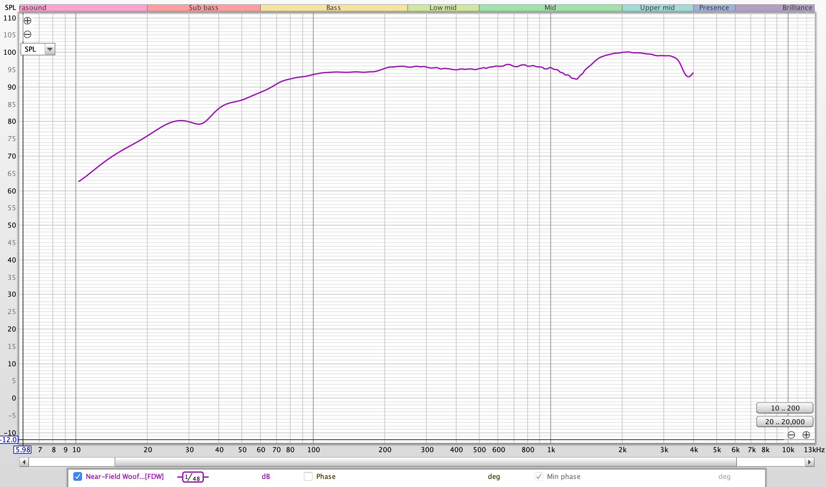

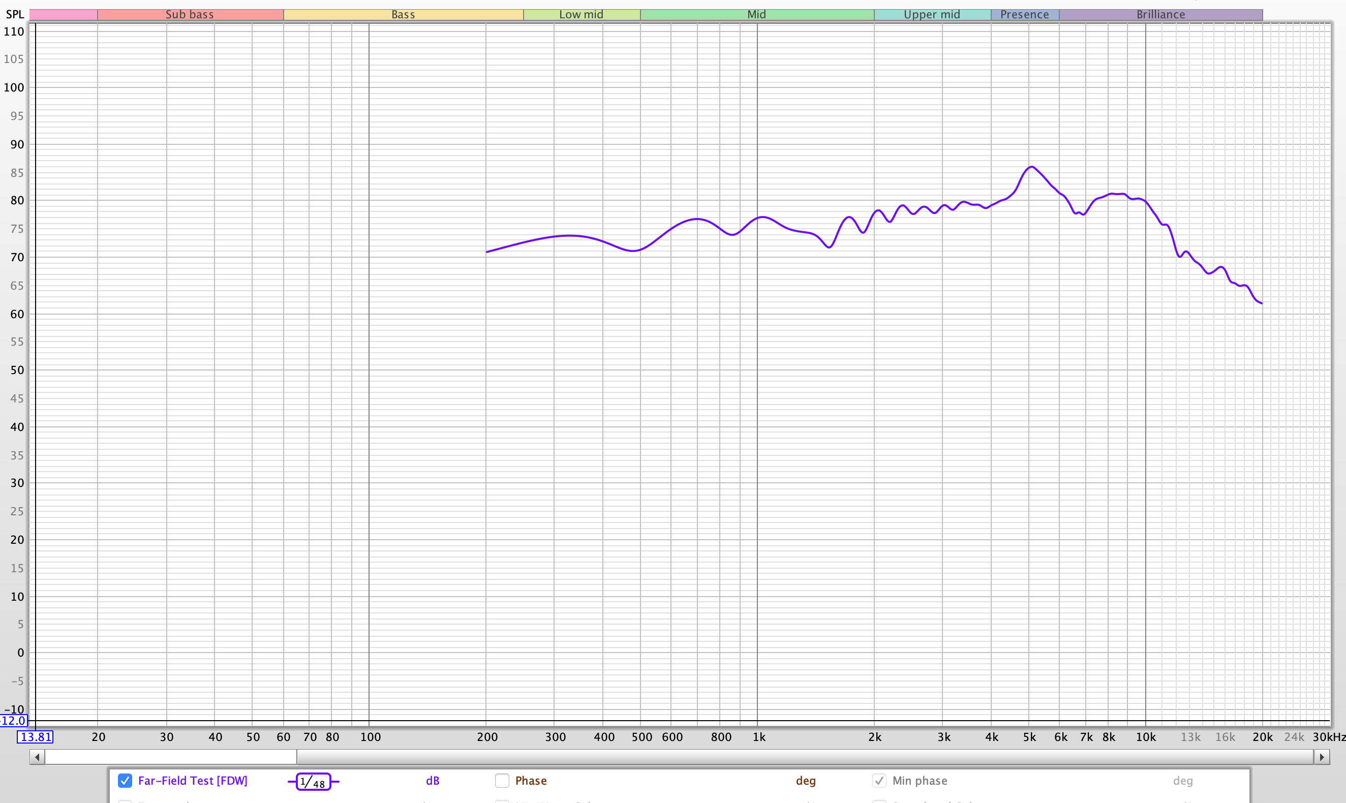

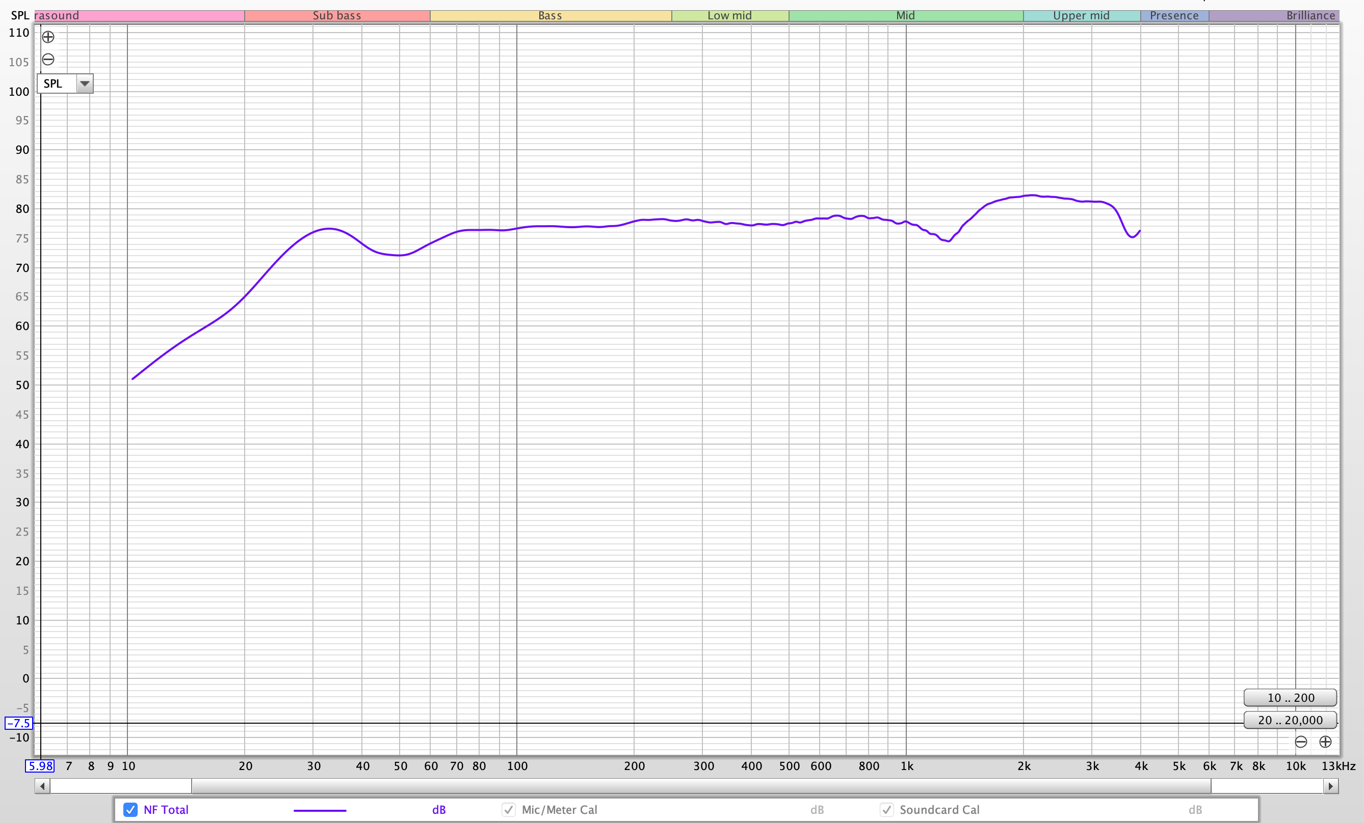

I'm just going to spill what I did today with the FR measurements and wondering if it aligns with what you would expect and do with REW as well:
FYI, I used the methods from the white paper by Jeff Bagby for the far-field, near-field, port consideration, and octave smoothing. I took into consideration, yet did not follow the exact methods for the gate and measurement blending, due to how REW is set up differently.
I also used 1/48th octave smoothing for all traces.

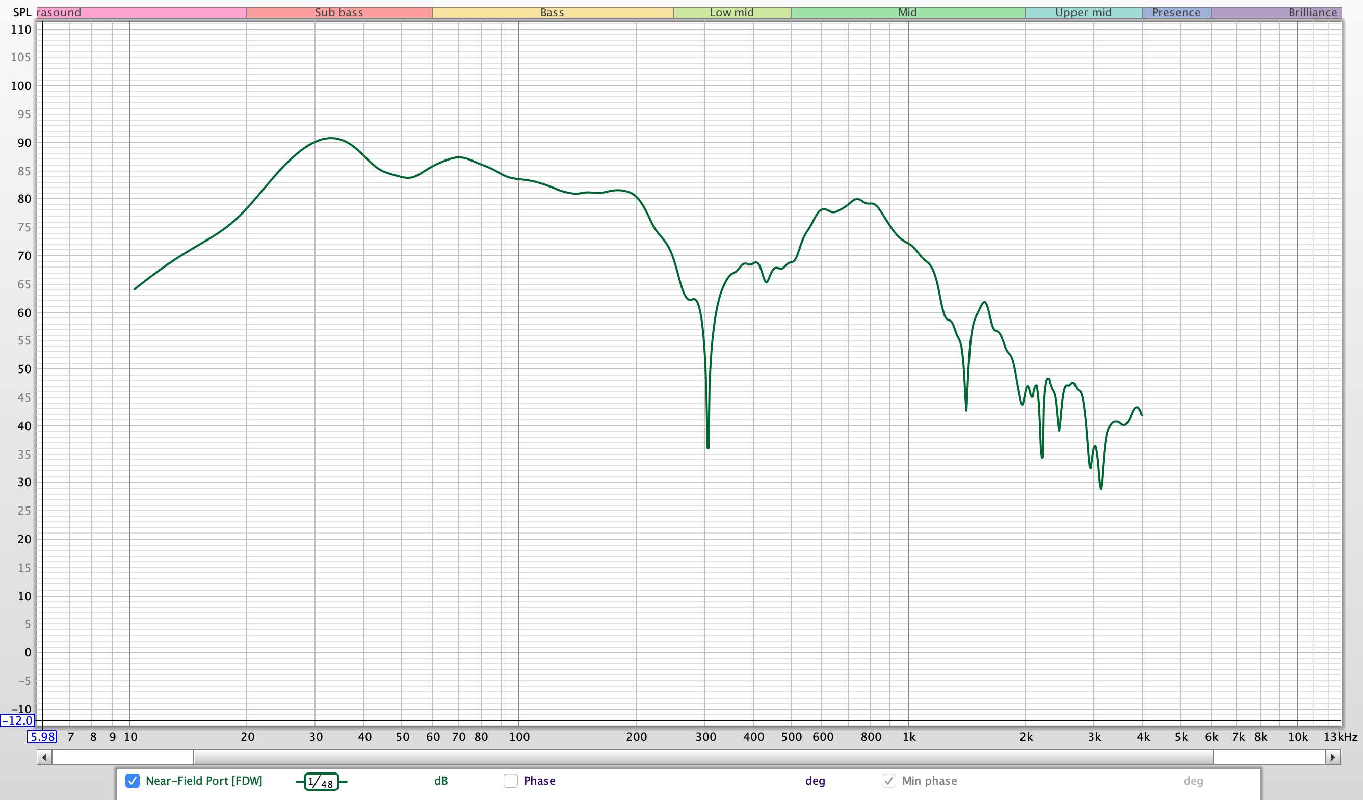

Procedure I used: For the top woofer on Tower (A)
1) I did a far-field test with the mic 14" away from the center of the cone. Then set the IR Windows to:
- Left Window (ms) = 5
- Window Ref Time (ms) = auto set
- Right Window (ms) = 5
Picture 1

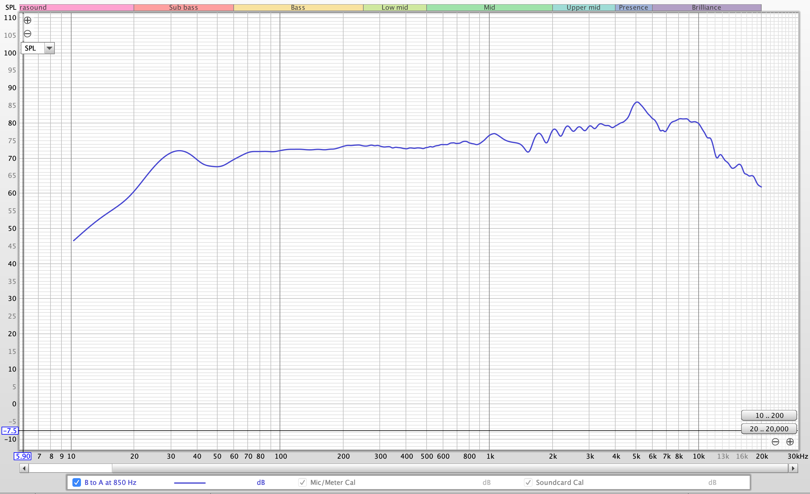

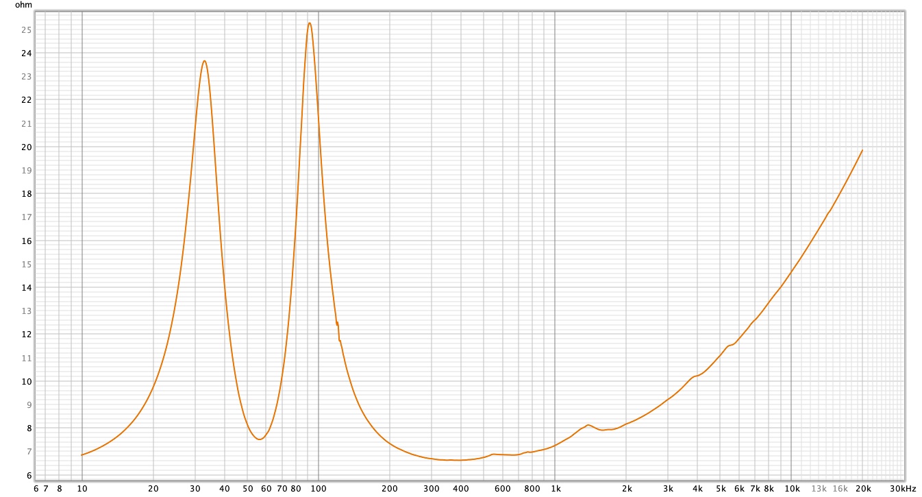

2) Took a near-field test with the mic 0.225" away from the center of the cone. Then set the IR window to:
- Left Window (ms) = 100
- Right Window (ms) = 100
Picture 2

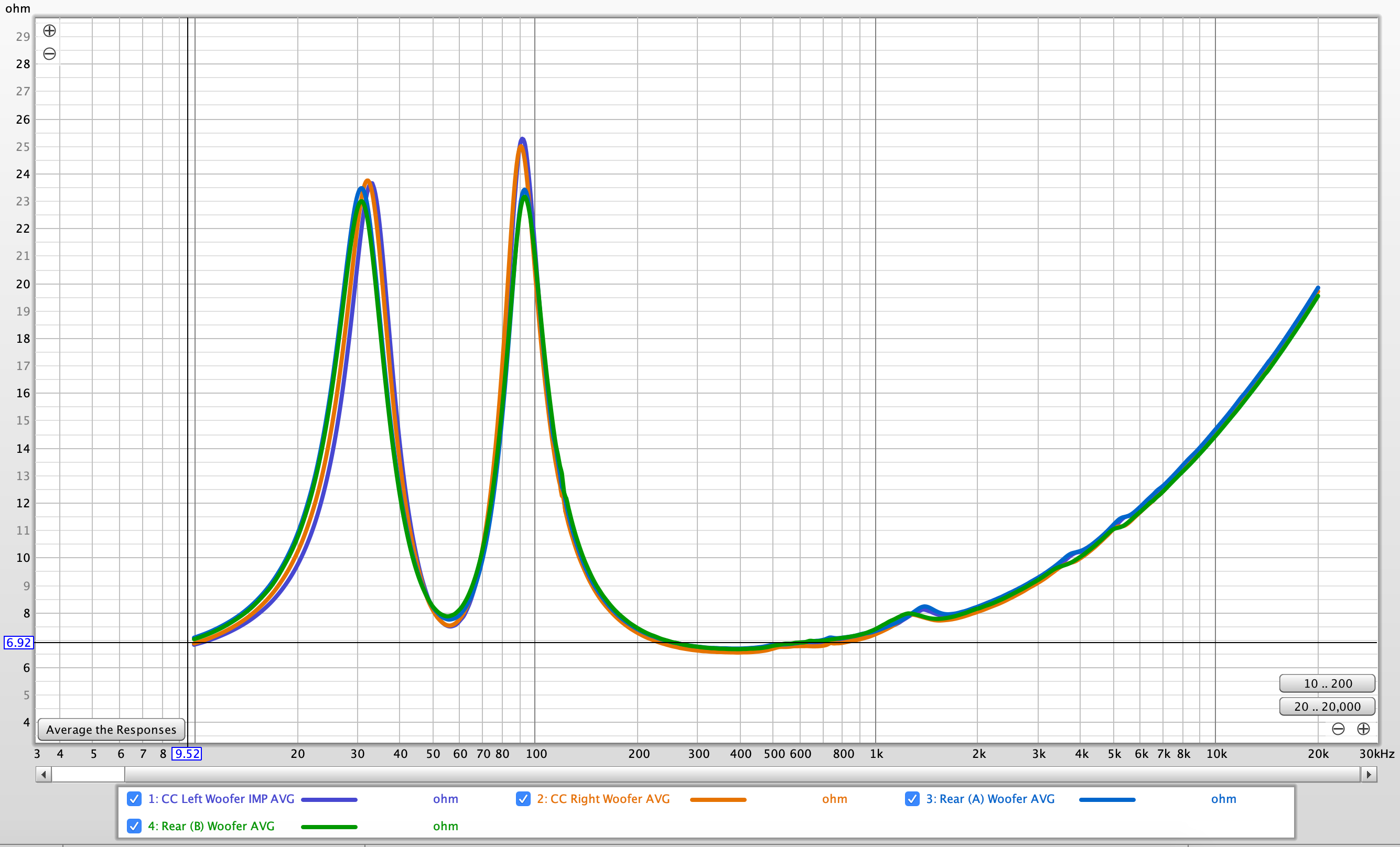

3) Took the near-field test with the mic basically right inside the curve of the port. Then set the IR window to:
I also, lowered the port SPL by, the equation given in the white paper, -3.522dB
Picture 3

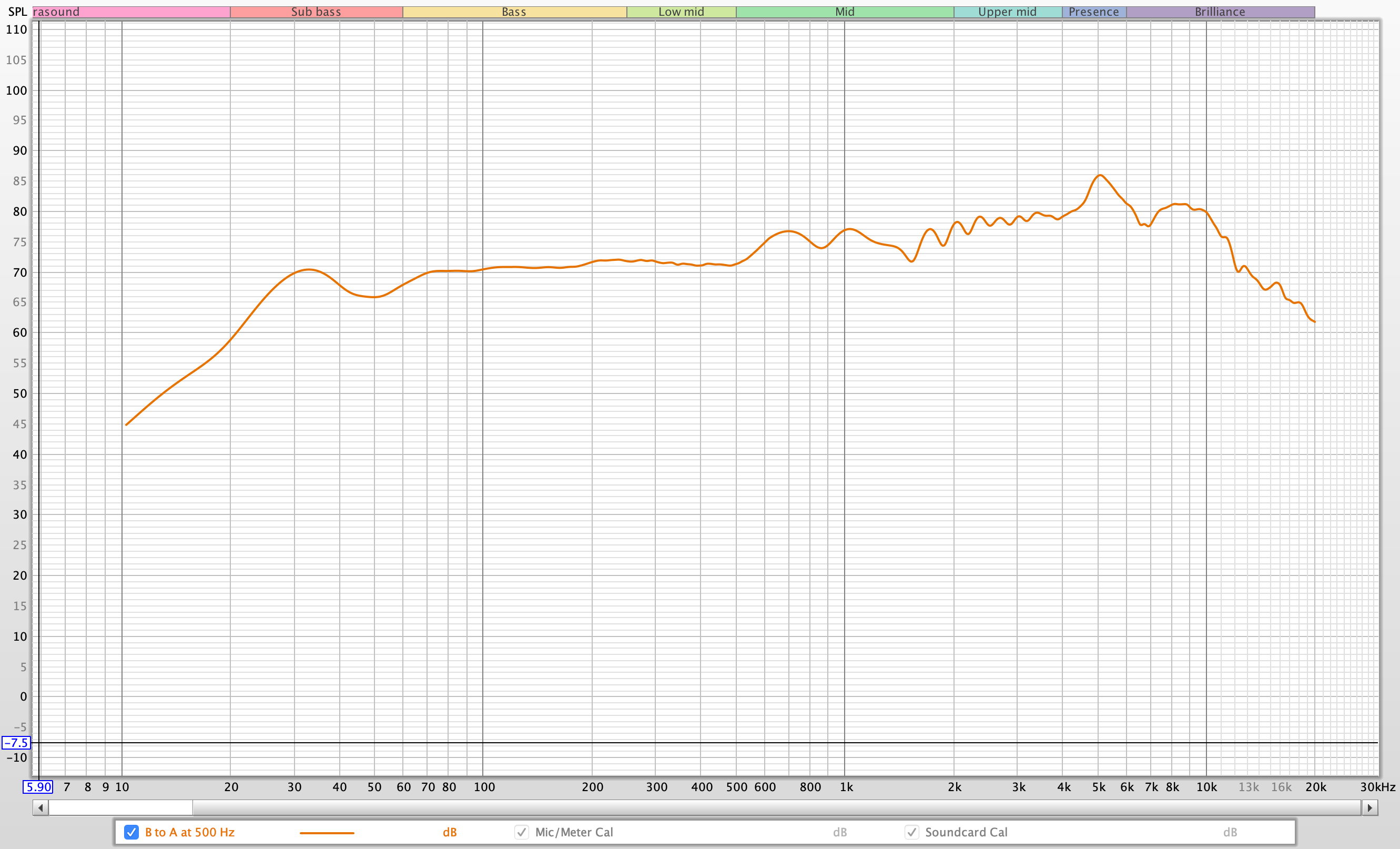

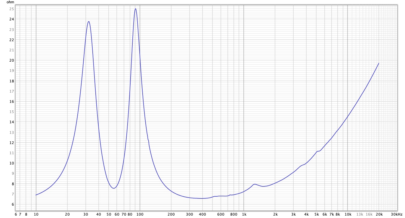

4) Then I took the average of both near-field measurements for a total near-field FR.
Picture 4
5) I then looked at both the FF and NF responses and lowered the NF by -14.8dB to line them up.
6) I then used the 'Trace arithmetic' feature on REW to 'Merge' the two responses at 500Hz with blending. I also tried blending at 850Hz and that looked good too.
Picture 5 - @500Hz
Picture 6 - @850Hz
Picture 1
Picture 2
Picture 3
Picture 4
Picture 5 - @500Hz
Picture 6 - @850Hz
I did these tests in my room to just figure out the process more. But, when I have the procedure nailed down and right. I will most likely be moving to the basement where the walls are much farther away.

I'm short on time this evening so just quickly:
- Not really sure what's going on with the tweeters. The others look good. Maybe imp will change if the tweeters get worked in a bit but I'm not hopeful. Let's see what the FR's look like too first.
- For all the farfield FR measurements: the mic should always stay stationary on the listening axis (usually the tweeter height) for each speaker's farfield measurements. You want the same power to each driver and the same mic position so that all drivers' relative SPL levels are correct. If the tweeter is the listening axis, then all other drivers with the exception of the CC will be listened to off-axis so this is how we want to measure them too.
- For nearfield, then you move the mic for each driver or port that you measure and then we'll adjust those levels to match correctly with the farfield measurements. I haven't actually measured drivers with phase plugs before so I'm not sure which instruction should prevail - proximity to the cone or in the center of the cone. I'm inclined to say the center of the cone, so right in front of the phase plug and then maybe go with a little higher SPL.
- When blending, you have to add in the baffle diffraction to the nearfield measurement before you can blend it correctly with farfield.
- Try to ensure all drivers are 3' to 4' from all surfaces including floor and ceiling. That may mean raising the towers up a bit too. Choice of the gating time will be dependent on how far the nearest surface is. This can be spotted in the impulse response and/or it can be double checked with some simple geometry and the equation for speed=distance/time.

So just repeating from last night, I agree that the measuring paper misses a couple of key points. The first is that the mic should stay fixed on the listening axis for all FF measurements and the 2nd is what to do for NF when the driver has a phase plug.
Re your FR measurements:
1. First it looks like there is too much smoothing. It looks more like 1/6 or 1/12 than 1/48 smoothing to me. If you didn’t just pick the wrong one in the drop-down ‘Graph’ window, go to Preferences -> Analysis - > Frequency Response Calculation and make sure that 1/48th is selected.
2. Woofer FF: Comparing your measured FR to my sim with baffle effects included, it looks about right. I’d probably use a gating window of 3ms though. Check your impulse response to look for any blips under that amount of time. Or looking at time of flight, 5ms will record any sound source, direct or reflected, with a pathlength less than about 67”, which means you’ll need clearance of about 5ft to all surfaces near the woofer. I’m guessing but I think the floor was probably only about 20” away from the driver. Three ms on the other hand only allows a direct or indirect sound source to be recorded within 40”. *
The accuracy of a 3ms measurement btw will go down to about 333Hz.
3. Woofer NF: Not sure how much difference it would make but 50ms will be accurate down to 20Hz. I’d go for that instead of 100ms.
Just fyi: Driver piston diameter is generally considered to be the distance peak to peak on the surround. More or less.
I would expect to see a deeper null at the tuning frequency, so around 40Hz but I think this is just an artifact of over smoothing.
4. Again, not 100% sure but I typically set the L and R gating to the same amount.
With the port, it looks like there is more SPL at ~70Hz and ~800Hz than wanted. The 800Hz doesn’t matter at all because that frequency will be out of the passband of the woofer. Not sure about 70Hz. Let’s see if shorter gating changes things. Or maybe we need the NF source, the port, to be louder than the cone source so maybe turn it up a little bit more. The drivers should be able to handle it!
5. Averaging the woofer NF and the port NF responses may work as a combining method but I’m doubtful. Jeff’s paper suggests using a xo sim program that uses SPL levels plus phase info to add them together but I don’t find it necessary to add them together usually in the first place because for xo work, the reference SPL of the woofer’s FR that sets the speaker’s overall level is at about 200Hz, which here should be well above the contribution from a port tuned to about 40Hz.
*If you wanted to calculate the path length for reflected sound waves, it’s a pretty straight forward formula.
If h2 = the distance of the mic from a surface, and h1 = the distance from the center of the driver to the same surface, and d = the horizontal distance from the cabinet to the mic, the distance of the reflected path length, L is:
L = sqrt[(h2-h1)^2 + d^2]
(Obviously if h1 > h2, then it’ll be (h1 – h2).)

So next up I would probably look at the FR of all the tweeters. I think you need to know if those tweeters are going to be ok or not before going too much further. Maybe give them a little workout before hand to make sure they are well worked in.
For the tweeters by themselves, FF only is fine and the mic can get closer than with the woofers.

When the impedance tests were being done, I tested the mids and woofers in parallel since there was no improperly tuned passive radiator thing happening.
So, in the white paper, Jeff explains how with dual woofers and one port you need to subtract 6dB from the port's NF FR. Yet, if I am only testing one woofer, then I'm guessing that does not need to be done until I test both woofers at the same time.
When testing two drivers:
Do I take the FF measurement of both drivers together, then take the average of both drivers NF responses, and then blend the two NF and FF like usual?
