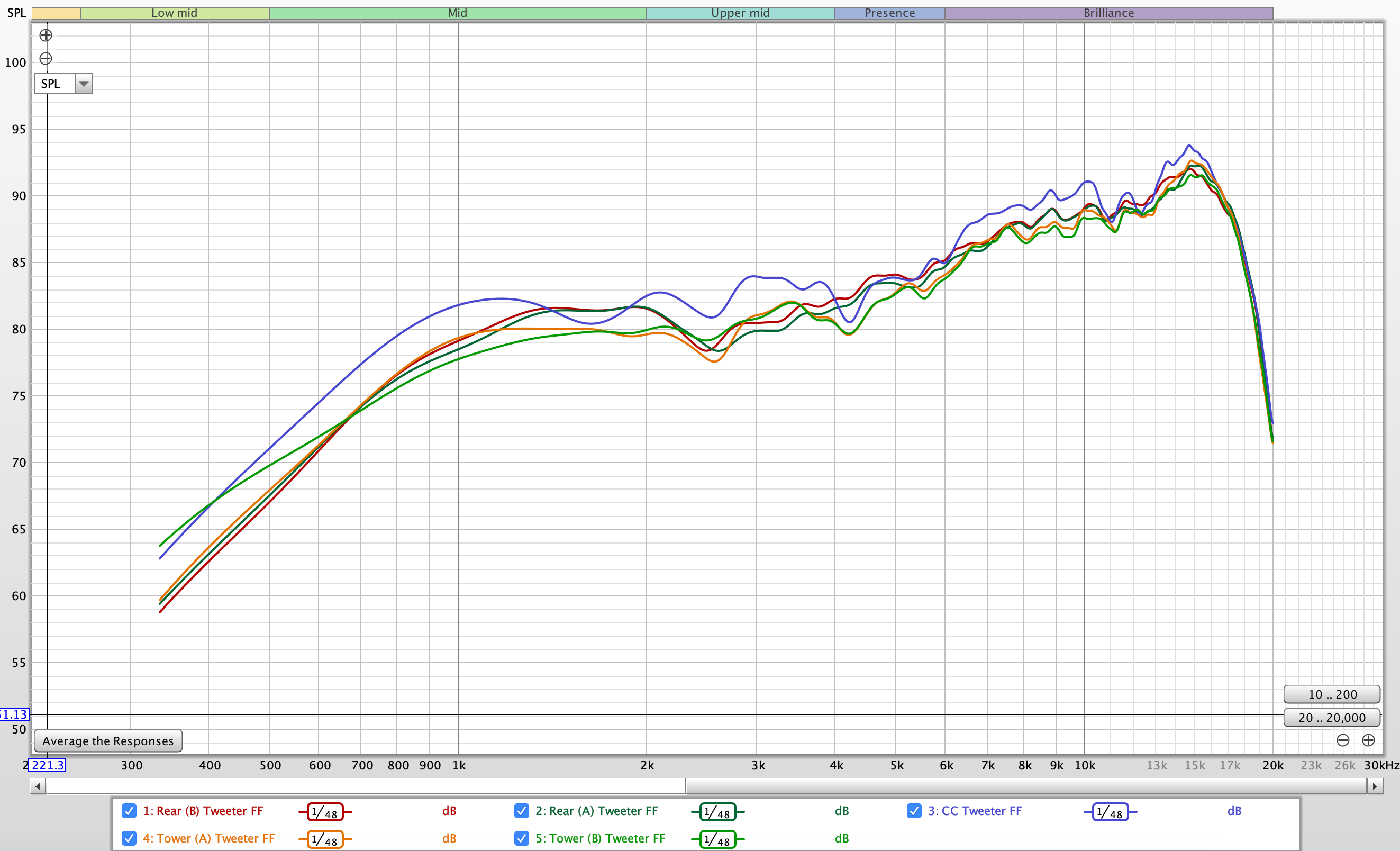

I have taken the FF FR of all the tweeters, the picture is below. They are looking good and consistent. Also, keep in mind these responses have not taken into account the baffle diffraction, I will explain why below.

That's great with the tweeters. There looks to be a reasonable amount of consistency. Here's what I'm thinking about them. Re-measure the impedance and let's see if there is more consistency there too than the 1st time. If there isn't, let's try to match them up into similar pairs for the paired speakers and leave the outlier for the CC before doing any more measurements.

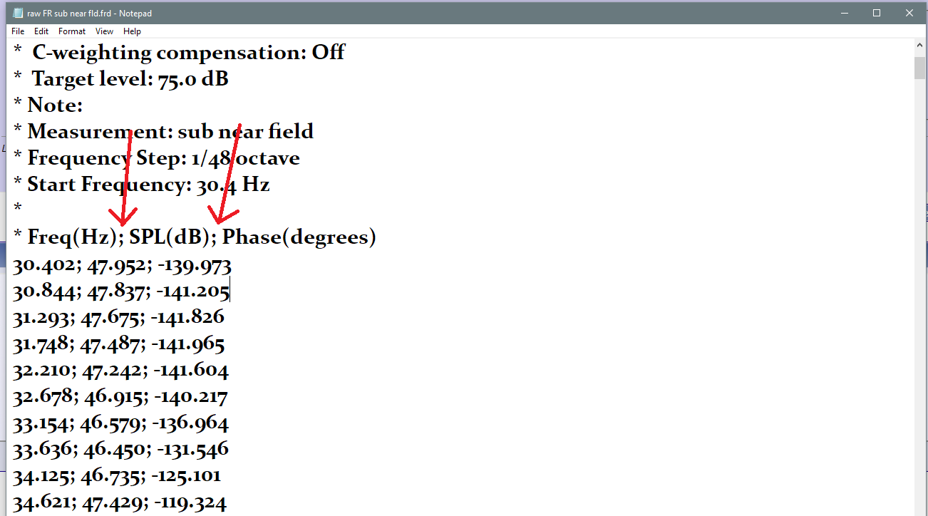

First is that the file extension is incorrect. This is especially easy to occur with files from REW because it will save them as .txt files unless you specify otherwise. If that's the case, just simply rename them with .frd as the file extension.

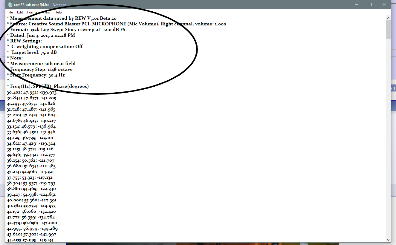

Secondly, some programs don't like the info that can be inserted in the frd file before the actual numbers. Open up the frd file (just double click on it and it will open as a Notepad document) and then just delete the text and/or empty lines. See pic 1 circled.
Lastly, again in the actual text of the frd file, in each line the 3 points of data can be separated by different means. Very typically, it's just done with an empty space or a tab but REW likes to put semi-colons in between them (pic 2). Open up your frd files just to make sure and then when you load them into Response Blender, check the little box called 'Show Import Options', click "Import FRD File' and in the window that pops up, select 'User Defined' and type in ";" (or make one of the other choices if that's appropriate). This is what I think the problem is most likely to be.

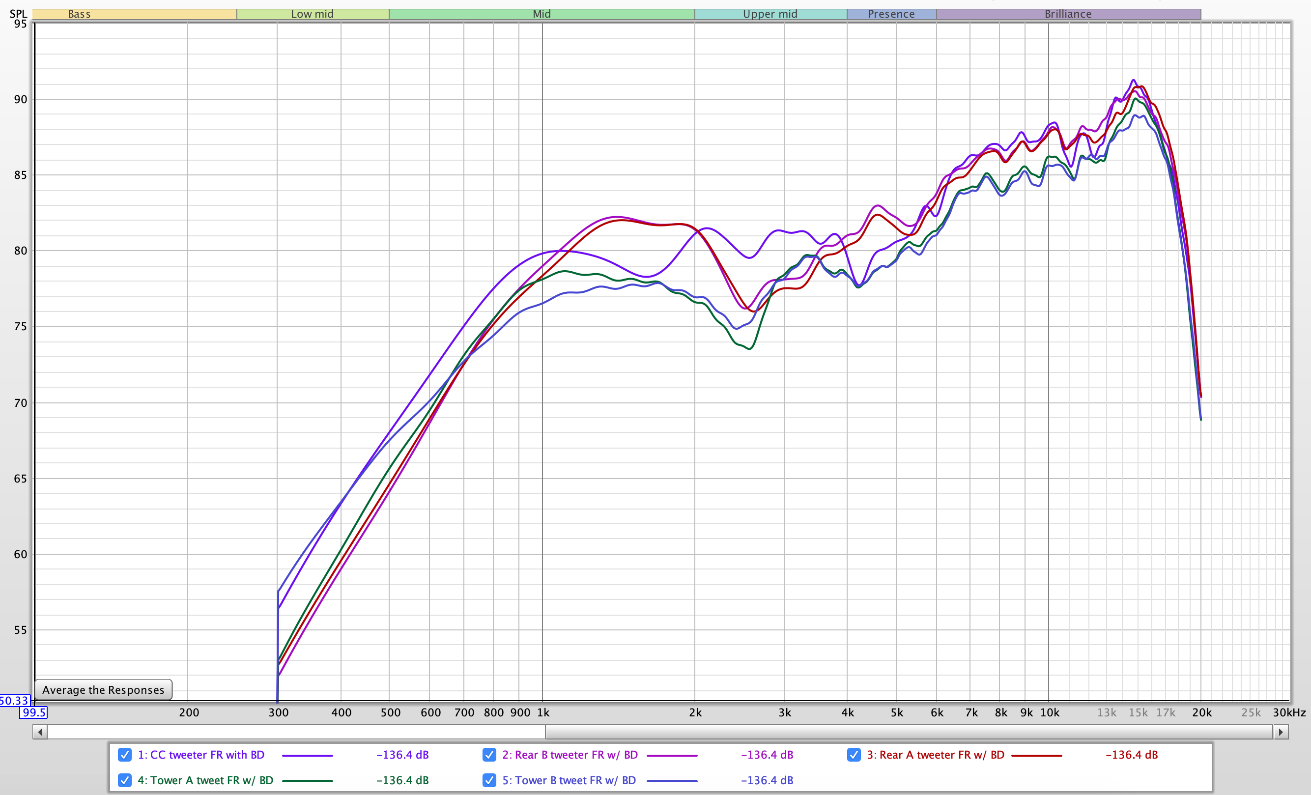

The picture below is a look at all the tweeters with the baffle diffraction files from Diffraction & Boundary Simulator and did the A*B summation in REW. Just to get a look at it. I will be using Response Blender now and see how it goes!

Ok, Response Blender is used to blend the FF and the NF measurements but with the tweeters, all you need is the FF. So no need to use Response blender for them. Although I guess you could if you wanted to for practice.
On another note, it took me until after I posted to stop and realize that although those tweeters are showing some consistency, the FR's do not look right at all. They don't actually look anything like the spec sheet nor the spec sheet FR combined with any of the baffle responses. Attached are the spec FR and the sim for the surround.
So I'm starting to worry there is something off about the measurements or the tweeters.

Hmmm, that is odd. Honestly these tweeters are a pain in the a-s-s.
Maybe again Dayton did not have accurate results, which I doubt. Yet, all my other impedance results looked good except the tweeters, then now the FR is odd too.
Idk where I could have gone wrong, I've been following all the steps and taking this all into account. Like I said I even put up foam and sheets and more rugs down, probably more than I need, to help with reflections.

Also, importing the FRD files from REW, making sure they are saved as .frd files with semi-colons. Then I deleted the text and empty lines. Then in Response Blender I did the User Defined as ;

So I'm hoping that the tweeter FR's you posted include the baffle diffraction twice which would account for the serious ski hill going down to the left of the frequency range. If that's so, let's try again and post just the unadulterated FF measurements for the tweeters.
So, the first screencapture I posted of the tweeters FR's is just the raw measurements with nothing added to them.
The REW file for all the tweeter measurements is too large to post, I will email it. The file has nothing done to them besides 1/48th octave smoothing and gating at 3ms.

But I was afraid you were going to tell me that the measurements of the tweeters you attached in post #161 were correct. Yea, because those are just not right. It's as if there is a 10dB treble boost starting at ~ 3-4kHz. Do either of the 'AIR' or 'INST' settings on the Focusrite by any chance operate like an EQ setting?

Yeah that picture from post #161 were correct. Idk what this looks like to me is a high frequency resonance from the metal dome. I remember when I did my speaker project for school I used the Dayton Audio ND25TA-4 1" Titanium Dome Neodymium Tweeter. In the FR of that it has something kinda similar where it peaks up toward 15kHz. The professor and I's thought was that it was due to the metal dome over it.
I know these measurements I made are different, but yeah it is odd how it ramps up like that. Maybe I should email Dayton about it like you had before.

I got Response Blender to import the files now! I used spaces in between the data values and also clicked "Use CRLF as end of line for Window compatibility" and that worked! So I've been messing with that and its all working on that end which is good!

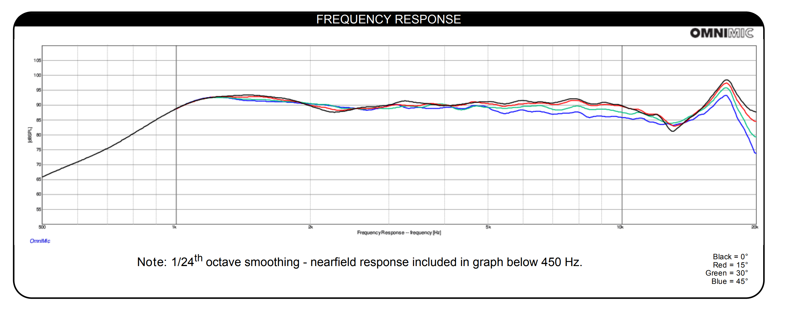

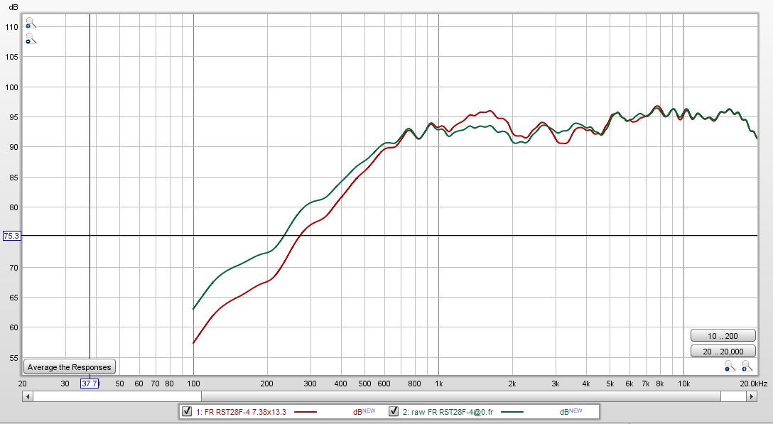

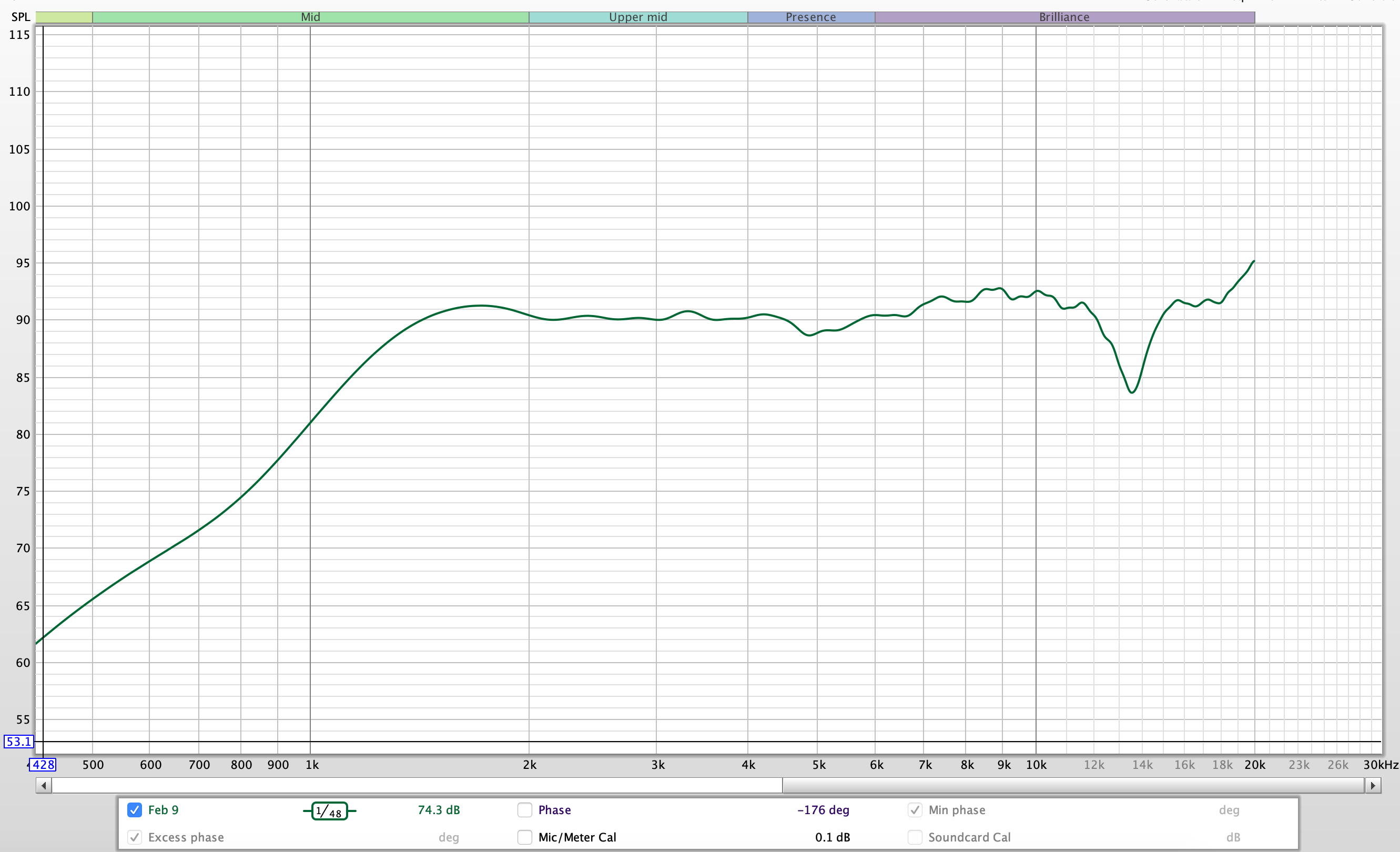

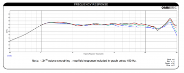

Wow yeah, the tweeter from my old build looks way more accurate to the spec sheet then the tweeter now for this build.
The first picture is of my measured response with the mic 8in away. Then the second is from the spec sheet.
So haha wow idk whats up with these new tweeters now. Maybe they really are just off form the spec sheet or somehow defective.
