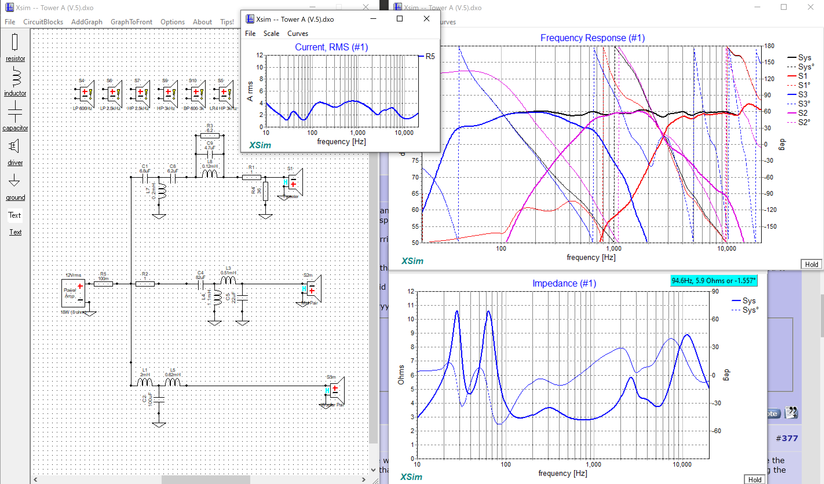

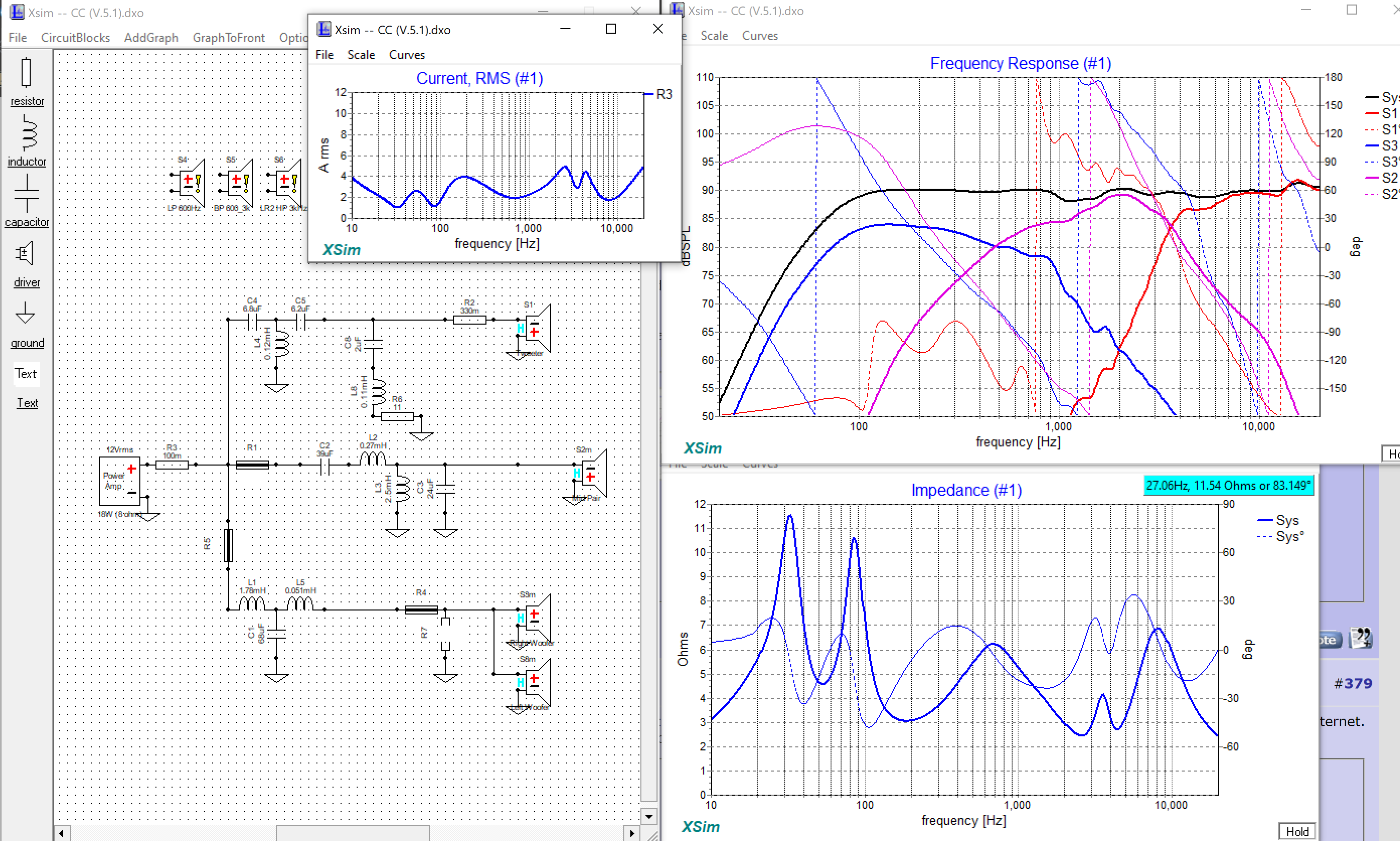

Alright so this is the best I could do to get them closer. The first screenshot is the tower and the second is the CC.
The tower xo point is now around 2.7kHz and the CC xo point is around 3.6kHz. At least closer this time.
The impedance on the CC gets pretty low, but I forgot to check that when I took the screenshot. It can easily go above 3ohms if I lower C3 to 22uF and lower C4 to 6.2uF or 6.4uF. That would put the xo point around 3.7kHz then.
Re that darn pesky tweeter - it seems to me that with a lower xo point, it does better with a parallel LCR and with a higher xo point, it does better with a series one.
If there were no other choices, yes I'd favor the flat response even though the voicing might be slightly different.
It's easy to bring down the tweeter level if the mids aren't loud enough but how are you going to bring down the woofers? Maybe I didn't state this explicitly before but it's sort of a cardinal rule to keep the series resistance on the woofers as low as possible. So here I'm just talking about the inductor(s) never mind adding any kind of resistors. Adding additional series resistance to the woofers is very inefficient on the amplifier, it actually changes the box tuning somewhat (you can add resistance in Unibox to see the effects) not that that is going to make too big a difference here where your F3's have already been reduced significantly and you need to make sure you have resistors that can handle all the amp power and not burn up.
Yes good, add in the port but the blended response of the CC woofers isn't close to that of the towers - the CC is rolling off at about 100Hz instead of 50Hz.
Both the tower and the CC sims are good efforts with the topology you have decided upon. Impedance is low in the CC but with enough current in the amp it probably won't be a problem. A couple of things to note -> if you are going to look at the current graph, you should probably look at it with the maximum watts you expect to use, especially when looking at the lower frequencies. Additionally, XSim sort of assumes that equal power is being drawn by the speaker right across the whole frequency range which isn't actually true in most cases. Most music genres are recorded with levels that drop as frequency increases. Kind of makes sense when you consider Fletcher-Munson. So the lowest frequencies will need the most power whereas the higher ones will draw less so the lower impedance up in the high frequencies isn't quite as bad as in the lower ones. But of course, best is if they don't go low anywhere. This is also the reason why you can use series resistors with lower wattage ratings as you go higher in frequency too.

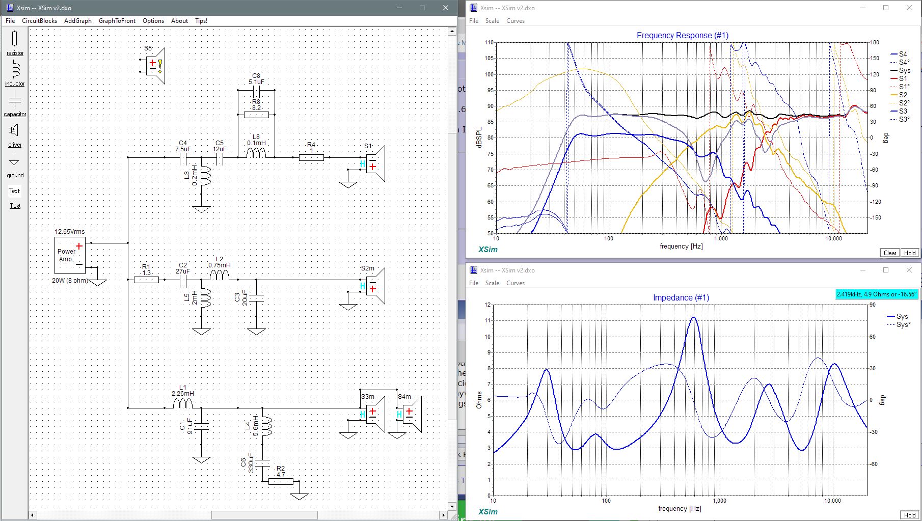

Attached is my version of the CC - flat and with just about the same xo points as the towers. Impedance and phase are good and both the tweeter and mids have room for adjustment both up and down. And port contributions are not diminished from the fundamentals. But I'm making design choices again that you don't want to make which is again, fair enough. They're your designs and your speakers and your choices. I'm just trying to lead you in the right directions.
Hope that helps.

Your CC sim does look very nice and is really close to the tower xo points. I'm going to try that on what I have and see what I get, cuz from my experience I would still get those nulls like I was talking about before.
Sorry if this phase of the speaker design has been frustrating at all for you with trying to work with me. It has been abundantly clear to me in a lot of ways that these speakers need to get done asap and that I need to start my career and find a real job. So I apologize if I more or less has been "pushy" or not as easy to work with. As always, I appreciate and value your help in this very very much and do not know where I would be with this without your help along the way! Thank you!!!
I will try your CC sim and see what I get. See if I want to change it, but by the end of today I will be ordering the xo components! Which is honestly very exciting😀
