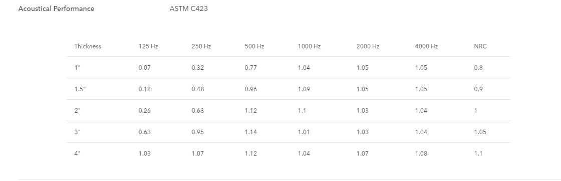

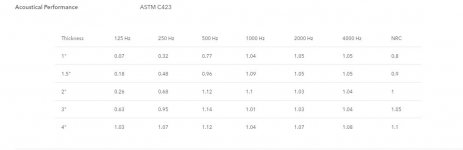

I looked at the Owen's spec sheet for their product but couldn't find the density listed. The Rockboard I get here is the 6lb/sq ft stuff which is pretty compact and definitely better for acoustic absorption than the much lighter varieties of rock wool and foam as well. Just want to make sure you aren't mixing them up.
The 3/8" acoustic felt looks to me like it could do a good job but if you need about 30 sq ft, you need to order 4 packs of them, = $$$. But your choice of course.

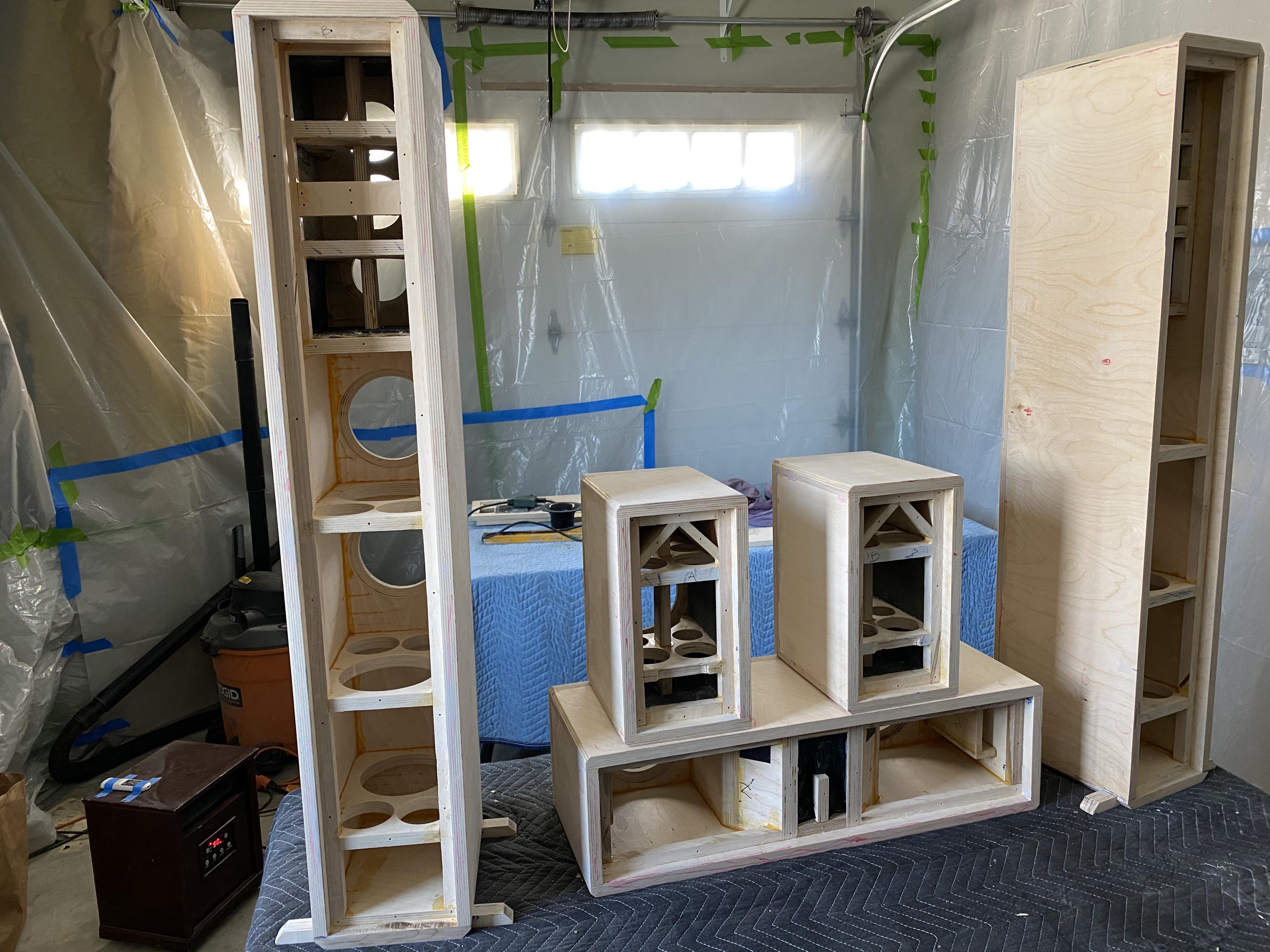

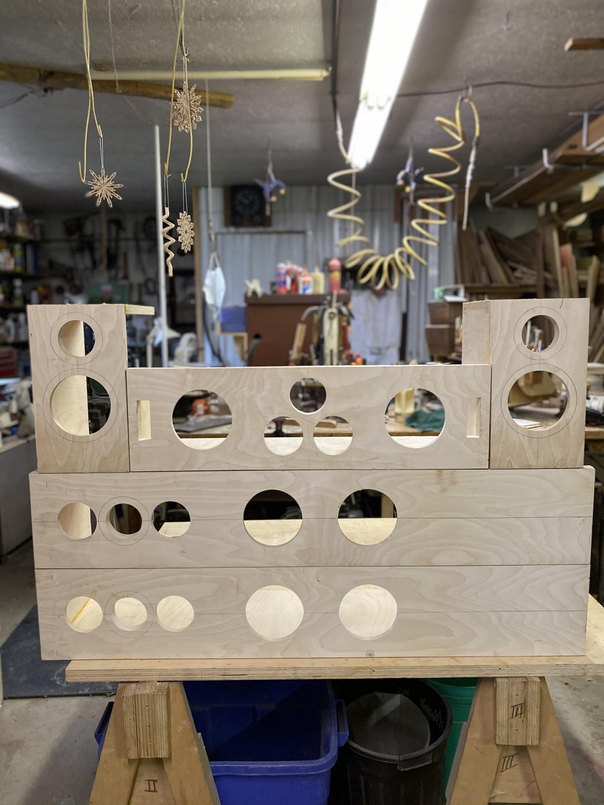

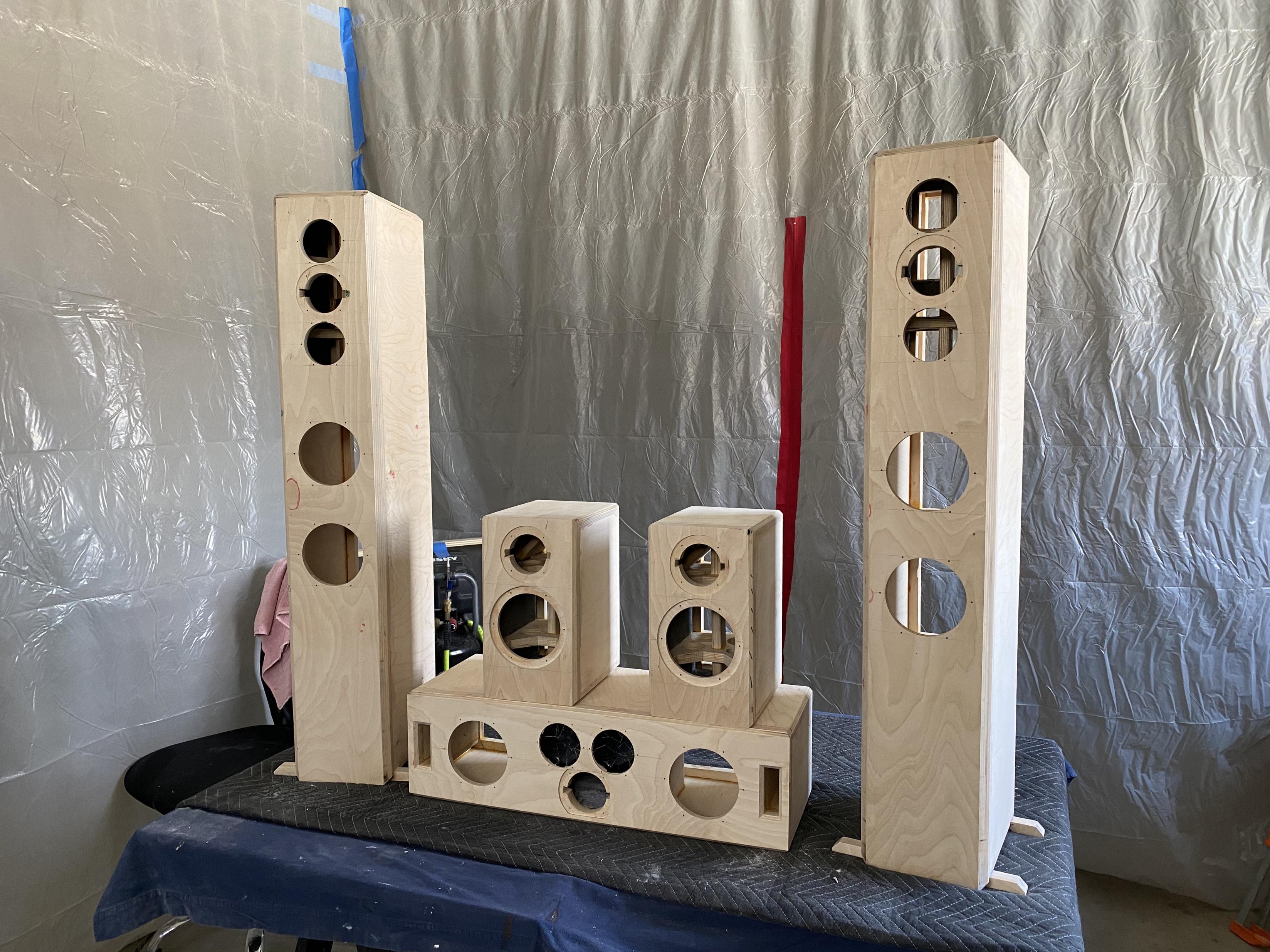

Here are some pictures from the build progress!

Speaker cabs are looking awesome. Not too hard to tell that it's not your first time working with wood. I've always found it tremendously satisfying when I have designed something and then it starts to come to life - I would hope you are feeling the same. You have come a long way actually from your first post and should be proud of yourself.

Thank you very much! Yeah this is not my first rodeo with wood. It has been very satisfying with these cabs tho! Having them come to life and everything. Thank you for the kind words. I have came a long way, but I have had great help!

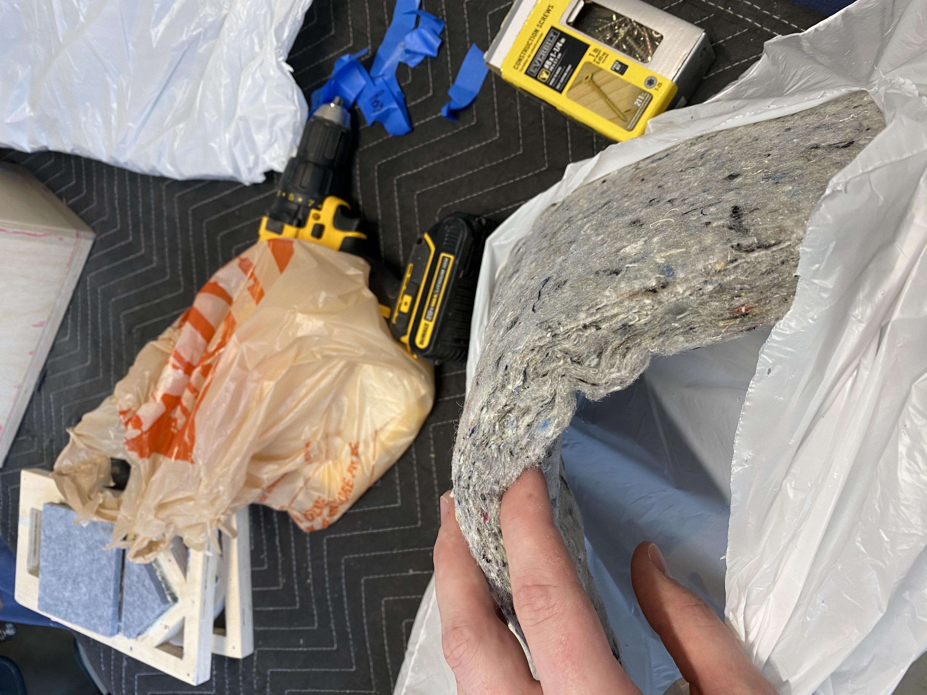

Actually just right now the Amazon felt pads just came in. As a first look I am having doubts, yet that it due to ignorance. All the felt absorption I have researched is all (more or less) flexible and easily moveable. These felt panels I just got are extremely stiff. Like I can knock on them and get an audible sounds from them. So thats odd to me, in my head it seems like they might not absorb that sound as well. Yet! I need to keep in mind that these panels need to absorb the mid range frequencies, like you said around 1kHz is the hardest to do. The description of these panels does tell me that they absorb 1kHz as well of others.
So, it seems like I need to trust the makers on this. As well as that thread you linked is also promising. At first glance they didnt seem to be great, yet with thinking about it more I think they will do just fine or great. Time to experiment! ... soon.

Well, hopefully along with the stiffness there is some density as well. It's that density and lots of it (ie. thickness) that does the better job as you go lower and lower in frequency. would have been nice if the company provided measured noise reduction at different frequencies but you can't ask for everything.
Actually in the link here the company says that it has a density of 300lbs per cubic yard. Also an average absorption coefficient of 0.8 at 5kHz, 2kHz, and 1kHz.
Who knows if theyre being truthful and accurate. But it is quite dense, I'm certain on that haha.

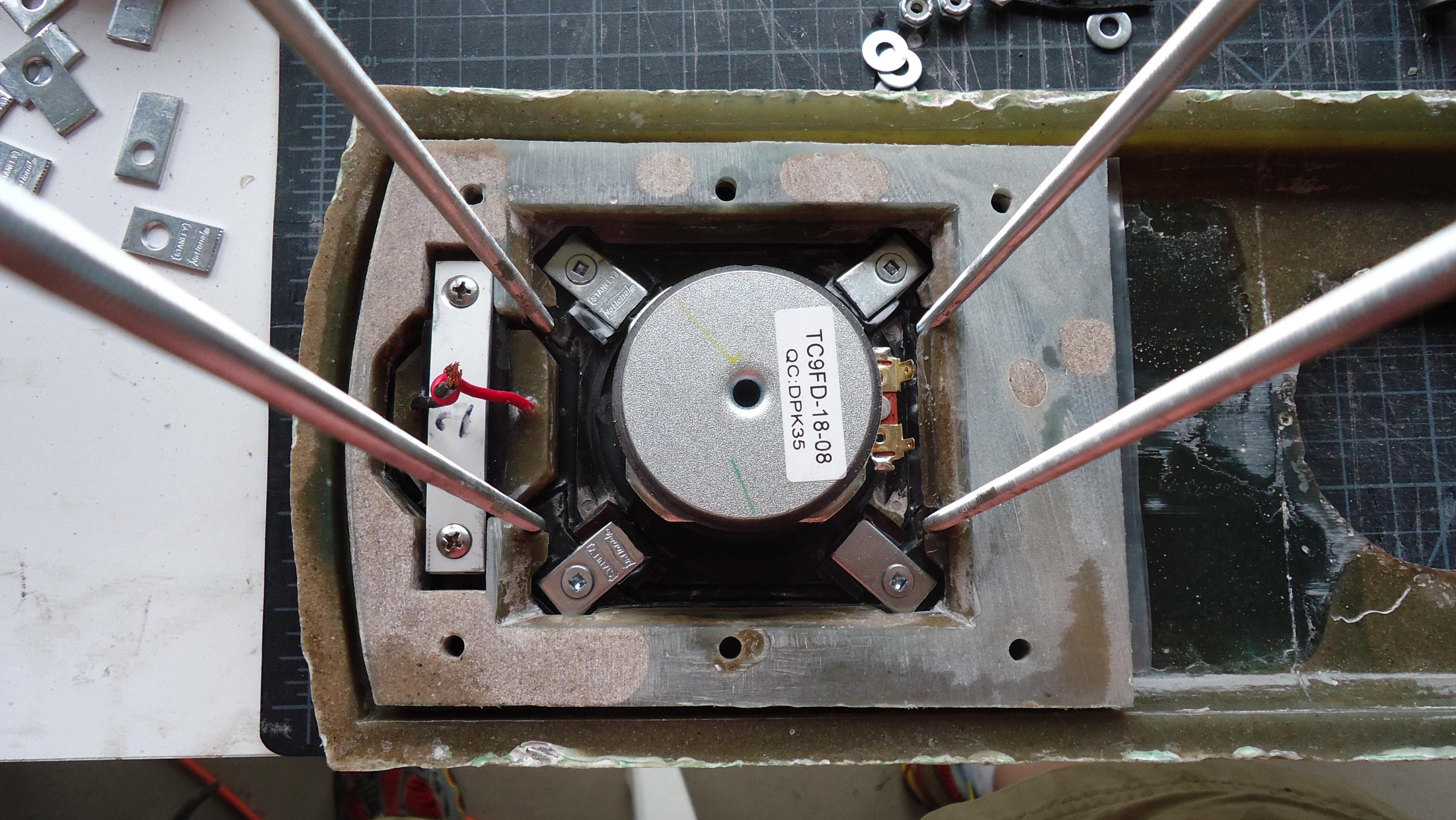

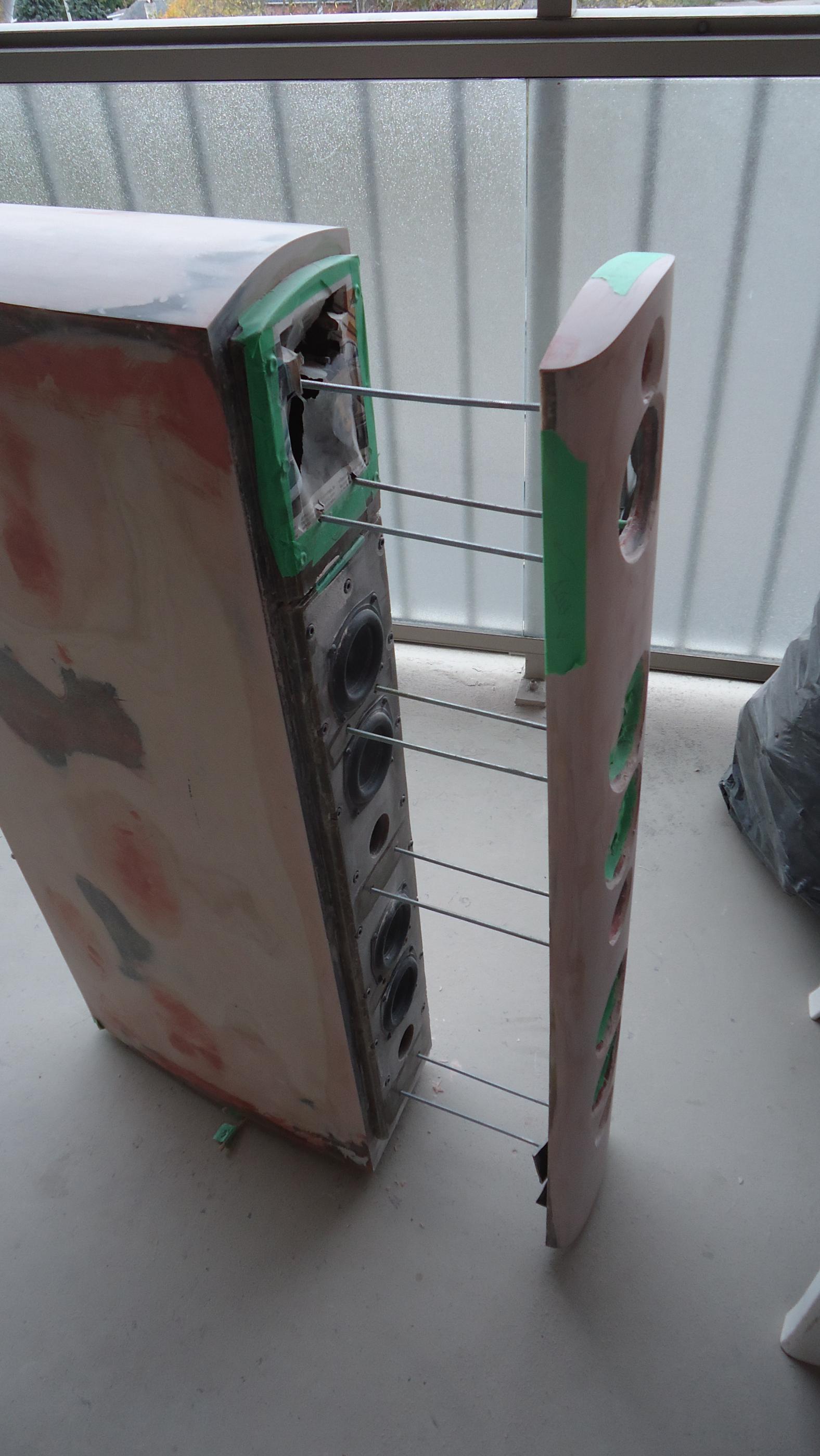

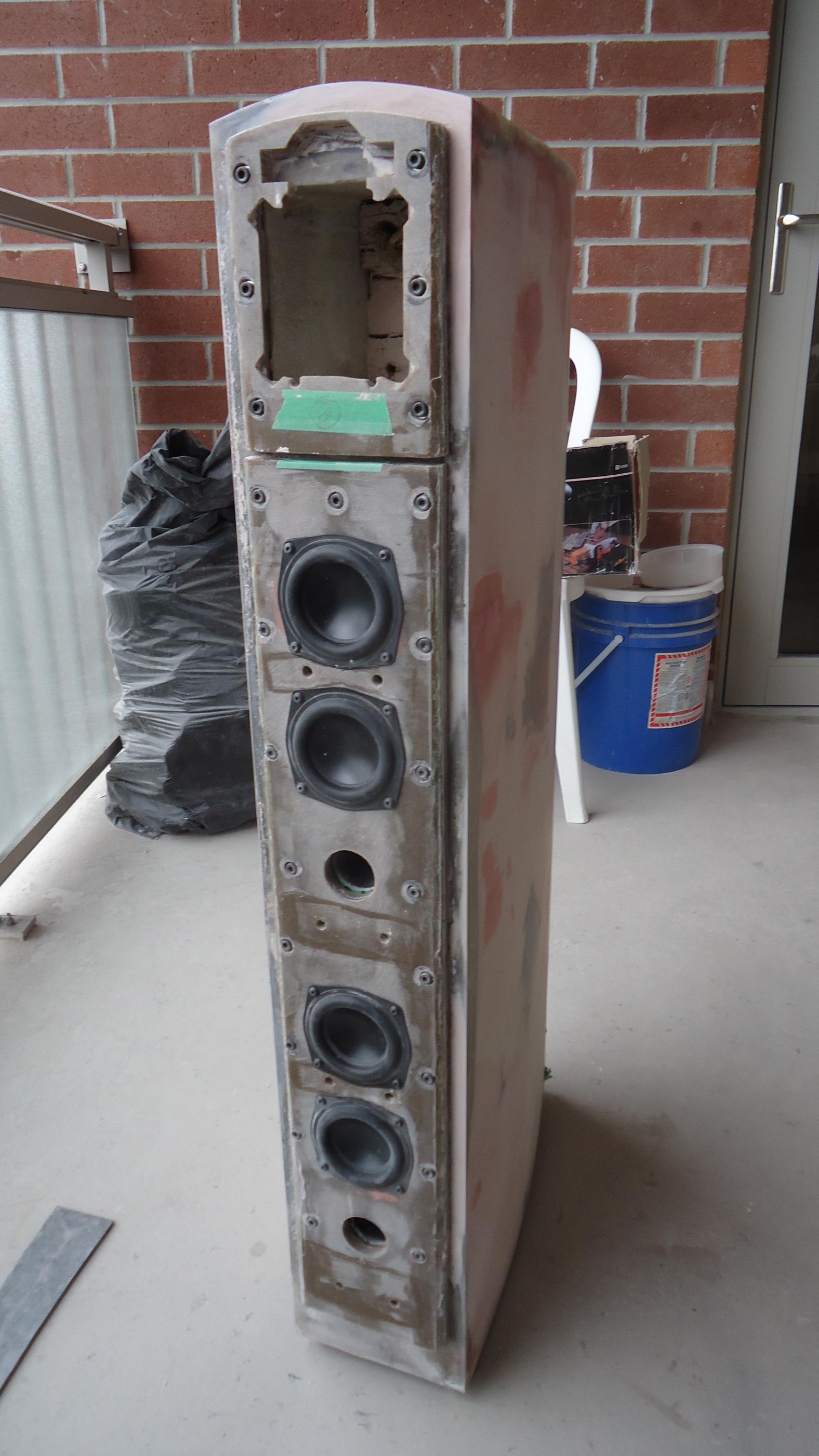

As an experiment, I recently tried out something similar to both of the above and also tried to do it without a woodworking shop, so using non-standard but easily accessible materials. For the cabinet walls, I used a cement/green glue/recycled tire rubber mats/green glue/fiberglass construction with the outer FG layer a composite of woven FG sheets/sand filled resin with embedded pieces of roofing tile/woven FG. The front baffle was done in 2 layers of FG separated by sorbathane, so again a sandwich of FG on the outsides and sand filled resin in the middle. The first layer was in 2 sections - one for the woofers and 1 for the mid and tweeter with both of these bolted on to the cement layer only. So mechanically isolated from the external FG layer and mechanically isolating the woofers from the mid and tweeter too. So woofers are attached to the 1st baffle layer but the mid and tweeter are attached to the 2nd baffle layer. Just to be sure the mid and tweeter and their method of fastening were also decoupled from the 2nd baffle layer with sorbathane. The 2nd baffle layer is attached to the speaker via threaded rods which run the depth of the cabinet and tighten at the rear. To be clear, the 2nd baffle never makes physical contact with the 1st baffle layer or any layer of the cabinet although the threaded rods do at the back. I might change that if I do it again
It was just a bit of work to put it together however and the cabinets ended up weighing a ton (~150Lb each). Since it was just experimental, I used relatively inexpensive drivers but it turned out so well that I wish now that I had done something different now. Live and learn. The drivers were 4 x Dayton ND91-8, a Wavecor FR070WA02 and a Vifa OT19NC00-04.
To test the cabinet, I put a driver inside the mid chamber, closed it off and then measured the SPL inside the chamber and then outside at the side panel wall trying in both cases to keep the mic about an equal distance from the driver. The attached graph shows the difference between the 2 - minimum attenuation was at about 300Hz and 1500Hz and was about -40dB. I'd call that pretty good.
Pics below:
1- cab + 1st baffle layers
2- cab + both front baffle layers + threaded rods
3- Inside look at the 2nd baffle layer just out of the mold
4- Fit and attachment of the TM with 1st and 2nd baffle layers

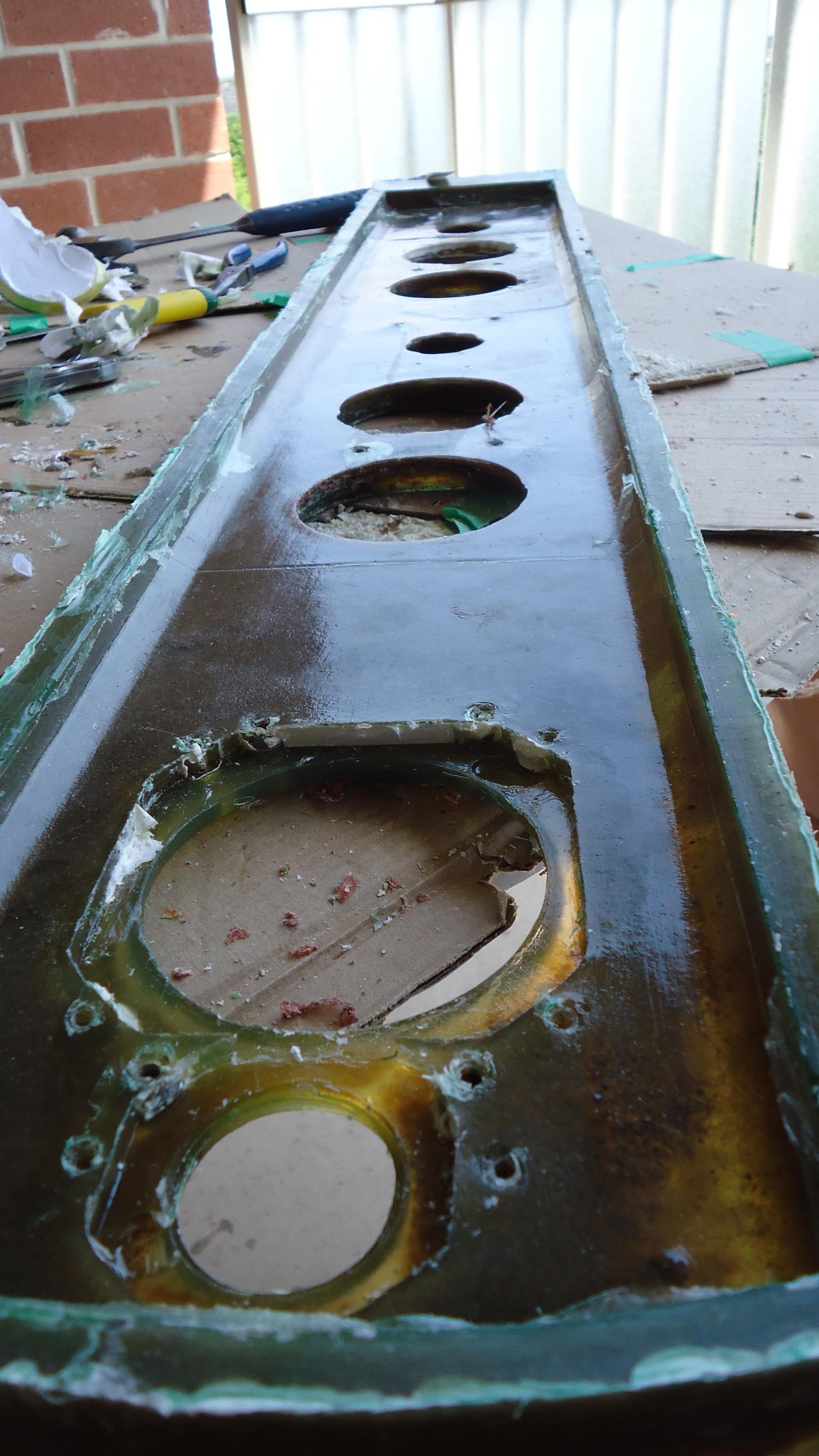

Pics below:

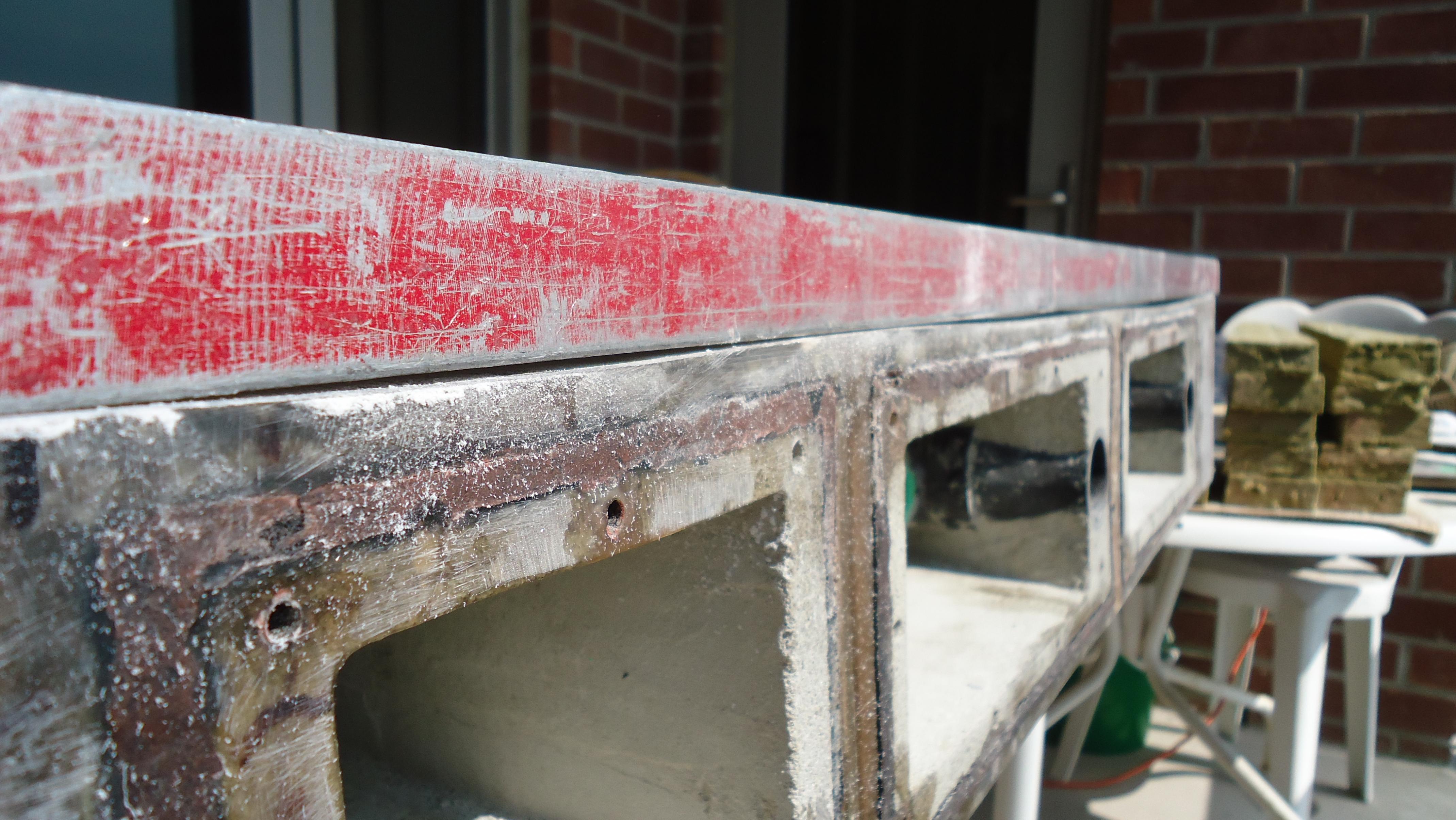

And a couple more pics:
1- Close up of the cab 3 layer wall construction (with a good look at how my FG mold failed me -> corrected with more FG and lots and lots of bondo)
2- Assembled cabs with baffle painted but cab still just with primer.

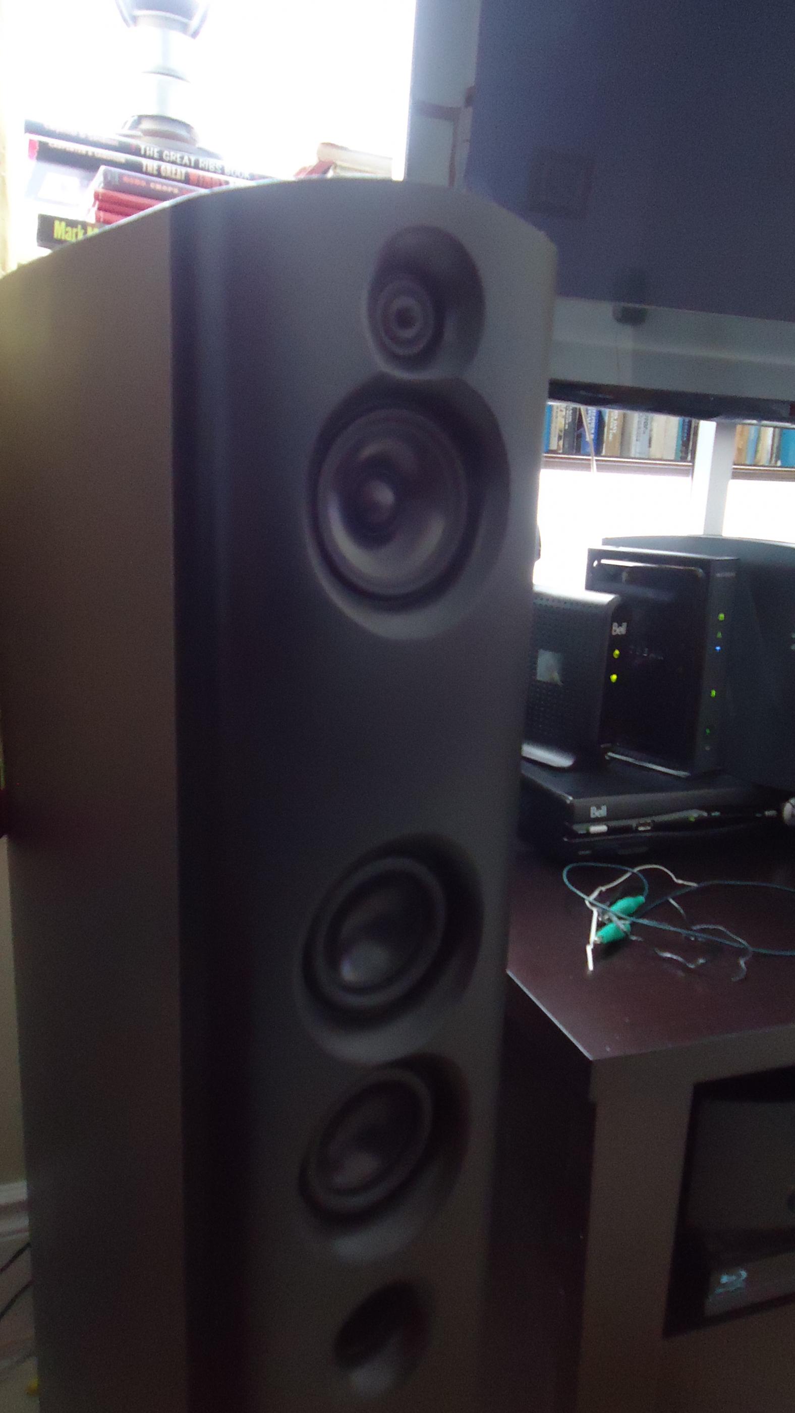

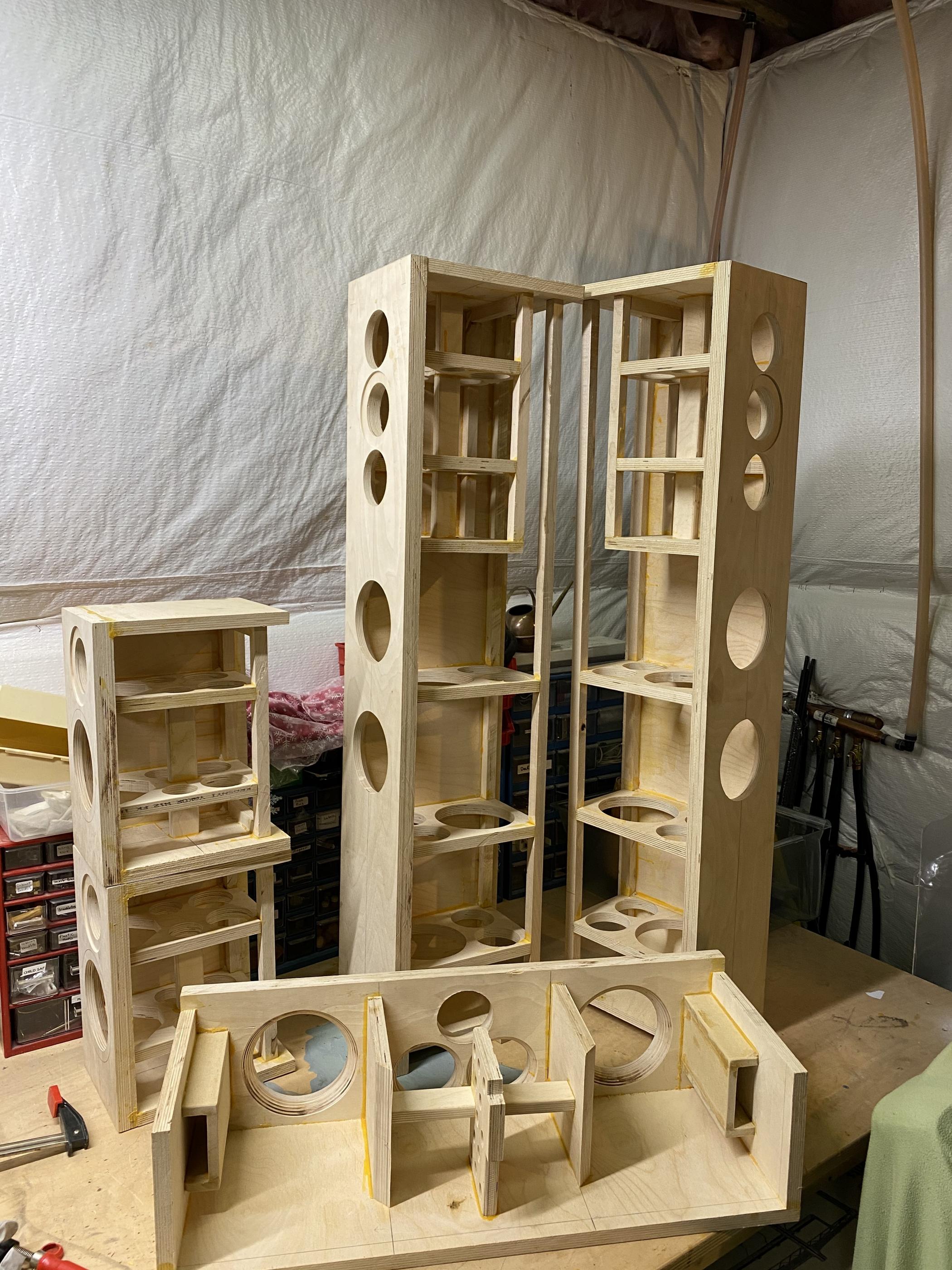

Sorry it has been so long, I have been non stop on these speakers haha.
But wow that project you did sounds very intense, but dang do i want to hear those bad boys. Judging from you explanation, I'm so intrigued. I can't believe how dang heavy those must have been haha.
Thats pretty awesome that you had the time to experiment like that. Just these wood speakers now are taking up all my time. Mostly due to having to put all the tools away everyday and clean up the dust since Im in the garage. And now its cold so sanding is take each speaker at a time outside.
Anyways, your finished product of those cabs looks amazing. Like straight out of a factory clean finish and look to them. Thats something Im trying to strive for right now and is also taking a lot of time. Is while assembling Im noticing how when some cuts are not perfectly square or straight, then towards the end of the build Ill have some problems that are so frustrating. Like the side of one of the towers not being long enough by like a 1/16" of an inch, but thats noticeable! Not to mention will make the tower not level.
Other problems as well. But im trying my best to make everything straight and square.
Also, I agree lots and lots of bondo haha

But here are a few pictures of where my progress is! The colored markings on the speakers were for me to quickly know there to bondo since the dry time is very fast. They'll never been seen after painted anyways.
So yeah I have the primer and paint bought, as well as a spray gun! So when sanding is 100% I will be covering the floor and workbench in plastic, putting a box fan backwards in the window, and painting these puppies!
Awesome. Absolutely awesome!
Your brother is going to owe you big time.

So Im starting to put the absorption in and I have finished all the felt.
Now I will start putting in the wiring and also the rest of the absorption.
Question, I have ran across the medium density cotton sheets that came in a package to insulate the food with the dry ice. The picture is attached.
What are your thoughts in using that instead of the foam mattress for the mid chambers?
