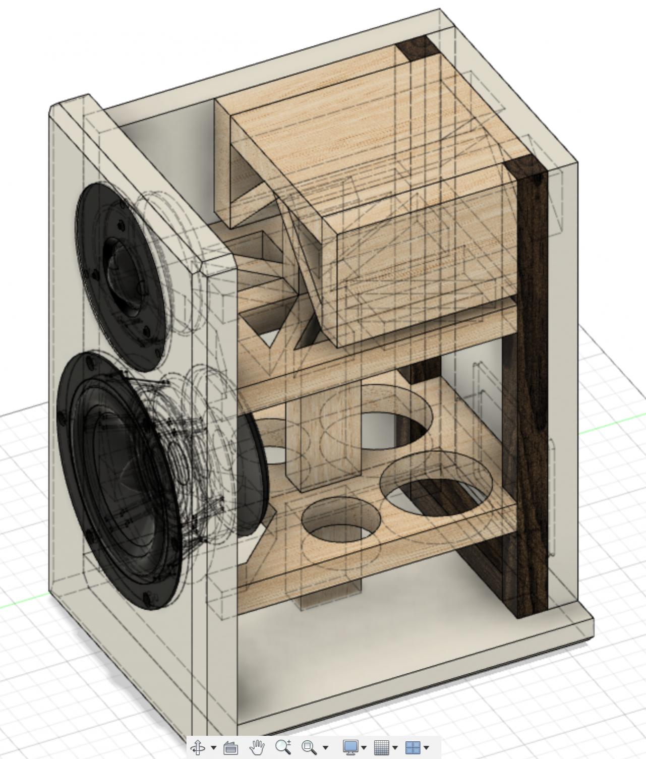

Oh my yes, my bad. I forgot to explain I have also not finished the drawing of the ports on the rears completely. But they are 1.625" x 1.625" and 6" long. That equals out to almost the minimum diameter that Unibox accepts. To yield a shorter vent. But yeah, itll workout, just havnt finished yet.
Great point actually. Maybe Ill make the back panel of the mids in the tower two pieces so it can slip down below and shimmy it out.
But I was thinking that, yet I do need that extra volume for the woofers though.

Can you not just use the existing side and top panels to make the slots work instead of adding extra pieces of wood? Ah, maybe the added strips for the removable backs will get in the way.
I wonder if 2 x 1" diameter round ports would work and just be easier too?

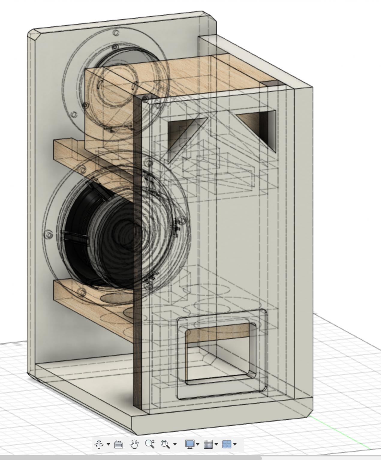

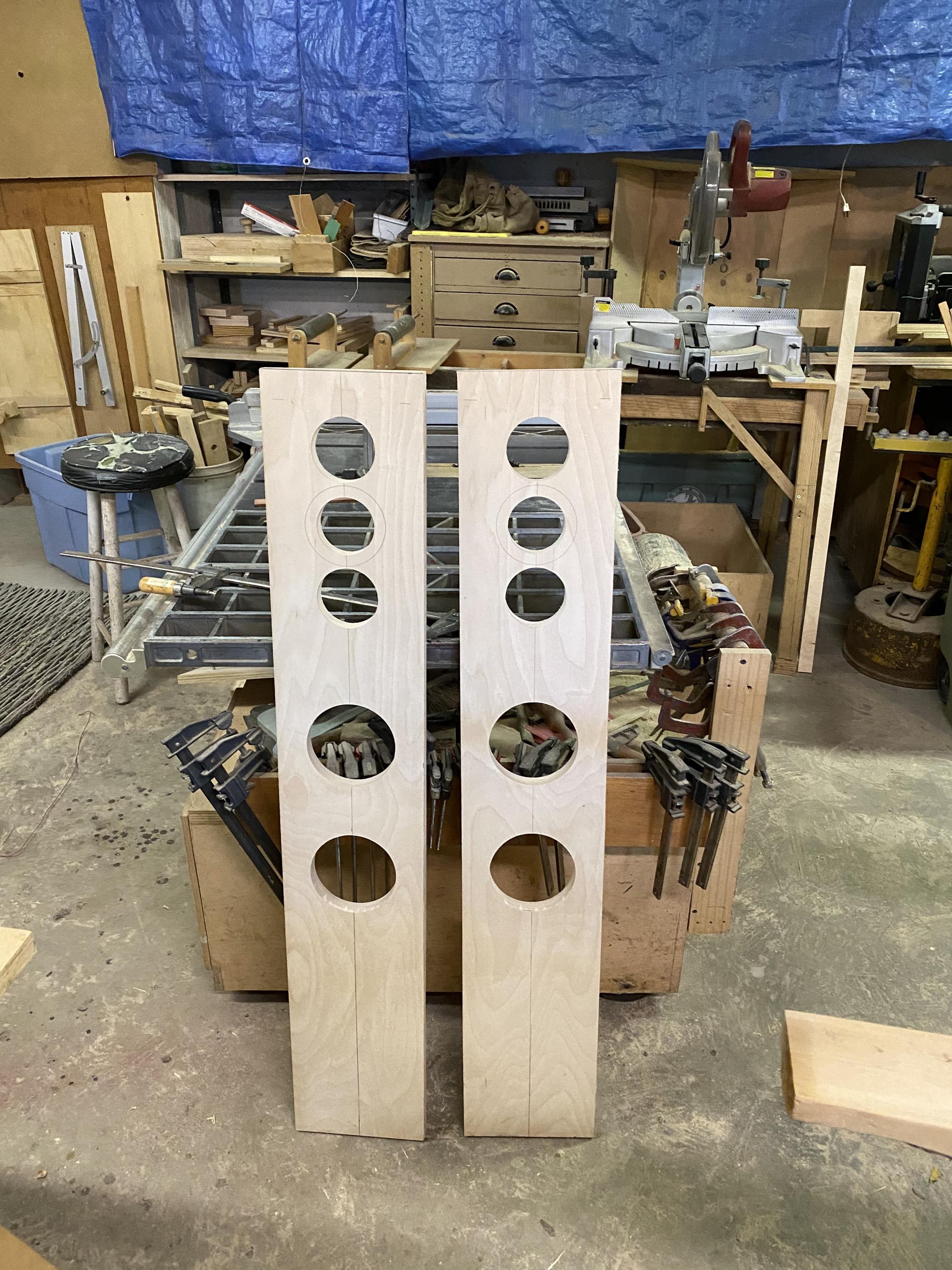

I have been building all week and I have all the pieces cut, inside and out. And I have the front baffles glued to the top&bottom and one side glued on. When I get back home I will be putting in the bracing and everything else. Then figuring out where to buy the absorption.

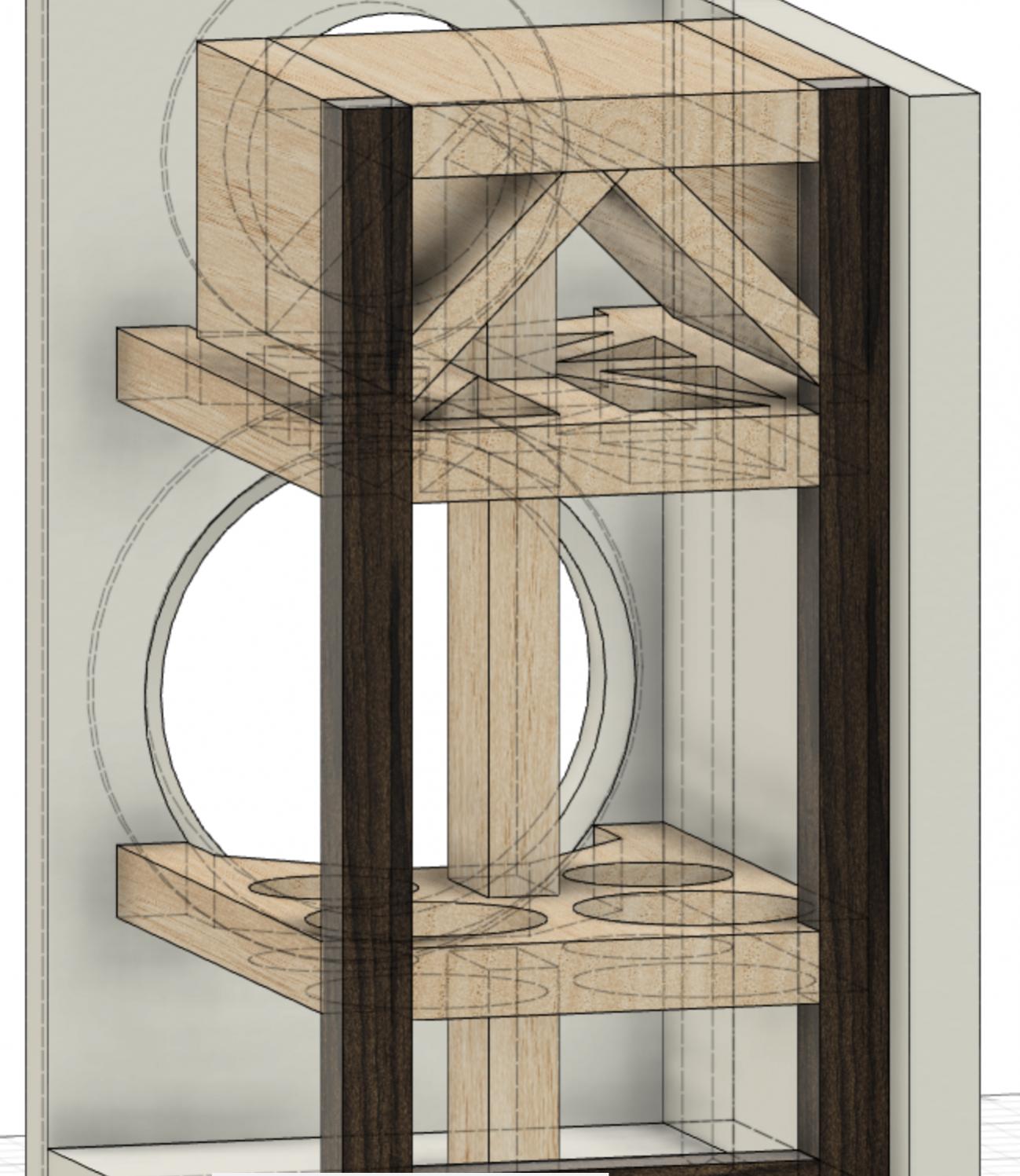

But I have decided to go with the triangle ports, yet I am going to use 1/4" wood instead of the 1/2" thats in that picture.
Also, I have ditched the starburst pattern window brace because it would take way too long to cut. Since drilling out a hole was easier and much quicker, I went with that. Also, you had said how changing the bracing shapes might help with standing waves. While that does seem like it still is a good idea, the absorption will deal with the standing waves.
Here is just a few photos from building.

I was wondering if you had started the construction. Looks excellent. Don't worry about some of the smaller details - the right choices are the ones that work best for your priorities.
Keep up the good work.

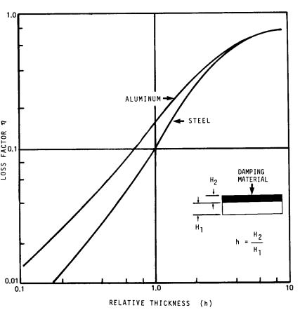

That's for extensional damping but you might also think about constrained layer damping which is adding a 2nd layer of stiff material (wood, concrete board, real hard and heavy (ceramic?) tiles, etc.) with a viscoelastic layer in between (green glue). Resonances are damped via the energy loss of the sheering action of the 2 layers as the panels bend and resonate. Supposed to be better than extensional damping but I don't have a good enough handle on all the details to inform you on that topic.

I have a sort of rule of proportion that I use which sort of says that the quality of the cabinet and the damping and the absorption etc as well as the quality of the xo components should be about equivalent to the quality of the drivers. It sort of works with the amount of money I spend in each category too. So you've picked some very good drivers, particularly good value drivers but they are not exactly ScanSpeak Revelators, or SB Acoustic Satori's or Accuton ceramics or so on. So I'm not sure I'd be spending too much money on cabinet fill when all is said and done. Unless of course you really want to......
Re extensional damping: a thin layer like 1/8" is unfortunately almost useless up against 3/4" wood. Up against 1" wood it'll be totally useless. I was doing some further reading into damping and below is a chart I came across showing damping effectiveness (vertical scale) against the relative thickness of top layered damping - which just confirmed for me that extensional damping needs to be at least 1/2 the thickness of the rigid panel thickness if not more to be effective.
So with roofing tiles make them about as thick as you can. And I think what is very important is to bond them together well enough so that they form essentially 1 thick solid heavy but flexible mass. And bond it well to the panels too. PL Premium is my glue of choice for this type of heavy duty application but Liquid Nails may be just about as good but I'm not sure about that.
