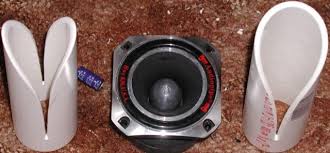

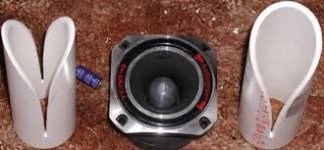

Thanks, interesting to read of your findings with longer K-Tubes vs shorter ones. I should ask if you are using a single cut away K-Tube or a double cutaway version. I use a double cutaway with the slot oriented vertically and have good results with short 1/4 wave tubed set at the drivers primary resonance or first impedance peak (when supplied by the maker in their impedance curve of the compression driver).

single and double cutaway K-Tubes photo

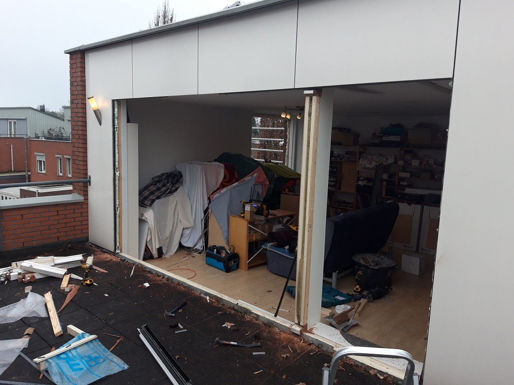

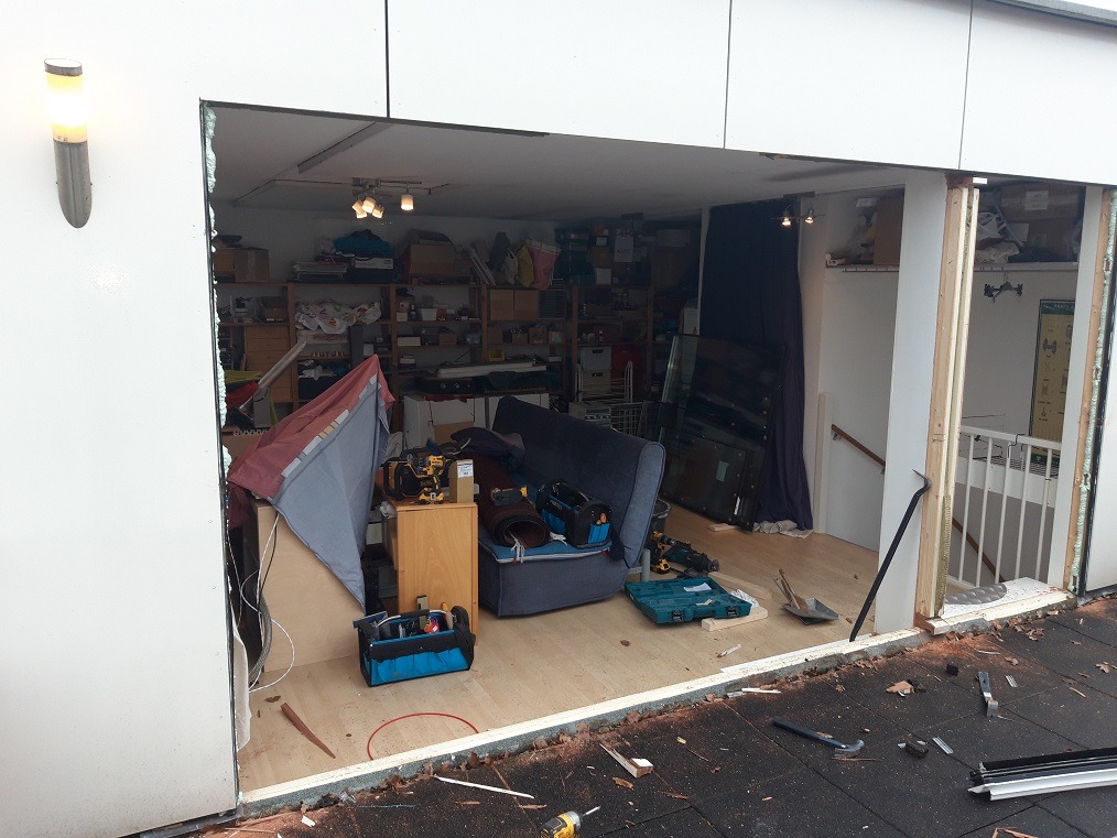

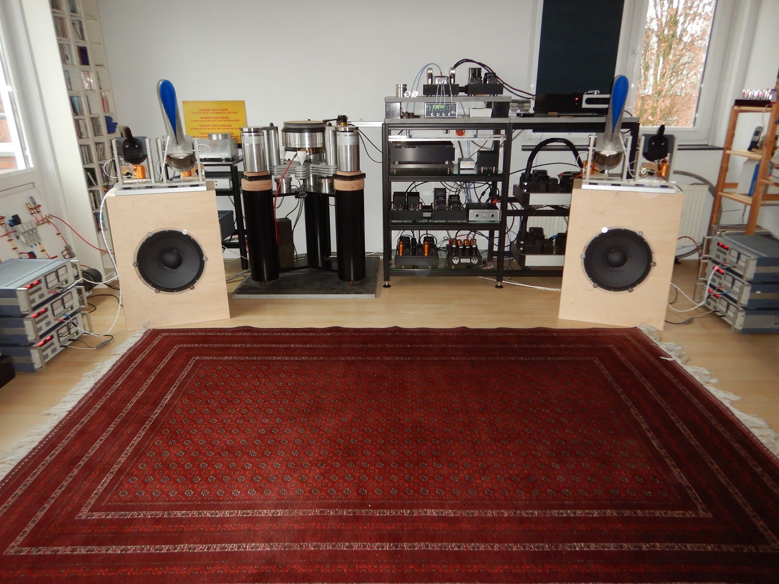

House renovation finally done. All frames and windows have been exchanged so it was cold the last week in a house without glass....
Luckily there was no rain as all stuff was quite exposed; also the audio set.
So the set was totally stripped down; perfect timing for a grand overhaul:

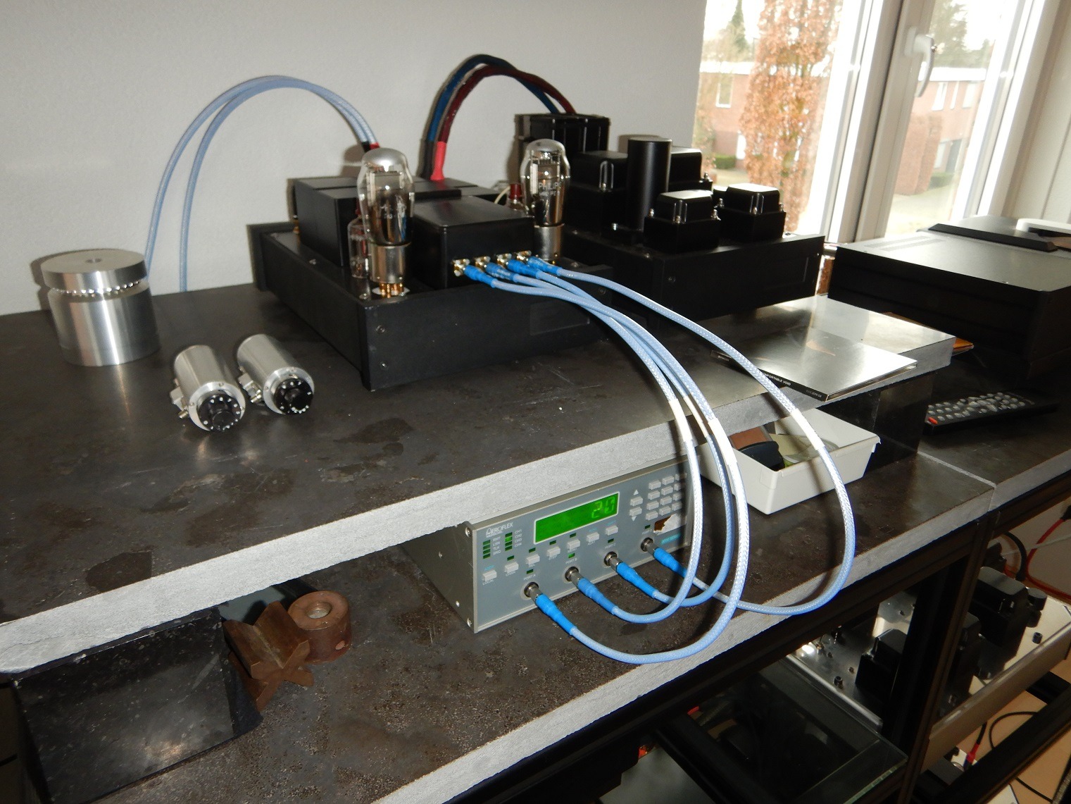

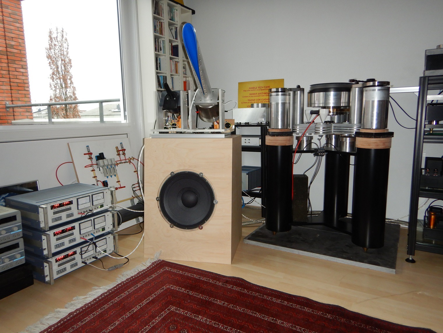

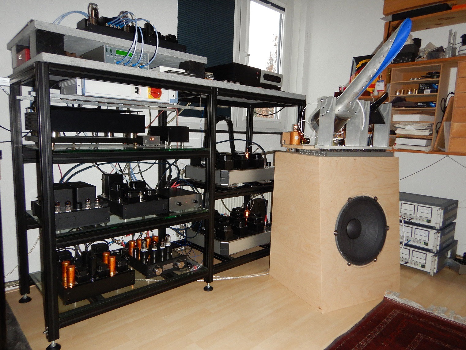

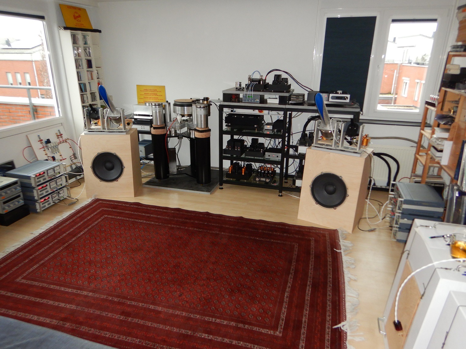

  • new cabling (both signal and the power lines)
  • dedicated Rohde & Schwarz power supplies for each field coil. So i have a stack of these next to each speaker. Stable stuff !
  • running in of first tweeter-amp tube combo (4P1L and ED111 tubes)
  • running in of external volume control in preamp. The original attenuators were decades old from R&S measurement gear and i could here the switching noises. So i opted for a 2 GHz-solution by Weinschel. Never meant for this purpose but it works flawless
Happy with the result. Snappy drivers and a natural performance.
I had to tilt the Karlson's (mid and high) from 45 degrees to a more direct pointed 35 degree to get the optimum sound. Tilting it more had a "more in your face" presentation. Still funny to see/hear that tilting the drivers/K-tubes bring such an effect. This is all personal taste !
Still waiting for the CNC made K-tubes.......COVID19 doesn't help.
In the meantime i can enjoy the current set and find out the optimal tube combo in the tweeter amp.
A wonderfull 2022 to all.
Reinout
