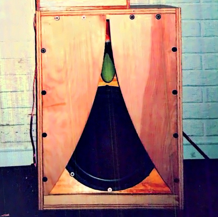

GregB really helped with his "Karlsonator". Suntiger build's K with curved reflectors and employs K-tubes.

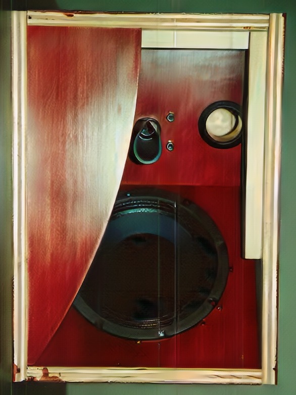

I think the little K3.5 with Faital 3fe35 sounds pretty good (Lapaire preferred it sans aperture) - its in this thread: https://www.diyaudio.com/community/threads/heres-a-little-k3-5-plan-i-missed.379978/
Here's two K-ish tweeters both using a Faiatal 3fe35

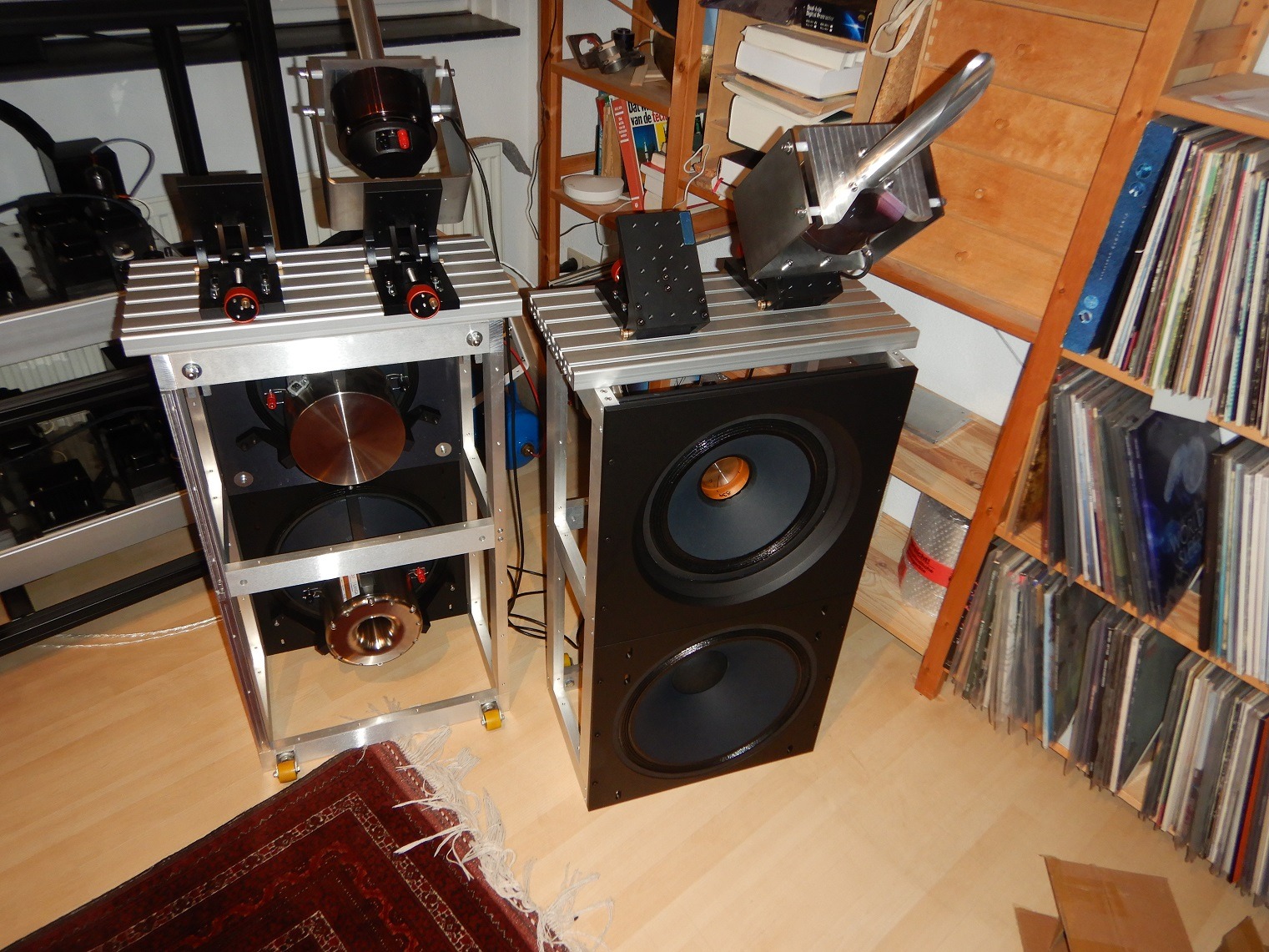

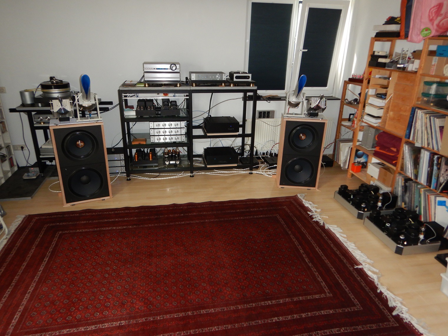

Already some time ago since i posted here so this will be a somewhat longer addition....
Very happy with the 1" and 2" k-tube results. I see/hear no reason to change them ....the question is how to improve them so the total (sound)package becomes better.....
I use a 3 way system as my main loudspeker-system (15" woofer + 2" k-tube + 1" k-tube) and i have a 2 way system (10" mid/bas + 1" k-tube) for demo-purposes. Both work good but that 10" driver has an enthousiastic nature that is missed at the larger system (...that goes deeper..). So the plan: make a 4 way system with the best drivers from both systems and use those drivers in the most linear possibility.

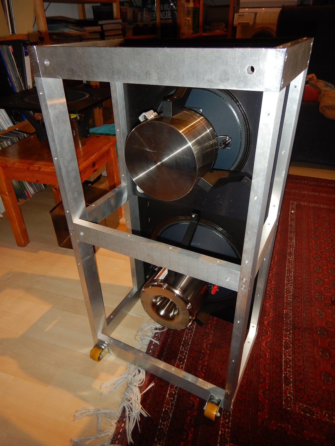

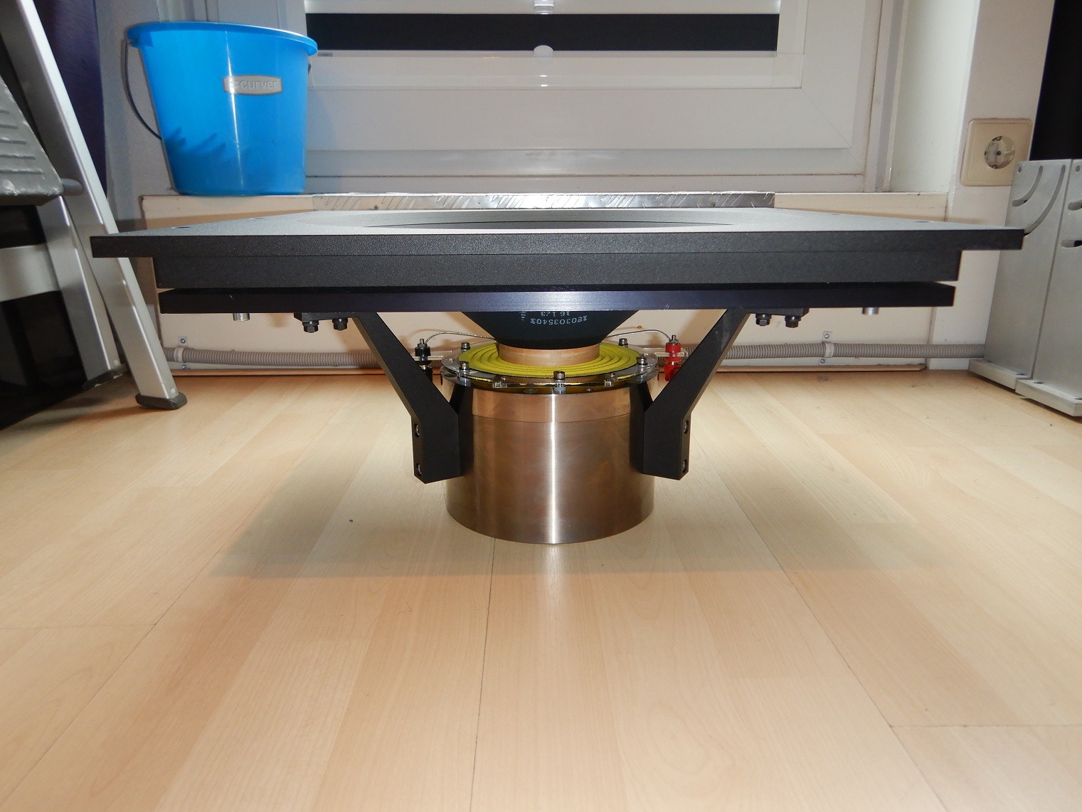

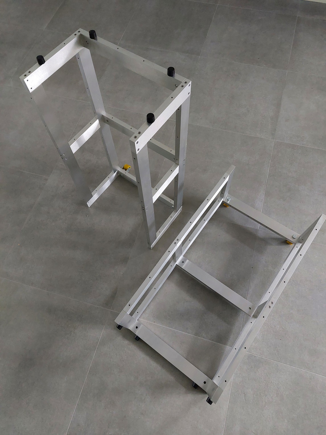

As all drivers are fieldcoils each weighs between 6 and 20 kgs so from the start this speaker system had to be made modular as i want to take it to the ETF (European Triode Festival; a 4day audionerd gathering of serious level).

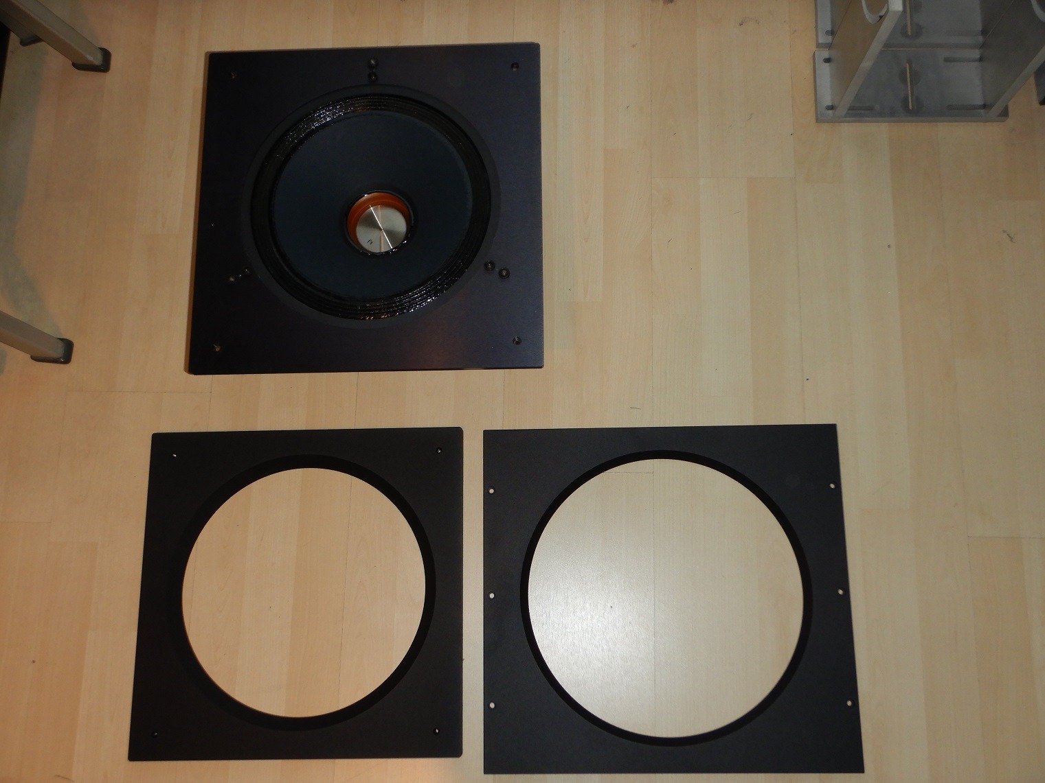

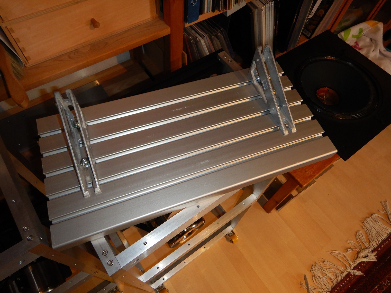

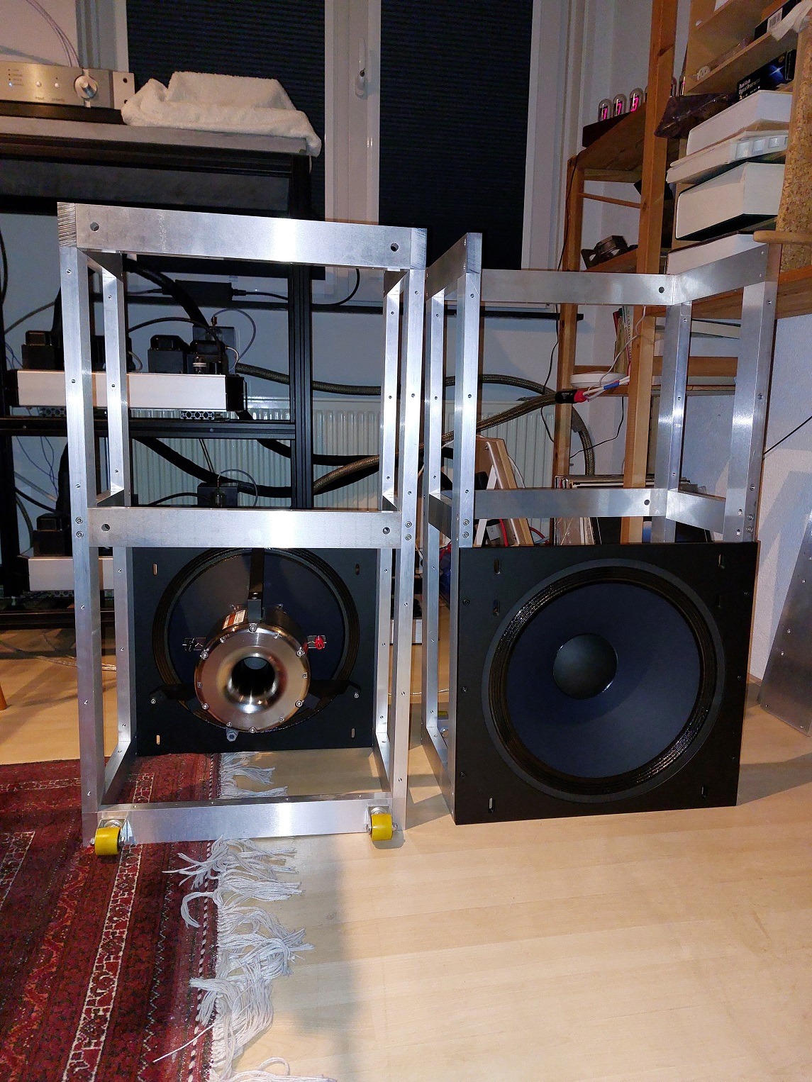

So starting with a 20x50 mm aluminium frame. Lucky i could use a prototype frame that was intended for the 15" woofer.

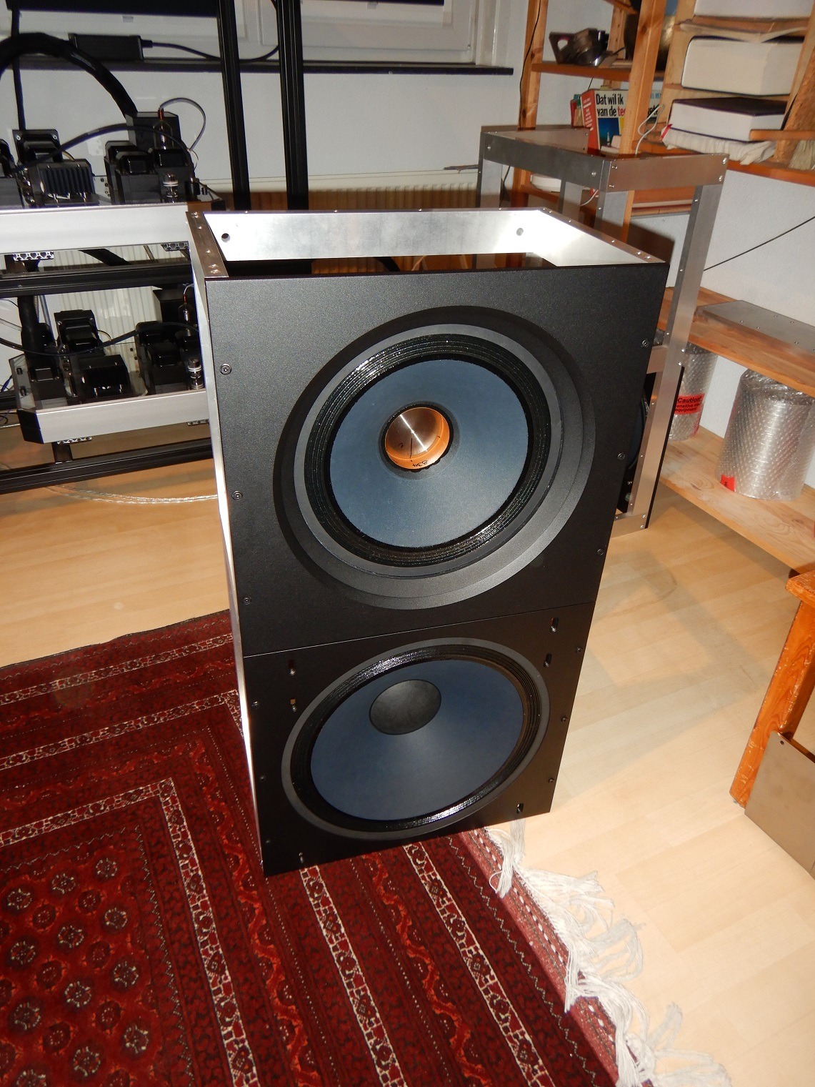

So the 15" woofer fitted without problems.
Next in line was the 10" which of course did not fit. A subframe to the rescue !

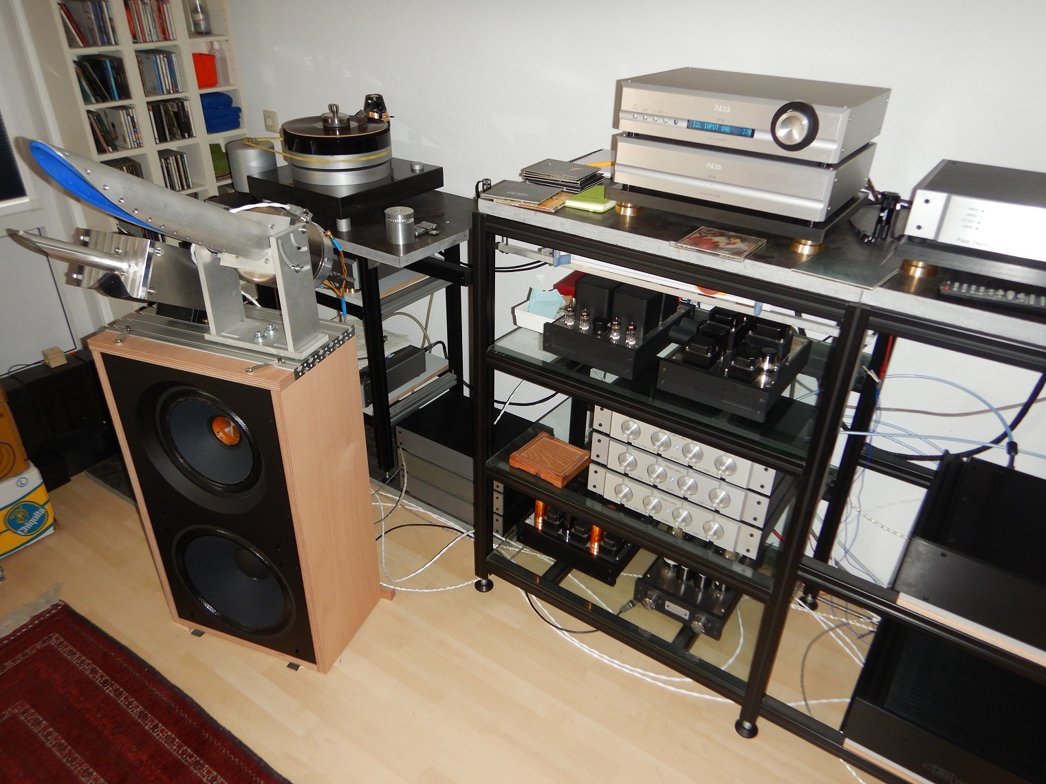

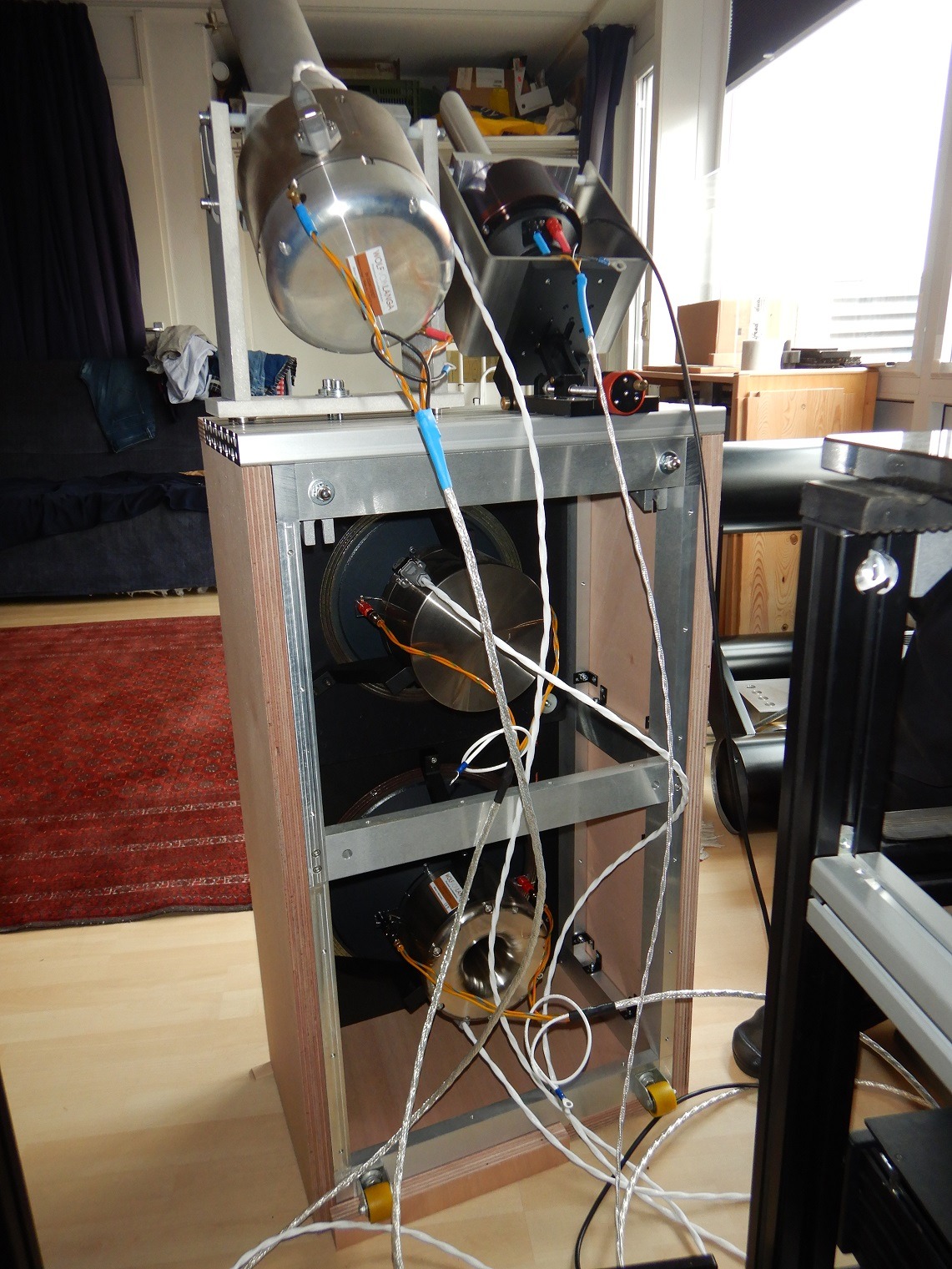

Happy with the result so now the compression-drivers + k-tubes had to be mounted on top. I wanted to "direct" the sound-coverage of those k-tubes so i made them on a swivveling base.
Very happy with this build, together with a stash of Pass Labs XVR-1's (analog active crossovers) they perform wonderfull.
Of course i needed another amplifier to fire up the 4th way in the system. A First Watt amp to the rescue ! I was able to get both a F1 (current amp !) and a F8 and currently i'm swapping amps to find the optimum match amp-driver. It will be a fun mix of diy tube amps and First Watt products (never used them but especially that F1 made a wonderfull first impression on the woofer.....and me)
A shame here in Europe First Watt products are impossible to audition. Glad with this forum so i can gain valuable insights before i make the following First Watt decision. Serious tempted for a First Watt SIT-4......
Integration of tubes & transistors, K-tubes & cones, push-pull & single ended, etc works. It takes time but the total result is pretty ok at this moment.
Just listened to Tin Pan Alley and that magic worked. Serious dynamic and lifelike.
Hydrophonic Gardens by Carbon Based Lifeforms simply proved that this system is technically correct; otherwise that bass was not possible (positively shocking).
And now finetuning !
Regards, Reinout

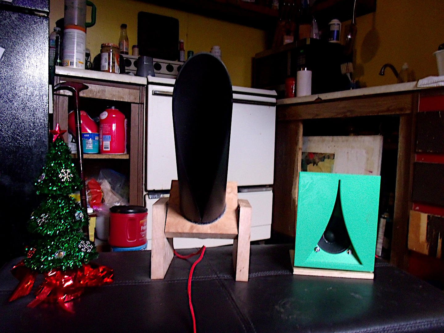

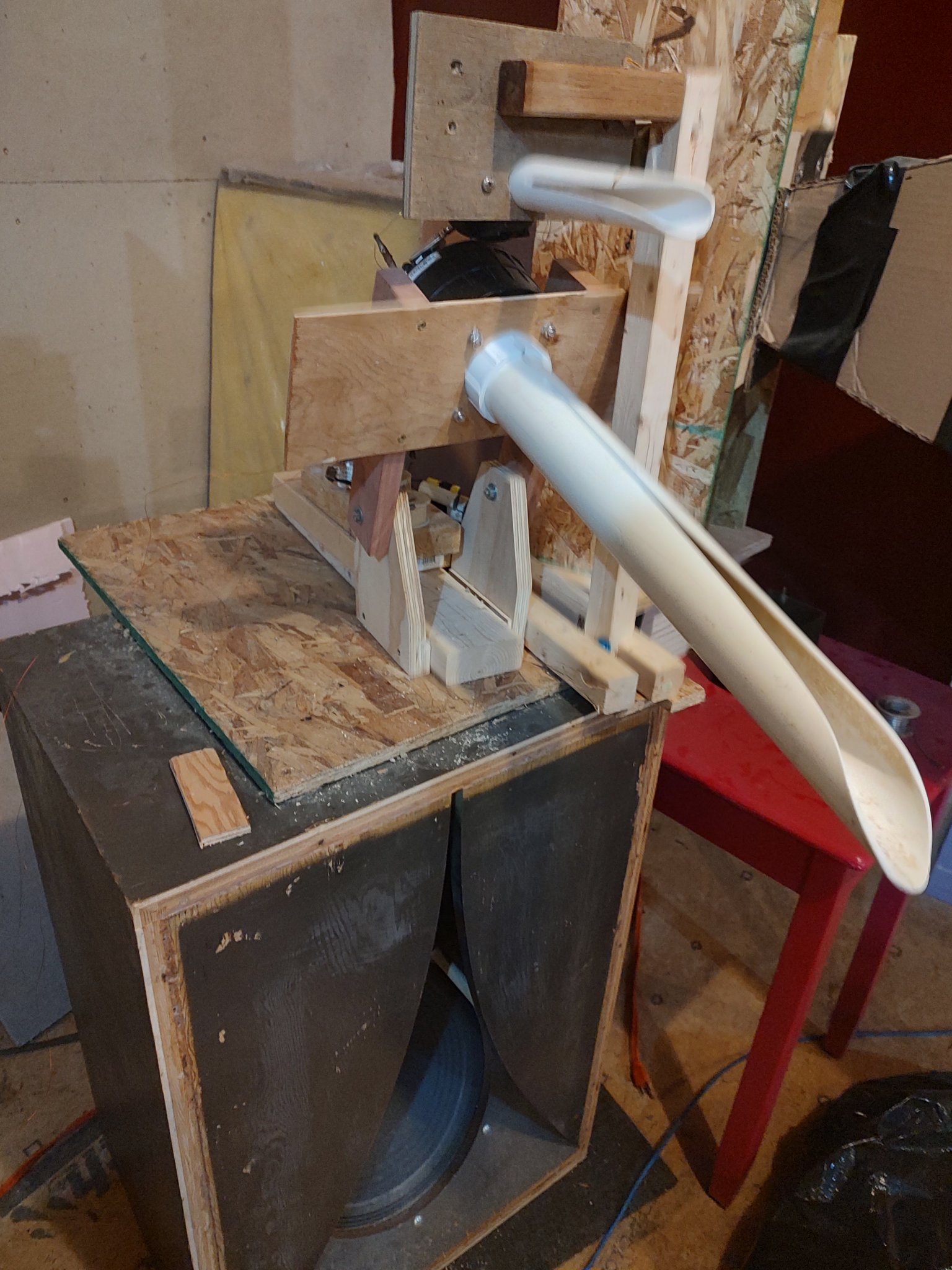

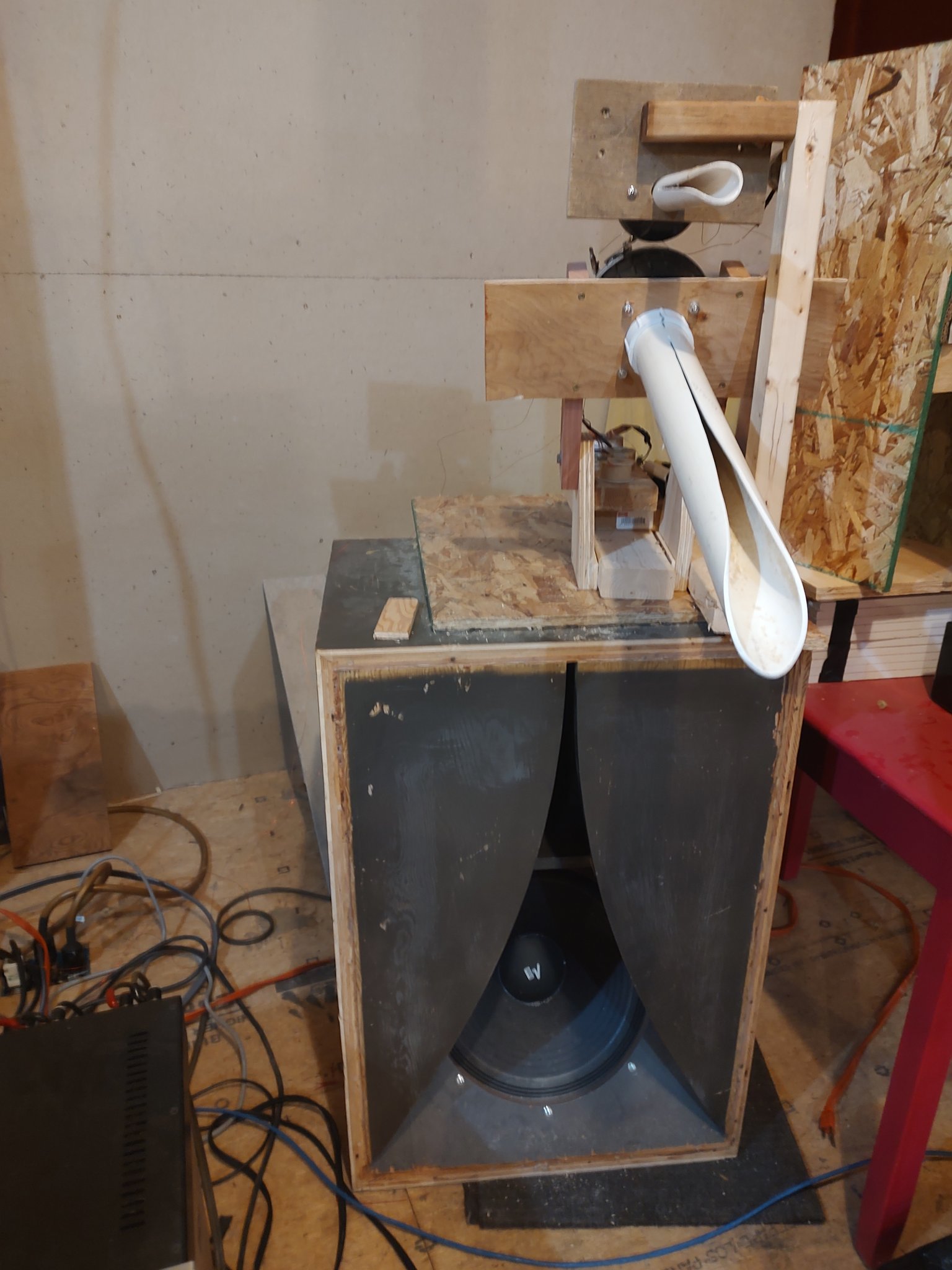

I was intrigued by Reinout's experiments and reports about his midrange Transylvania tubes, so I am conducting my own experiment. I found a good deal on a pair of B & C DCM420 2 inch compression drivers and cobbled together a wooden support system and 2 inch PVC pipe (20 inch long) which I fashioned into Trans tubes. I also mounted the 1 inch tweeter Transylvania tube just above the midrange Trans tube. Note that both are resting above a 15 inch Karlson bass system, and operating below 60 hz is a tapped pipe subwwoofer.
The midrange tube is angled 20 degrees below horizontal, while the tweeter Trans tube is aimed directly at the listening position. The only crossover component is an inductor low-passing the midrange output at about 1 khz. - the resulting frequency response is reasonably flat. The frequency response of the midrange Trans tube is 500 to ~8 khz. I hope to extend the frequency response down to 350 hz which is a good spot for crossing over to the Karlson K15 boxes. I will live with this for a few weeks as the compression drivers break in and then reassess the frequency response and crossover.
The midrange is 4 db less efficient compared to Lowther DX65 drivers in front waveguides, which is not a small deal with SE tube amps. I will gain a little of this back when I swap out a large inductor for the inductor I am using now, which is comprised of three smaller inductors in series to achieve the needed inductance value, but adds 0.7 ohms in series with the nominal 8 ohm compression drivers. While the Lowther drivers with diffusers mounted in front of them provides good quality sound for multiple sitting positions, the Trans tubes seem to be even better, which is good for when I use this system as a home movie theater. The other desirable aspect of this system, compared to a front horns or waveguides, is its simplicity,
Enough for now....
Retsel
