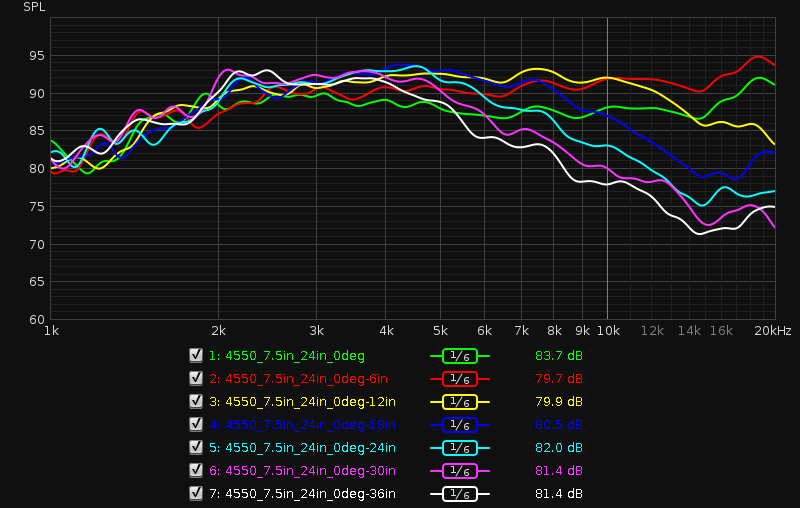

My latest K-Tube measurements and DonVK`s ABEC model are making me re-think how I set them up in addition to their crossover and EQ. I was wondering if you`re EQing yours in any way. In its vertical window, ignoring the un-slotted side, the 1" format 5.3" long tube rolls-off ~12dB/oct above a varying kneepoint with increasing listening angle. I would assume your TPC tube might be roughly like the blue trace below.
vertical_24in-png.1014046
Your larger mid-tube probably does similar, with the effect simply shifted-down in frequency.
Of course the response of your FC driver will factor-in heavily and ultimately, the in-room power response will balance things out. I think your listening angle is pretty reasonable. I know I would likely need a bit of EQ above ~8kHz with my BMS 4550 or 4540ND and the level of absorption in my room, if set-up as you.

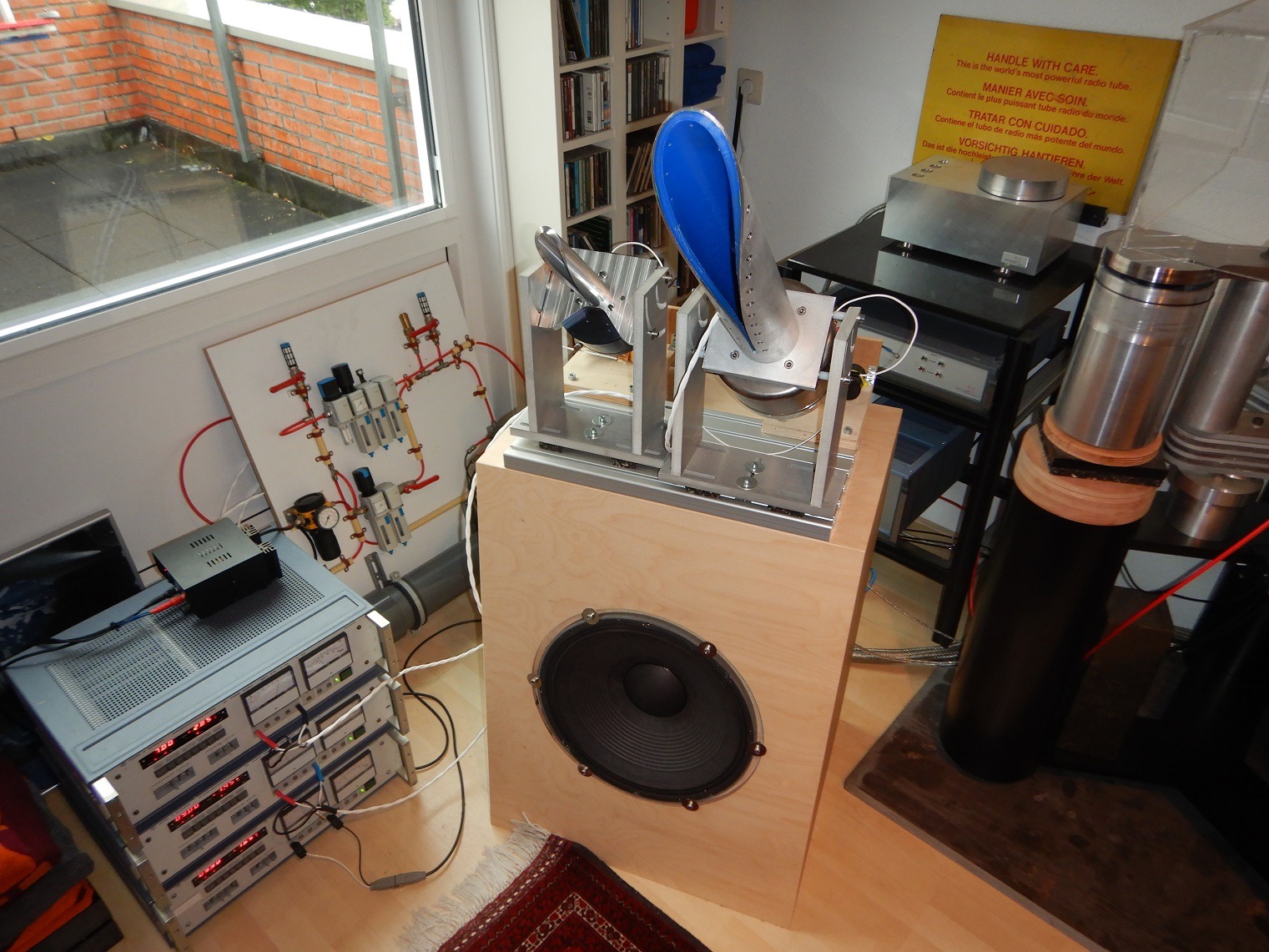

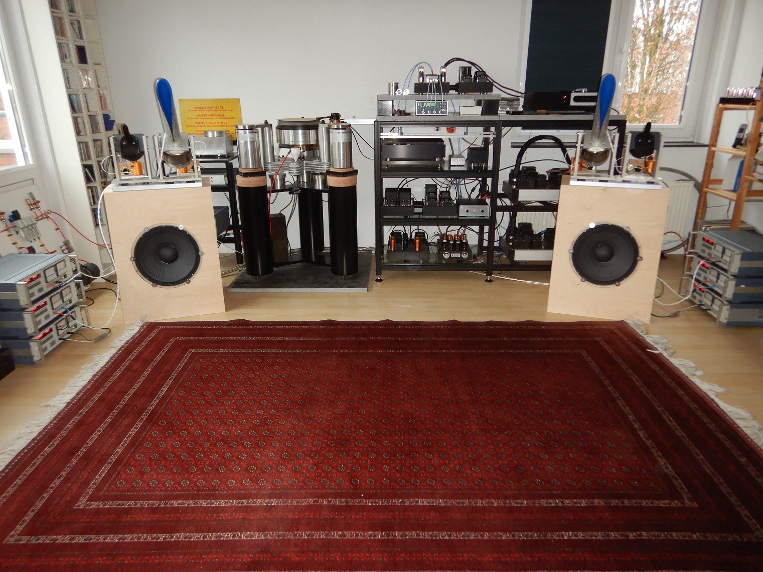

Good afternoon IG81,

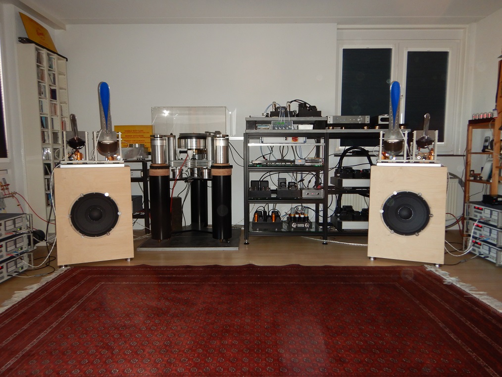

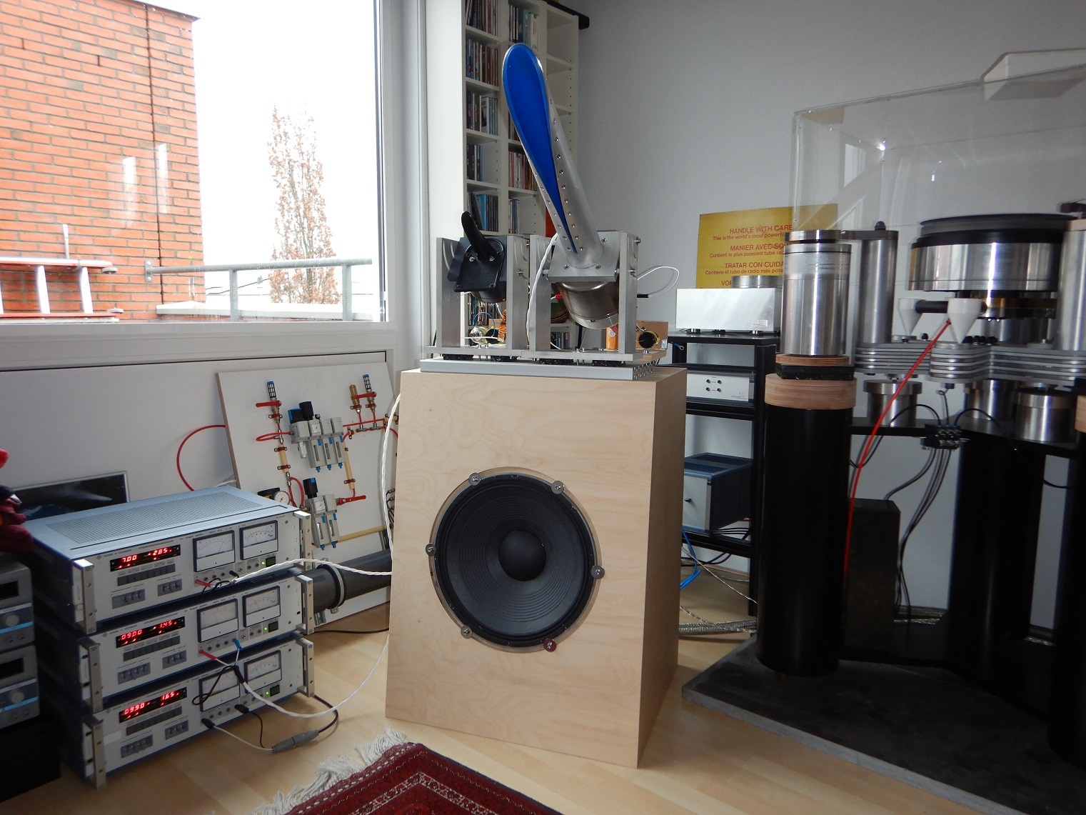

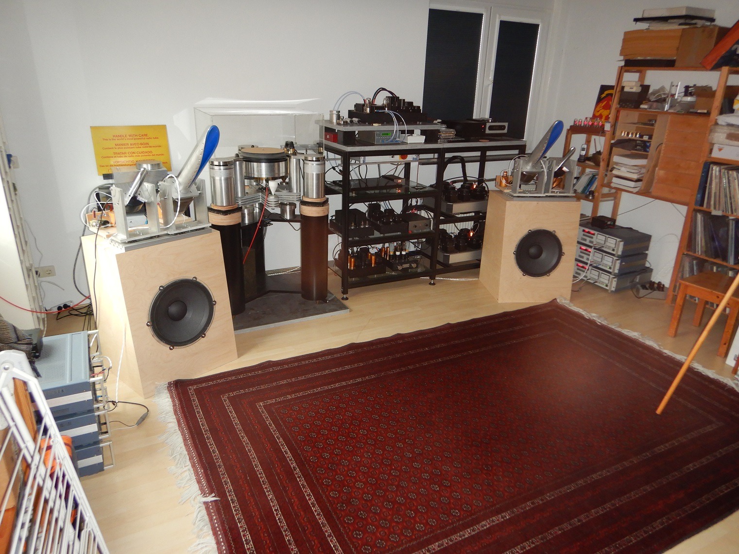

i don't have that speaker-measuring stuff myself. Most of the time it is "using the ears" and tune the output till proper musical presentation (together with our audio group).

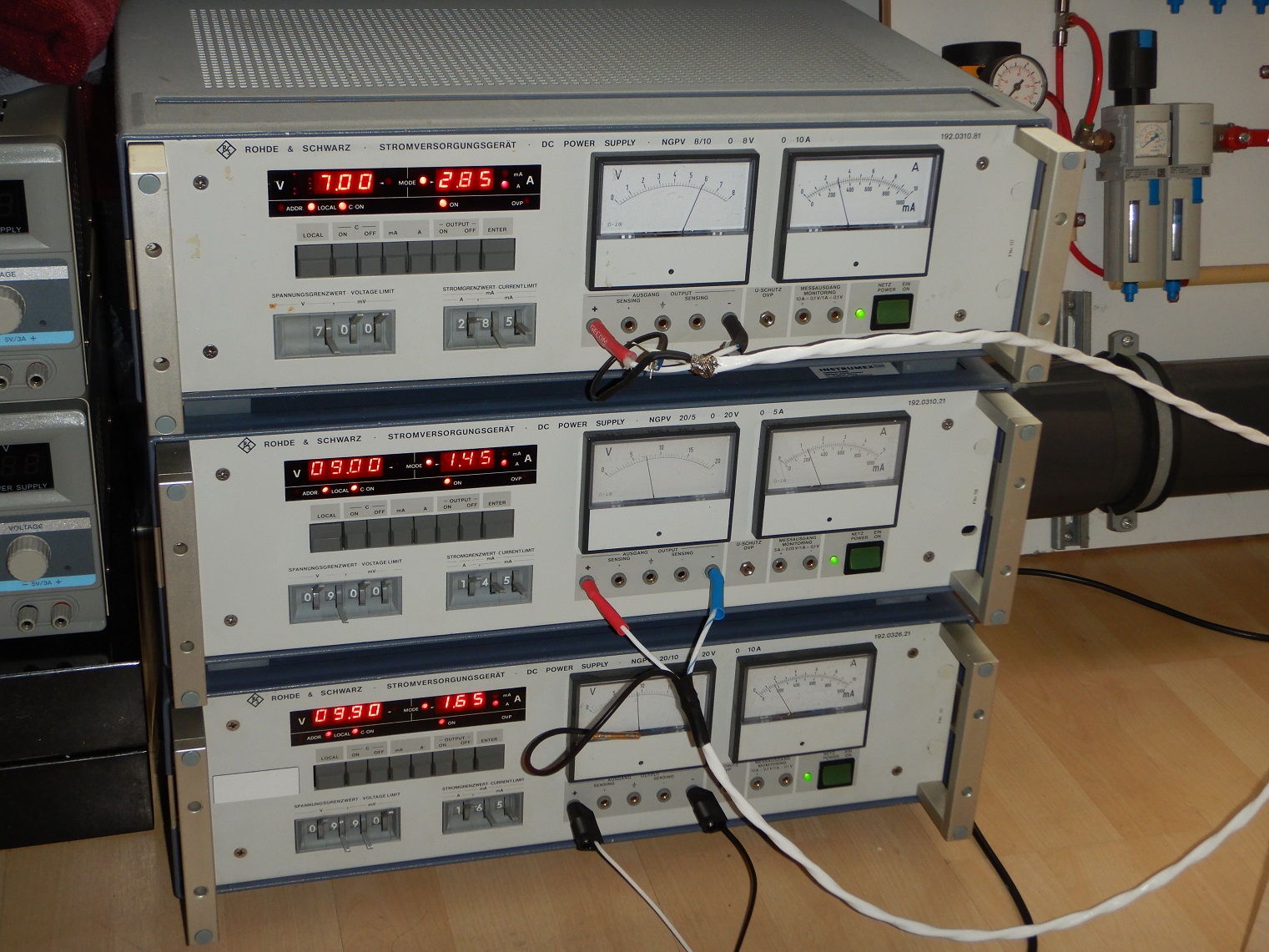

My set makes it possible to do a lot of smaller/larger changes:

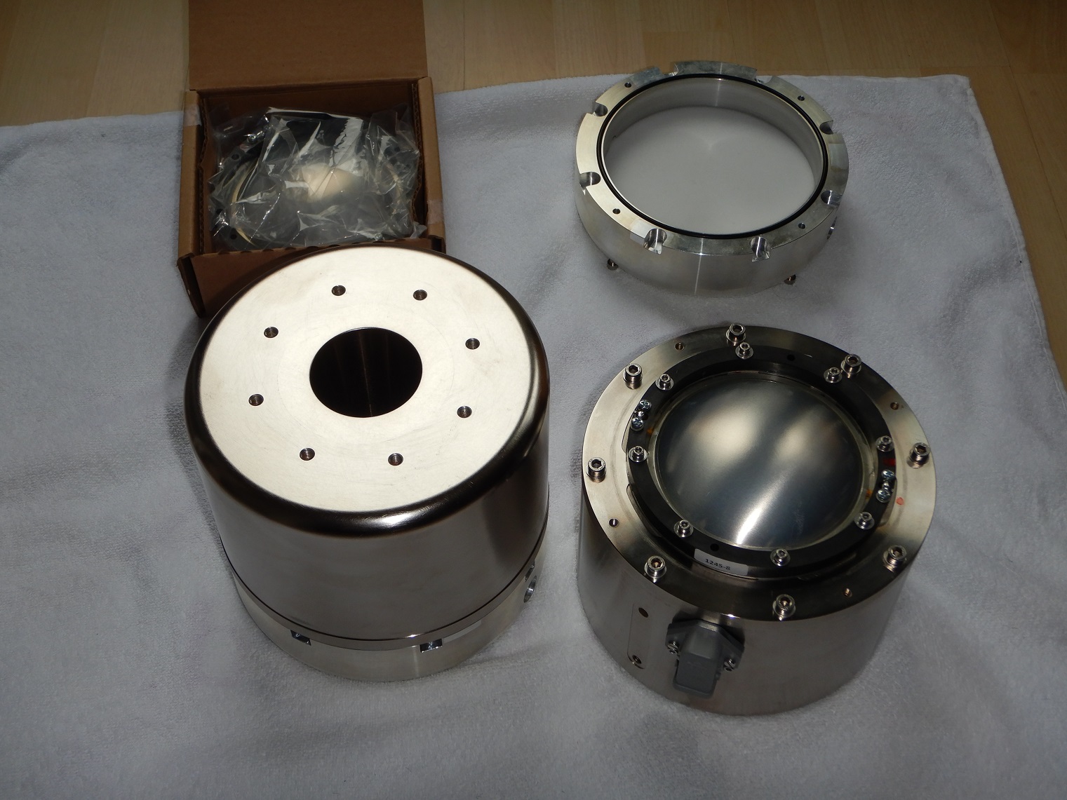

  • tri-amped (and i can change volume of each amp);
  • XO is tunable;
  • all used drivers are field coils......and the used power supplies flexible;
  • K-tubes are on a tilting system and can be brought forwards/backwards in order to keep all diaphragms in line.
See picture of current set-up.
So it pretty old-fashioned analogue here.
Nevetheless very nice results.
Reinout

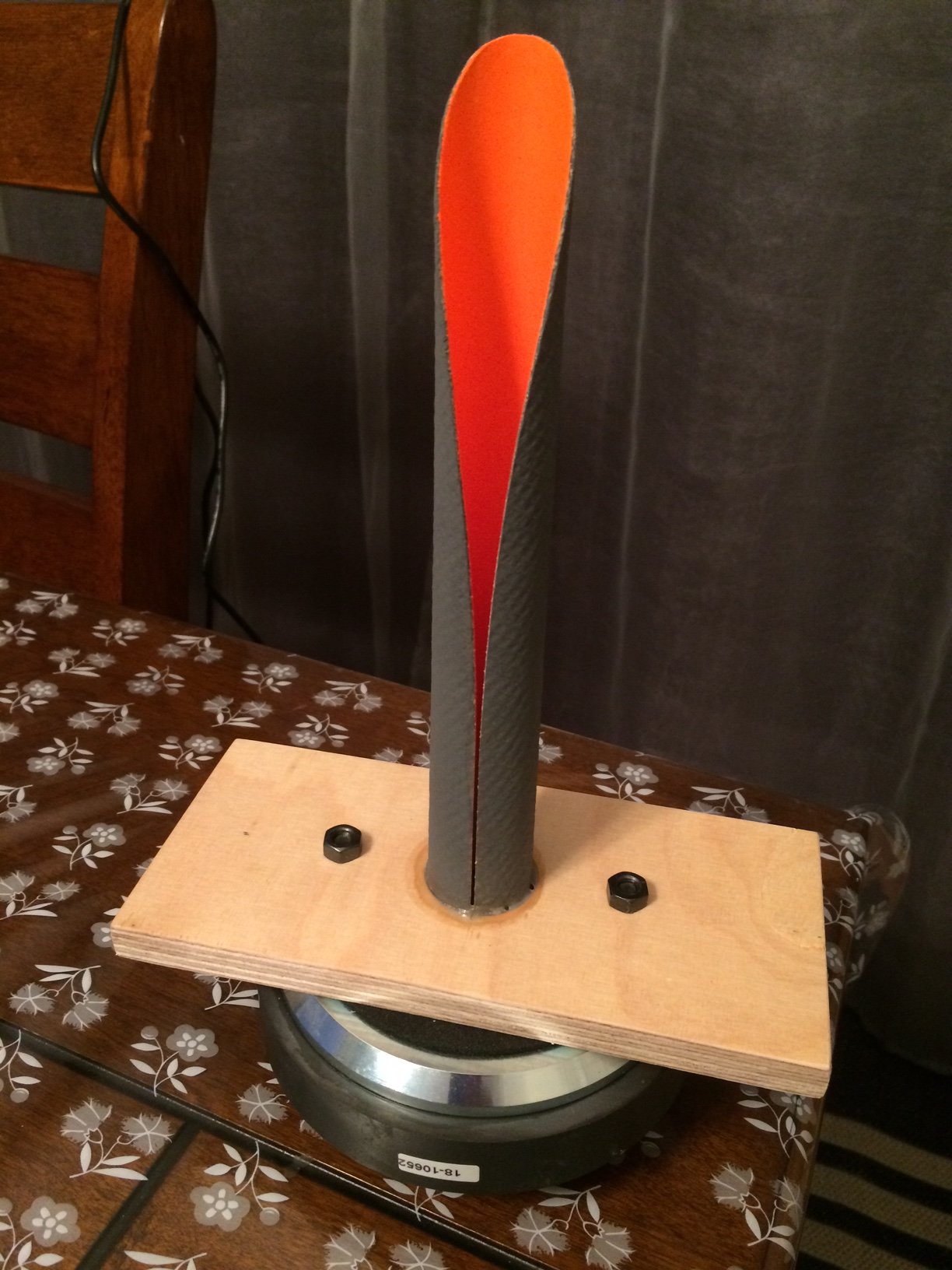

Thanks, but I just copied the Volvotreter horn colour scheme, always liked the grey and orange... Your aluminum+blue looks pretty good as well. If you or a member of your audio club ever gets around to measuring these large tubes, do share here, I`d be very interested in seeing the results. I have output down to 700Hz with the BMS 4550 on the 7.5" tubes, I imagine yours can go quite a bit deeper. It does not load like a proper horn, but most quality drivers can likely handle it at domestic SPL`s.

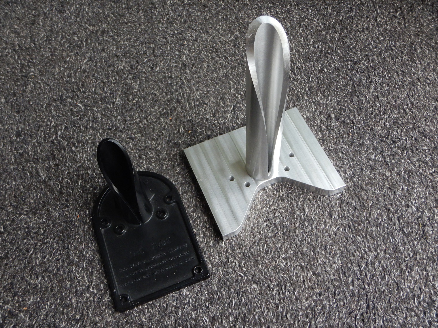

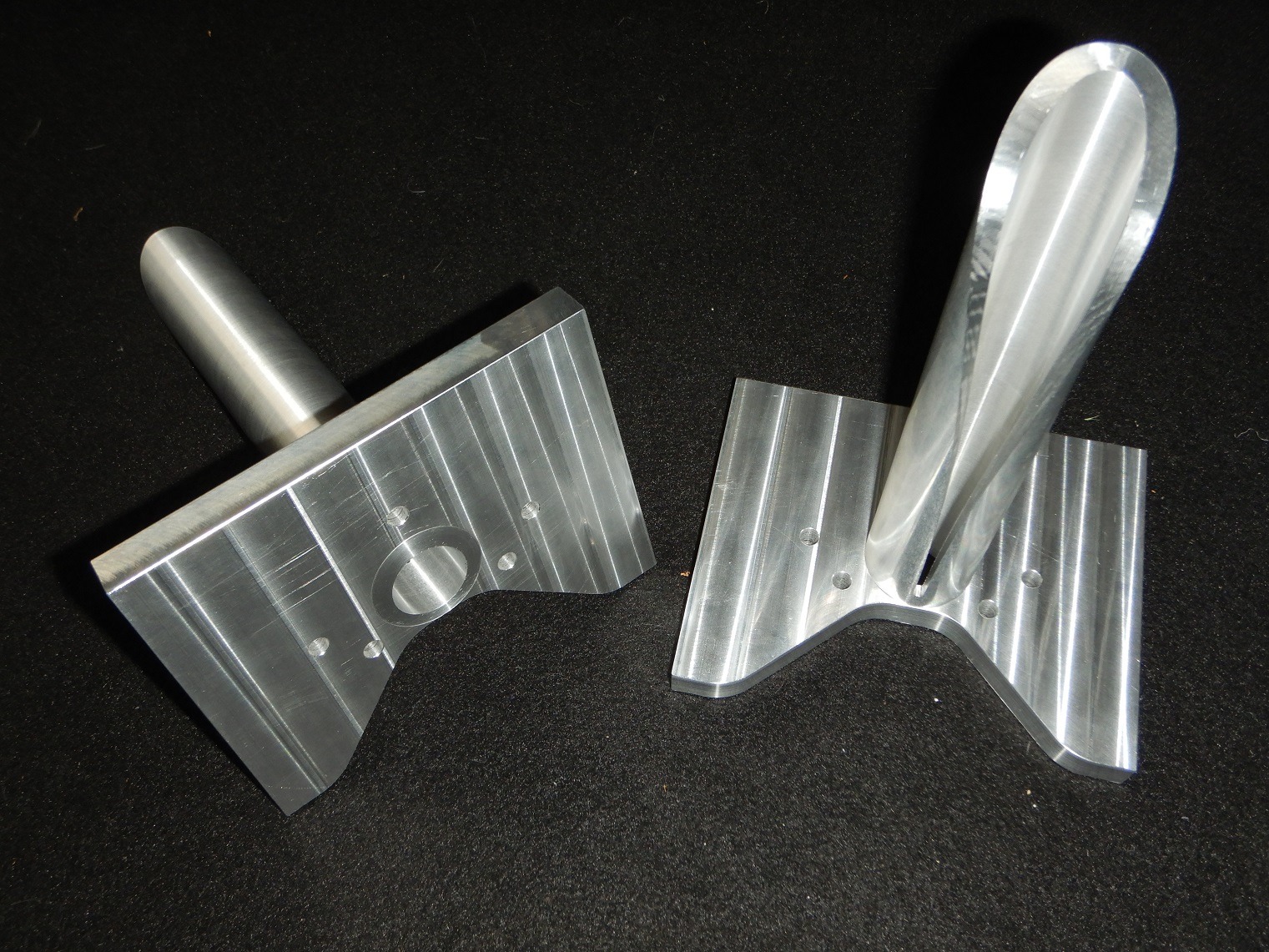

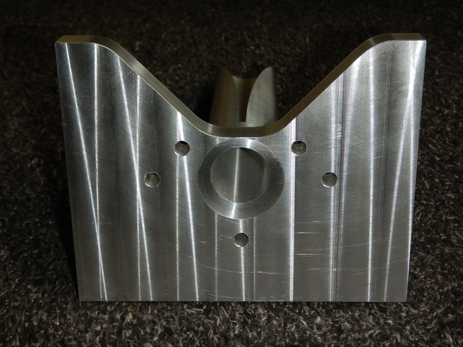

After a serious waiting time the prototypes of the alu-milled 1" K-tubes arrived. Nice to see the difference between the original K-tube (black) and the fres milled newer version.
Obvious difference is the tube-length. The original K-tube is somewhat stubby; with a longer slot/tube you are more in control of the spreading/direction. This has the same ratio of the larger 2" K-tube so now the 2 coverage diagrams are more alike.
Not so obvious is the resonance control
The original K-tube can/does resonate which has a negative effect on pinpoint imaging / staging. With the 2" K-tube we made use of the combination of 2 different materials. That worked. And now for the new 1" version we opted for a different route: different thicknesses of the tube-wall ! The miller was not really happy as he had to make that hole excentric......
And to be completely in line with the original we asked for a 2 degree tapering.
Proto pair arrived
New K-tubes inserted in the audio-set:
Details:
Very happy with the first results.
A follow-up pair will arrive in a couple of weeks (neater metal work) but in the meantime i can use these to the max. As the imaging is more thight the next modification in the set should be more clearly: totally different tubes for the tweeter-amp (TC03/5 and the CV1660).
Enjoy your music and audio-efforts !
Regards, Reinout

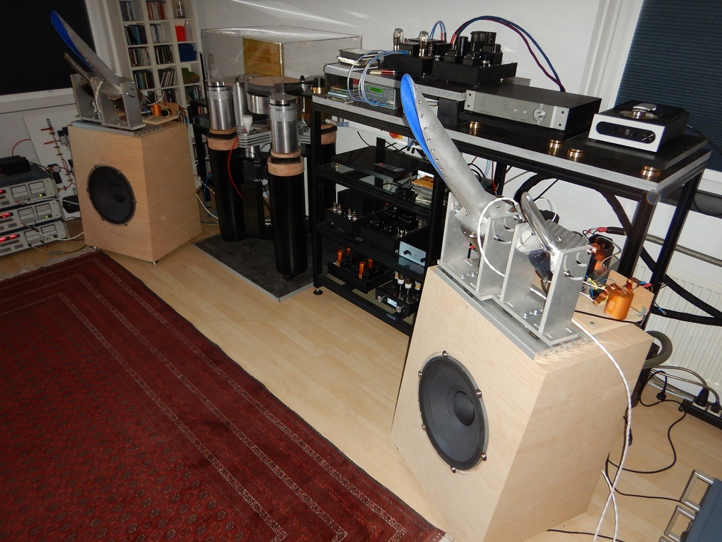

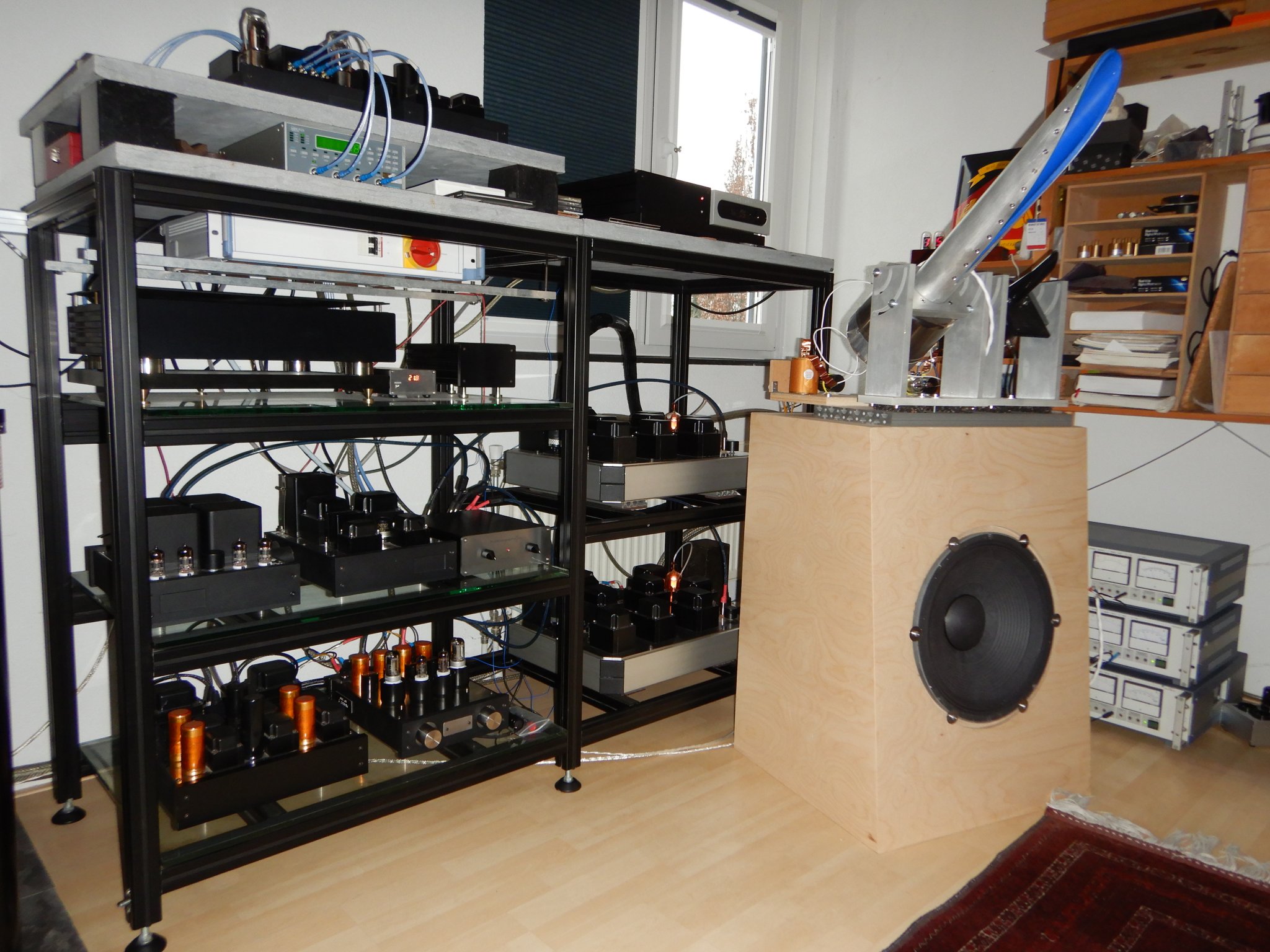

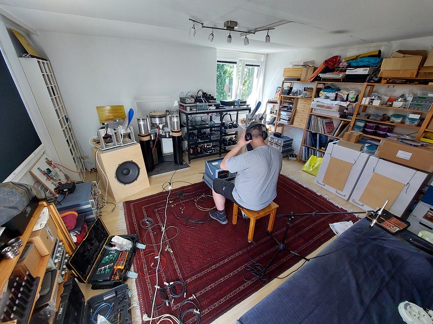

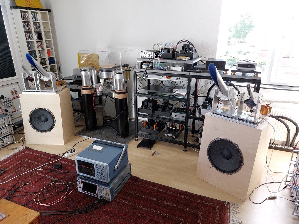

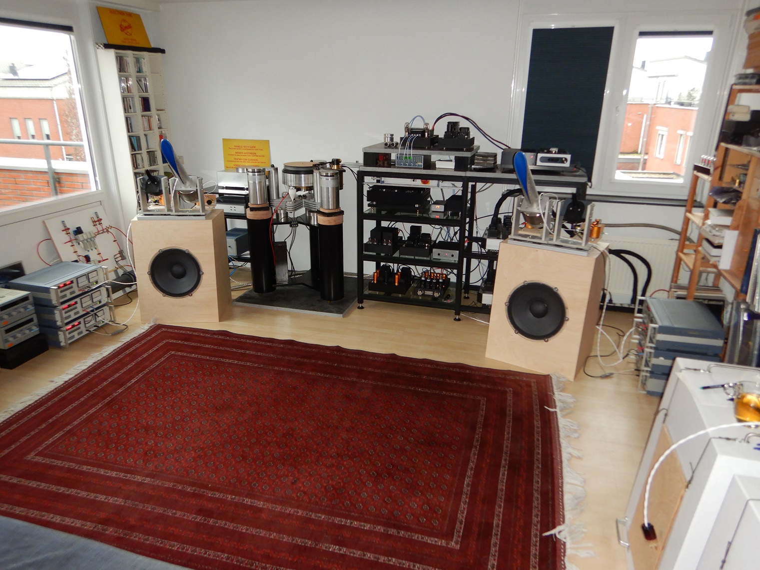

This weekend was a proper measuring & listening session.
After using the set that long you get accustomed to the sound ; you therefore loose objectivety.
2 extra sets of ears, a lot of measuring equipment (LeCroy Wavepro 950 scope; Rohde & Schwarz UPL audio analyzer), some sound meters and microfones and a lot if time made it possible to measure and adjust the set to it's current optimum.
checking....checking....
Noted a "non-linearity" in the frequency plot at the crossover from woofer-to-mid: adjusted the XO from 500 Hz to 350 Hz. Hurray for Nelson Pass XO-efforts (PAP-C1); so easy to adjust.
Adjusted the 3 power amplifiers to the required/needed output. Very happy with the decision that all the amps will have an internal volume control. Now it's easy to adjust the 3 tube amps (35TG tube to the woofer [8 W] ; 6C45 tube to the mid [2,6 W] ; VT105/ML6 tube to the high {1,1 W] to all drivers who have serious different efficiencies.
Aligning the K-tubes to get the proper musical presentation. That was fun as there were in essence 2 options:
  • with the K-tube more directed to the sweetspot. this delivers an in-your-face highly detailed presentation. Very demanding to listen to as you can hear every detail.
  • with the K-tube more directed upwards so you get the sound through the slot. This delivers a wall-of-sound in a sweet zone (much larger than above mentioned). Soundstage is huge and you can still pinpoint the musicians and instruments at the stage. This is more relaxed listening and my preferred choice.
Of note: this is personal opinion. In our group we both have persons who like the directly-fired solution but also persons who like the tilted K-tube.
Currently i have the K-tubes at 50 degrees.

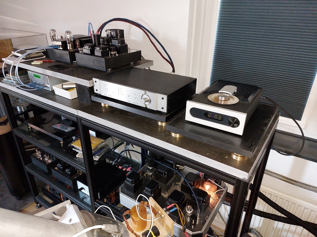

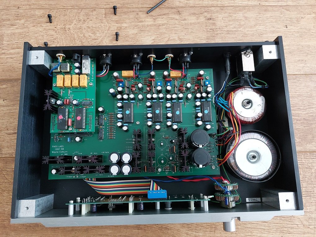

Besides that K-tube-adjusting also "new" equipment has been added to the set: a Pass Labs Digital 1 DAC. A DAC from 1997 (first version; no modifications) which i spotted for sale in the internet. A properly executed BurrBrown PCM63P-K DAC; impressive bass and musicality.
Nothing wrong with a nice executed design....

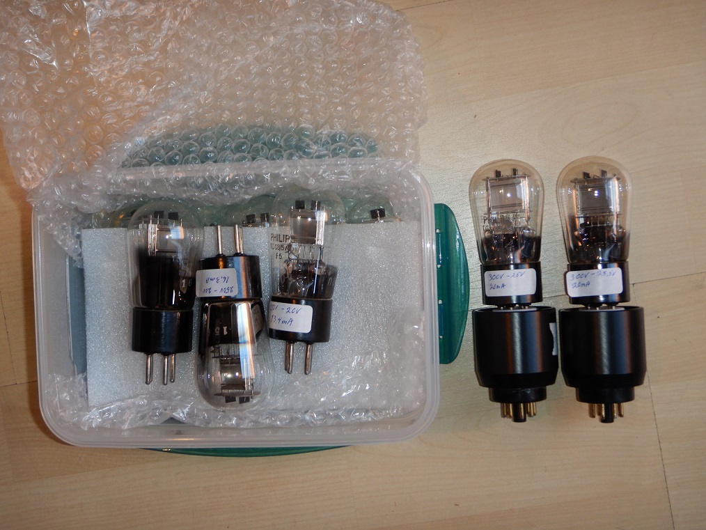

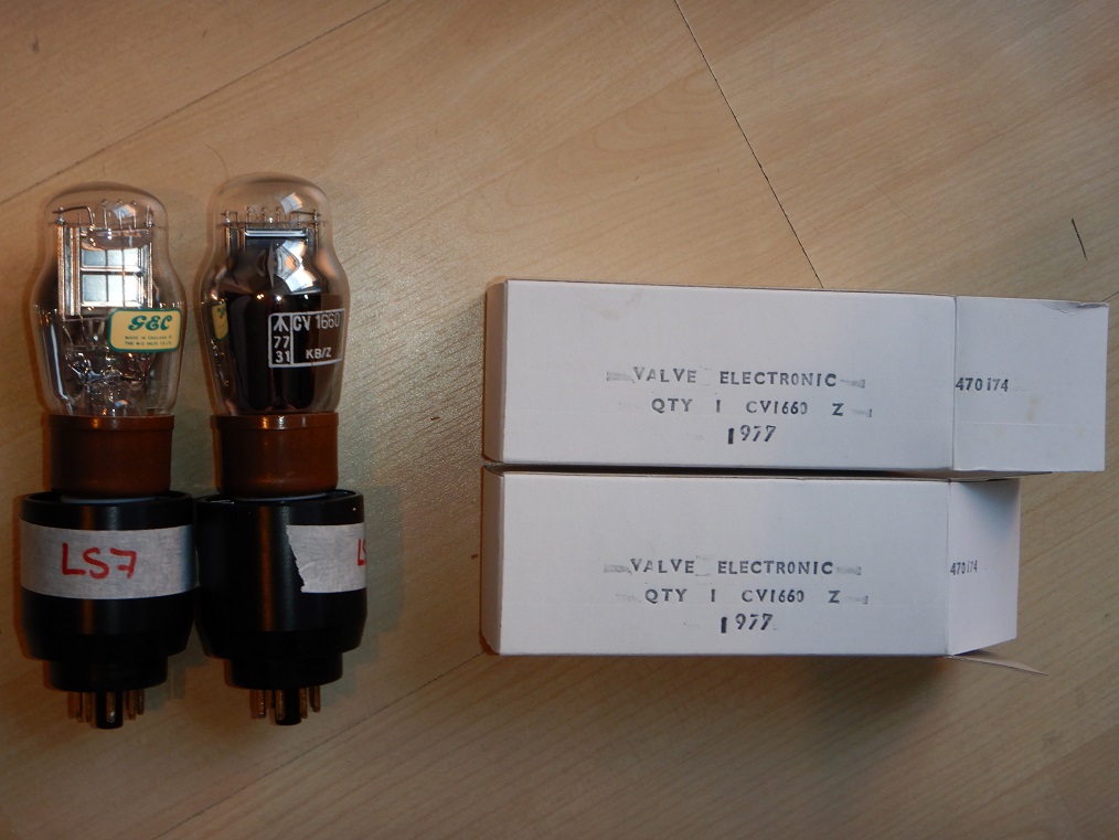

Last changes to the set was a modification to the tweeteramplifier. I have a couple of tube-options to choose from but the Ce (Posttube) triode as the driver is seriously good sounding. Problem with that tube is availability and therefore the demotivating price.
In my preamplifier project i listened to many many options and 2 of them were sounding very good in the mid & highs but were simply lacking some oomph in the lower registers. Not to be used in the full-range preamplifier but no problems in a tweeter-amp.
And now i can use those CV1660/LS7 triodes (GEC / MOV manufactury = Marconi Osram Valves) and Philips TC03/5 triodes. These can still be found for reasonable money; in fact....i have them already.
Very happy with the results !!

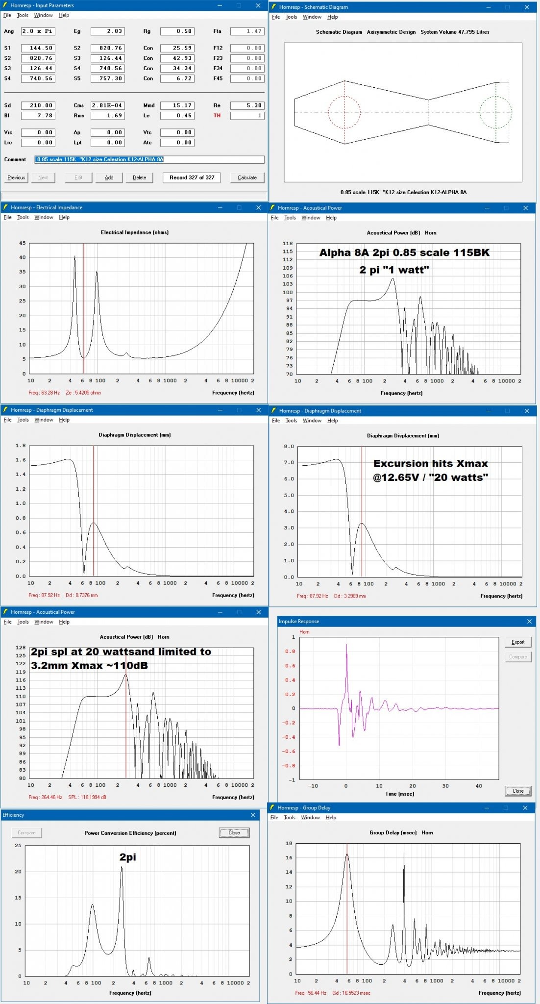

@unaHm
Here's a guesstimate of your Alpha 8A in a K12 sized 115BK Acoustic Control cabinet and should be similar for K12.
There are dimensions for 115BK posted in other Karlson related threads.
Reactions: unaHm
