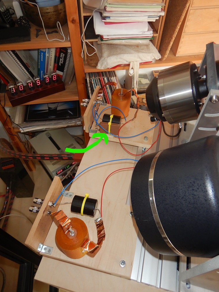

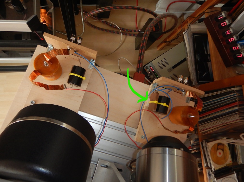

Good morning Freddi,
that bypass-capacitor is EXACTLY what i'm doing now. During the build-up of the (external) crossover-boards i added space + wires next to the XO-capacitor itself to play with an added bypass-capacitor.
Yes, it changes the (high) reproduction but not in a qualitative way but in a change in taste. It doesn't get better; it's getting different.
Currently i use a mica-cap as bypass and it seems to bring out more details but on the hard side. Its taste ! Someone will like it; somebody else not.
For my planned tweeter amp i know i will not use that same mica as coupling capacitor because that would simply be too much.
Time for experiments: soo much caps to chooce from and it is an easy change in my set as everything at the crossover-boards is open/exposed.

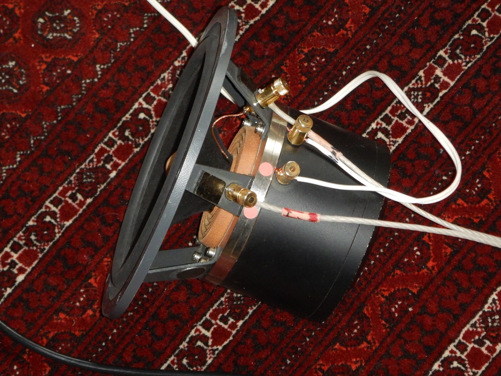

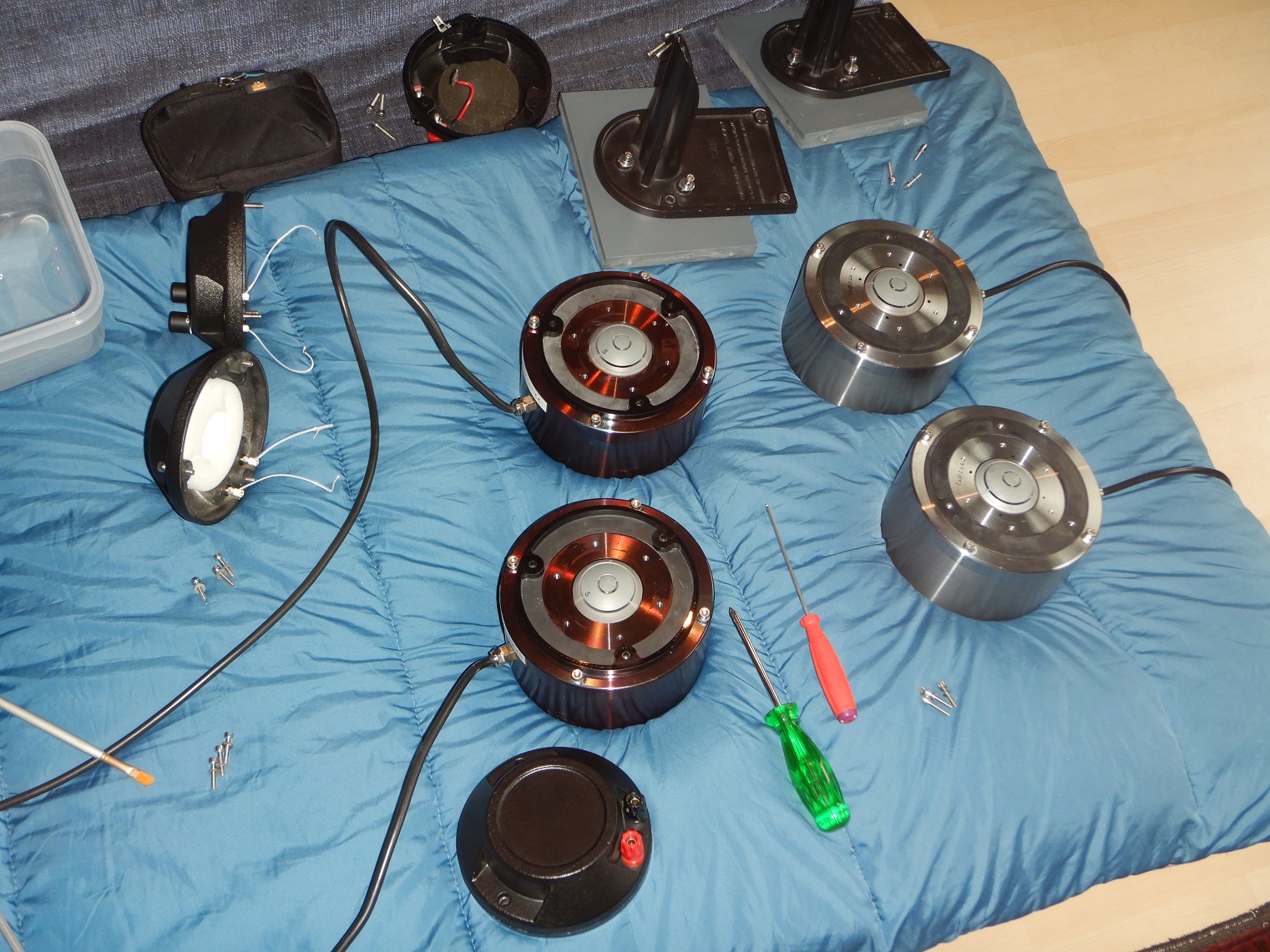

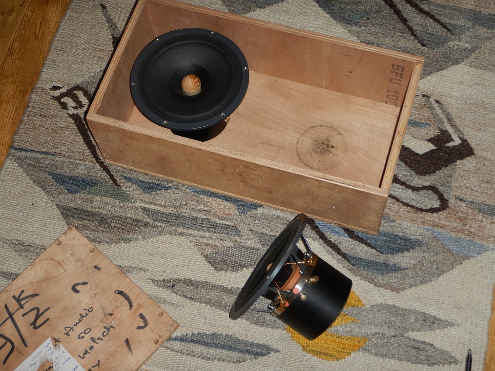

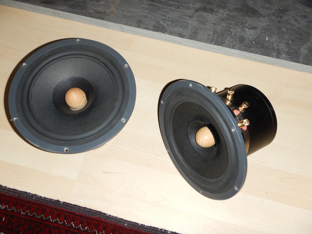

Good evening Freddi,

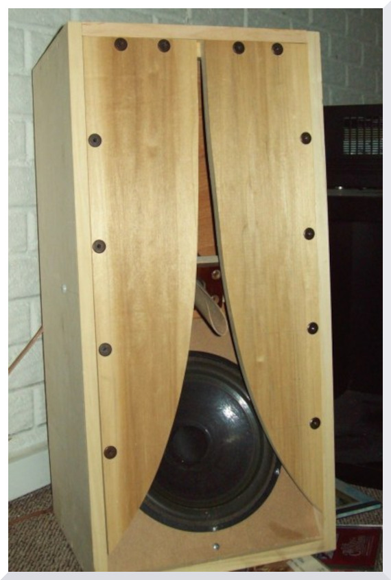

i walked that road also with very nice Fertin 20EX field coils (8" ). See pictures..
But the K-tube / compression driver midrange give better results. It has the same fast transients as the K-tube / compression driver tweeter.
The CNC-work on the K-tubes are extremely slow........Corona-effects kicked in at that production facility so these orders were (logically) pushed aside in order to survive. I simply have to wait.

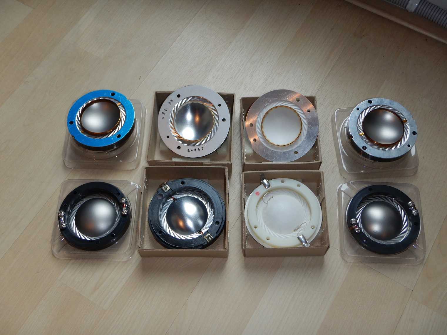

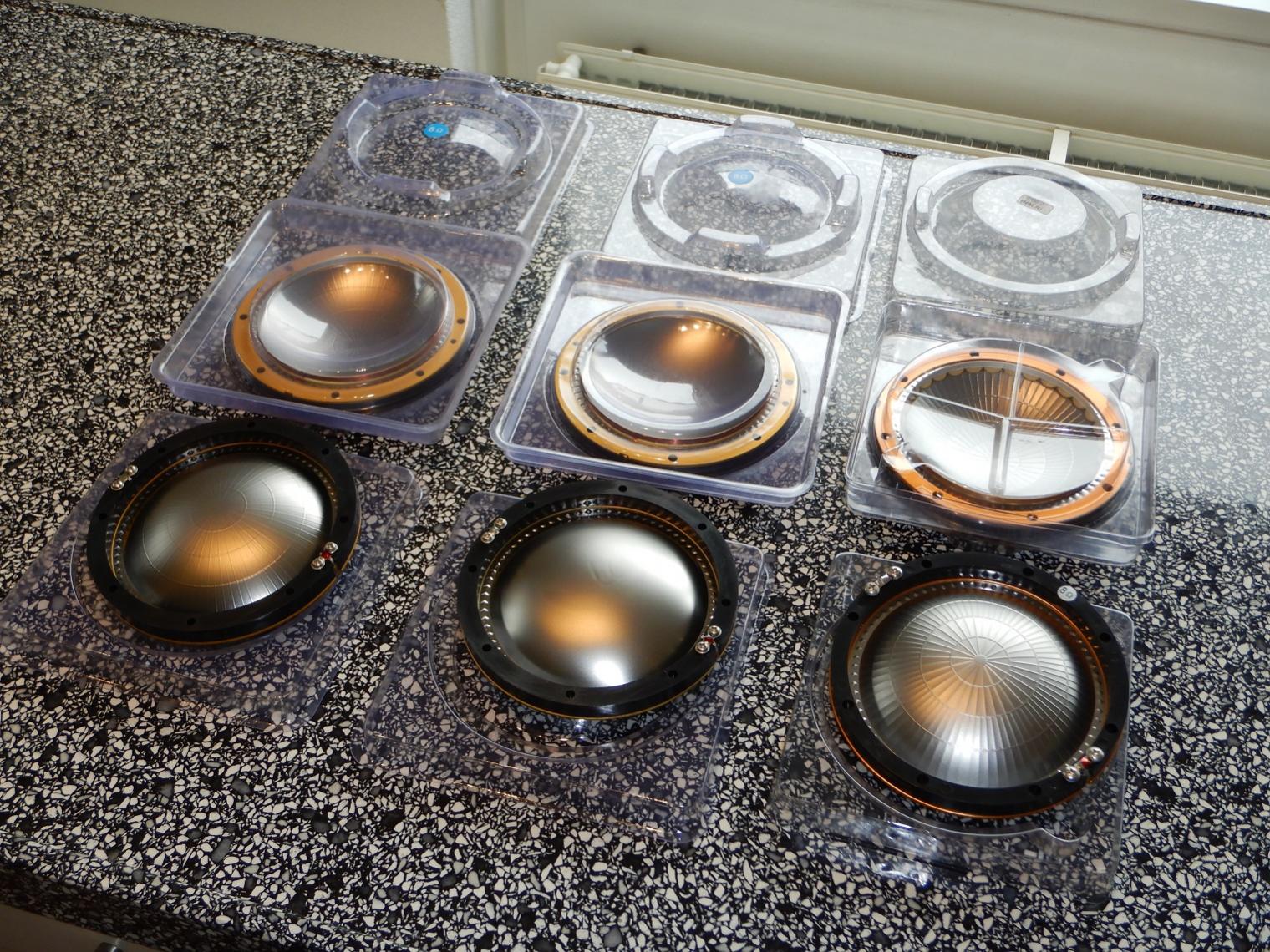

That does not mean there is no progress as i am currently exploring all kinds of diaphragms for the Von Langa field coil tweeter (the compression driver behind the tweeter K-tube).
Currently i have available:
- American aluminium (these are made on/with original Altec tooling; GPA bought everything from Altec)
- Chinese aluminium
- Chinese titanium
- Russian paper
I'm waiting for the Radian mylar/aluminium so i can have a real broad test ahead. The Radians are on backorder so again......waiting.
The physical differences are great as well as the quality / workmanship. Already surprising results with the early tests but i want to burn in those diaphragms properly and i am waiting for the last test subject.
Of course i'm still waiting for the availability of beryllium diaphragms ......

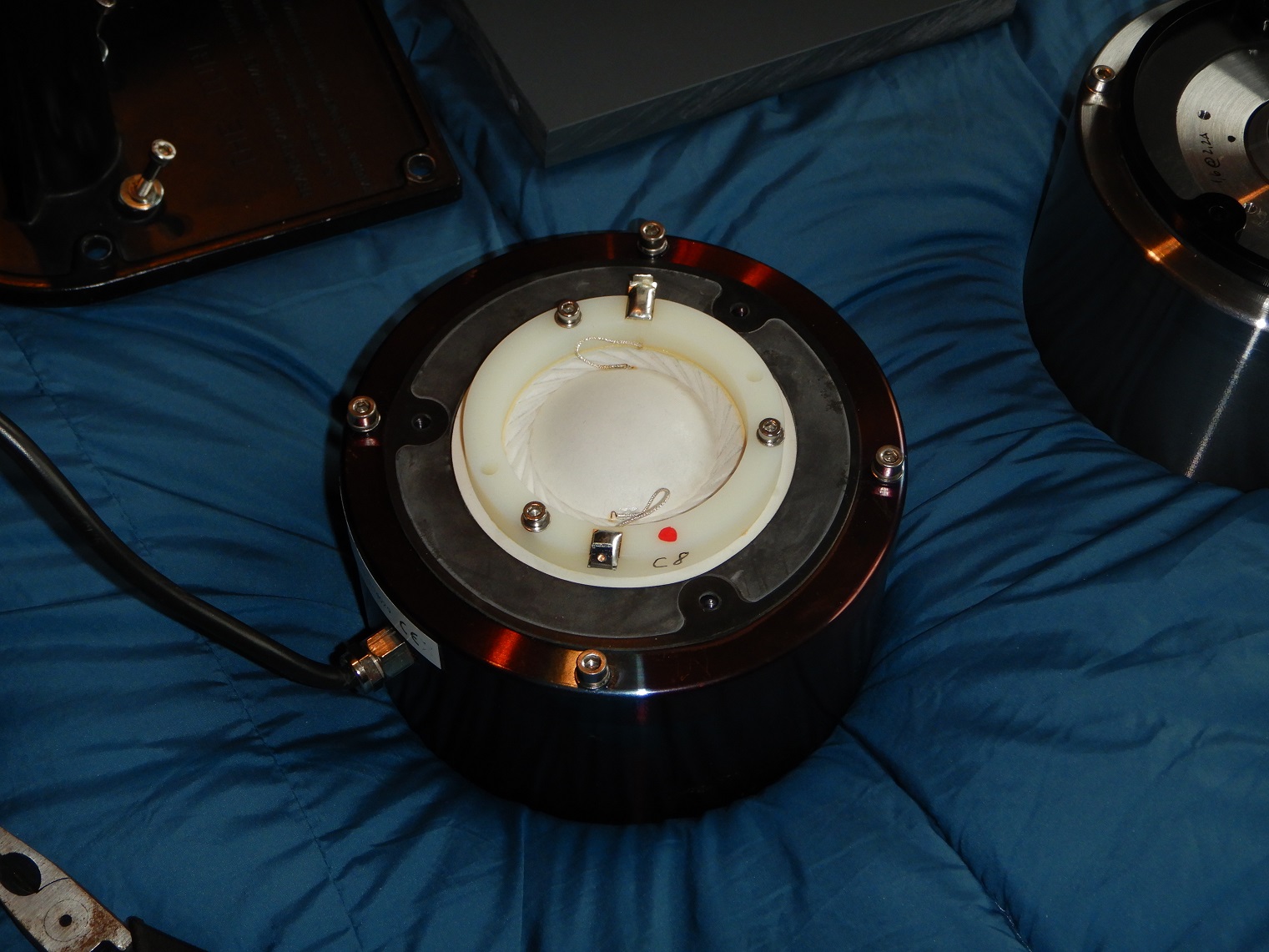

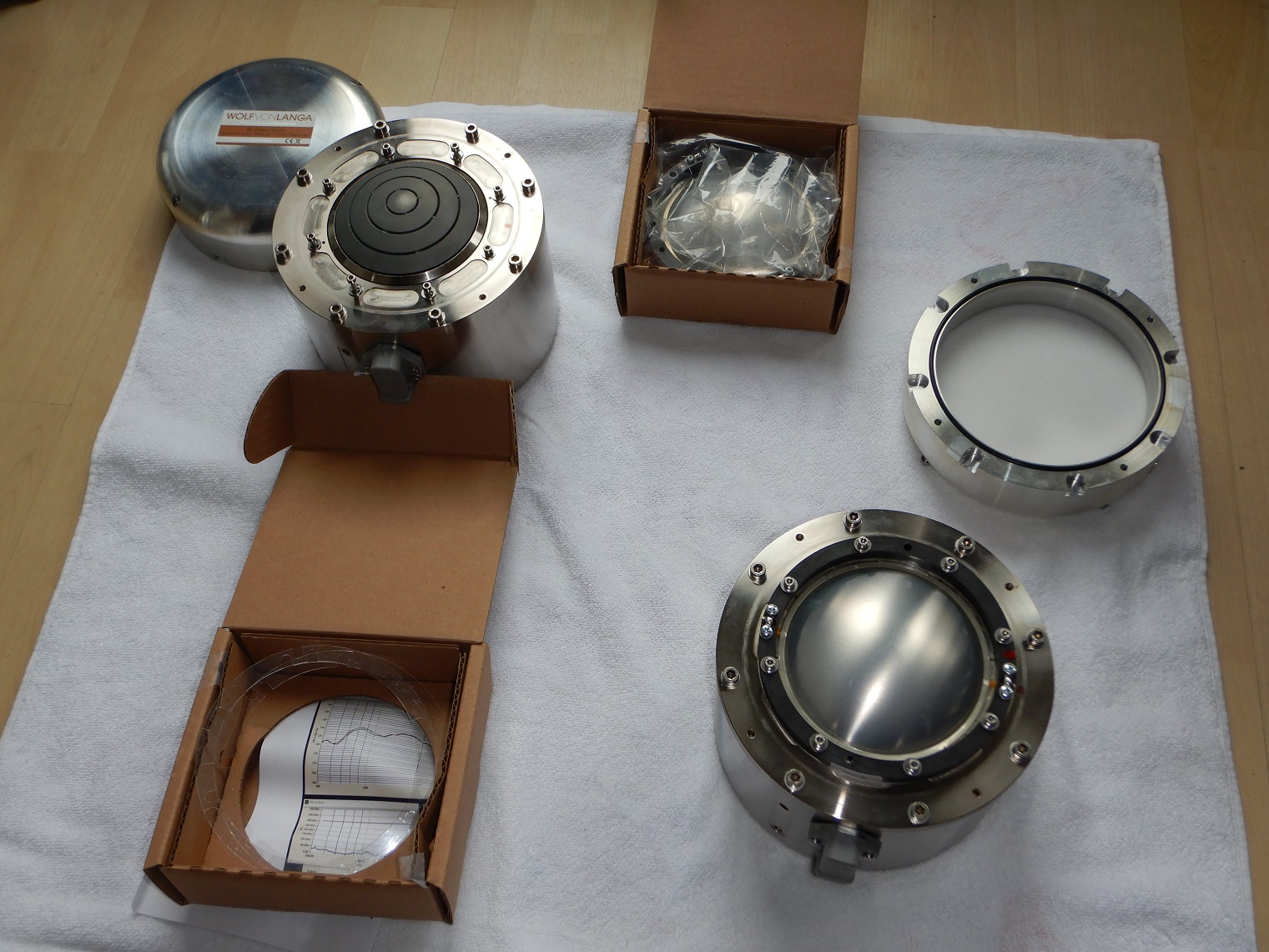

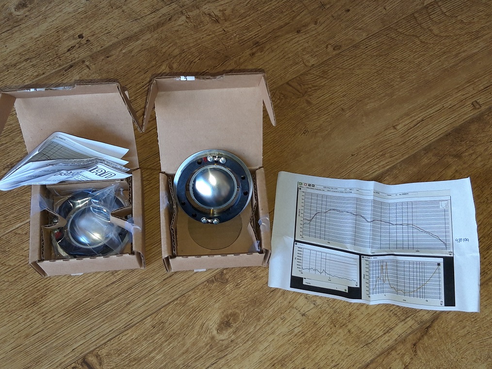

And today the Radians 1228-8 arrived. Very nicely made, serious packing, frequency plot (unique to diaphragm), etc.....good first impression.
But for the groupfoto they were too late as the paper Russian paper diaphragms are already installed and running in.
Nevertheless: the testgroup is complete.
Of course i would like to have a beryllium pair as well but that will be quite difficult at this moment as there is no production. And if the production starts i probably will be shocked by the prices.
Diaphragm-time !
Regards, Reinout

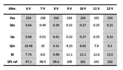

As an example i've added some specs of the Supravox 285EXC. Look at the changing Qts and BL with changing voltages from 6 to 12 volt.
With permanent magnets you must optimise the enclosure to the fixed parameters. With a field coil you can optimise the driver to the enclosure. Of course within limits but you simply hear it when it is optimised.

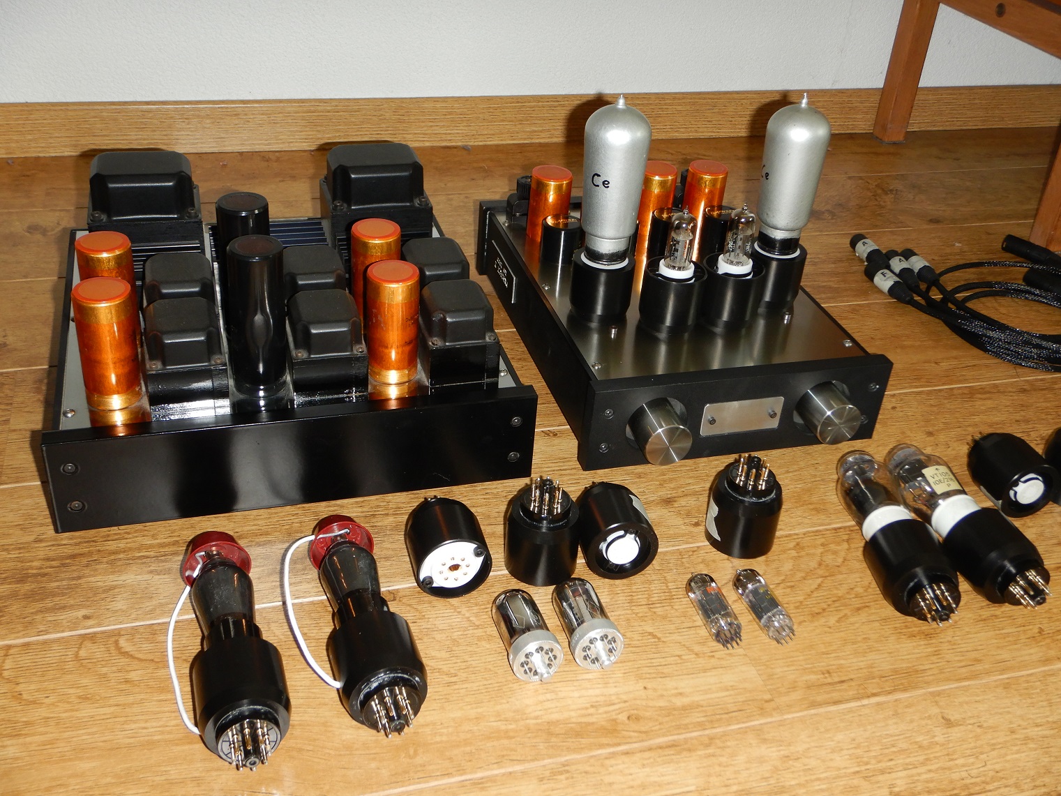

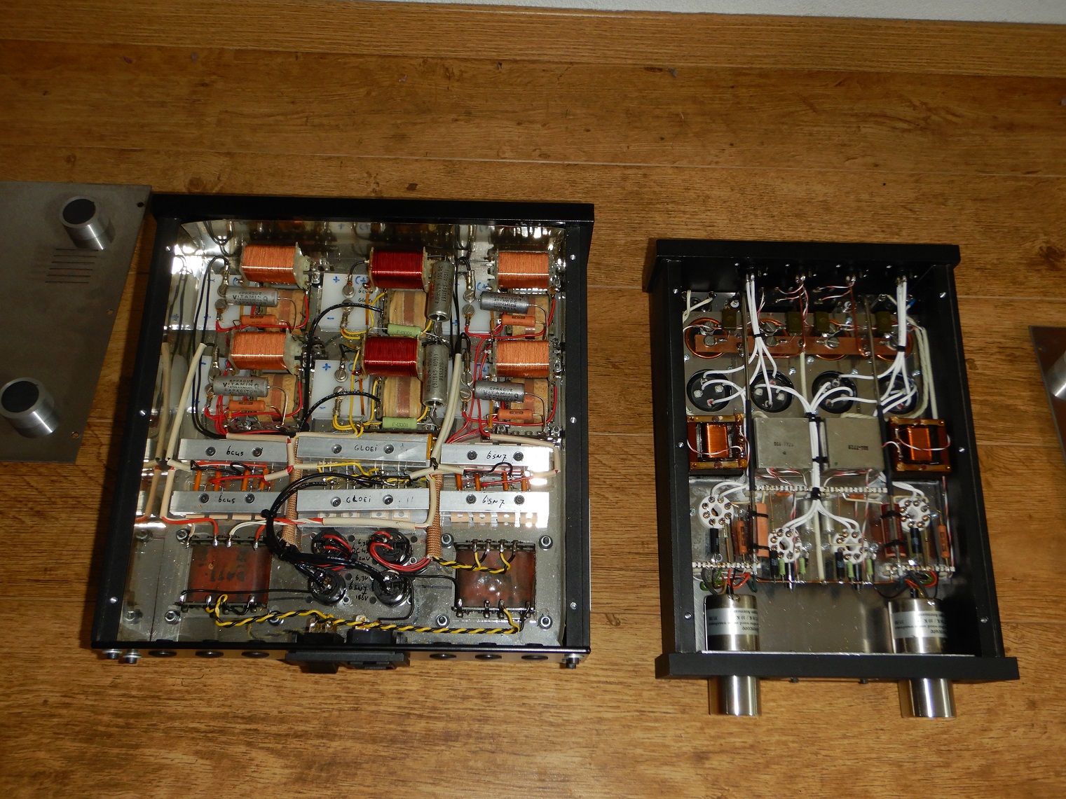

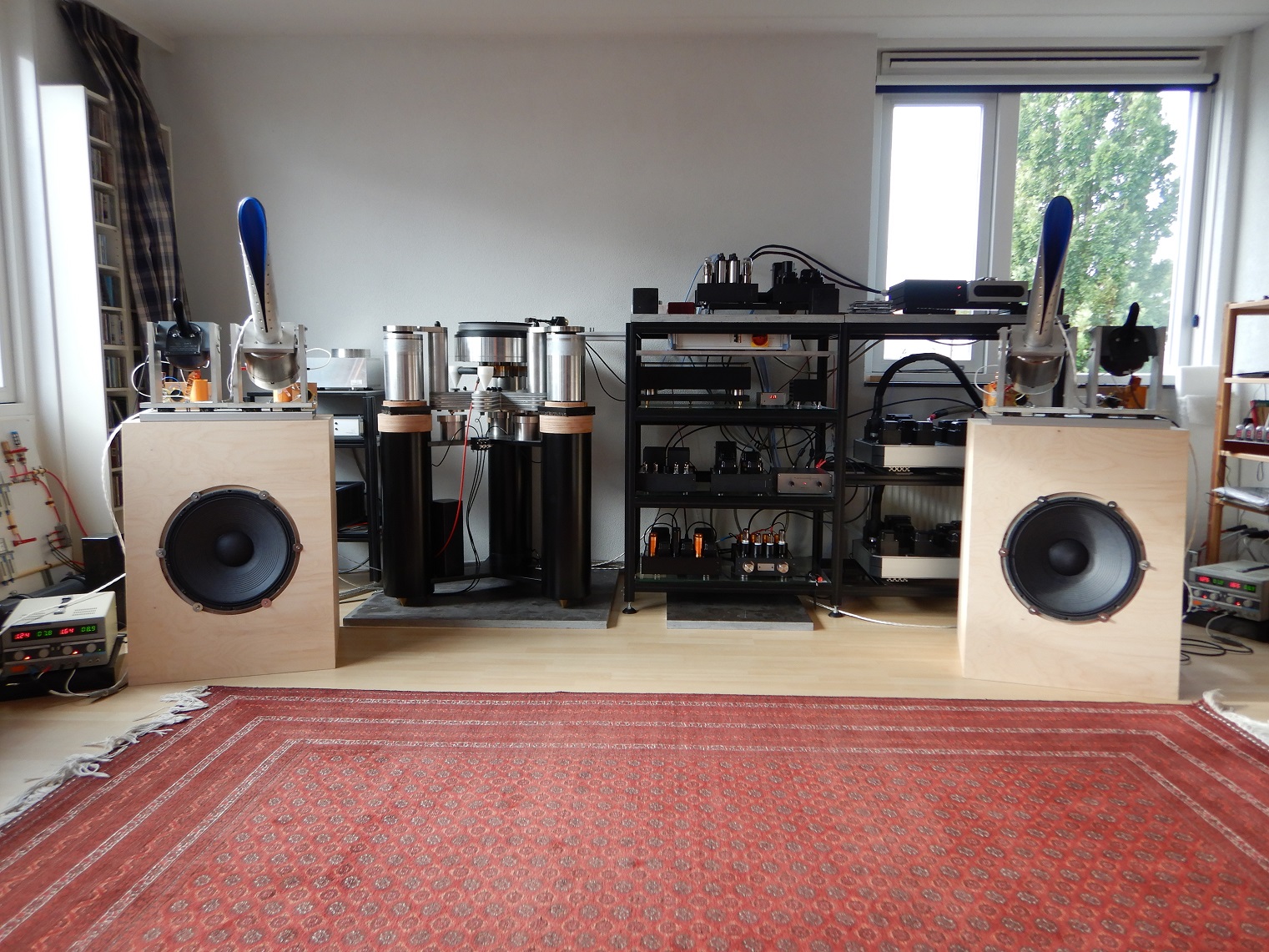

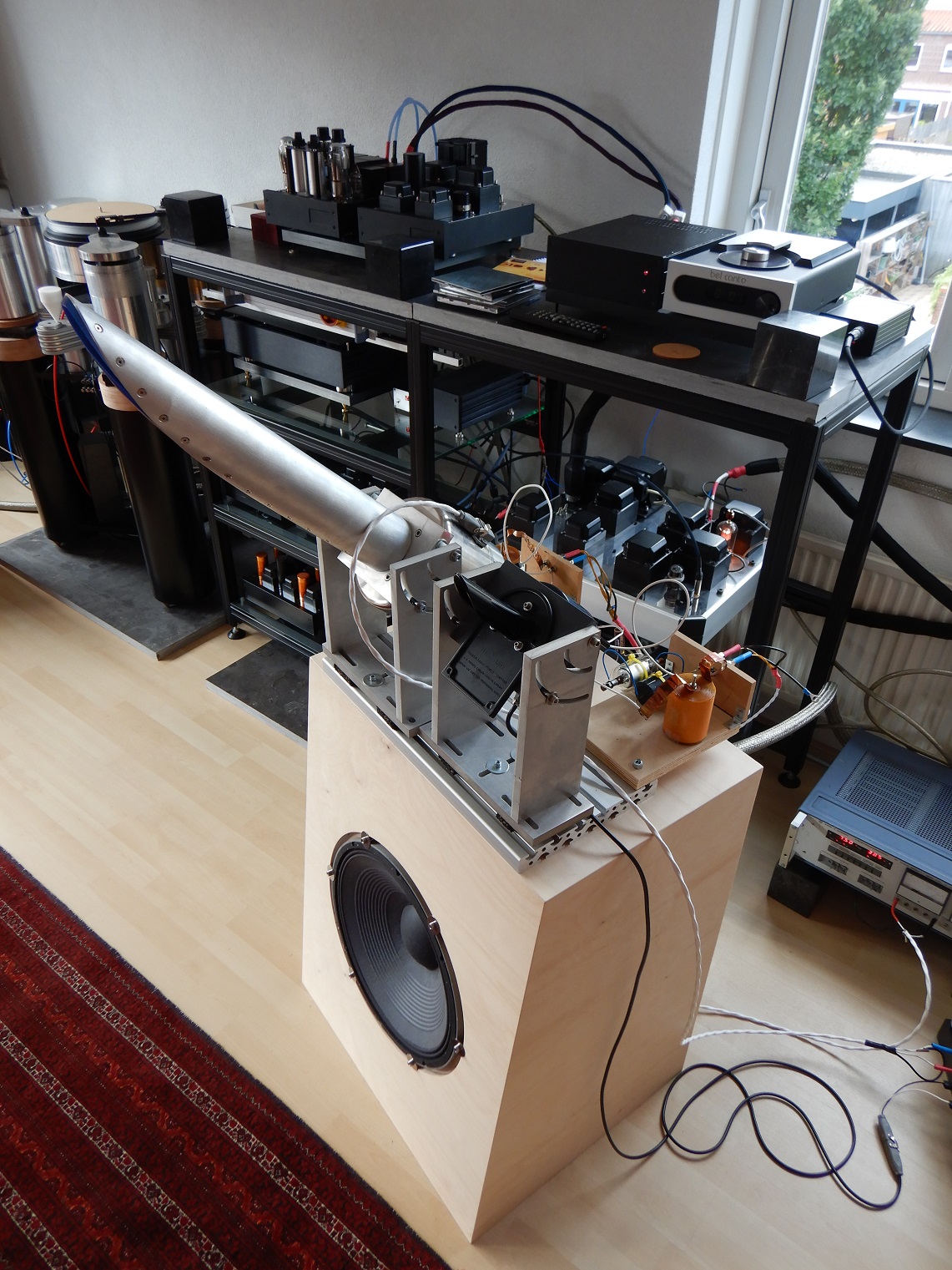

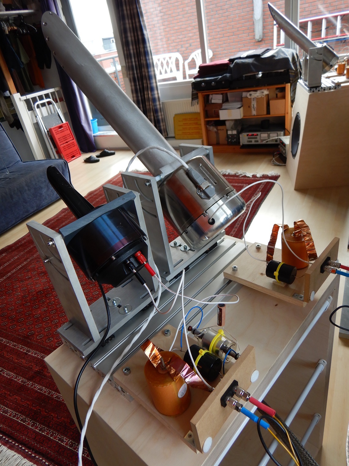

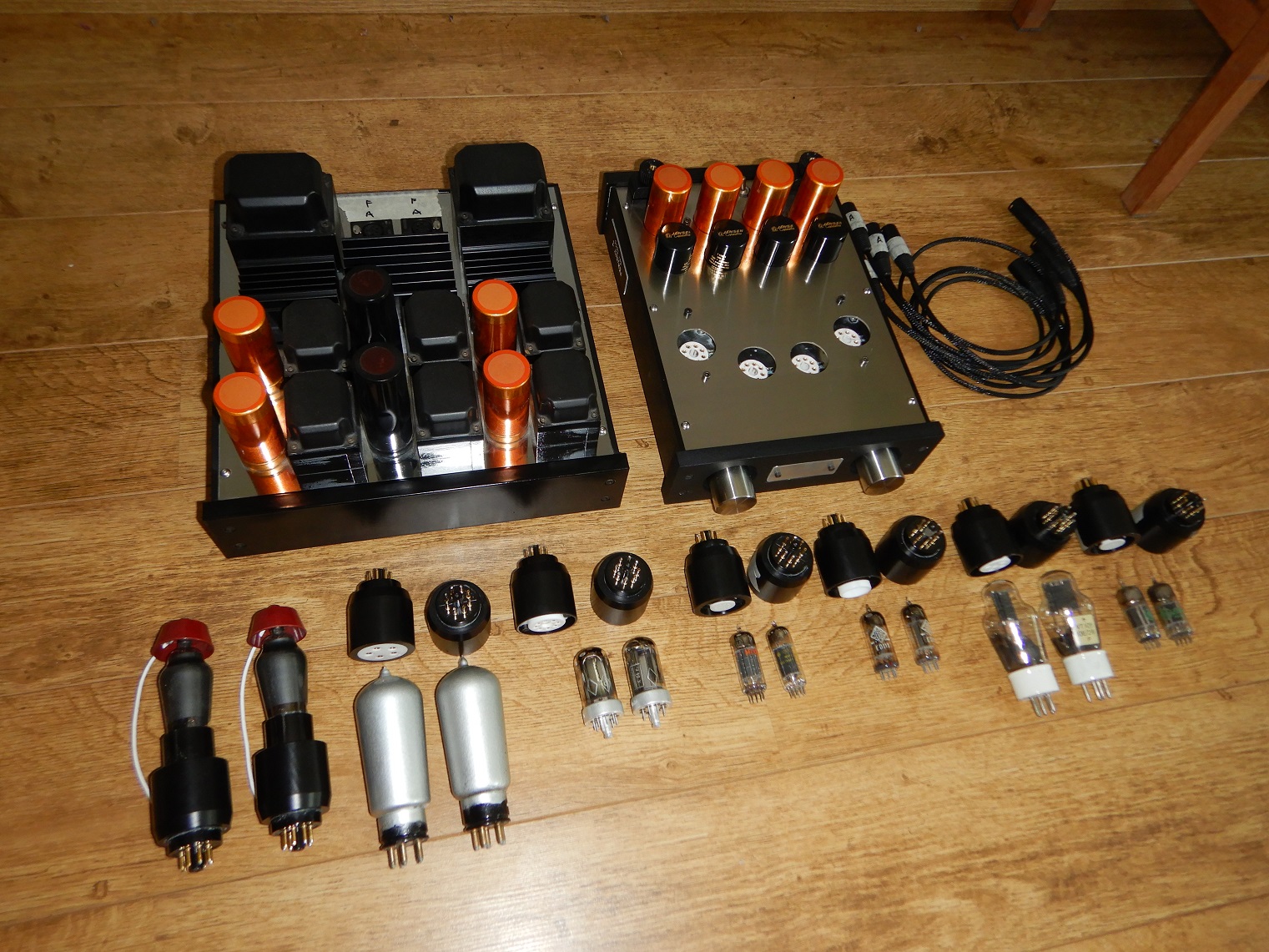

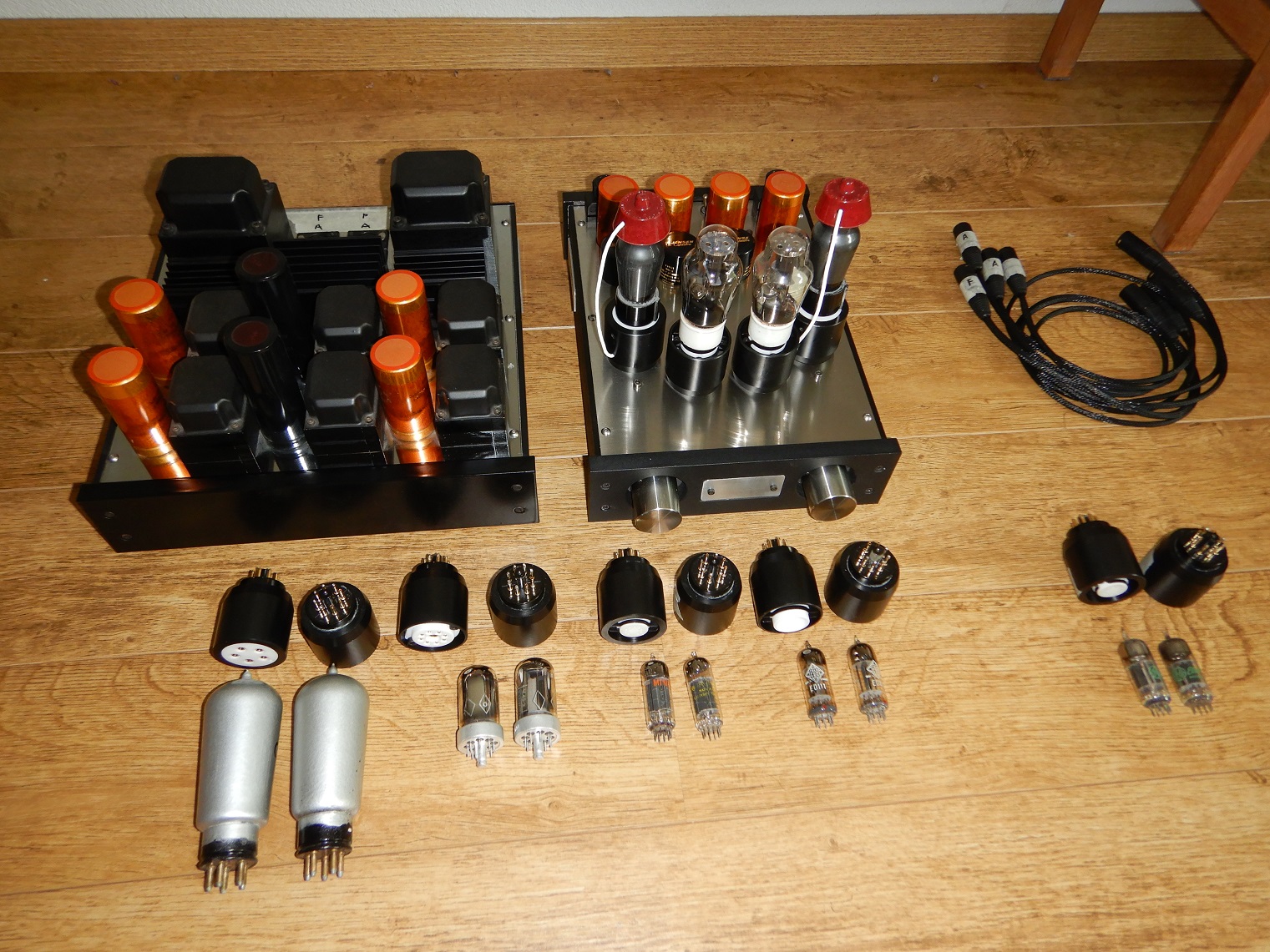

New developments here:
- tweeteramp is ready. Burn-in time ! It's a real 1 Watt performer with options to use really different tubes. For the input tube the Ce / 4P1L or AC100 can be used. For the output tube you can use the ED111 / 6S4 / 12B4 or ML6. All combinations allowed as the convertor sockets contain also the needed compensation resistors etc.
Pictures included.
- 2" WVL compression driver available. Currently finding out the nicest combination of this serious field coil driver with different diaphragms. Pictures included.
Regards, Reinout

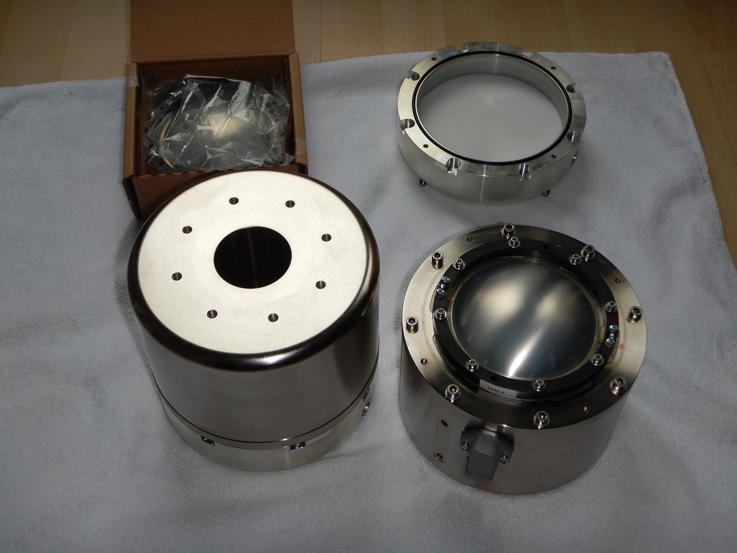

That would be an original "Transylvania Power Company" K-tube as my CNC-order is still not finished........
The length of that CNC-version will be the same as the original but the walls will be in different thicknesses in order to supress standing waves / resonances.
Regards, Reinout

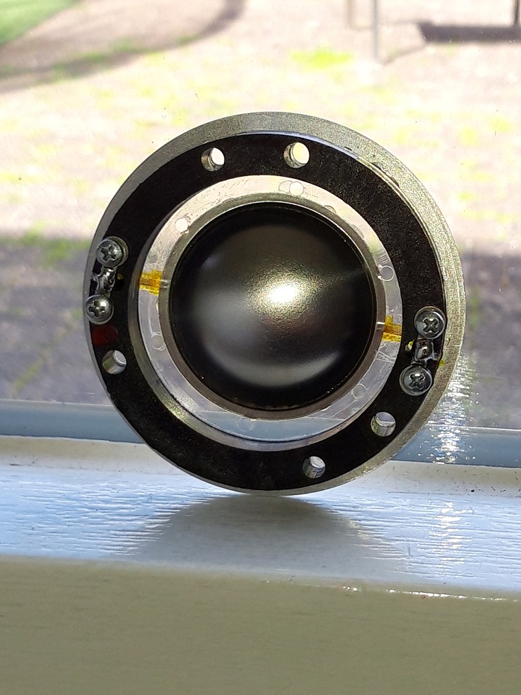

First of all, thanks to @freddi for directing me to this thread. Secondly, this is fascinating!
So I have two compression drivers, a Pyle PDS521, and a Miyako DU-100.
Both drivers have a 1 3/8" (1.375" or 34.925mm) diameter screw thread throats, and I'd like to combine them as the Pyle driver can cover 1kHz-20kHz, and the Miyako can cover 150Hz-6kHz.
What size would I need for each K-Tube to use these as a 2-way system? I'd imagine a crossover of 4kHz would be appropriate.

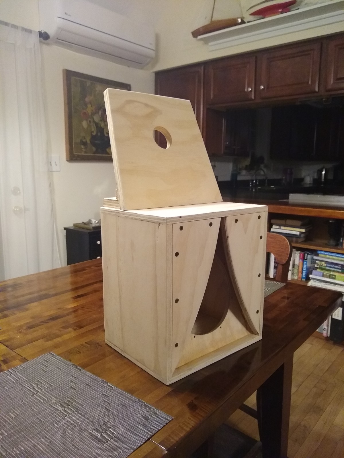

I think it is time for K Tube experiments again. Since I built a multicell horn for my JBL2445 using a 3D printer, I think I should also print some 2" single and double slotted tubes.

Good evening Pelanj,
the sound of a K-tube is OK; nothing wrong with that....on the contrary (see picture of current set; ALL drivers are field coils by now....).
Indeed there is no gain like horns. And another item is indeed dispersion; but that is very very subjective/personal. Noted that some readers/writers were not too happy with the small focussing / radiating area. For me it is exactly the contrary as the seriously broad dispersion makes too many room reflections which lead to less focus.
Important is the length of the tube. The "original" K-tube ("transylvania power company") is rather short and this leads to a broad dispersion. So my next K-tube will be longer so a can focus more.
Of note: the dispersion has about a 20 degrees vertical coverage so it is essential that you can "aim" the K-tube at your listening spot.
Not really a surprise as when these original K-tubes were introduced the were meant for small halls/venues covering the horizontal plane to the max. And with the preset fix on the enclosures the correct dispersion angle was aimed at the audience. Hence the name "sound laser".
Very happy with my contraptions so i can aim the K-tubes. The 2" has the correct length: good dispersion around the listening position.
The 1" K-tube is simply too short; will be redone (including different/varying wall-thicknesses).
Maybe i'll let that 2" long K-tube manufacture ?! Thanks for the drawings.
Reinout
Reinout
