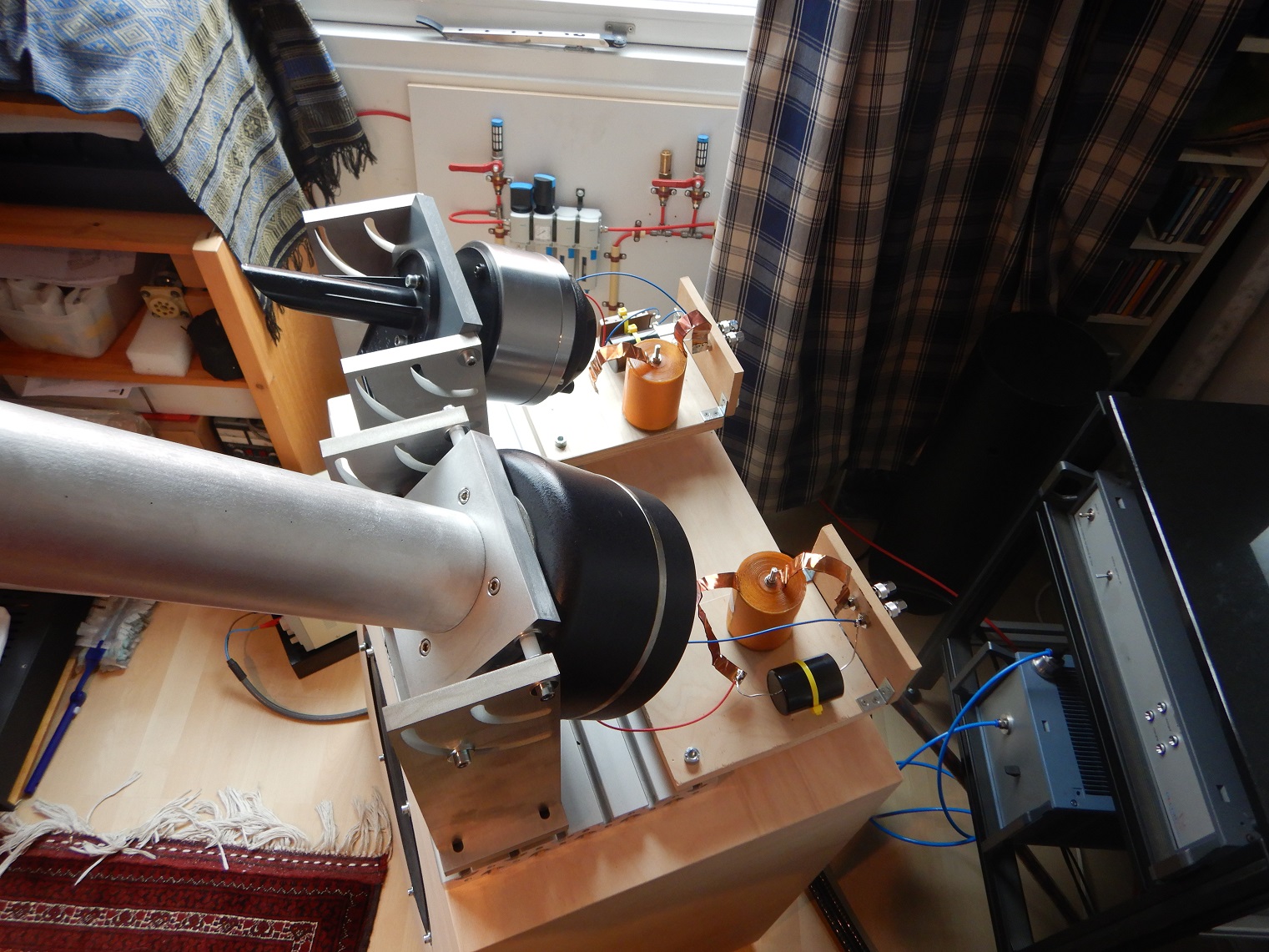

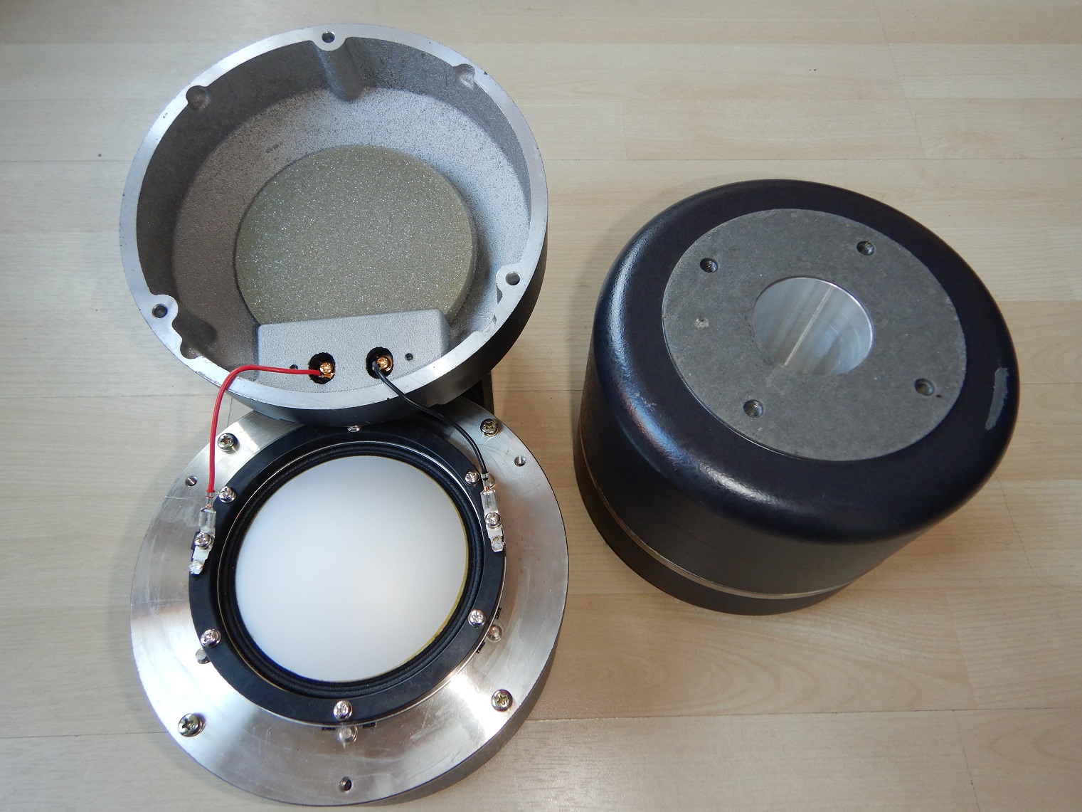

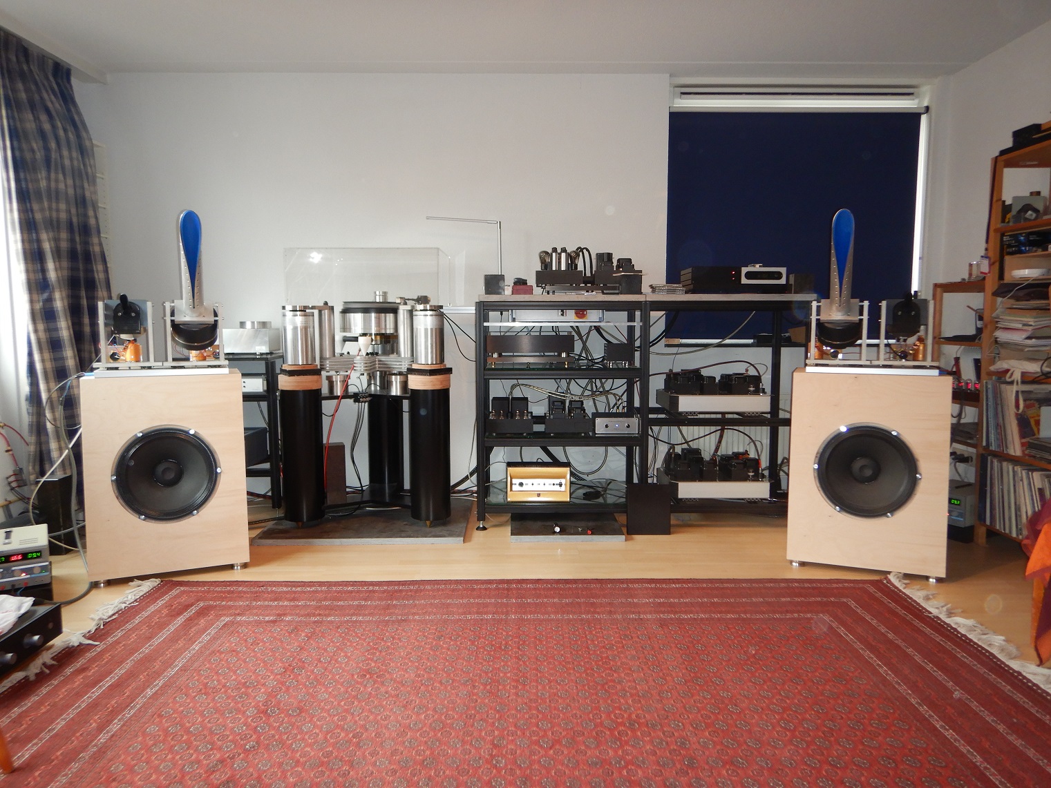

Good morning Freddy,
only the actual build will tell/hear if this is a smooth solution.....
In the meantime i'm working through my speakersystem cleaning up the details. Next little project: to exchange the binding posts + internal wires inside the compression drivers. I know both drivers stuck to the original Altec-description that field replacement of the diaphragm had to be done immediately and without specialised tools (so they use crappy Faston connectors) but currently the precious audio-signal is through mediocre binding posts - awful internal cable - sheetmetal Fastons ? AAAARRGGHH
Noted in serious other brand drivers like TAD and JBL they do the same ?! Of course this works but it is not audio acceptable.
Currently gathering nice parts and the correct tap because i have to drill/tap into the driver units (better do this when my kid is not playing in the house which is a problem currently with the COVID19 lockdown and schools formally closed; i have to find the correct time to do this as i don't want to be disturbed when those units are internally exposed).
Look at the current situation (pictures): options for improvement....= audio hobby.
Regards, Reinout
Regards, Reinout

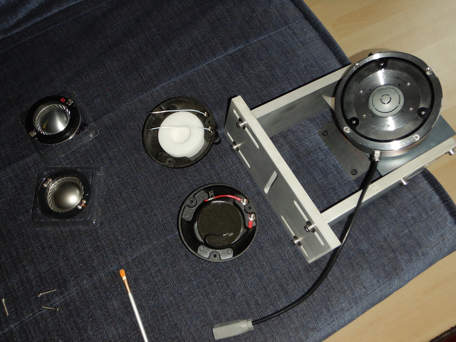

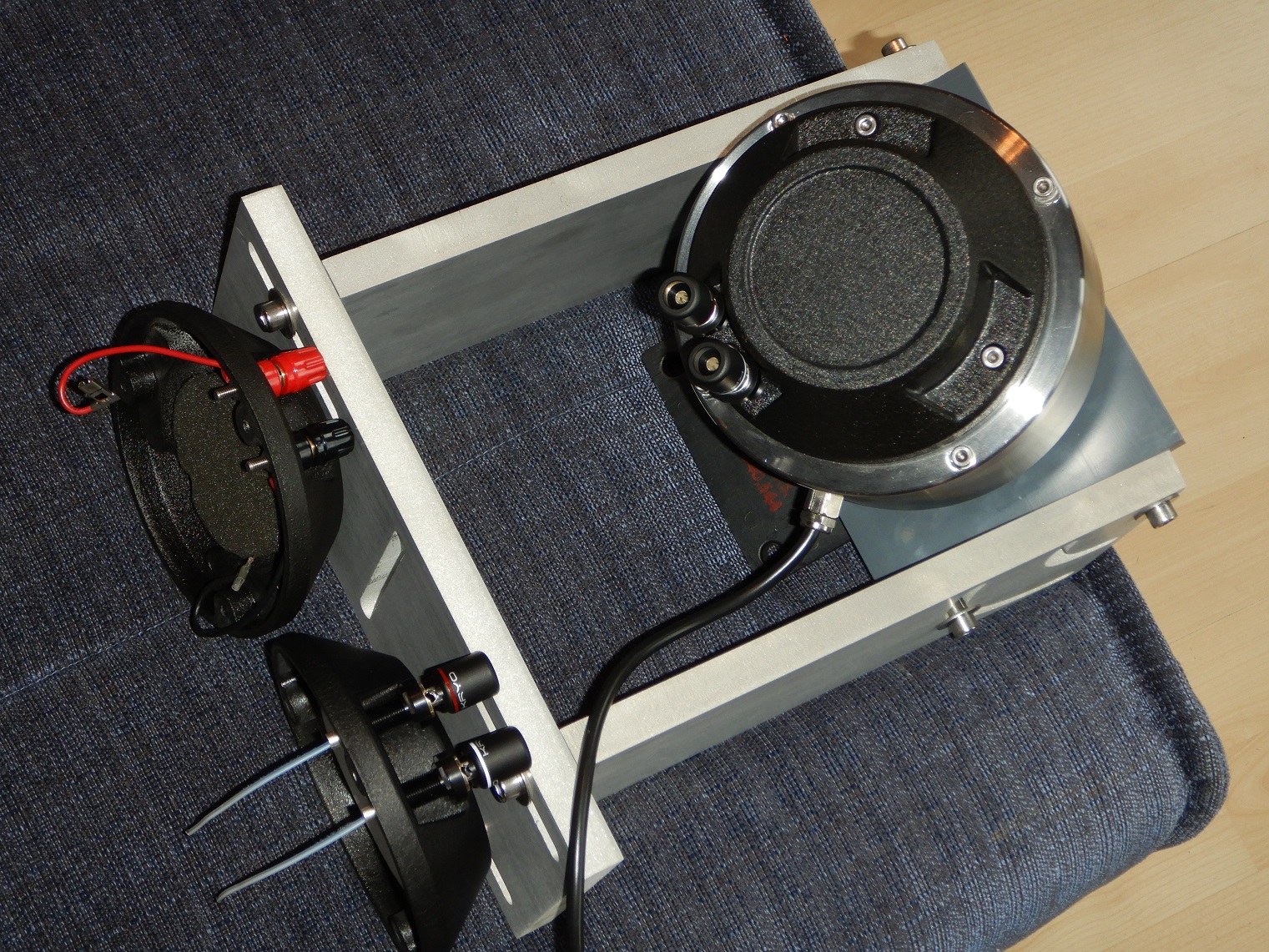

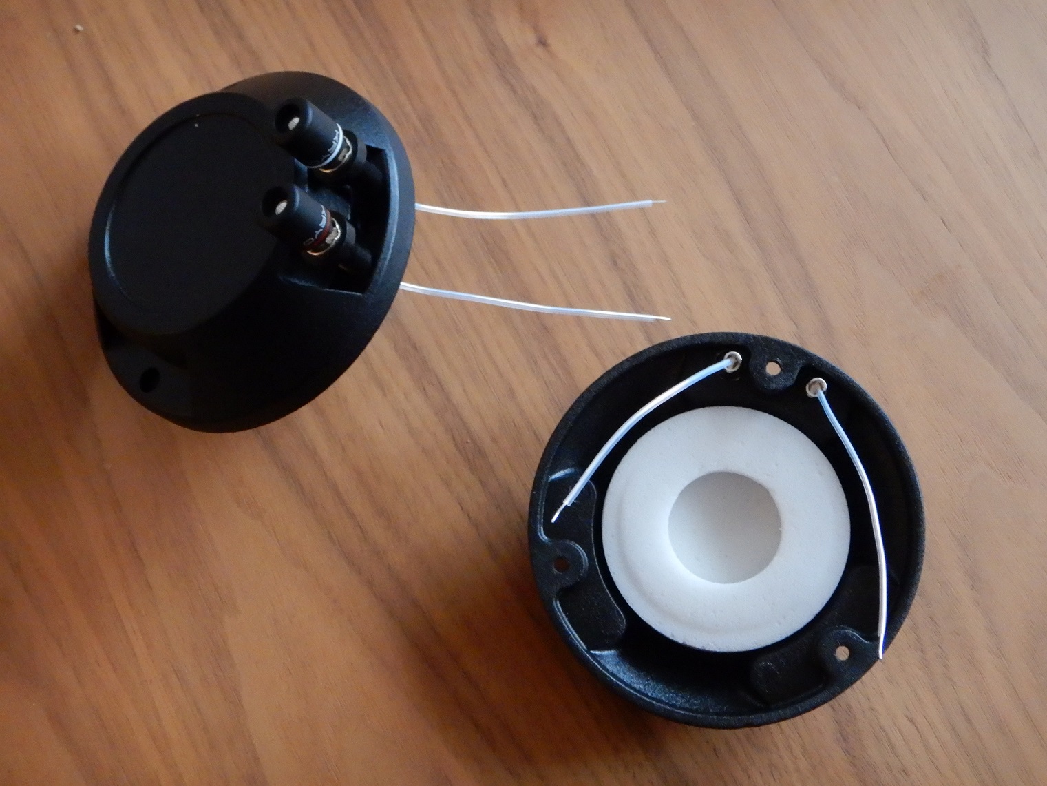

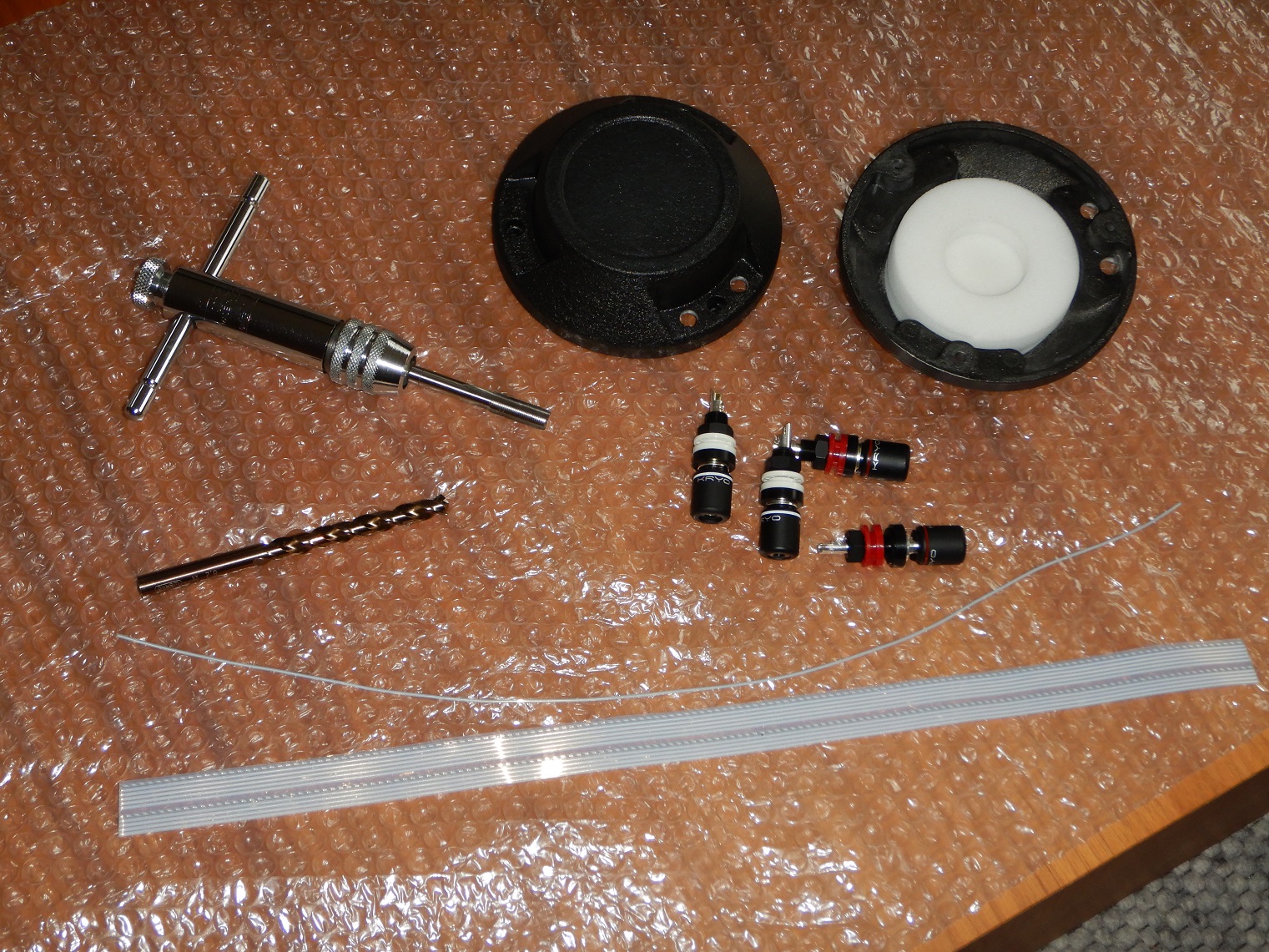

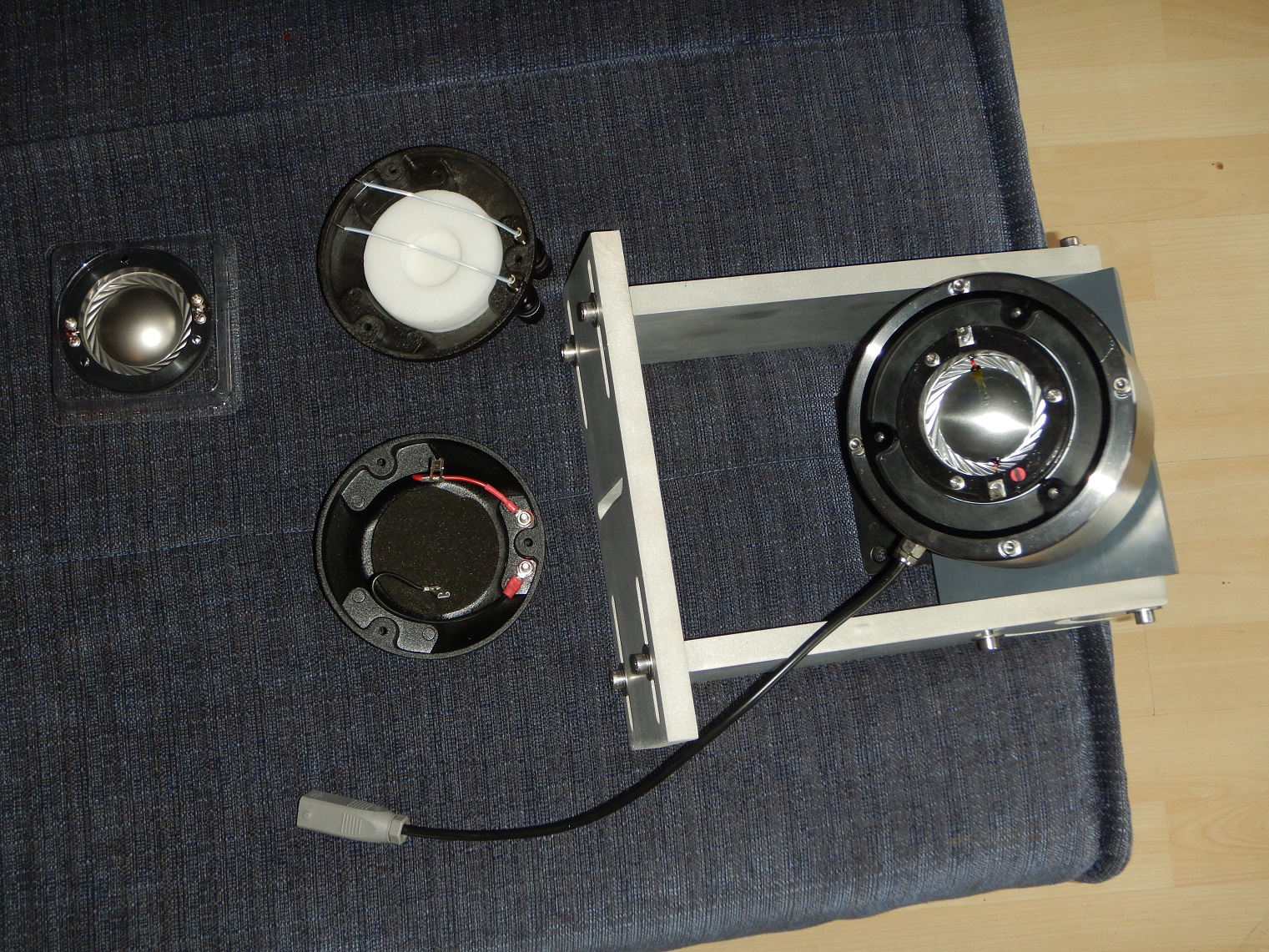

Good afternoon DIYAudio-forum,
with the help of a drill and tap now the Von Langa backcovers have populated with quality ETi binding posts and Audiaz silver wire instead of those horrible original binding posts, the to-be-avoided Faston-connectors and dreadful wire. Much better !
Luckily that i had an extra set of back covers so i could do this "procedure" while the system is playing. With that drilling/thread-making i have certainly metal dust/parts on my clothes and i will NOT open a compression driver with metal particles flying around....
So the actual fixing of the new backcovers + proper will be done later on.
In the meantime: Merry Christmas and a Wonderfull (healthy !) 2021 to you all.
Reinout
(pictures of the original Von Langa innards and the new situation that avoids all the non-audio metal/connectors)
Reinout
Hi Reinout,
you seem to know no mercy with original manufacturer design 😀😀😀
Will the two wires be soldered to the diaphragm?
Congrats to this mod, it looks very good! Do you think it will have a major impact on sound?

Good evening Bernd,
i simply love these drivers but don't understand these horrible audio-constraints like Faston-connectors.
Probably the manufacturers like to stick to Altec-guidelines which stated that diaphragm-replacement had to be done "in field without specialised tools". Those Fastons are great in following that guideline but audio-wise it is a nightmare.
This is not a specific Von Langa issue ! Look at those fantastic Fostex D200a i have; they have the same crappy connection-solution. Or Google the TAD-4001 (fantastic driver !!!!!!!!!!!!!); even that icon uses those crappy sh@# connections. Why ?
Currently there are numerous really serious binding posts (your choice....) and perfect "cable/wire" suited to your liking. If i'm willing to spend serious money on loudspeaker cabling, like many audio affecionados do, this 5 cm replacement of sh@# is an easy upgrade.
With the money involved in all the above serious drivers i would like to see that manufacturers would at least start with a proper audio-acceptable solution. Currently they are just limiting their fantastic products .....which a shame.
In a couple of days (after Christmas) i will install these freshly fitted back-covers and find out the differences. I do not expect a landslide difference but only the thought that my precious audio signal currently passes brass binding posts - tin covered connectors - pvc covered copper wire will be a mental improvement on its own.
I'll keep you posted.
Merry Christmas and a Wonderful (and healthy) 2021.
Reinout

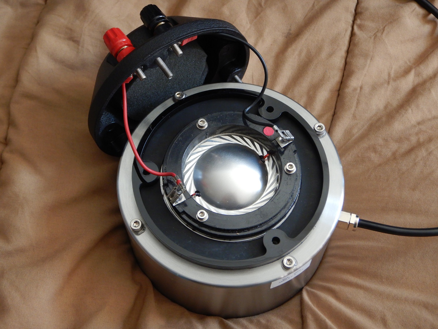

Good morning diyAudio-forum,
yesterday i had the opportunity to swap the inner cables of the Von Langa drivers. My 10 years old son stayed over at his grandparents which is a must before i open up compression drivers ......
The swap itself was easy and straightforward. I dropped 0,1 ohm in resistance (always nice to see that my own contraption is functioning). Happily surprised with the result: more crisp (not hard/edgy !) and detailed.
Although it is only 5 cm of Audiaz wire the absence of the former crappy wire was easy to notice. It was like swapping an interlink or loudspeaker cable.
What a simple and effective upgrade.
A healthy and wonderful 2021 for everyone.
Regards, Reinout
Regards, Reinout

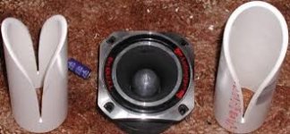

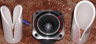

have you tried using a double cutaway K- tube. I like them much better than a single cutaway version. I set mine up centred upon my seated ear height, the tube is parallel to the floor with the cutaway in the vertical position. I start with the tube firing directly at each ear then adjust toe in or out as required to suit my taste. I keep k- tubes on the short side at 1/4 wave of the compression drivers impedance peak or the cone drivers Fs. Longer k- tubes can be easily damped with open cell foam (25 PPI).
Please note that I borrowed the photo of the single and double cutaway k- tubes off line it is not my own, I make mine from single or double wall layer rolls of standard weight graph paper the kind in school note books. These have zero energy storage can be made or modified in a few minutes each and sound wonderful.
How do you compare efficiency and directivity of both versions ?
I can not imagine that thin paper tubes have any effect as wave
guides. Dense tubular cardboard could probably be used. Thanks
I never measured efficiency or directivity of either version I simply listened to each and played with positioning of each and I chose the one I liked best it was not a difficult choice to make. I did not notice any difference in efficiency so far as I could tell. You would be very wrong about using paper as a tube material but if you want to make protoyping and your build more expensive and time consuming build what ever type you like. Having some hands on experience would give weight to your comment on the suitability of using paper as a tube material.
Here is a simple paper tube on one of my compression drivers this is a EV DH1A fitted with a single cutaway paper K-tube. With paper you can experiment with as many different profiles as you like to find which you like best in a single session you never have to leave the room all you need is a pencil paper scissors and a form to roll on (you don't have to have a form it just makes the process faster). Every paper tube you make will be a perfect fit for your driver exit.
Double cut K-tube model for 3D printing is here: 3D printed K-Tube for 1" compression drivers and some measurements here: 3D printed K-Tube for 1" compression drivers
Moray, how long is that single slot 1.4" format K-tube ? I like "The Tube" and clones - on axis (straight down the tube) they go to about 17K with a DE250, but should be elevated or pointed down for best sound.
The double slot tube by Pelanj has excellent sound. It freaks me a bit that I like it best with the slots facing the ceiling and floor.
For K-midrange I hope to try a strong 6 or 8 in a regular and shallow K -"wedge". Softening the hard/sharp inside corners with auto putty might be helpful (?)

the tube was set at 1/4 wavelength at the impedance peak of the driver (around 475 Hz), so the tube was about 5 3/4" - 6" long. I had my tubes (double cutaway) set up so the vents were facing up and down with the solid sections of the tubes to the left and right, tubes parallel to the floor at seated ear height gave best results for me after a lot of different orientations. Hope this helps.
the K-Tube set up mentioned above was used for near field listening. Other orientations of the K-Tube might suit other listening goals more effectively, Omni directional reproduction comes to mind.

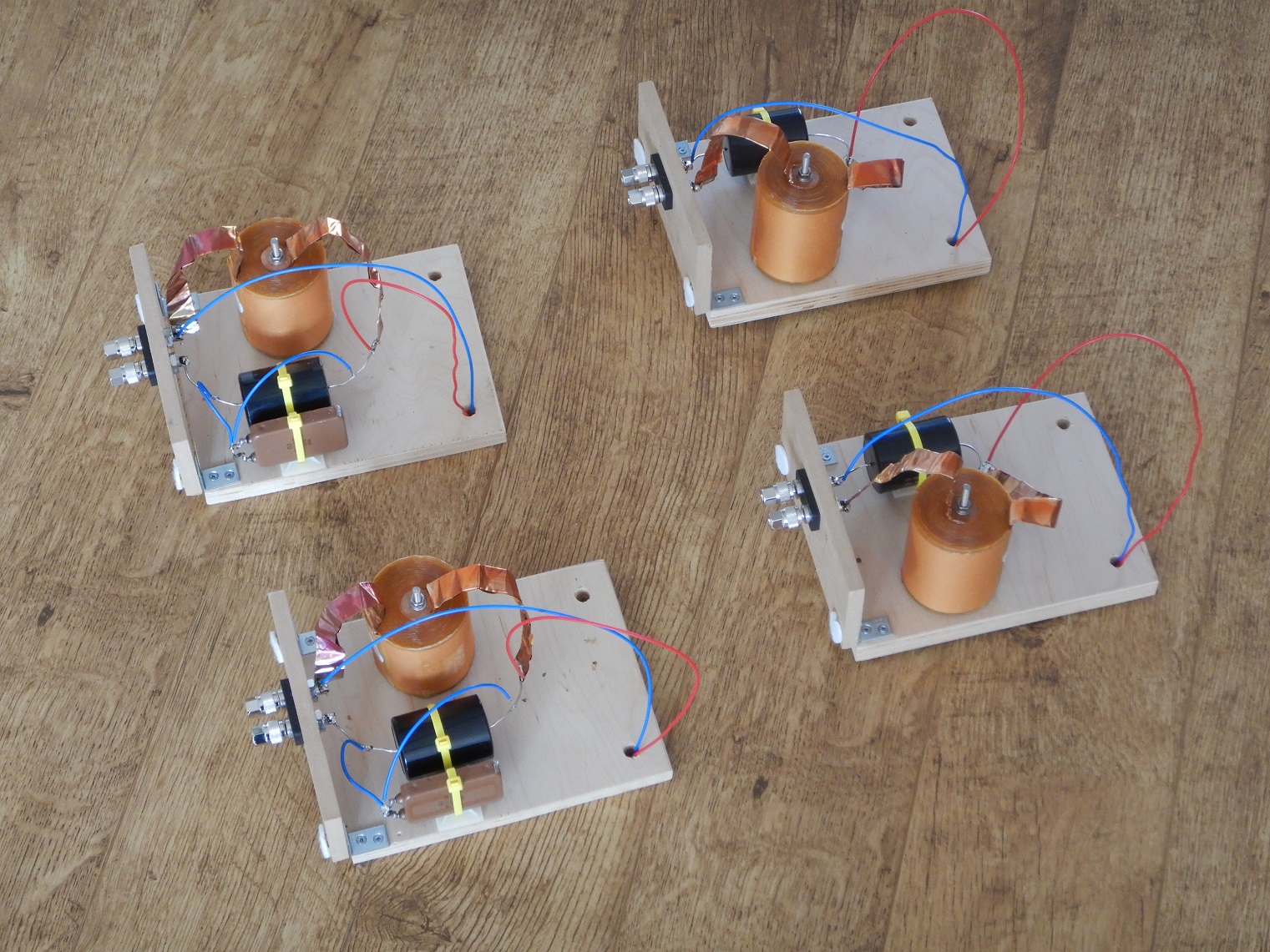

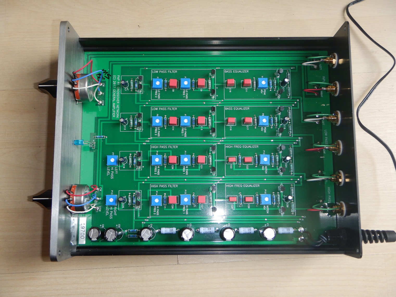

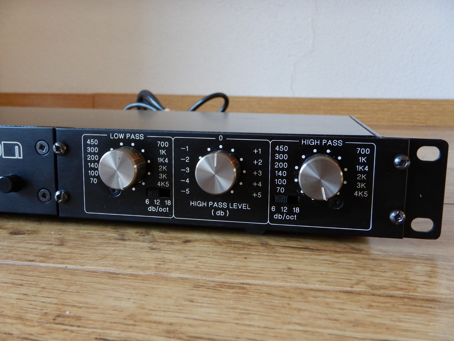

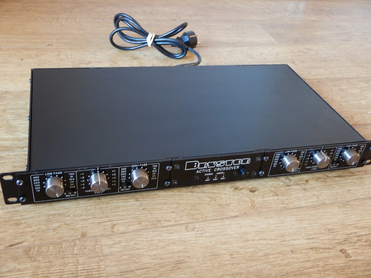

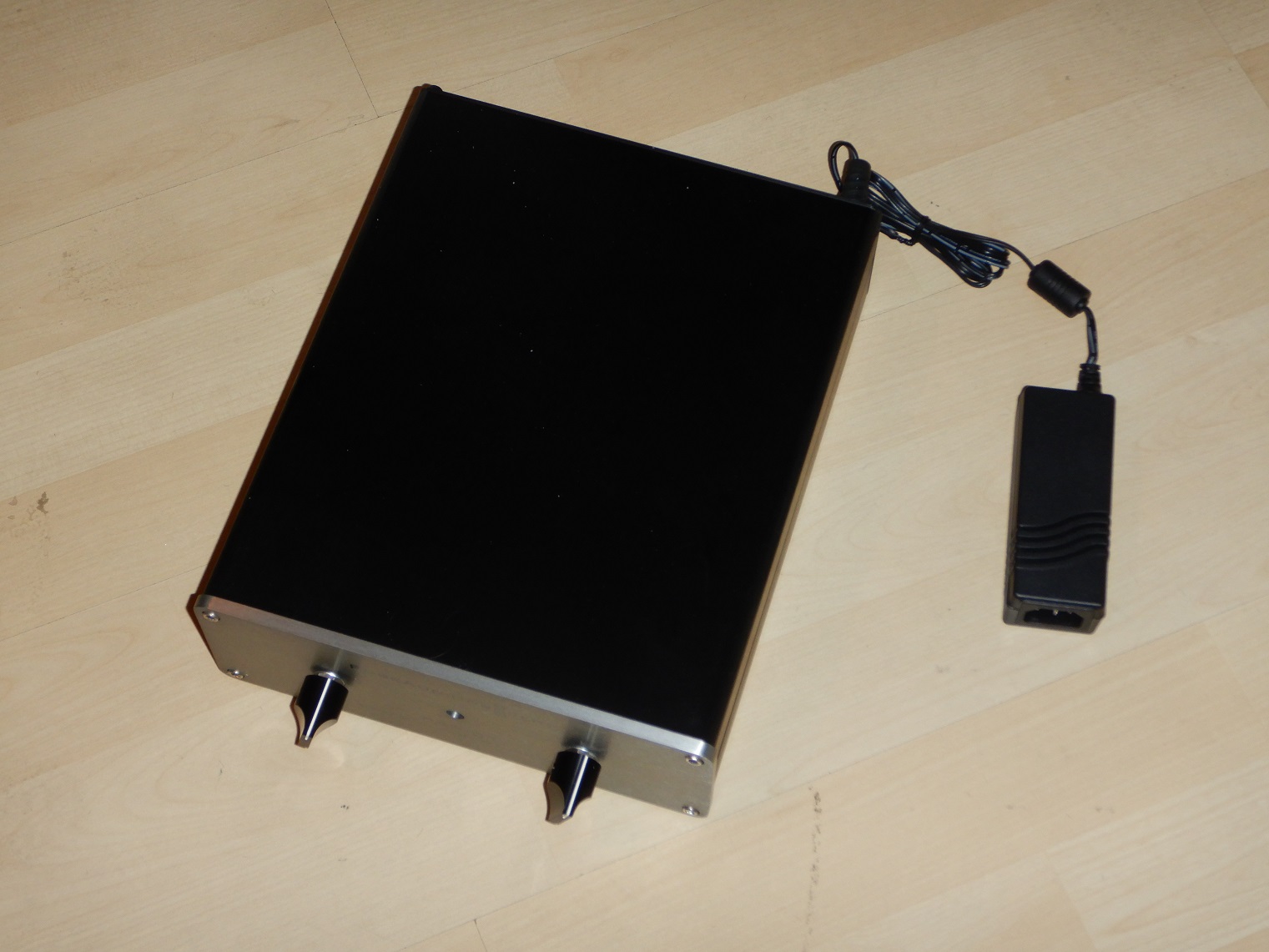

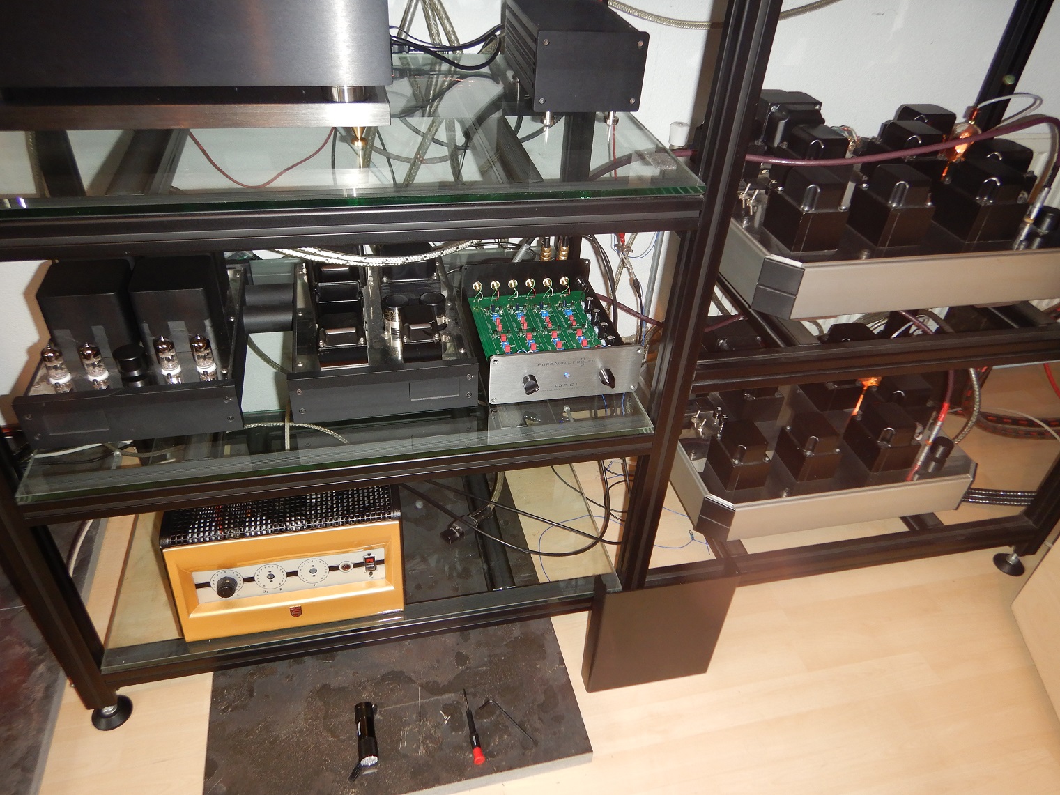

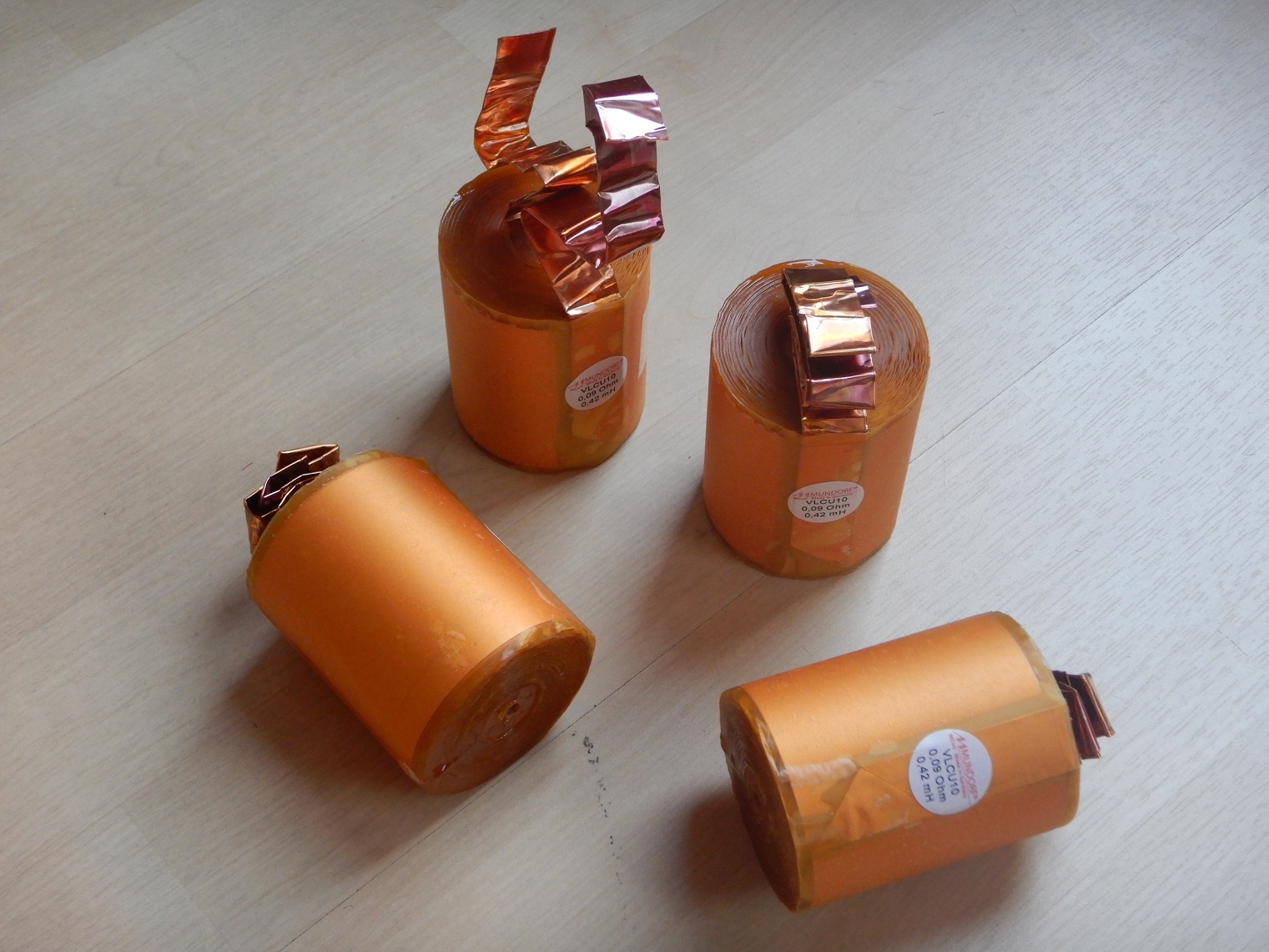

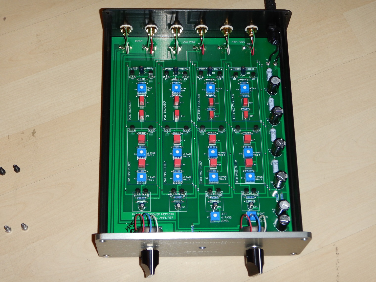

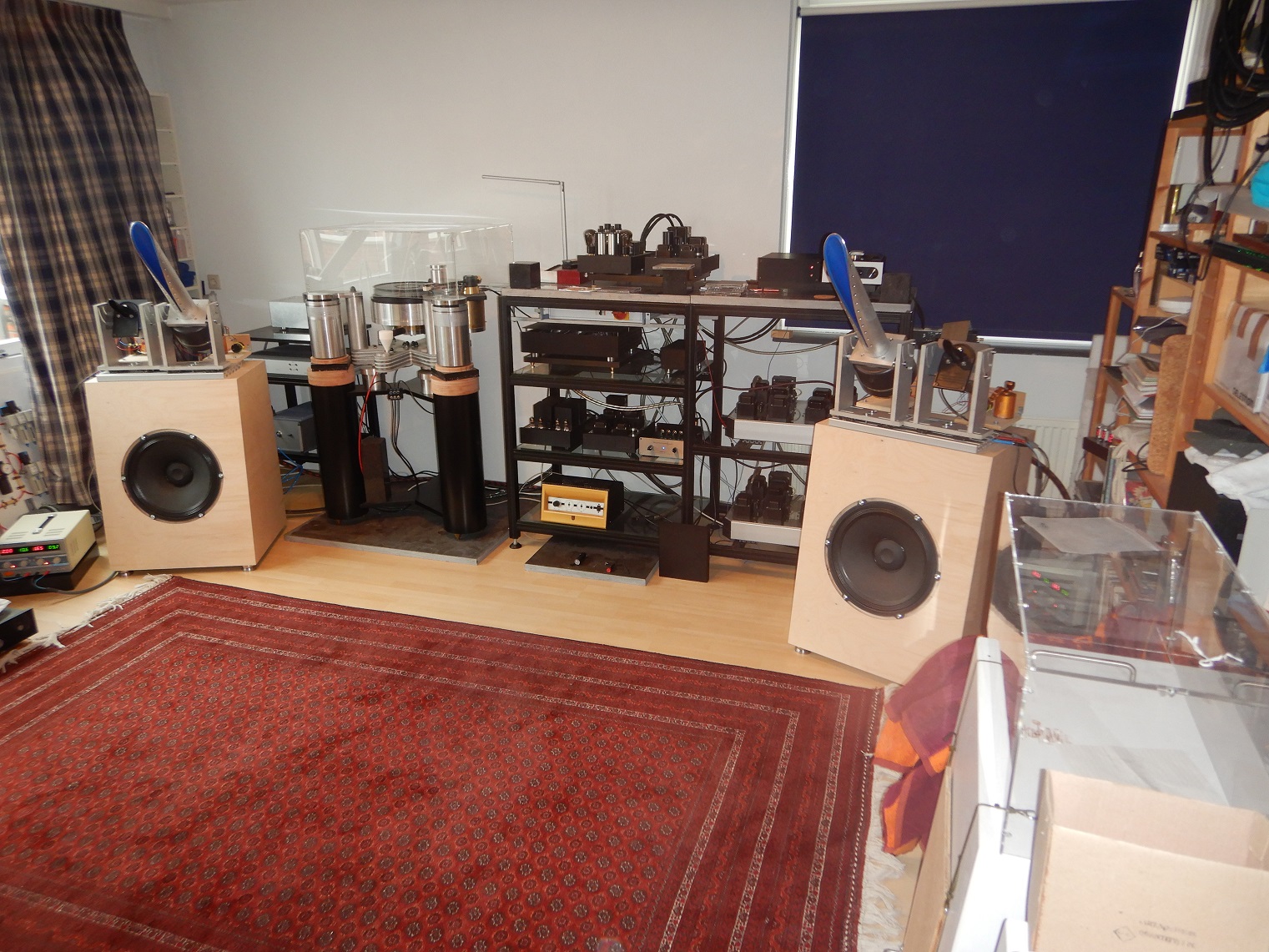

Good evening all,
till now i used the speakersystem with an active XO in order to find the most optimal crossover-frequencies and slopes for the respective drivers.
I had 2 active XO's available:
- a Bryston 10B; an older trusty workhorse. 100% analog, few XO-possibilities but with highly appreciated 6/12/18 dB-slope options.
- A Behringer CX3400; ultra modern device. 100% digital, multiple XO-possibilities, slopes fixed at 24dB.
Soundwise the Bryston won hands down; but that was not the essence of this procedure. With these 2 (different !) active XO's i could found out the correct crossover-frequencies.
The Fertin woofer is happy with anything below 1000 Hz but sounded better with "below 500 Hz".
The split between mid and high was around 4250 Hz (2nd order).
That means huge coils for the bass. I prefer air coils....they exist but they are "interestingly" priced. From earlier projects i have enough experiences with ZeroOhm coils which are acceptable but not preferred here. So i decided to do the bass somewhat different and use the PAP-C1 (Pass XO) to actively divide low and mid/high.
That PAP-C1 is an analog XO (fistfull of FETs) with some tweaking possibilities. The crossover can be set tot 120 Hz - 550 Hz which is spot on for my set up.
So from that PAP-C1 (with a ridicilous minute external feather weight power supply....rest assured....this will be different in near future !!!!!!) the bass amplifier is fed directly.
The other output of the PAP-C1 is split to seperate mid and high amplifiers to be followed by the passive XO-filters near the drivers/K-tubes. With a single capacitor + coil at each seperate crossover-board it made sense to invest in quality.
The coil is the quite new Mundorf VLCU10; the capacitor is Mundorf Supreme SilverOil (prefer this one above the SilverGoldOil).
And after some running in i can state that this is way better then the Behringer-Bryston combination. Bass is deep and the mids/highs are more crisp.
The combination of actively dividing low and mid/high certainly keeps the partnumber of the passive XO down as you only are building a 2-way XO whereas the bass-power is channelled away by that Pass PAP-C1 (which works very nice).
Next project is my own tweeteramp. Currently i'm running my set with an on loan 1,1 Watt E2C SPUD which works flawlesly and proves that 1 Watt should be more than sufficient.
Reinout
