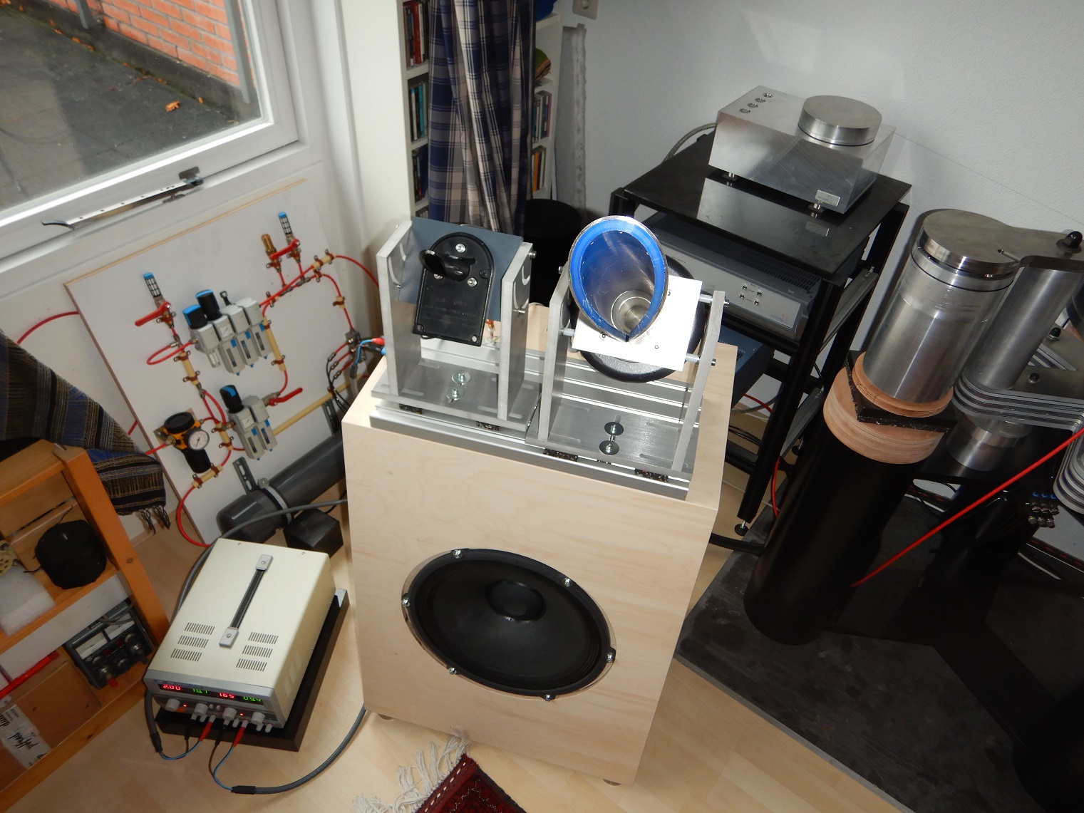

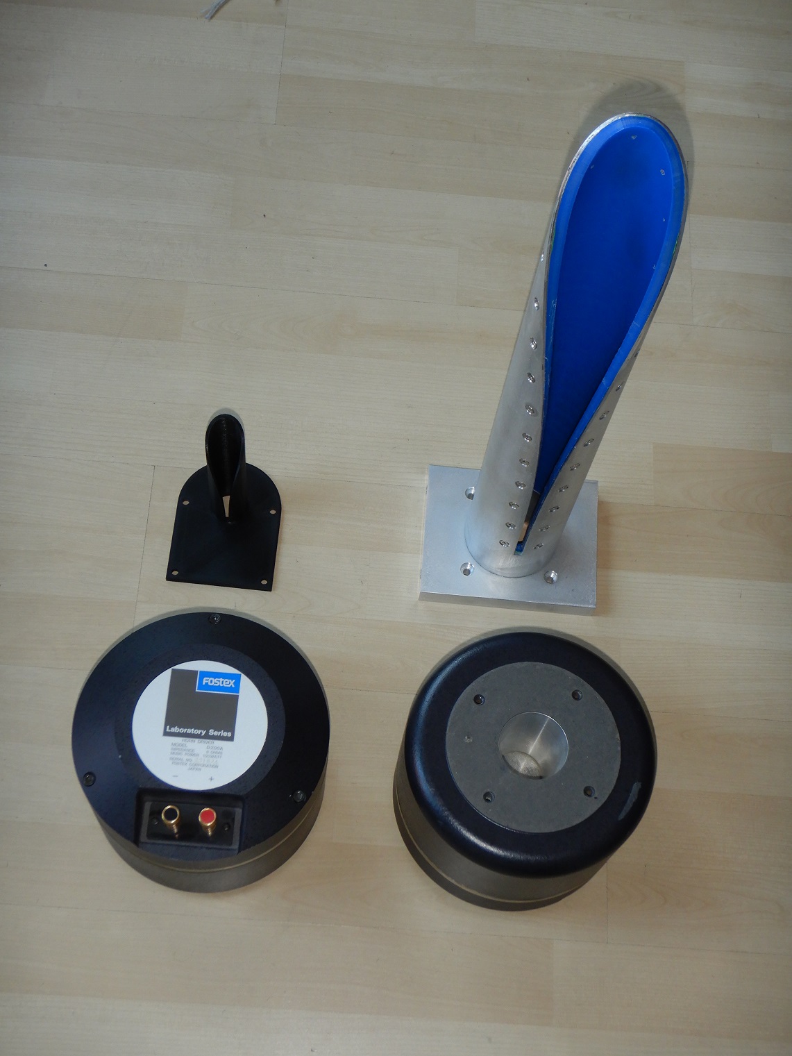

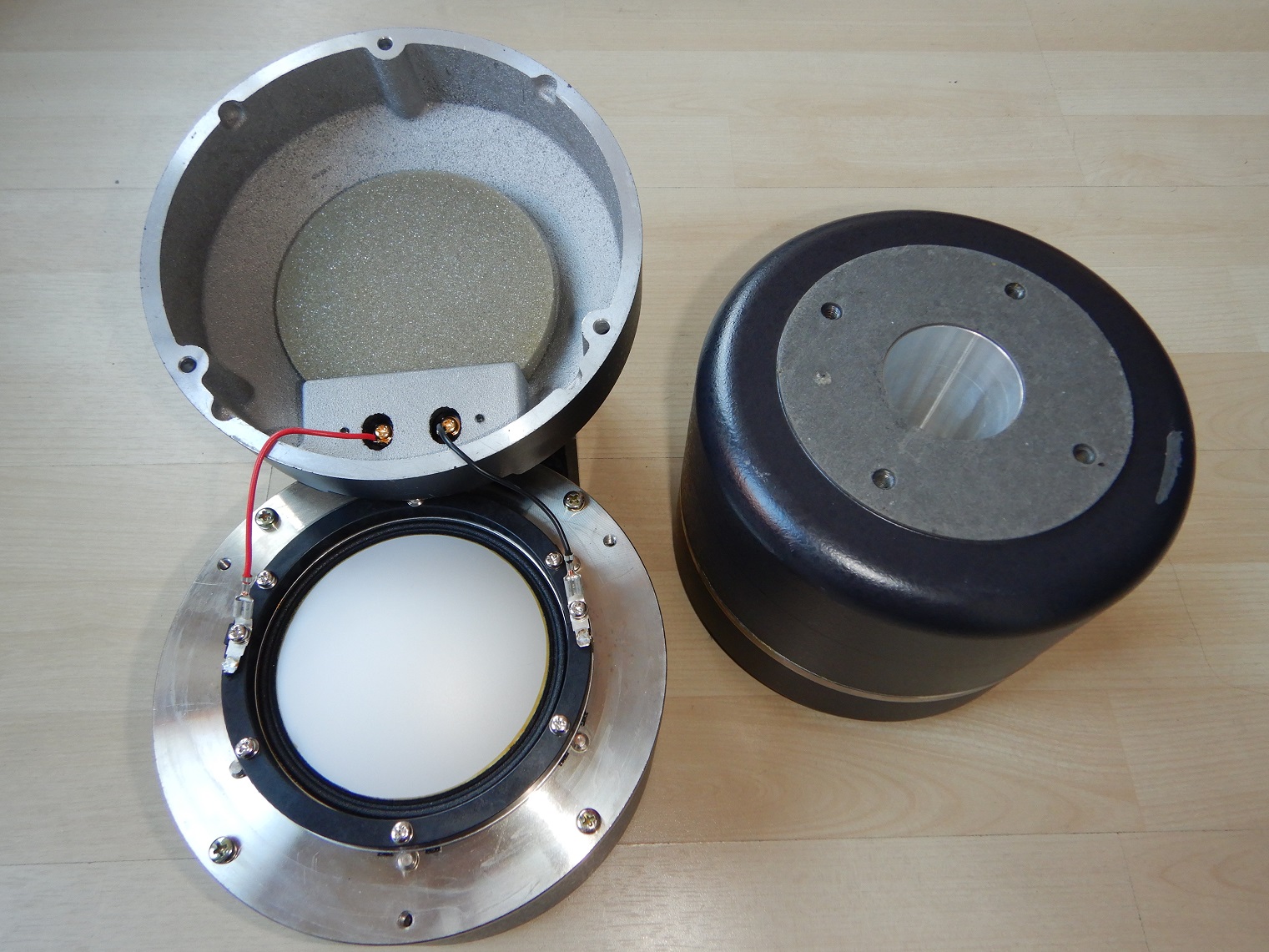

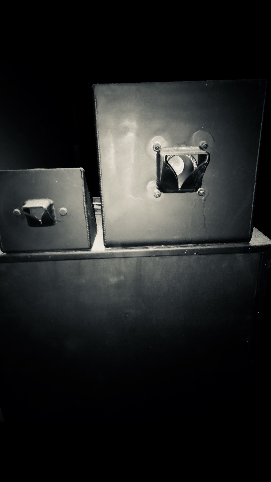

Good morning Freddy,
i have a couple of 2" compression drivers available. So i don't need a throat-convertor.
If everything works out allright i should go from 2 to 3 ways this weekend.....
The Fostex D200A has the best chance for good results; we simply have to see.
Pictures included of that D200A (open/closed/next to 1" and 2" K-tubes).
Also a picture where you can see the other 2" drivers.
Looking forward to this weekend !
Reinout

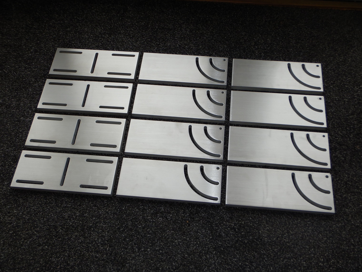

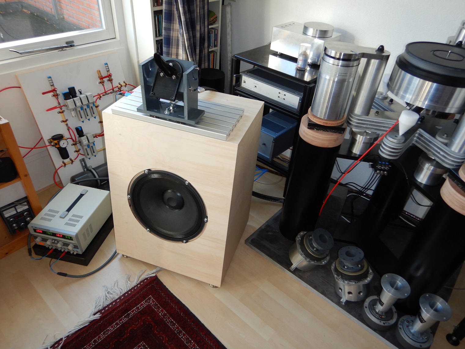

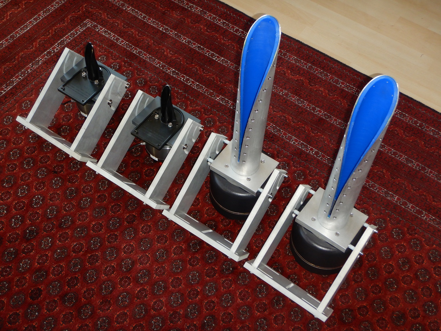

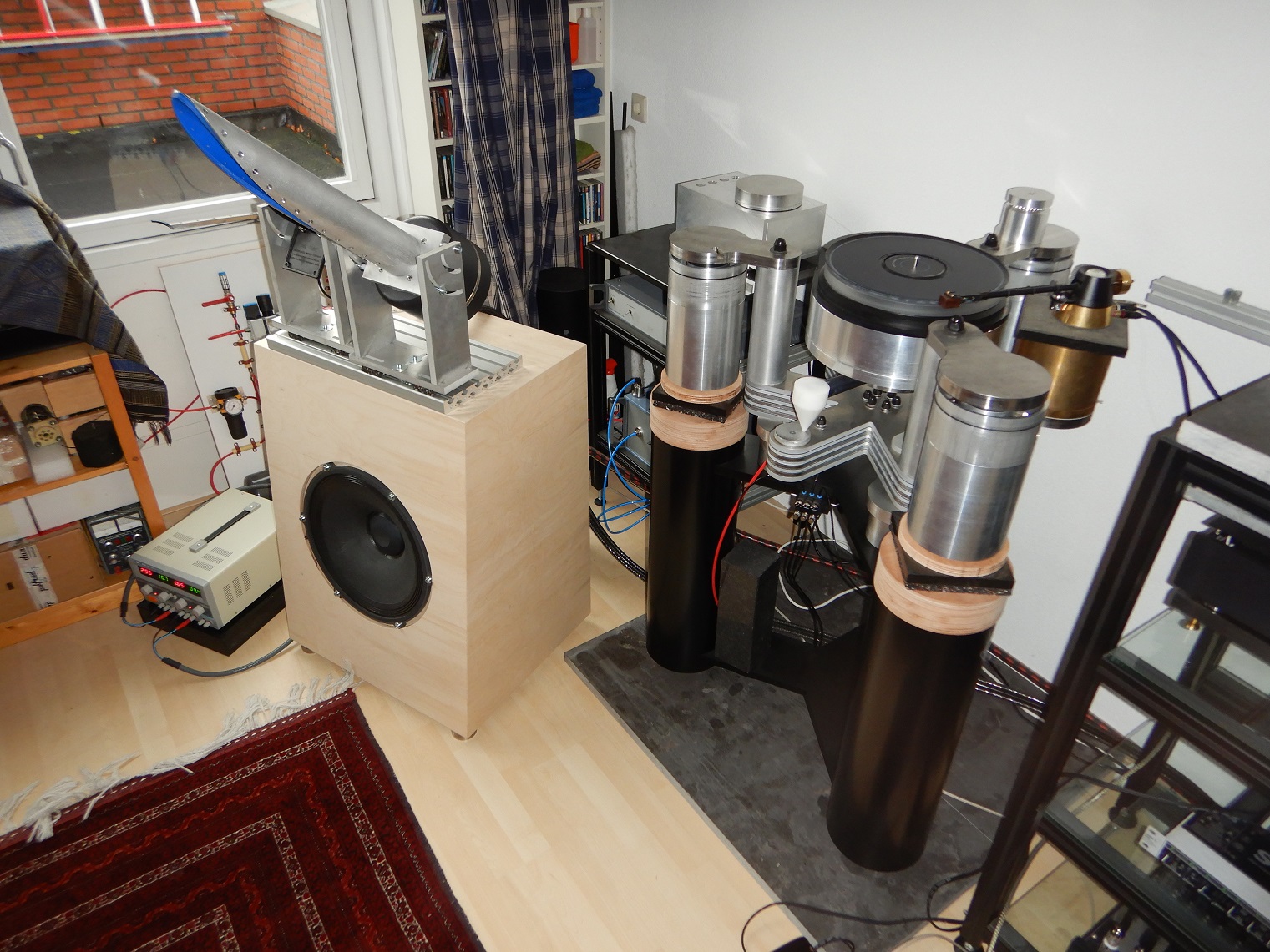

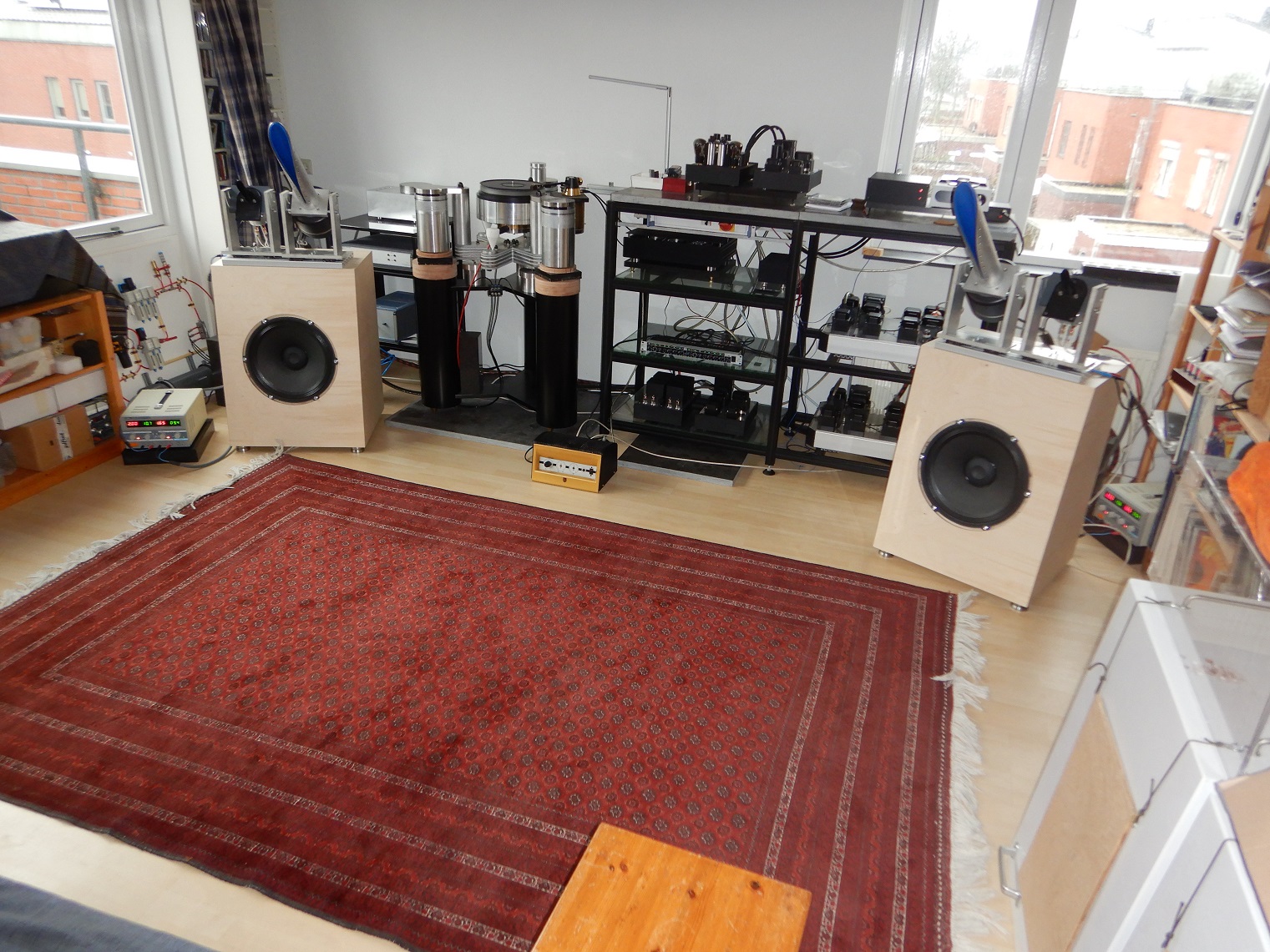

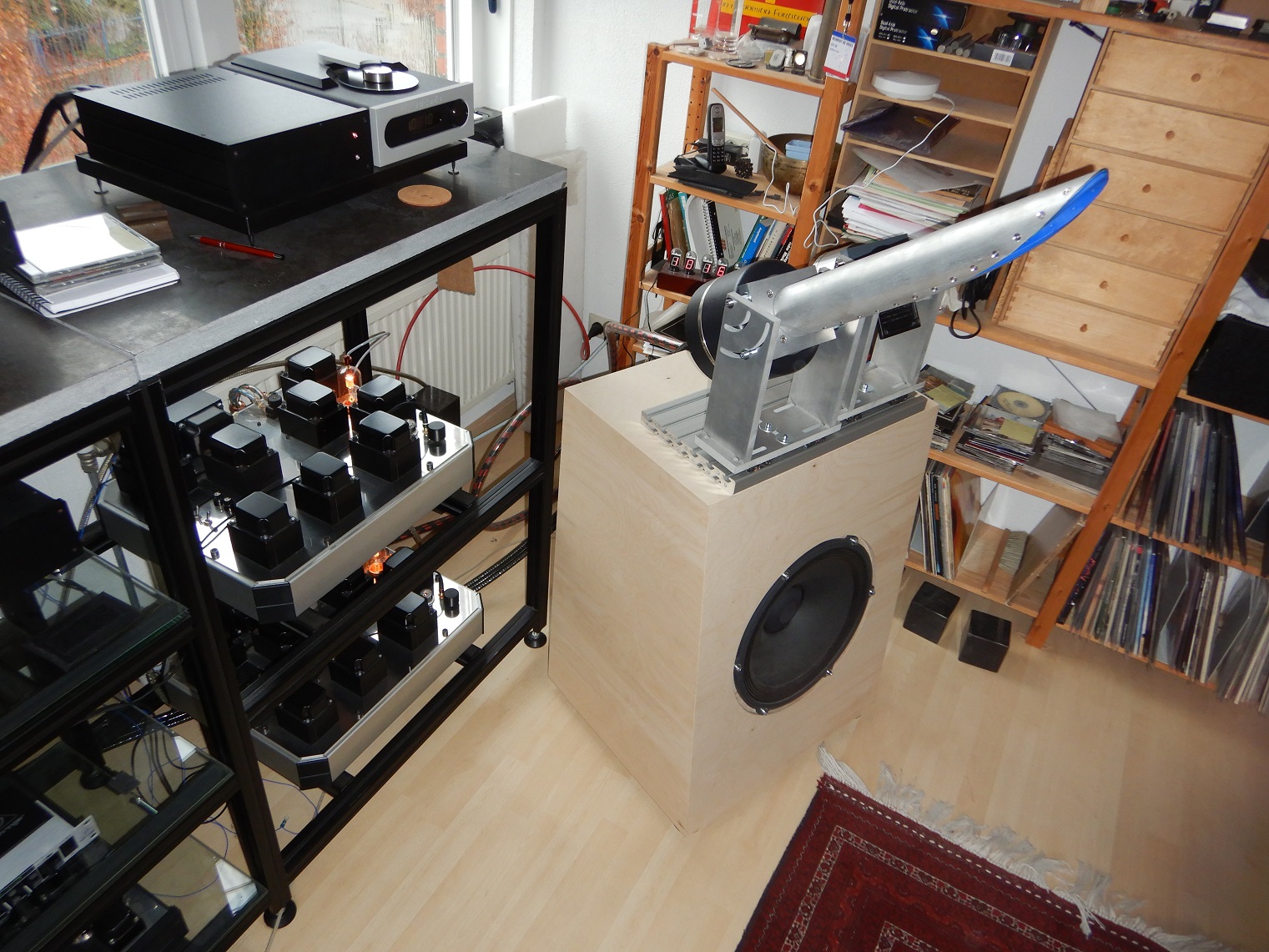

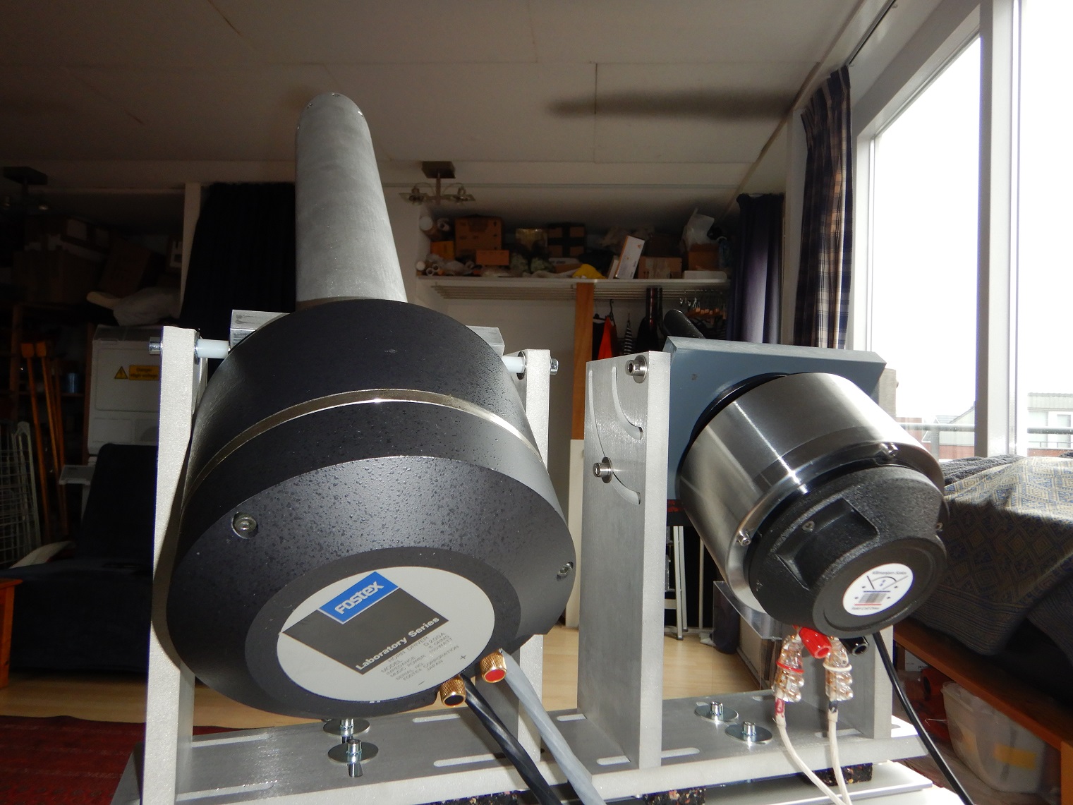

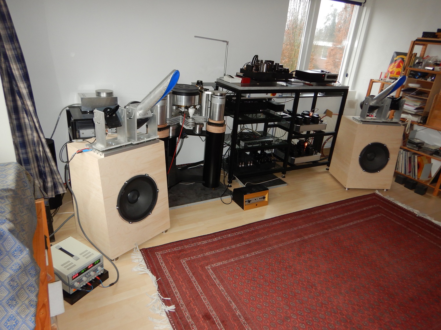

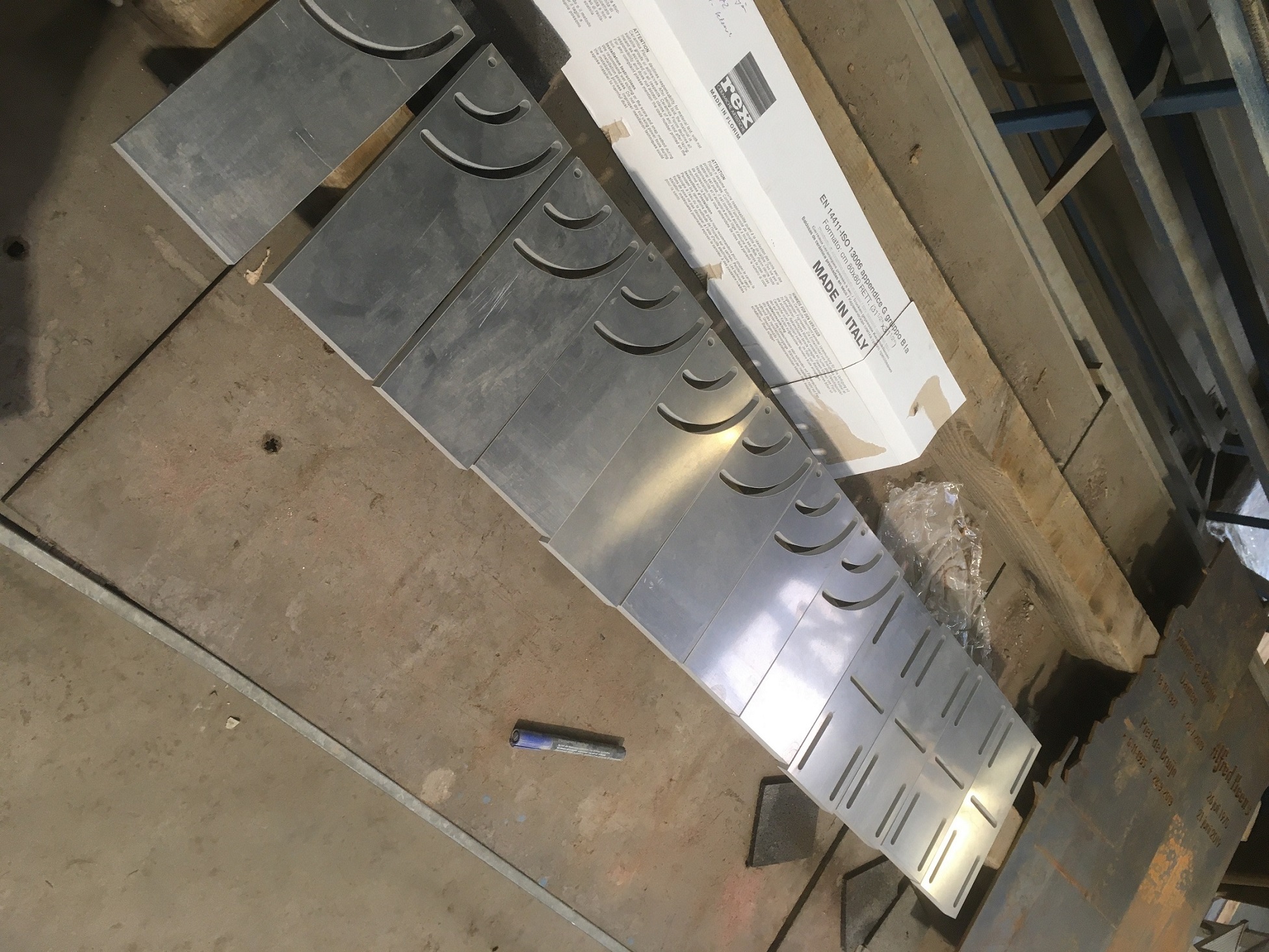

Hurray, the metalwork is finished so i can start assembling the Karlson-frames. And they are needed as the Fostex-driver + 2" K-tube does weigh in at 20 kgs.....
The frames are made from 15 mm aluminium, waterjet-cut so shockingly sharp. It did cost some time to get this stuff more manageble.
From an audio-collegue i could have a tube amp on loan so:
- the Fertin woofer is powerd by my 35TG 8 W amp;
- the Fostex + 2" K-tube is powered by my 6C45 2,6 W amp;
- the Von Langs + 1" K-tube is powered by a 1,1 W E2c amp.
More then enough.
With the use of a Behringer crossover i found out the XO-freqs fast: low/mid in the 500-550 Hz and the mid/high in the 4000-4500 Hz.
That Behringer is a useful toll but not really audio. I'll find another solution for that.
So it's up-and-running and i'm pleased with the result: great soundstage/presentation, oodles of bass and very very direct. There is no hiding possible.
When all crossover-parts are in i'll start with the aligning of the K-tubes.
Reinout

Oh, Reinout,
besides those 15mm aluminum supports, the whole system's composite aesthetic is truly gorgeous and astounding in scope.
What are the dimensions of the Fostex driver's K-tube?
Best wishes,
Freddy

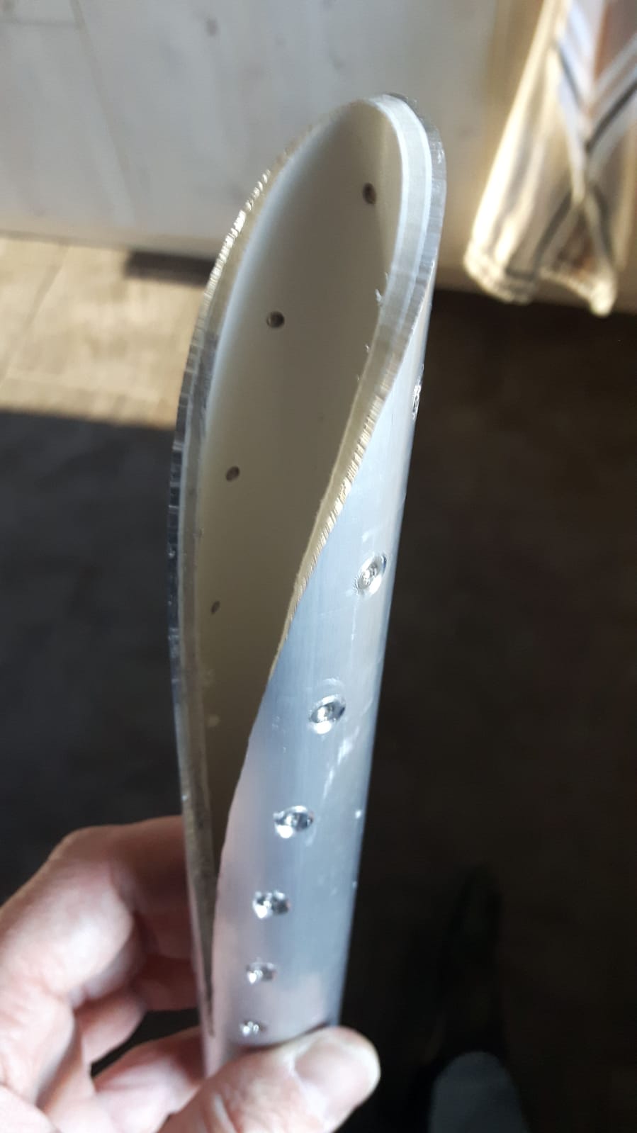

thanks for the nice words. I will pass it to our audio-group as this is claerly a team-effort. At this level you can not do everything on your own and the help / knowledge / materials of others is essential for that next step.
The K-tubes are simply supersized. Sizewise it is just larger; not different. That being said the current large K-tube is made as a 3" version (to be fitted with a convertor to the 2" driver throat). The reason is very simple: we couldn't find the proper 2" material but did find nice 3" stuff.....
With our experiments we found out that resonances in the K-tube are a nightmare and to be avoided. That means seriously adapting the 3D-print. Simply making it heavier did decrease the resonances but lesser than expected/hoped. The best way for reonance control was stacking different materials so we went on looking for 2 tubes that fit perfectly in each other.
So the inside of my 3" K-tube is made from layered polypropylene and outside is made of aluminium. If you look closely at the picture at the blue plastic you can see the layering inside the plastic.
My audio-collegue doesn't have the original THE TUBE so he made a 1" K-tube himself on the same principle: 2 totally different materials (alu outside, plastic inside) and even the inside plastic is layered. See picture; white plastic.
And to be honest: that K-tube is simply better then my original......
Reinout

Hi Reinout,
That one inch K-tube looks great. Did your team also investigate the little klam? It would not have much air load but I gave a printed one inch format version a brief listen with Altec "Symbiotic" 808 and thought it could have merit for certain applications,
Best Wishes,
Freddy

Here's an ultra low resolution picture of an Acoustic Reality brand lens from years ago. It was used in a small sealed box with Eminence's Beta 8 and the compression driver was an Eminence 1" bolt on. In those says, Eminence's compression driver only extended to around 12.5KHz, and had an aluminum diaphragm. Sometimes those were subjectively preferred to the later titanium diaphragm.
https://i.imgur.com/PYRH9Ig.jpg
A 1944 British microwave patent application is the closest thing I've seen yet for ancestor of the clam/klam. (other than an ancient water sprinkler nozzle 🙂). It was referenced in Karlson's Open End Waveguide Antenna patent which relates also to acoustic K-tube.
I will try to find out.

Hi ReinoutdV and as_audio
do either of you know of folks experimenting with "K15 style" bass - midbass couplers who might share some findings - or at least give some hints towards what works best for them? Some of my K-type have been very good sounding, some including Karlson's originals, can sound very good to very bad depending upon the speaker chosen. (assuming no EQ applied)
Some couplers measure fairly well, others may exhibit a couple of deep dips.
GregB's "Karlsonator" with its offset driver solved a lot of problems. Transyvania Power Company's X15 box plays well but its not known how it would behave scaled. A stub connected to the top of K15 type can add volume to the front chamber and help tame the first peak.
The curved reflector and cavity shape it can present are another unknowns. One builder said his X15 size cabinet made with a fully curved reflector was an improvement over his earlier builds with several flat panels for the reflector, (all of his builds have the K-tube mounted internally)
I've had several K turn out pretty well - but other than intuition, and messing with them, don't fully know how to design the thing. (IMO they should be listenable without resorting to front cavity damping materials)
Certainly a poor choice in driver can ruin results.
Best,
Freddy
Best,
Freddy
