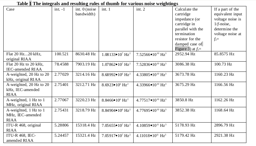

Looking at the noise specs, those op-amps are both very suitable for moving magnet amplifiers, but what you wrote about LF noise is only correct when you are interested in the unweighted noise at the RIAA amplifier output.
When you take into account RIAA and A-weighting or RIAA and ITU-R 468 weighting and assume that the voltage noise is partly white and partly 1/f, what matters most is the noise density at 1162 Hz and 2897 Hz, respectively. For a given noise density at 1162 Hz or 2897 Hz (or 1169 Hz for A-weighting and IEC-modified RIAA), you always get the same total output noise no matter what part of the noise is white and what part 1/f.
I know JFET noise can have more exotic frequency dependencies than just white or just 1/f, I never tried to find a break-even frequency for those. Still, the fact remains that the bass boost of the RIAA correction is slower than the low-frequency roll-off of A- or ITU-R 468-weighting filters.

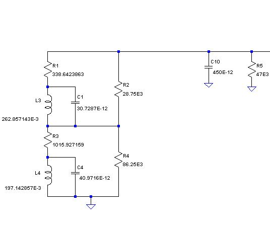

By the way, I don't think this will help you with your distortion issue, but an acquaintance of mine once measured the impedance of a Shure V15-III and much later, I made a LTSpice model for it. It includes iron losses and parasitic capacitance, but no mechanical transfer. See the attachment. C10 and R5 are the load, so they are no part of the cartridge.
Marcel, thank you very much.
Can you please specify which units those are: ohms, mH, nF or pF, etc.? You only mention those on the right, which are obviously the cartridge load.

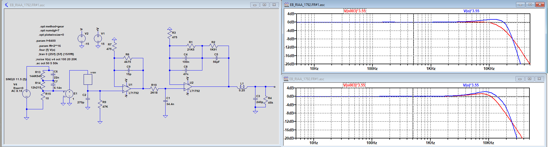

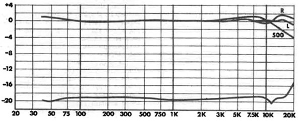

Using Marcel's replacement circuit for the V15III in Carlmart's circuit, I tried to add the mechanical resonance, thereby looking at Stereophile's recorded FR for both 170pF and 500pF, assuming a cable capacity of 100pF to be added.
Result is below in both images, showing the FR before (red) and after the resonance filter behind the output (Blue).
It's clear that the real thing is even more complex because of secondary resonances in the cantilever, but as a first approximation it comes quite close to the recorded FR.

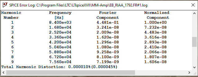

When offering a 8500Hz signal producing 280mV rms at the output, distortion is below ppm level as shown below.
