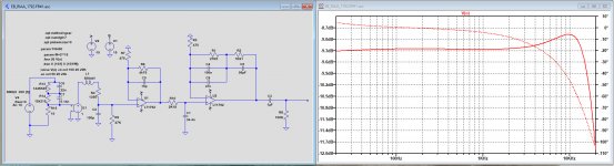

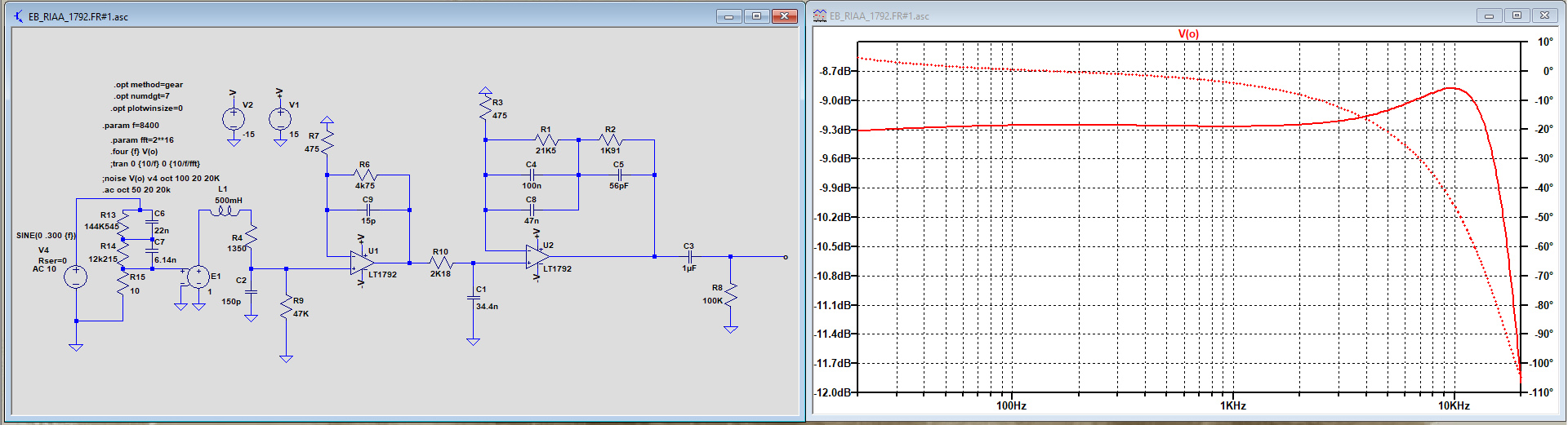

OK, I have been playing with different values for the 750 ohms resistor.

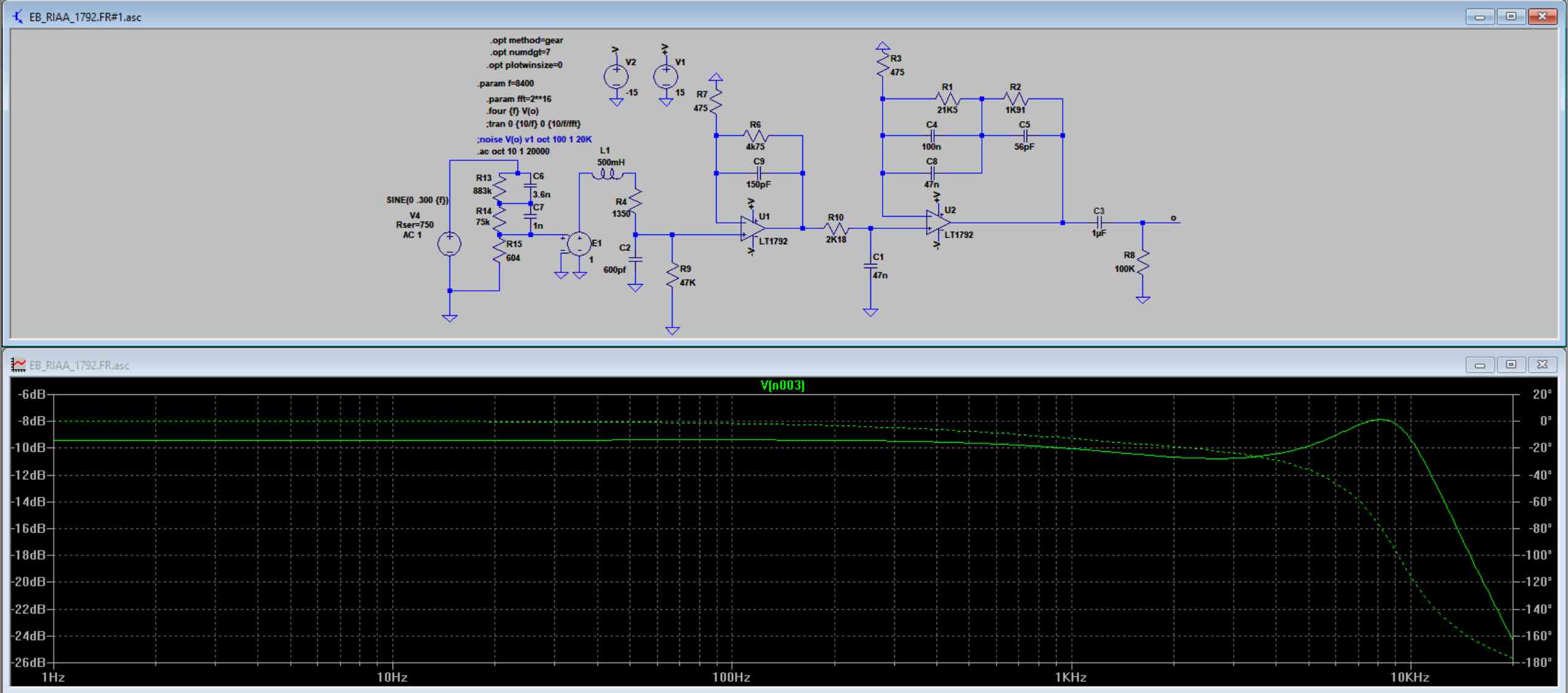

No one seems to have commented anything on that experiment I did, replacing Borbely discrete stages with LT1792s. So I wonder if this is I'm trying is something valid, something realistic, that the results the simulation shows mean there's an actual improvement or is just a theoretical game, to call it somehow.
What I did was play with that resistor only, and when I get to 2K18 the FR curve gets flatter than with 750, at least on the hump on the right, which is present in all simulations with the Shure V15 load. If I increase the resistor value further the FR curve starts to get weird.
What I would like to know is if such results are meaningful, have any significance. I'm pretty sure this experiment has been carried out by many people, perhaps Borbely himself.

Do you keep the time constant R10 C1 constant, that is, change C1 inversely proportionally to R10?
You mean that if I increase R10, then to decrease C1 in the same proportion, right?
But I was looking at flattening the response curve. I guess that is not allowed then.
Ah, I didn't understand that. If you want to flatten the response by tweaking time constants, I think it is better to do that in real life using a test record, assuming those are accurate enough - I haven't a clue if they are, but Bill probably knows. The problem with using the simulation for flattening the response is that there are two things missing from the simulation model: the mechanical transfer of the stylus-cantilever-magnet and the iron losses of the inductor. Both have an impact on the response.

O.k. here it is, see the image below.No one seems to have commented anything on that experiment
First of all I have replaced your anti riaa network with a more accurate one.
Second, I have replaced the rather huge cap at the input to 150pF.
And since the passive network should have a RC time of 75usec, I changed your C1 into 34n4.
The FR response as a result of that is shown in the image and is caused by the Cart.
It is possible to make this flatter by letting the 75usec pole be taken over by a much lower input resistance as the 47K you are using, with two disadvantages
1) every Cart will need a different termination resistance and
2) you will loose some S/N, but this amp produces so very little noise that it will not be a point to worry about,
I have also taken the opportunity to change the LT1792 for an OPA1656 and a-weighted the output noise, but the difference in noise production was only marginally in favour of the OPA1656.
Hans

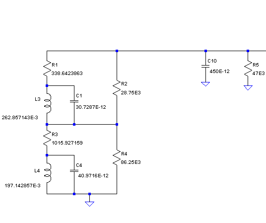

Shure recommends 450 pF for the V15-III, but on Stereophile's plots, it looks flatter with a smaller capacitance:
Shure V15-III phono cartridge | Stereophile.com
Unfortunately the recommended load capacitance is different for each cartridge model, and you have to subtract the cable capacitance to find the right termination capacitance.
Well, sorry to say but now I definitely know something is not right in that cartridge we are using on the simulation.
For the first time I loaded it on the simulation I had for the discrete Luxman 5C50, which is the best RIAA preamp I have ever heard, always using a Shure V15III.
The FR seems to look "fine" not much different from the others I saw using the cart model load.
But what I got when looked at the THD, with the same 300mV input and 8400Hz was very poor. And this had been a preamp that had had brilliant, superb results in the reviews from the time it was released.
So I'd say something is not right in this load.

Did you take the usual precautions: long enough settling time, switched off waveform compression, tight accuracy settings and so on?
By the way, I don't think this will help you with your distortion issue, but an acquaintance of mine once measured the impedance of a Shure V15-III and much later, I made a LTSpice model for it. It includes iron losses and parasitic capacitance, but no mechanical transfer. See the attachment. C10 and R5 are the load, so they are no part of the cartridge.
