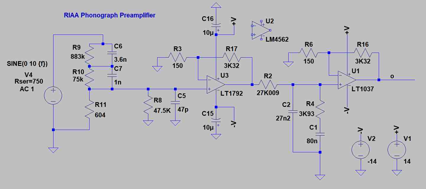

Assuming we are still discussing this circuit, https://www.diyaudio.com/forums/att...bjt-input-phono-preamp-lt1792-riaa-preamp-jpg , an OPA637 should theoretically work somewhat better than an OPA627 - both should be stable, but the OPA637 will have five times more loop gain at high audio frequencies. The OPA627/OPA637 noise specs are fine for moving magnet and the offset is quite low.
Yes, the circuit should basically be that one. But if possible I would like to build two versions, perhaps using that PCB I had mentioned which is very cheap, one passive (as the one you showed) and a passive/active hybrid one, and see how different they sound.
Then it would only be a question of plugging the opamps in one and then in the other one.

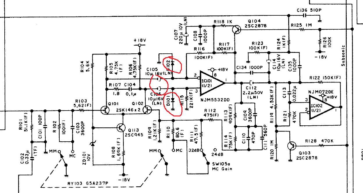

here's a circuit that's haunting me for a while taken from the Nakamichi SR-4 receiver .Clearly no offset or saturation problems depending on the kind of diodes used...i'd try some Schotky there.

Nothing special about it, and I don't think it will sound better than the circuits I have shown. Nakamichi was good for other things, not phono preamps.
There's a mic preamp design that has the same architecture, with two low noise BJTs on first stage. It just sounds OK.
You need to see their CA-5e, Ca 5EII(Ca-50II) , CA 7 and Ca70 control preamplifiers before saying anything about Nakamichi phono preamp skills...Besides CA-5E is a Nelson Pass design.They were good in anything they did.I am impressed with that little phono preamp because it solves some basic problems of phono preamps in a very simple manner.

So what I did was load the schematic into LTSpice, but using the same LT1792/LT1037 of the other preamp.
Now: Borbely's proposal was to use first the passive stage and then active one after it. So I inverted the stages on Elliott's preamp. With an accidental mistake: now the first stage was the LT1037 and the second stage the LT1792.... .

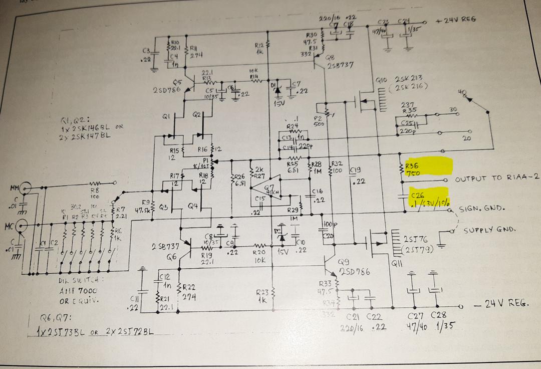

The arguments I've seen for this topology make make me lean towards this type splitt-Eq also. Borbely is not the only one to advocate this split passive LP active Bass boost.
The op-amp based design posted by J.Curl in a thread here on diyaudio, the Rotel Rq-970bx, the NAD S100 discussed previously in this thread and the above mentioned Emerald are other examples.
......., I estimate that with unequal impedances, the noise current will double to 0.8 pA/sqrt(Hz). That's not too bad, but an NE5534A or a good FET op-amp can easily outperform it for moving magnet.

Attached is the first stage and passive Low Pass of a two stage RIAA amp published by Erno Borbely. In the article he makes a comment that he has been able to reduce the value of the series resistor in the LP filter (R36) to 750 ohm for noise reasons. The JC published RIAA uses 1600 ohm, the Emerald 2K26 ohm and the Rotel is all the way up at 75K. Without having done the calculations, I suspect that the high impedances in the Rotel LP passive networks warrants the use of JFFET amp also in the second stage. The Emeralds value of 2K26 seem be good in the sense that most op-amps can drive this load and the filter network would pose a low source impedance for the second stage.
