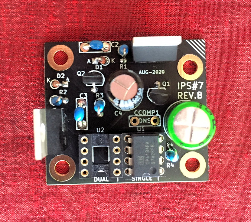

Certainly it is POSSIBLE to lay out your PCB so it will accept either single opamps or dual opamps. M2X IPS7 does this; photo below. Click on the image to see it full size and undistorted.
Guess so, but it should be quite tricky.
Perhaps design it for dual IC should work. Then using two-singles to one dual adapter, now a bit difficult to find.
My first idea, some pages back, to use a RIAA kit sold by Airexpress and eBay, might be a better one.
Deciding on the better schematic and chip it's the important decision, I guess.

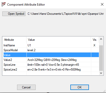

I have made a subcircuit called OPA1656 based on the UniversalOpAmp 2.
Have entered all the specs from the OPA1656 into it, see first image below.
For a subcircuit you have to make a .asy and a .asc file and place both in the directory that you are using for your model, they are in the .zip file below.

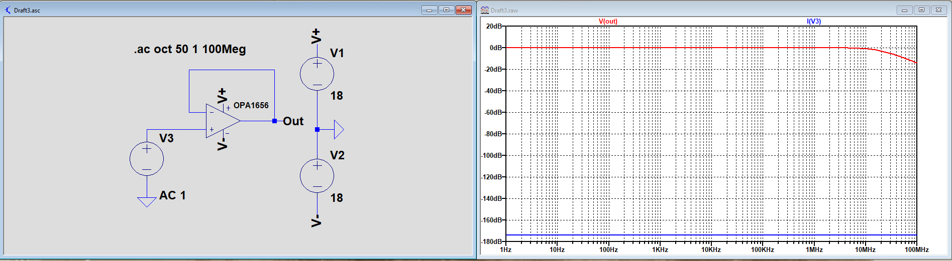

Then I inserted this newly created OPA1656 into a schematic and checked it with a FR sim.
You know how to insert a subcircuit into your model ?
Do as if you are going to select a component by pressing the And gate in the Menu Bar as you normally do, but now at the right of the Top Directory line press the little arrow pointing downwards and you will get the OPA1656 in the area below. Press it and place it in your model.
Succes,
Hans
