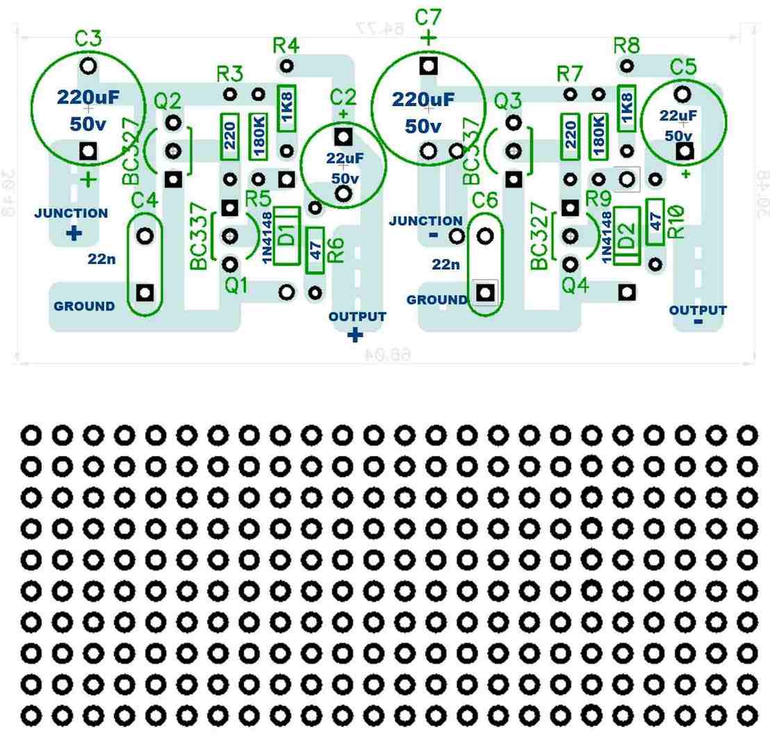

Yes, you're probably right in trying a perf board, also adding the regulation on same board. Something like this would do:
3pcs 8x12cm Double Side Copper Prototype PCB 8*12cm Universal Printed Circuit Board Fiberglass Plate For Arduino Soldering Board|Single-Sided PCB| - AliExpress
For the prototypes, what I do is load a perf board on the pcb program, and then proceed as if I'm drawing a normal pcb.

I have been carrying out LTSPice simulations with several power supplies, and the proto pcbs might be a way to start. I enclosed an example on how I have been thinking of dealing with pcb prototypes using proto pcbs.
In that case it was a small add-on circuit for regulators, called the Dienoiser, dealt with on another thread of the forum. But I'm already designing a Jung/Didden pcb with the same approach, and how I would do other prototypes.

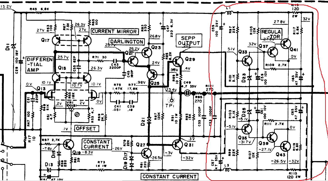

or the nakamichi kind of regulators:
https://www.diyaudio.com/forums/power-supplies/359652-fine-ic-voltage-regulators-25.html#post6348364
or the kenwood like type of regulators
https://www.diyaudio.com/forums/power-supplies/359652-fine-ic-voltage-regulators-18.html#post6336611

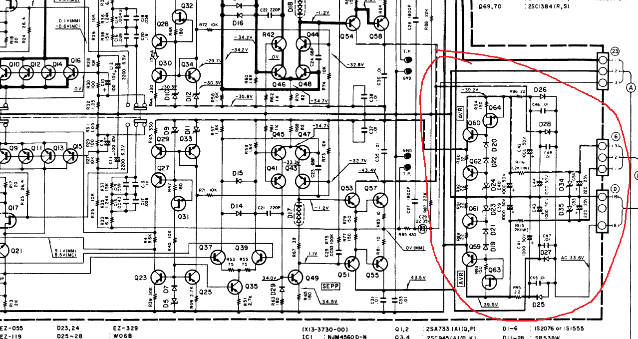

or the additional kenwood regs in the photo below.
Other than that i can tell you for sure that you don't need a damn regulator if you really know how to work the ground plane ! Most commercial products are using regulators because they need to provide a safe voltage supply and a lot of clean current for tons of other circuits than just the phono spread on a big pcb .The lousiest op-amp cand provide 90db PSRR and CMRR where the ear is most sensitive to noise and a simple first order rc filter can eliminate the rest of the HF noise .

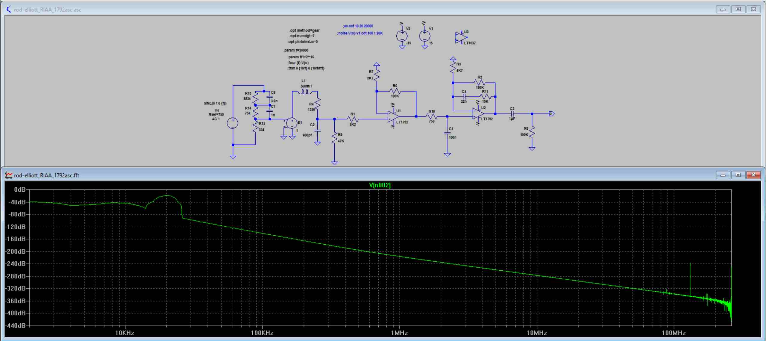

Today I was playing with LTSpice in a different direction, or not quite so.

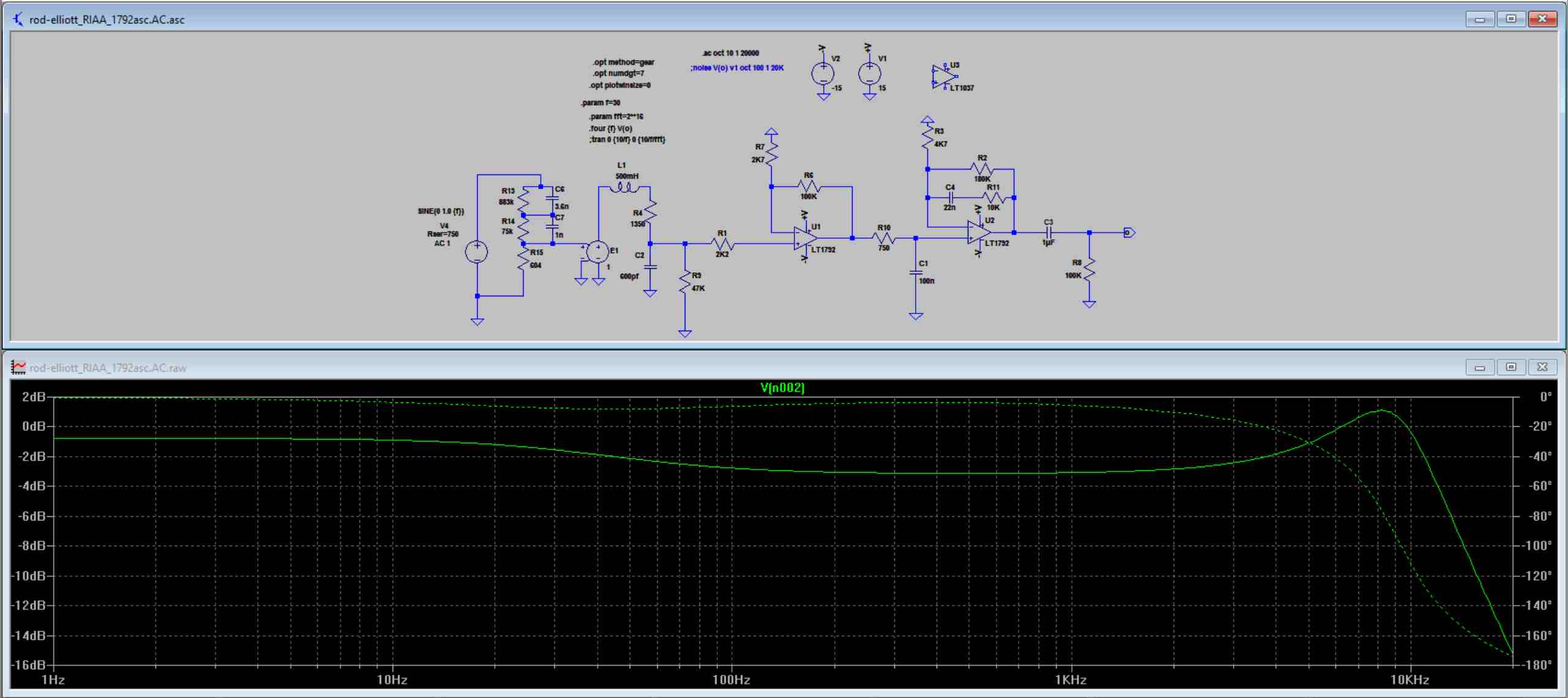

What I did was take Rod Elliott's original RIAA preamp, published on his site, which he designed for using two stages of an NE5532. I never listened to the original design, so I can't say anything about, pro or con.
Hi-Fi RIAA Phono Preamp
The fun thing about LTSpice is that you seem to be able to play with anything, and even get good results. But you can't know if it really means a real life project or just a "soap bubble".
Though I was not interested in the 5532, particularly because of the feedback DC blocking you need with it, what I was interested is its architecture. It also combines active with passive eq, which I did mention Erno Borbely had said was the best of both worlds.
So what I did was load the schematic into LTSpice, but using the same LT1792/LT1037 of the other preamp.
Now: Borbely's proposal was to use first the passive stage and then active one after it. So I inverted the stages on Elliott's preamp. With an accidental mistake: now the first stage was the LT1037 and the second stage the LT1792.
The resulting THD on the simulation was the lowest of them all. But Marcel vdG had been very picky on using a BJT as first stage for a moving magnet. I'm not sure how Marcel qualifies the LT1037.
The second thing I also perceived is that the LT1037 is a VERY expensive chip, which is not something I really want. There might be other more affordable singles that are good replacements for it, which I don't know.
So I put the chips in the "original" order: LT1792 first, LT1037 second. The THD was also good, but not as much as the other.
Then I replaced the expensive LT1037 for another LT1792, and ran it.
THD was very good (I think) and THD curve looks quite clean.
If you can please check on these results, and tell me if what I got is real or just a "soap bubble".

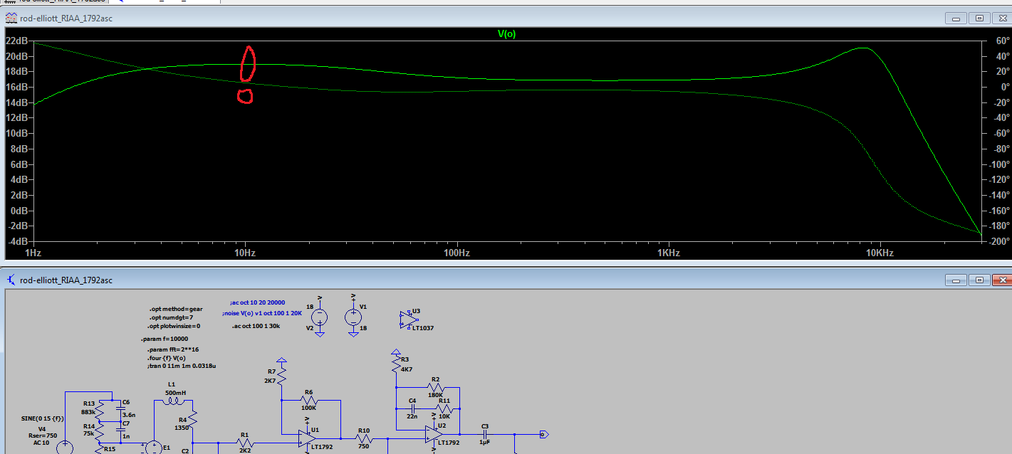

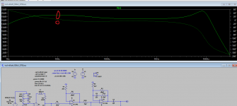

20khz is irelevant for measurements 1khz,5khz and 8.4khz(the resonance point ) at 250...350mv input(15v for 300mv input before antiriaa filter in your case) are the important one.71.5 signal to noise ratio at 1khz...
Now the frequency plot at low frequencies doesn't look ok.

If I reverse them on my plots I do not get V-. I can't explain why.
Now, to start with, I don't get that low response you get on my simulation on the Rod Elliott preamp version.

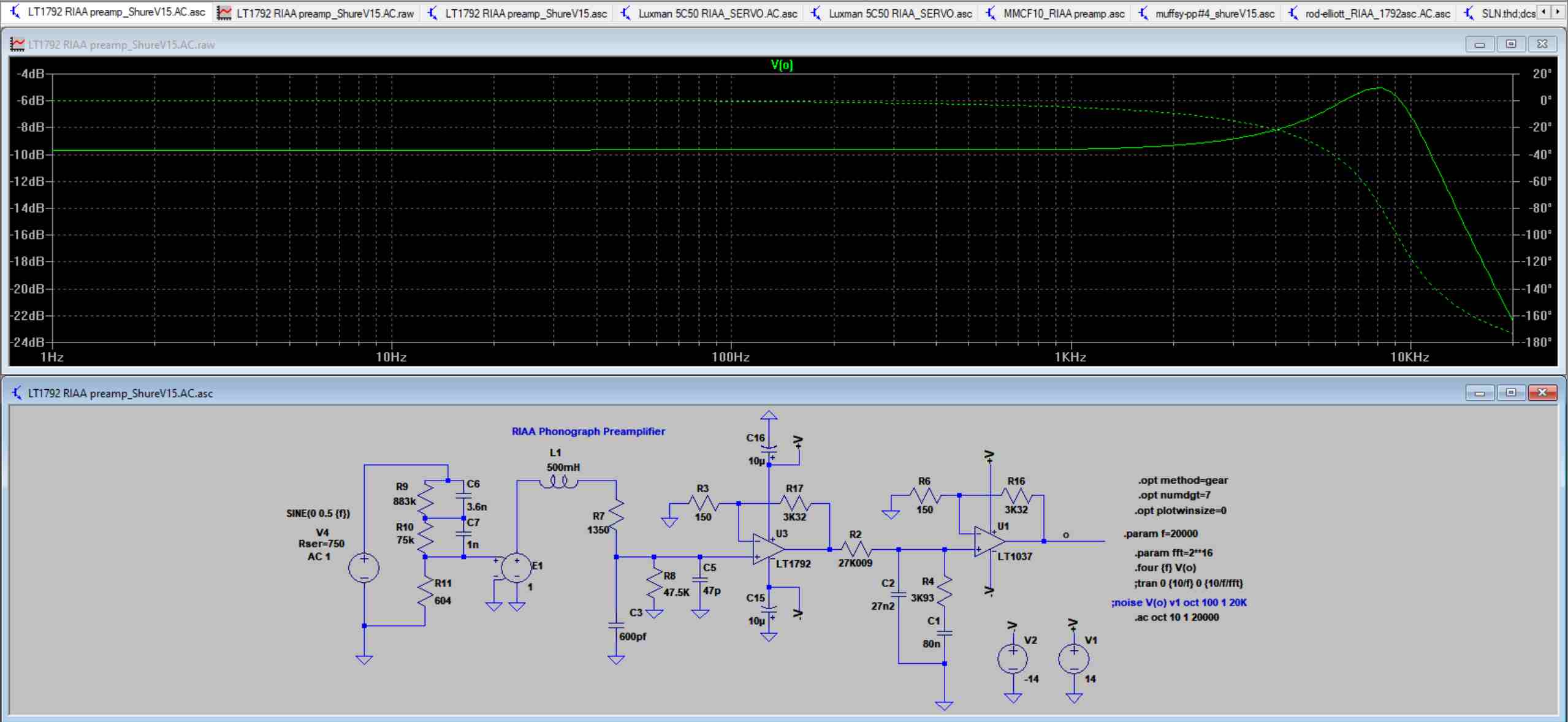

I run the other LT1792 preamp with the V15 load, passive filter, and the FR response is flatter than the Rod Elliott version
