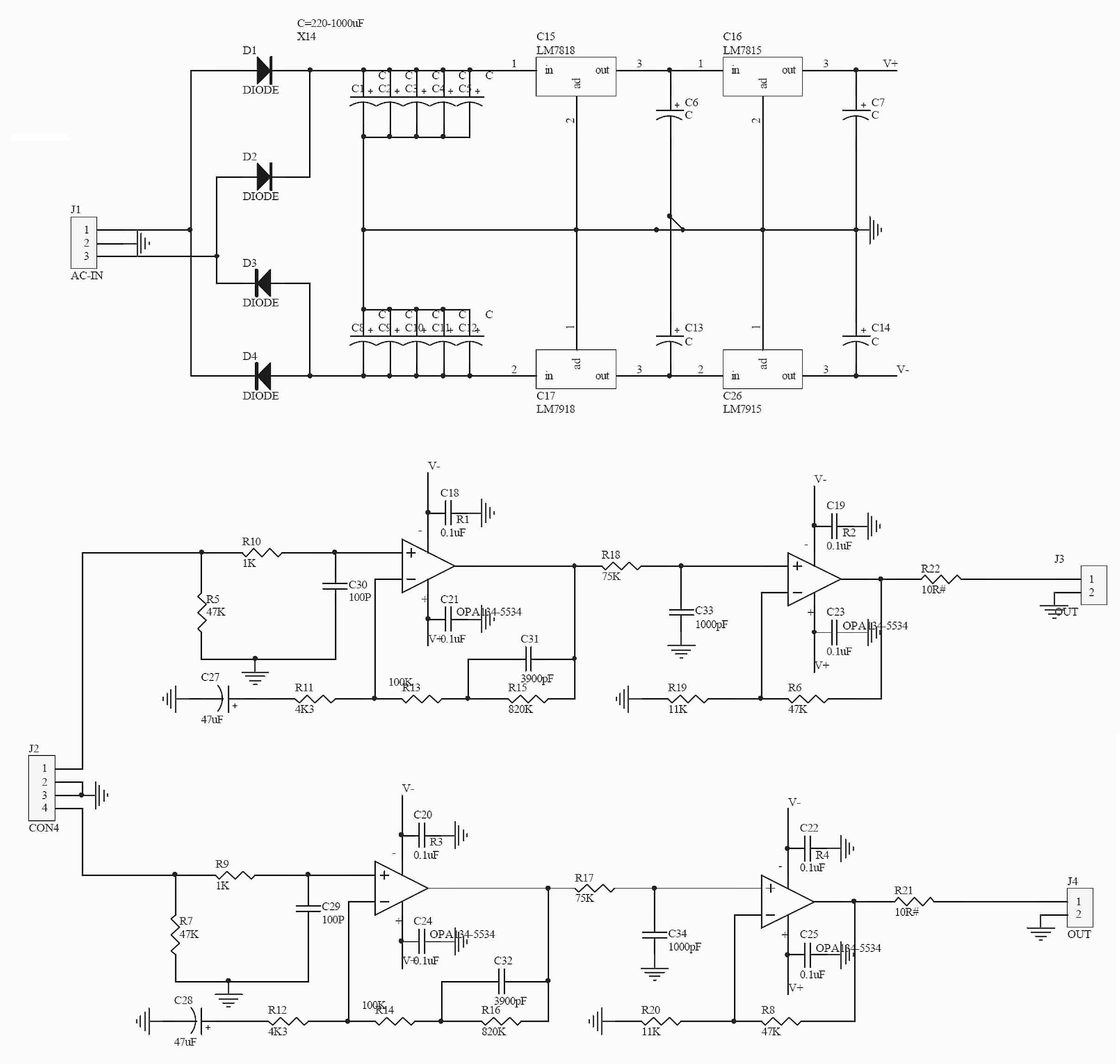

A practical project for implementing a circuit like the LT1792 I proposed.
Why not take an existing being sold as preamp kit and assemble it with the parts we want, perhaps even using some of the kit parts, like bypassing caps?
Looking around I found this RIAA kit that has an architecture quite similar to the LT1792 based preamp, with different passive parts.

I have found this way of assembling preamps and power amps a good way to get things done, not getting involved with pcb home fabrication. If you buy the kit, which is not too expensive, you get other stuff you could use.
Before advancing on this, I would like your opinion on this approach to build a RIAA preamp. Why yes, why not, how to handle it.

there's no real reason to use lm7815 after 7818 with a phono preamp.The op-amps PSRR is so high that you don't actually need any regulation at all.18v supply is much better for phono riaa than 15v in your case.The only reason to use a regulator in your schematic is to make sure the op-amps rail supplies won't exceed the max supply of your op-amps.
This is just the beginning of my proposal. Several changes would have to be implemented.
If you agree on the principle for this project, I would go forward and propose the changes that should be made.
Of course I would never use a fixed regulator like the one they used, certainly not two regulators in series. The minimum I would do is put two LM317/337 small regulators you find on eBay, which should be considerable advance on what they used.

''The minimum I would do is put two LM317/337 small regulators you find on eBay, which should be considerable advance on what they used.''
not really...78xx series is a bit noisier, but it's definitely faster and takes less space...I wouldn't loose my time with assesing which regulator is better...I used more advanced regulators because my phono preamps also involves external transistors and i also supply the headphones amp too, but if you're using just the LT op-amp you only need supply regulation to protect the op-amps and a series rc filter like 10...22 ohms/220nf or just do like Marantz : no regulation at all and 22...220ohm/220uf(low esr cap-they used elna cerafine)
I'd go with 7818/7918 , 22ohm/220uf panasonic FM...

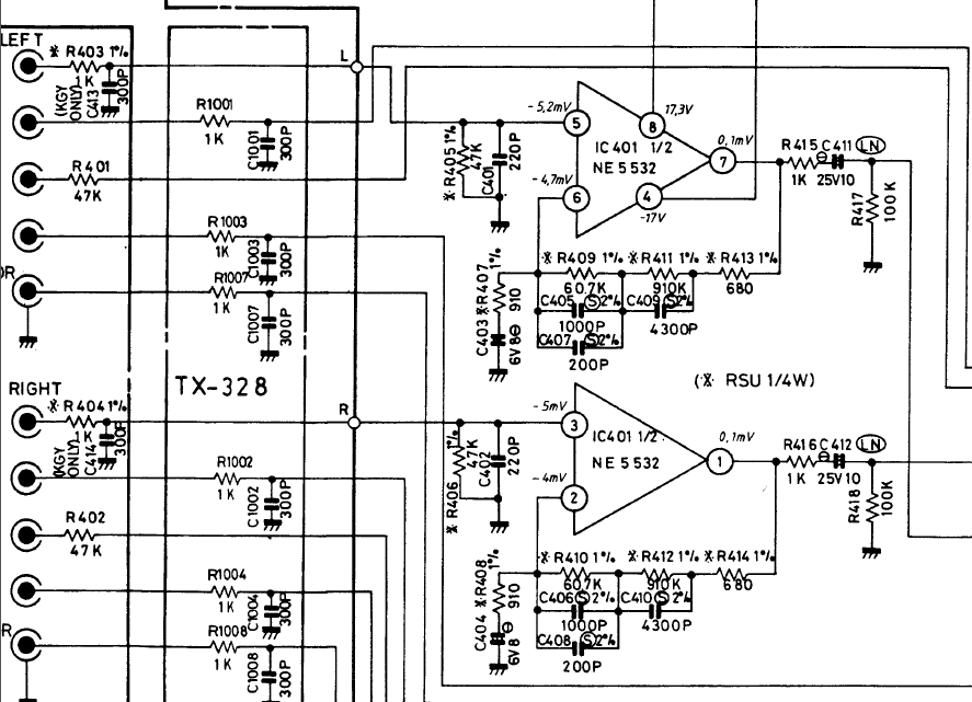

What i don't really understand is why you abandoned the first lt1792 project with passive network for the later active network with ne5532...ne5532 accepts a maximum +-22v V supply so you could even go with +-20v supply, but the LT opamp should be better sounding in either of those projects .

This project is using passive equalization:
https://www.diyaudio.com/forums/ana...vs-bjt-input-phono-preamp-15.html#post6360137
This one is using both active and passive eq.:
https://www.diyaudio.com/forums/ana...vs-bjt-input-phono-preamp-17.html#post6361267
Thus they are different projects.

I think you didn't pay attention to my text or I was not clear enough on my intention.
That second schematic was for the MMCF10, which the kit is for.
I simulated that circuit with the LT1792 and LT1037, and the THD results were very poor.
So my proposal was to use the pcb, but for assembling the passive equalization schematic on it, the one I call LT1792 preamp.

A RIAA amplifier with op-amps is simple enough to build on perfboard, but modifying this kit will also work. Do what you like most. R10 and R11 are a bit high if you want low noise, but you can modify them of course.
Edit: last sentence not applicable when you build the middle circuit of post #130.
