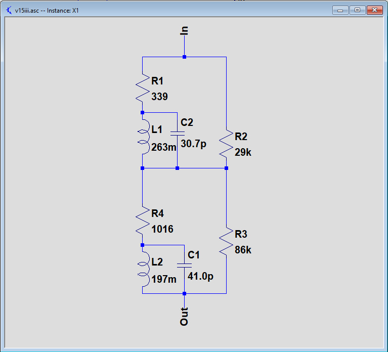

Hans,
1) What's the little box after E1? How will LTSpice read that?
2) The first curve on the left was taken from where? Stereophile?
3) Why did you change the output values and are they supposed to be kept on the actual circuit: inductor, cap and resistor?
As I asked Marcel, I still do not quite understand which are the actual values for his input model.

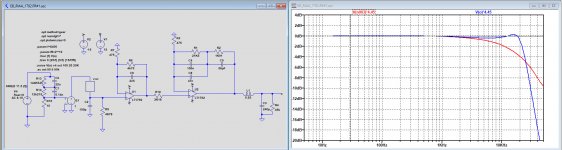

And this is what things are becoming when replacing the 75usec pole behind the first OPA by a lower termination resitance.
R = L/Tc = 0.46/75usec = 6k13
This 6K13 minus the 1k35 fron the Cart gives 4k783 as a termination load.
Because of this, the FR will significantly change in the HF area, so C9 will have to be increased to 2n5.
In the image below you will see again the FR without Cart mechanical resonance in red and after Cart resonance in Blue.
FR will now be practically insensitive to the input capacitance.
Hans

Hans* has thoroughly characterised the electrical transfer characteristics of a number of MM cartridges and simulated response into a virtual ground preamp. What verification would you like?
*and to be sure George replicated a number of the tests to ensure they were correct.
Hans,
1) this Box is the subcircuit of Marcel's replacement circuit for the V15III
2) yes
3) What output values ??
Hans

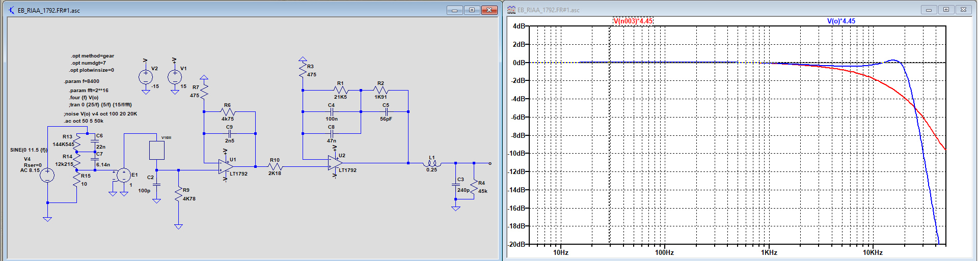

Hans
Looks good!
Why restrict? I have miniDSP as a preamp, this allows me to optimise for each cartridge. I'm not the sort to change cartridges every week so the setup time is not an issue for me.
Of course it may be that there is no audio band mechanical issues that need correction on the average cartridge. I would be happy if that turned out to be the case.
