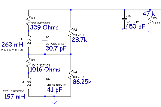

And this is what things are becoming when replacing the 75usec pole behind the first OPA by a lower termination resitance.
R = L/Tc = 0.46/75usec = 6k13
This 6K13 minus the 1k35 fron the Cart gives 4k783 as a termination load.
Because of this, the FR will significantly change in the HF area, so C9 will have to be increased to 2n5.
In the image below you will see again the FR without Cart mechanical resonance in red and after Cart resonance in Blue.
FR will now be practically insensitive to the input capacitance.
Hans

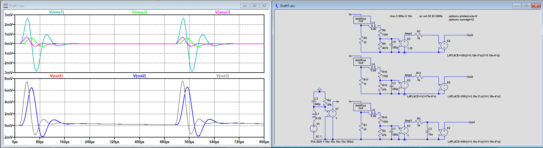

To show the differences between alternative topologies I have simulated three Riaa versions using a 460mH + 1350R Cart including it's simulated mechanical resonance.
This Cart is producing a click while using a two stage preamp.
The second stage has 20dB gain@1Kz
1) Flat first preamp with a passive 75usec pole after this first amp, like Carlmart has proposed.
2) 75usec pole in the first amp's feedback loop.
3) 75usec pole created by terminating the Cart with 4k78.
In that order you will see in the upper left part of the image image the output signals Out1 to Out3.
Apart from some differences in time delay, they are all equal and Out1 and Out2 are on top of each other.
Then looking at the output signal coming from the first stage at the lower left part.
-With Amp1, the flat amp, signal is almost 14dB stronger as in
-Amp2 where the pole was created in the feedback loop.
-Amp3 is comparable in amplitude to Amp2.
But with a gain of the second stage of 20dB@1Khz, in situation 1) both stages will then have to cope with almost the same click amplitude peak.
So when reducing the click amplitude with a feedback cap or a 75usec Cart termination, the clipping problem will be fully transferred to the second amp.
But intuitively I would still prefer situation 2) or 3) and try to make a much easier soft clipping provision around the second amp.
Hans

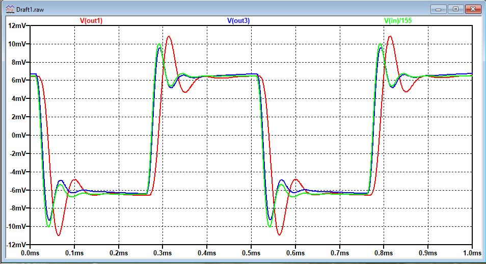

I never saw the point in having a damped mode without inverse resonant filter, but what you show here is that you can turn the cartridge mechanical resonance plus an extra first-order roll-off into a sort of third-order Chebyshev low-pass filter. With the conventional approach, it is always fourth order, so this could very well lead to a better step response than the conventional approach.
Do you indeed get an improved step response or is it rather similar because the pole pair with the highest Q stays as is?
Yes, damping has indeed improved the step response, see below.
In the image you see V(out1) for the straightforward version, the damped version as V(out3) and the the anti riaa's input signal as V(in).
Hans
