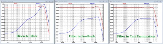

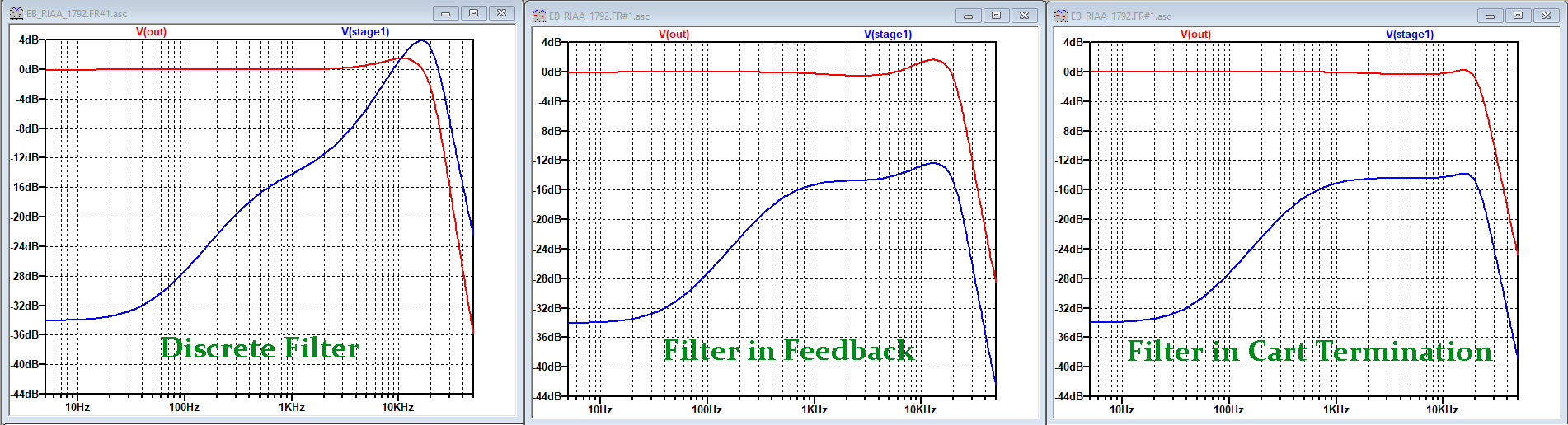

To make it more understandable, I have made three frequency plots of your amp, with the V15III model, including the Cart's mechanical resonance, but now with all your LT1792amps and real components.
The image shows resp the FR at the output of the first stage in blue and your output O in red.
The three plots are showing resp. the FR for the passive filter version that you favoured, a version with the filter function in the feedback loop of the first stage and finally the version with a 4K78 Cart termination replacing the capacitor altogether.
It's quite obvious that the first stage has a ca. 14dB higher amplitude to cope with than in the two other two versions, even higher as the output stage.
That's why I think that the passive 75usec filter may not be the best choice, depending on the amplitude of the pops and clicks for which I have no information.
Hans

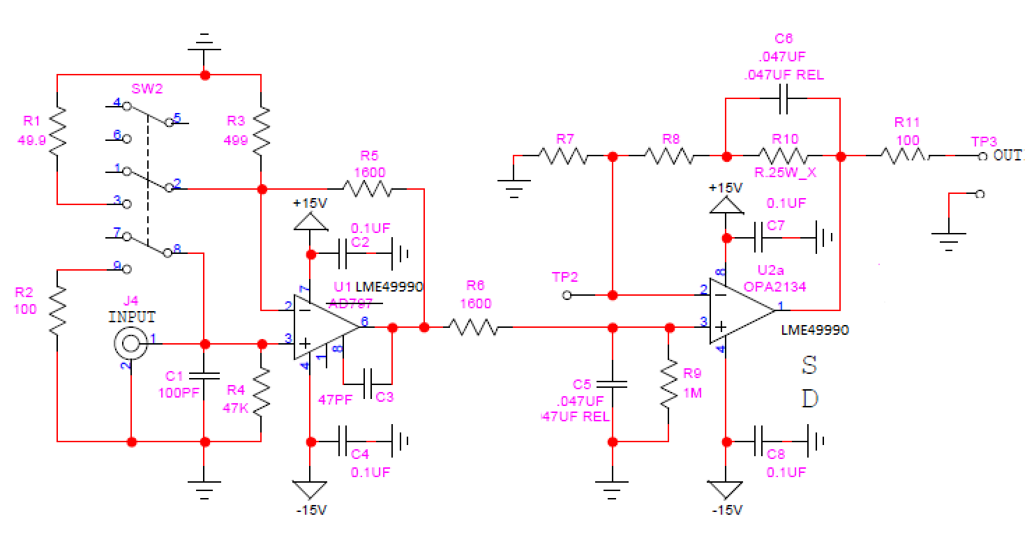

There are several alternative implementations of the RIAA curve discussed here and it is not always obvious to me which topology is under discussion, the passive all-in-one (Muffsy), passive LP-active HP (Borbely) or the "cartridge loaded frequency shaping" as advocated by some forum members.
Hans, is the "discrete filter" simulation you refer to in the previous post using the passive all-in-one? The all-in-one generate the Riaa response by "burning off" about 20dB above 500Hz. Therefore, it typically has more gain in the first stage compared to splitt RIAA networks.
I would be every interested to see the clipping behavior of e.g. the JC using the passive/active topology.
Unfortunately I have no experience in the use of circuit simulation tools.
It would be highly appreciated if someone would take the trouble of simulating this circuit using the same LT1792 for comparison.
Lars

Hi Lars,
On discussion here is obviously the "Borbely" LP version and not the complete passive Riaa network Muffsy version.
What can be said about clipping is that when using a complete passive network, the second stage has to produce 20dB more gain, which should not be a real problem, so the output amplitude of the first and the second stage are still comparable to the LP version as discussed here and so is sensitivity for clipping.
The point however is that one should carefully keep an eye on the noise directly after the fully passive Riaa network to prevent the RTI (referred to input) noise from too much worsening the noise from the first stage alone.
As long as that's not the case and you are still on the right side of the targeted S/N, there's nothing against it and the FR is probably more correct as in an active setup.
Giving the first stage more gain, makes this stage more sensitive to clipping which should be prevented.
Even for an MC amp is it possible with great care to use complete passive networks as shown in Linear Audio Vol. 12 without affecting the 1.2nV/rtHz RTI noise from the first stage.
Hans
