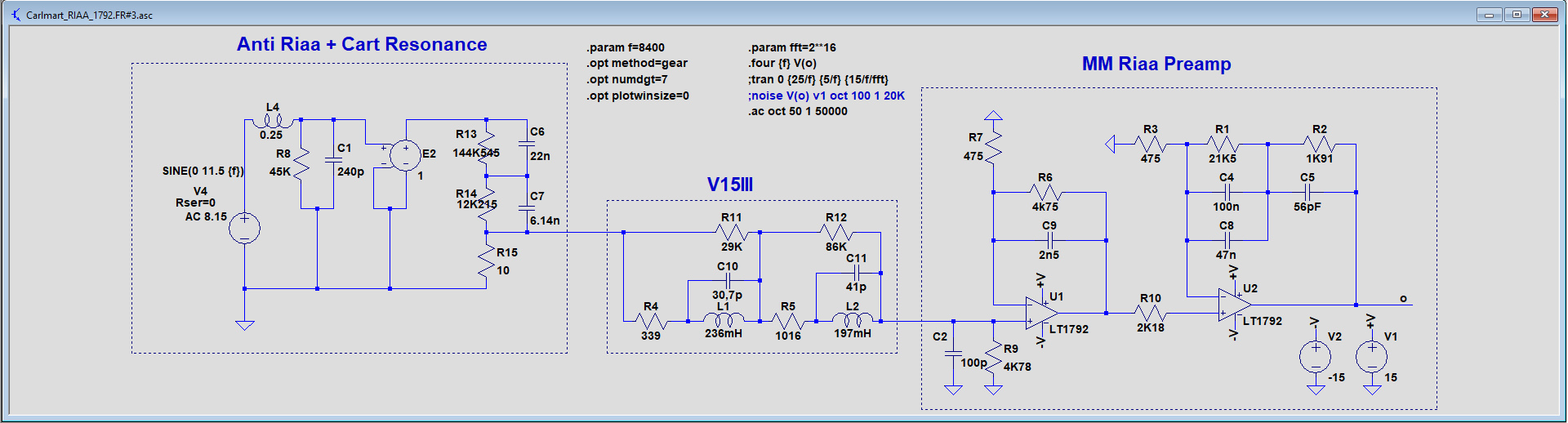

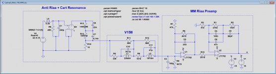

What I did was take latest Hans version to the circuit I had proposed based on Erno Borbely's proposal, and simulate it. Hopefully the variables I loaded are correct.
FET vs BJT input phono preamp

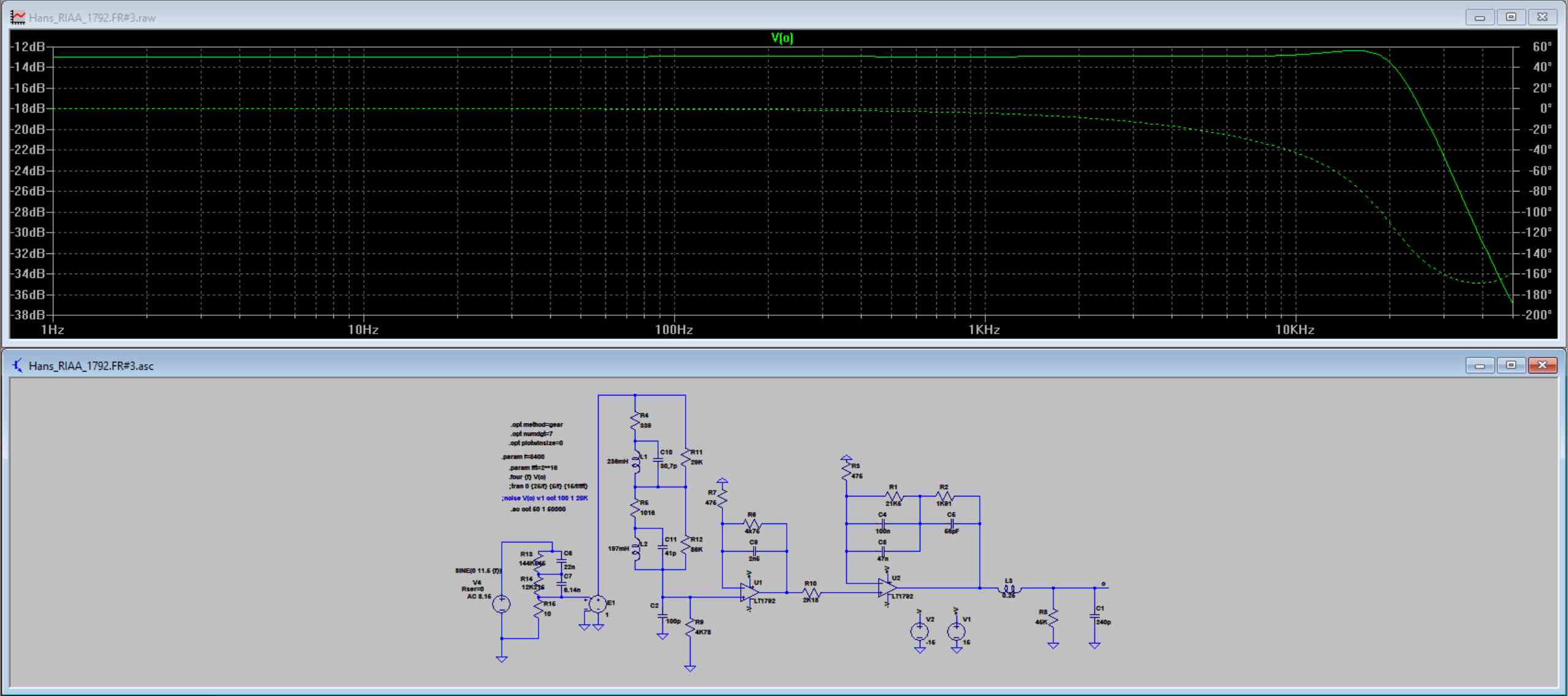

I think I converted it correctly into a working simulation and got similar results to that he got. Please do judge, particularly you Hans, if my job was correct.
.asc file is also enclosed, so anyone can check the simulation and correct what you think should be corrected.
I would appreciate if someone could redesign this schematic into the actual circuit to be used.
The input load, resistor and cap to start with, it was not what people have found out to be using test records and scopes. I wonder what other instruments could be used to check on those values.

What you did was exactly right for the damped version.
I rearanged the parts a bit, by replacing the mechanical cart resonance emulator into the generator, giving a better visibility of what is the Cart and what is the actual Riaa Preamp.
Hans
