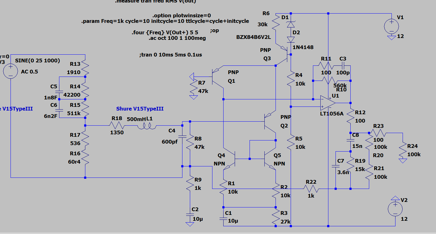

Just another chunk of an old schematic that i can't understand without syn08 solid knowledge of the Universe ,but you won't find it easily , courtesy to KCP , the E.F Taylor phono preamp:

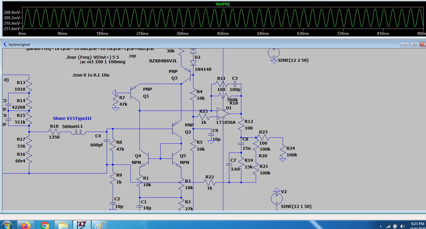

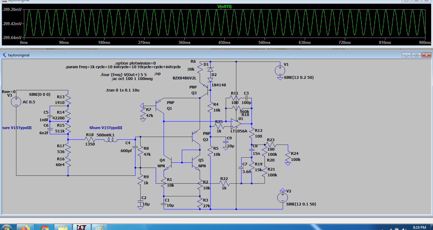

It doesn't need decoupling...I placed 100mv 50hz noise on the positive supply, and 200mv , 50hz noise on the negative supply with no input signal...result 6..7mv of output noise .I bet you can get better supplies anytime!

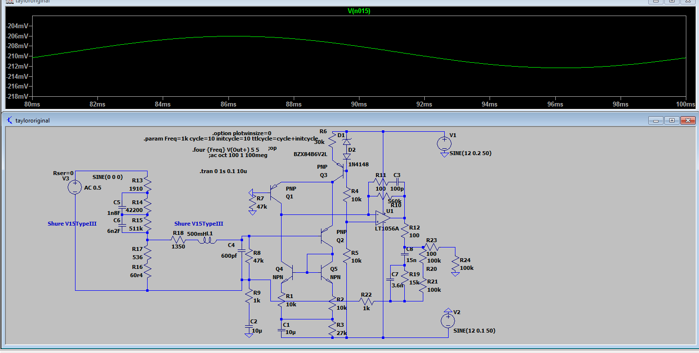

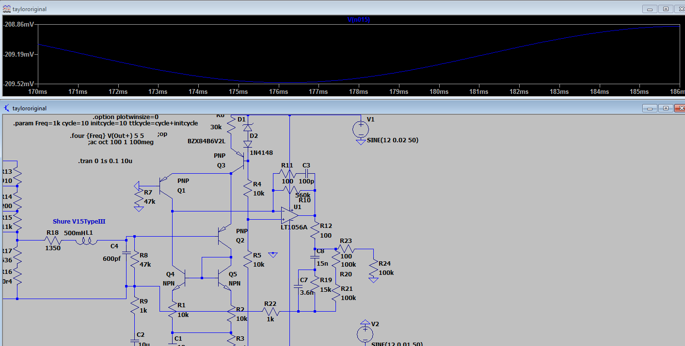

but if you really insist...i even made the difference higher ...for 2v-1v supply noise you can easily have about 3mv output noise...is it good enough for you guys?
