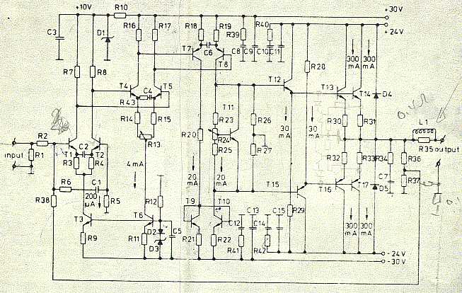

Hi, Mike,
This is the schematic of one of the "best" sounding amp. It is Electrocompaniet 25W.
It has the topology like you use in Symasim, also do not use complementary differential, but has 1 additional differential from what you use.
What do you think this design wants to achieve by adding 1 more differential? Is it trying to get more OL gain? But trying to get more OL gain will result in lower OL bandwith?

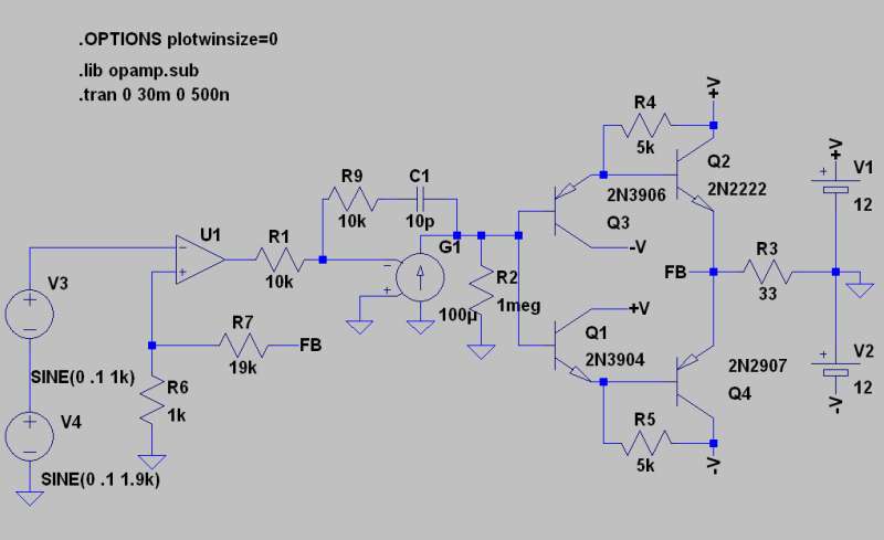

Open-loop distortion may decrease, but open-loop gain decreases too. If gain decreases more than distortion then closed-loop distortion will be higher. Linearizing each stage is good, but the sacrifices can be too great, otherwise we would all be using 10K emitter degeneration in the LTP all the time.

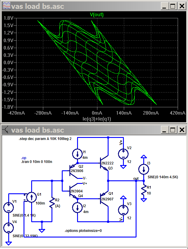

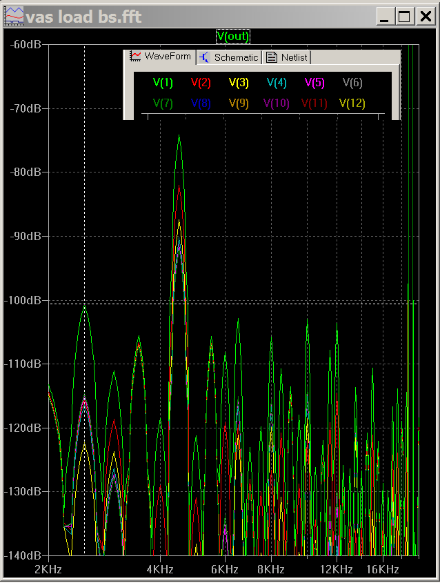

mike, be prepared to be disapointed...
Vas load simply reduces loop gain and Increases output Z and distortion, including IMD, it is Not “equivalent to emitter degeneration in another place”

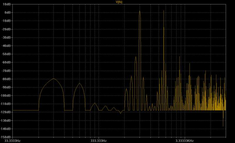

This “toy” amp sim shows this pretty unambiguously; the outputs are weakly class AB biased so the vas has plenty of work to do correcting distortion
To address objections to “resistive load” I’ve added a non-harmonic load current – you can see from the I-V plane plot that the output is being exercised over a more substantial region than any reactive load would cause
Again in the fft I’m just showing the distortion, 1 KHz 0dB and 19KHz -12 dB are off the fft plot
What you should see is that the prominent 4.5KHz peak from the output load current shows that output Z is uniformly degraded by heavier vas load – further the bright green 10K loaded vas trace shows the most harmonic and IMD distortion with any combination of input signal and load current
(2KHz left edge is 2nd harmonic of 1KHz input, peaks occur every 500 Hz moving right, for instance count peaks from the left edge 2.0KHz , 2.5KHz, 3KHz, ... and you can see that simple loop gain is reducing the 3rd harmonic as peak amplitude colors inversely follow the resistor load step color order from bright gren 10KOhm load increasing in 10^.5 steps)
The one “interesting”anomaly is the 2.5KHz third order distortion product (4.5KHz – 2* 1KHz) – this distortion seems to go through a minimum at 100Kohm load (yellow) and actually increases for higher vas load – so for some specific distortion mechanisms it is possible to find an optimum vas load, but you have a lot of work ahead of you to convince me that such specific optimization can be more attractive than the robust improvements across the board that high loop gain (no vas loading) gives
LtSpice cir file; change .txt to .asc

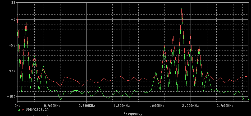

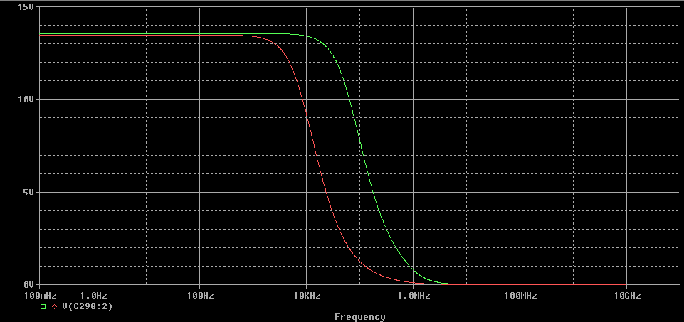

Here it comes !
Hi !
Here are some sim-results about the difference between vasloading
and using re's. I used the circuit from symasym, it's possible that
things are slightly different here than in a normal pushpull-vas,
but i had not too much time, and the pushpullvas showed only gain
of 1:20 which was not too representive...
These sims are only openloop for now.
Here are the 2 schematics i used:
emitter-resistors:
vasloaded:
Both circuit are set to the same gain, 1:1350, here is the acsweep
showing the gain for 10mv input:
Red = Re's / Green = loadedvas
And the distortionfigures: (same colors)
I had to use very low freqs for IMD-test, re-version was simply too slow !
(0.1khz,0.7mv + 1.9khz 16mv)
Hugh, you forgot No4, increased OLBW...
No further comment except i hope that i have not done any dumb mistake...
Mike

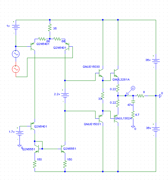

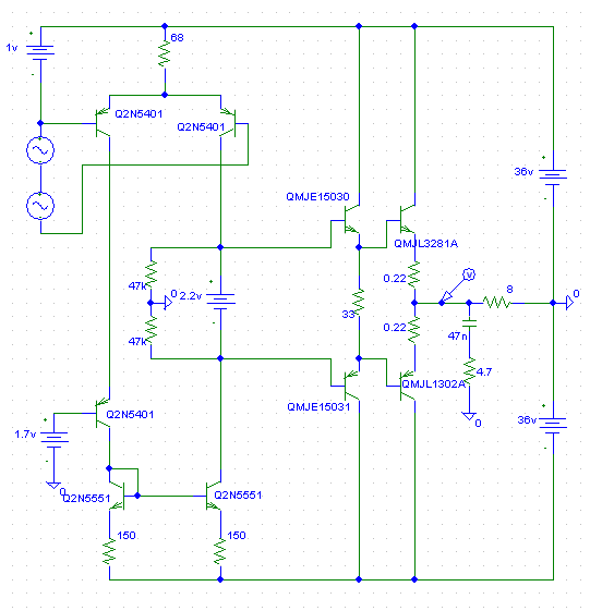

Here's a circuit (mostly 'ideal' components to analyse the effects of VAS output impedance.
U1 is a gain of 10 10MHz BW amp, G1 may be considered a perfect transistor (a transconductance - the transistor's gm = 1/re). It's output impedance is infinite, so at lower freq the stage output impedance is equal to R2.
R9/C1 stabilizes the loop, it's effects are minor up to 10kHz, but significant from some 100kHz on.
Let's start with R2=1meg and G1=100uA/V for a gain of 100; then let's reduce R2 to 100K and increase G1 to 1mA/V for the same gain of 100, and so on.
This way, one can separate the effects of VAS output impedance from feedback (since feedback is constant) and open loop linearity (your Re in or out would change open loop linearity).
