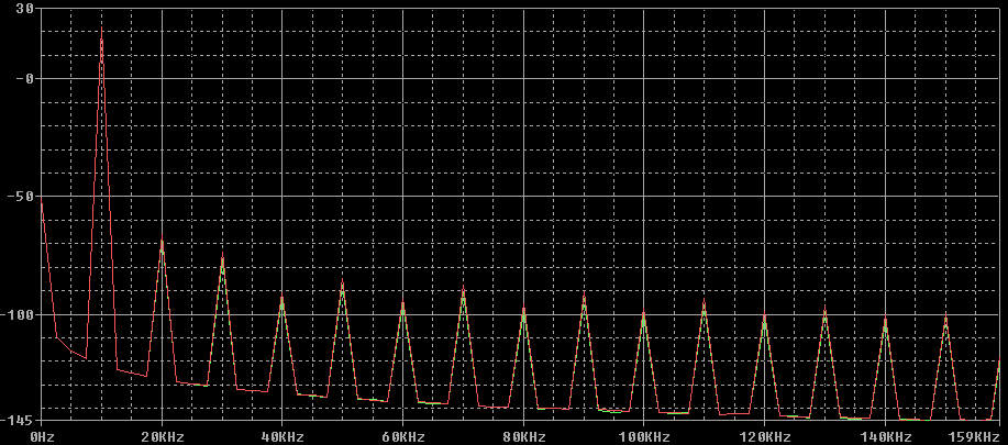

belated reply to MikeB
Sorry mike, I didn’t mean to leave you with the impression you’ve “proved” your point about vas load – I’ve just been too busy
http://www.diyaudio.com/forums/showthread.php?postid=710582#post710582
You comment that “…the only thing this schematic demonstrates to me is the benefit of higher feedbackfactor” – suggests we are on totally different wavelengths – OF COURSE my sim indicates the benefit of increased loop gain – and that for a vas with a given gain (= gm) that your vas load resistance throws away gain and reduces linearity in the closed loop amplifier
In your example sim
http://www.diyaudio.com/forums/showthread.php?postid=697807#post697807
you still seem to be under the impression that emitter degeneration is somehow equivalent/comparable to vas load – emitter degen addresses a completely different distortion mechanism than the dominant nonlinear output stage impedance in your example – linearizing the input gm has no effect on nonlinear Z load distortion from your darlington output stage’s finite and nonlinear current gain
You ignore the dual definition of circuit gain – matching open loop V gain but glossing over your boosting current gain by removing emitter degen in your loaded vas example – subcircuits with matching V gain and different output Z do not contribute the same loop transmission (Bode’s T) to the overall amplifier
Your circuit increases current gain and “throws away” the expected V gain by resistive loading and takes a lower output Z in compensation – I claim that you would see somewhat improved/similar closed loop distortion by omitting the vas R load while increasing input gm as you did with the advantage of the higher loop V gain reducing signal level at the diff pair input, the higher loop gain compensating for the reduced diff pair linearity compared to the emitter degen case
But better still is recognizing the dominant distortion mechanism in your sim circuit and addressing it directly – just add another follower stage to “buffer” the vas and the nonlinearity due to the nonlinear load from the output stage is reduced by the follower’s hfe ~100x
hi jcx,
obviously we have the one or other misunderstanding...
I agree with you that the benefits of degenaration are typically
lower than the loss of feedback resulting in less linearity for a closedloop.
But, if openloopgain is already too high, so that stabilizing gets
difficult/impossible, degeneration becomes a necessary step.
Maybe the combination of re AND vasload degeneration would be
the best choice.
Adding an extra followerstage and making a tripledarlington would
be the logical step, but i did not get it adequately stable, after it
was stable again distortion for 20khz had exploded.
This nonlinear load to the vas seems to be a bigger problem then
one would expect, especially in my case, as i use to92-bjts in vas
and have to keep currents low.
Especially for higher freqs, but still below resonancefrequency of
the feedbackloop, the dynamic load starts to create wild phasehifts
into the vas (even with tripledarlington), creating instability.
This dynamic load is created by the very unlinear nature of the big
output-powerbjts and can create a resonance in the very last stage.
Sims showed this resonance at 3mhz, but realworld had it even
higher... (i "cured" that with the caps to gnd)
I will check your claim closer, i have the feeling that distortionlevels
would keep similar for same openloopgain if i omit the rload and use
re's in inputstage instead. But the topology i use for my symasym
is a bit crazy, with this heavy degeneration the tanh() curve of the
2nd diffamp should create massive compressive 3rd harmonics,
but it doesn't, for lower freqs it does the opposite, uncompressive...
Mike

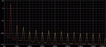

Hi jcx,
i checked this change, i made fft-plot of vasloaded amp (symasym5),
and amp without rloads, instead of them i used 8 ohms re's for first
diffamp. This gave same openloopgain/fb for 10khz.
Output is 12v peak into 4ohms 10khz.
Green is vasloaded, red is RE.
You're right, the difference is not big, but still, loaded vas has ~4db
less distortions. I should check this with complex signal...
Mike
