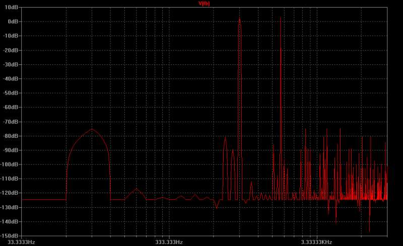

Is this driver is the one that Electrocompaniet have been using all this time? The latest Electrocompaniet is using CCS instead of R for biasing from the opposite rail supply. See AW120 schematic around here somewhere.In fact my idea in a bit different. It is not a push-pull but a variation of the type III configuration described in Self's book, 3rd edition, page 113, fig 5.4C. In this configuration, the drivers are emitter followers with an emitter resistor connected to the opposite power supply (NPN with an Re connected to -, and collector connected to +, PNP with an Re connected to + and collector connected to -). Each driver is always conducting. What I was thinking of was to replace these emitter followers with Sziklai pairs.
Is it possible to get like 20ohm-50ohm output impedance of VAS without using additional transistors / Emittor Follower?
No!
You can decrease it, when increasing the current in the VAS.
Doug Self said the output impedance of typical VAS is about 22kohm.
It depends a lot on your VAS transistors. 22k seems quite low to me. My opinion is that it is more like 50-100k. The higher the better. This can obtained by low-beta drivers or say better selecting your transistors for a high early voltage. Sometimes you find the output resistance in the datasheet. Using a tripple EF is better than try to decrease the VAS output resistance. Or see the solutions FORR has given.

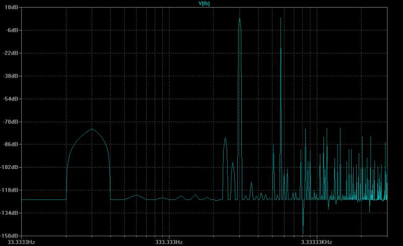

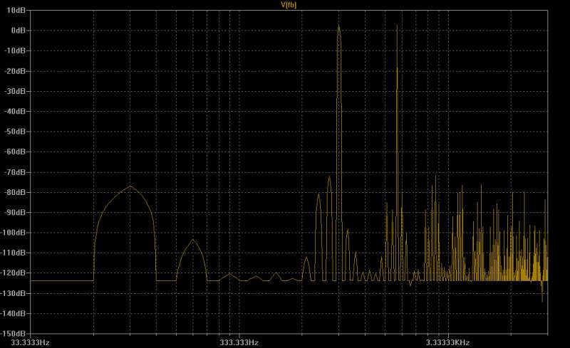

Actually the preference for less than ideal amps goes a little deeper.
Firstly, the "ideal" reference amp in all likelyhood is not ideal. It just has lower distortion, in level, but it will have *some* distortion *somewhere*.
While some may indeed prefer true euphonics, I find it entirely credible that some amps w/o obvious coloration may sound better on the basis of the distortion spectrum and nature. The crux is to find out why people have these preferences.
Research indicates that the ear itself is highly nonlinear and therefore creates its own distortion. Musical instruments of course generate harmonics plentiful. And there is evidence that certain distortion distributions simply mask each other because they mimic either the ear's or the typical musical instrument's harmonic better than other amps. So, the "more accurate" amp may have low level distortions that stick out like a sore thumb, while the "musical" amp may have slightly higher level distortions which, however, don't stick out. Given the level of speaker distortion, one would think that anything below 0.1% THD should be indistinguishable, it seems not so though. Hence Distortion spectrum should matter more than distortion level.
Ideally one would like both low level distortions (because any distortion will contaminate the audio band and contribute fuzziness) yet of a nature that doesn't make them stick out. Since we seem to have very competent engineers here on this forum that handle the pros and cons of the technology really well, what we need most is actually not more engineering approaches, but a better understanding of what is objectionable to the ear, and why. The engineers can then find a technical implementation that fits the bill.
Note: as I indicated in some post above, even very high order distortion of a very low level may be objectionable if produced in the bass region, simply because it will still be in the audio band and in a much more sensitive area of the equal loudness curve.
As to the figures we can see showing essentially no harmonics above the noise floor, I'd really like to see some cross correlation analysis of the said noise floor to check if it doesn't hide perceptible high order harmonics...

LUMANAUW
"How to determine (or calculate from schematic) the output impedance of VAS? Doug Self said the output impedance of typical VAS is about 22kohm."
I think this is still valid : the output impedance of a simple collector is about 100 kOhm/mA, wich means 100 kOhm for 1 mA, 20 kOhm at 5 mA and 10 kOhm for 10 mA.
However, with the Miller feedback effect, this impedance is reduced as frequency increases. I am not going to dig in the Self's book again tonnight , but I think the mentionned 20 kOhm is the average load on the VAS collector with 8 Ohm at the output of the amp, not the output impedance (I am not sure I am right).
LUMANAUW
"Is this driver is the one that Electrocompaniet have been using all this time? The latest Electrocompaniet is using CCS instead of R for biasing from the opposite rail supply. See AW120 schematic around here somewhere."
In the schematics you sent, my idea is effectively to replace T12 and T15 by Sziklai pairs. Constant current sources can replace the resistors connected to the supply rails.
A variant wich was used in the first solid-state amps made by Audio-Research (yes, the tube star) : the PNP driver feeds the NPN output and the NPN driver feeds the PNP output. The load of each driver is a contant current source, with an insertion of a small value resistor before the base of the output power transistor. The voltage across the small value resistors determine the quiescent current in the output transistors. Same as above : the drivers could benefit of Sziklai pairs.
