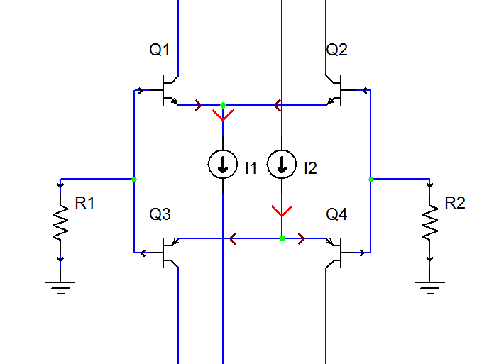

I'm not quite capturing this. What does it mean?One reason is that you get partial cancellation of input bias current.
Hi lumanauw !
You have 2 big advantages with a complementary diffamp-input:
1, Inputoffset is nearly zero, as the currents through the base
of the inputtransistors are complementary, so they short out each other.
otherwise you have a constant current through the input giving
a permanent dc-offset, also called inputoffset. The trick is typically
to have them on both sides (+input/-input) identical, resulting in
no DC-offset at output of amp. (for nonsymetrical)
With symetrical input you can discard the inputcap without generating
DC-offset.
2, a complementary diffamp is balanced by nature, without using currentmirrors.
the disadvantage: complementary transistors do not really exist...
(That's why i "gave up" this input)
Mike

Easiest to explain with a picture, I think. The attachment shows a complementary LTP and the currents flowing in it. Normally the current flowing into the NPN transistor bases is drawn through R1/2, but with the complementary circuit that current is instead drawn through the bases of the PNP transistors. Ideally, the NPN base current exactly matches the PNP base current and thus input bias current is zero.lumanauw said:...I'm not quite capturing this. What does it mean?

This is where the topology i use for my symasym becomes very
handy, it has single diffamp input and no currentmirror in 1st stage,
but is perfectly balanced and still has a symetrical push/pull vas...
D.Self is VERY wrong about the "poor" balancing in this topology,
just have a look at the currents in the 1st ltp:
http://www.diyaudio.com/forums/attachment.php?s=&postid=683534&stamp=1121552477
I have verified these currents in realworldcircuit, simply perfect...
Mike
With balanced i mean "identical" currents through the ltp-collectors.
Because of the symetric feeding into the vas, a current tending to
the left side of the 2 diffamps would only change the biasing in the
vas, not the outputvoltage. For that reason it's much simpler to
get the 2 diffamps running symetric/balanced.
This looks much different for a singlediffampinput, it's very hard
to get it balanced without currentmirror.
All this of course is only valid with matched transistors.
Mike
I can confirm Michael's findings.
If you measure the current at the emitter degeneration resistors of a current mirror/LTP you find they are dead equal, no question.]
However, what I believe Self ignores is the bias current for the single ended drive to the VAS.
My criticism does not apply where output is taken differentially, of course, but this approach uses resistive loading with no current mirror.
If the VAS draws 10mA, and beta is 100, then 0.1mA must be supplied from the floating end of the current mirror. If LTP stage current is 1mA, a common figure, then the bias for the VAS unbalances the LTP fully 20%. This is huge unbalance, resulting in high levels of distortion.
Hugh
Hugh
MIKEB
Balancing seems not to have the same meaning for Douglas Self and me, so you can't say Douglas is very wrong...
As with all circuits using push-pull VAS stage, the cascaded diff amp , pionnered by Hitachi, has problems of compensation. The NPN and the PNP transistors have different Cbc. Many people are puzzled by the right compensation to adopt : only one ? or one for each transistor ? The stability is not guarented at 100%.
Your scheme may be ok but it is not optimal as the load of the VAS is augmented without having the feedback effect of the classical Miller compensation which is very beneficial for linearisation.
Perfection in our world is a very relative world.
Back to complementary input stages and my question. Has anyone an idea of how is determined the working point by the two different loops ?
~~~~~~~ Forr
~~~~~~~ Forr
