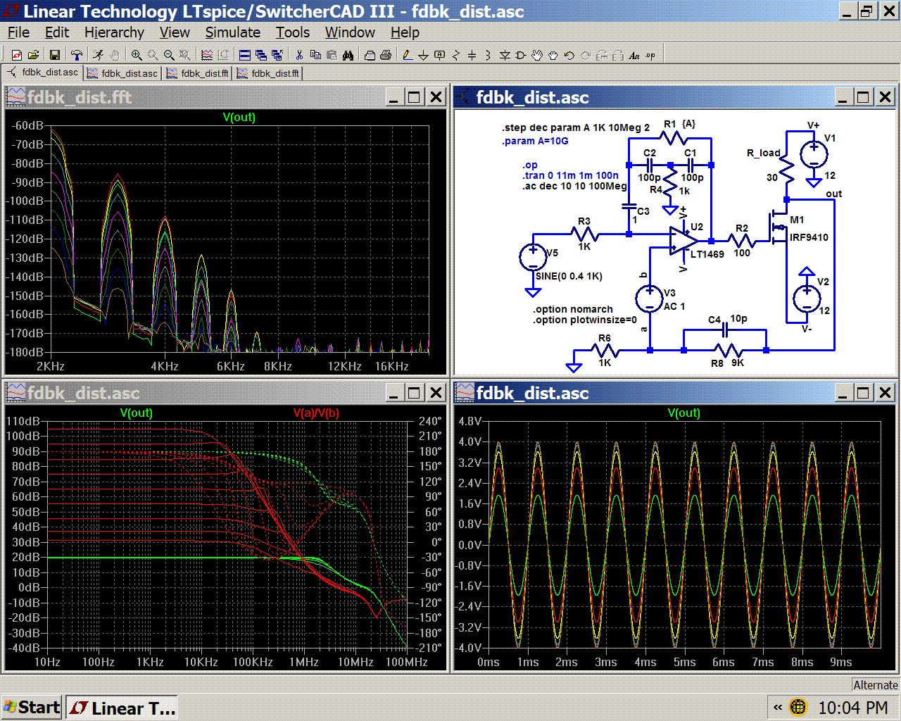

feedback distortion hump?
I’m all in favor of discussing feedback theory and agree with the oft repeated math behind “distortion multiplication” but in any engineering endeavor we really need to put some numbers on the general principles to keep relative importance of various competing effects in perspective
In this sim of an amplifier with stepped gain around a “square law” fet – it is hard to see the feedback induced higher order distortion “hump” amidst the higher order distortion products from the fet’s own nonideal behavior – where it is visible, it is associated with the lowest gain steps, really high loop gain pretty reliably hammers all of the distortion products down to below the noise floor
For higher resolution only the harmonics of the 1 KHz sine are shown in the fft, the green trace is the lowest loop gain – so low that the fundamental output amplitude is ~ 6dB down from the ideal +9 dB output so you need to add 6 dB to the green trace in the distortion fft to decide if feedback has really increased a certain harmonic relative to the lowest feedback case
[alternate solver, gear integration, 131K point fft 5 point smoothing filter, Blackman window]
PS as to the main topic I strongly suggest some perusal of feedback courses dealing with “minimum phase” vs “nonminimum phase” systems/networks and Bode’s gain/phase integrals
(LtSpice file; change .txt to .asc)
