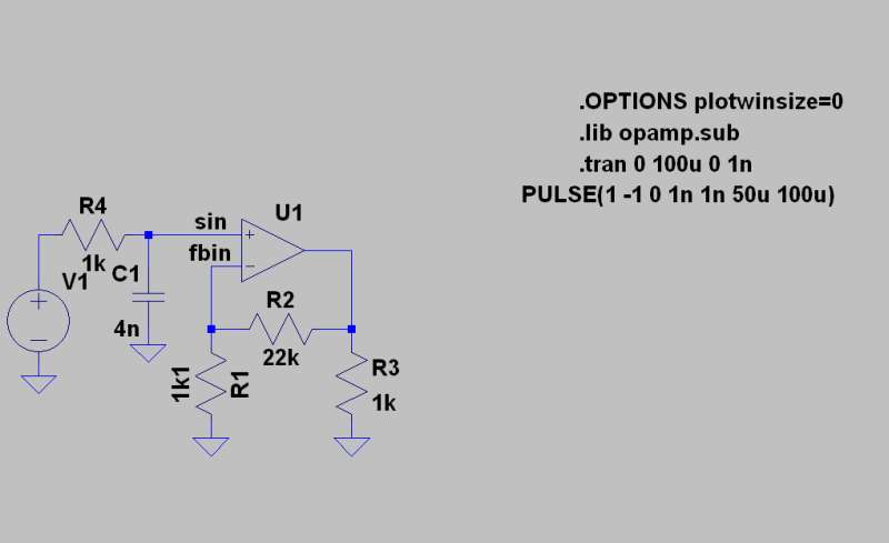

To show feedback in action, I've simulated the simple circuit below, with parameters taken from the well known Leach amplifier circuit (the amps' BW is 8 MHz).

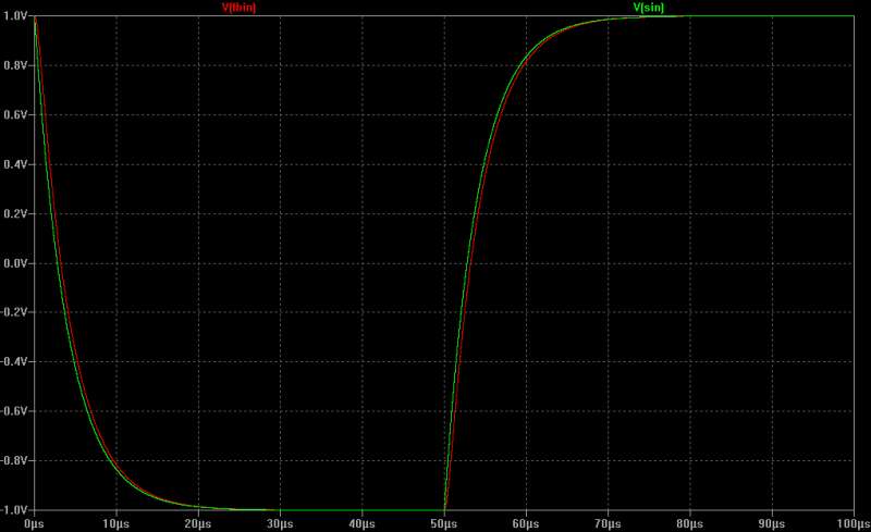

Input & feedback signals
The figure below shows input signal (sin) in green, feedback (fbin) in red.
It's a 10kHz square wave, band limited to about 40kHz.
Just by looking at the figure, delay becomes aparent.
One can see there's a delay during the transition time (rise and fall) and it disapears when the signal is stable (flat top and bottom).

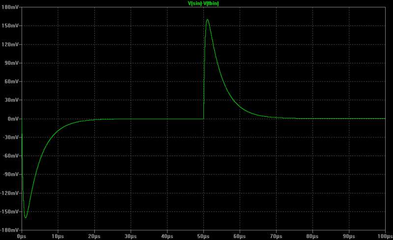

Feedback error signal
Here's the error signal (sin-fbin) applied to the amp to correct the error between input and output.
The error signal reaches 160mV at the beggining of the transition in less than 1 microsecond.
It is this large error signal that forces the amp to 'catch up' with the input, from there on the amplitude decreases until it falls to zero when the transistion has ended (flat top or bottom).
An amp with a wider BW will be faster (less time to catch up) and one with insuficient slew rate may distort because the error signal cannot rise fast enoug.
Are there negative aspects to this one microsecond delay?
I believe not, witness the many highly regarded feedback amps used all over...

That's very interesting - I have never seen the actual time involved calculated or simulated. The interesting part is the error correction signal and the time scale. 1 usec is actually very slow - how can that be for a reasonably "fast" amplifier? The shape is horrendous too, I can imagine all sorts of bad things happening here...
1 usec is within the range of say, offset delay errors for speaker drivers (e.g. a tweeter offset of 5 mm to the woofer will have a delay of 1E6*0.005 m / 343 m = 14.6 usec. I would have thought electronics a lot faster than that.

But, 1us delay to rise to max slew is incredibly slow !
A very good amp is completely finished with slewing after 1us.
I remember ~50ns for this delay in sims, but have to recheck.

It can give useful results because the amp has a pole at 80Hz (8MHz bandwidth and gain of 100k). This is the real signal delay.
Electron speed, etc has very little to do with feedback audio amps. The time to charge/discharge the compensating cap dominated the transient response.
My conceprual amp (posted in another thread) when submitted to the same signal has a delay of 100 nanoseconds (much wider bandwidth and more feedback gain).
And, believe one or not, no bad things are happening during the transient. After the inital rise, the feedback signal is just following the applied waveform (look at the second figure's slopes).

Re: Input & feedback signals
Congratulations, you have discovered phase shift in square waves after they pass through a system with a pole. 🙂
