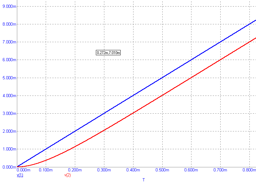

Eva,
this is not explained exactly. In time domain, the RC circuit's step response is:
Vo = Vi(1 - exp(-t/RC)),
where Vo = output voltage, Vi = input voltage (step), RC = Tau = time constant.
In case of linearly rising input voltage Vi with constant slope, Vo, after initial transition of exponential shape, starts to follow Vi, but delayed by Tau. That means, Vo equals Vi after time Tau, which we consider as time delay of the RC circuit.
Just to clarify, I am attaching the response of the RC circuit, R = 1 Ohm, C = 100 uF (Tau = 0.1 s) to linear constant slope signal. The time delay of 0.1s (Tau) can be seen.

PMA your picture is rather self explaining: The output of any RC circuit reacts inmediately to input changes but with non-constant time-dependent amplitude, as opposed to what happens when a signal is delayed, where any change in the input appears at the output after some time. Since any input change is not delayed in RC circuits, the output is just reflecting the instantaneous value of the input signal with time-dependent attenuation.
The 'time constant' concept is just used to predict this time-dependent amplitude change.
By using your criteria we could even talk of time constants (and thus delays) in voltage dividers since the output signal takes some time to reach the amplitude the input signal had.
Also, try to find time constants for the phase-shifted square wave shown in one of my previous posts, then again, it was generated witn four RC cells...
If we call 'apples' to oranges, then, how are we supposed to call apples?

OK, so we have again a problem of terminology. For Eva, only constant-time (group) delay can be called 'delay', any other time-dependent amplitude changes don't qualify for the term.
I actually thought a typical amplifier exhibits both some form of group delay, and these non-constant time dependent amplitude changes, usually AKA phase shift if they can be formalized as such.
How about this statement then:
Amplifiers exhibit both constant-time and non-constant-time dependent amplitude transfer functions. The output voltage of any instant input voltage in any case is thus subject to
Vout(t)=a*Vin(t-tconstant-tvariable)
It still appears to me that (tconstant+tvariable) > 0 , a positive time added to t, in common language a variable "delay".
In a periodic system you can get rid of the time term mathematically for the phase shift, because you will express the non constant time variable output as phase angle. Then time "disappears" in the equation, but it does not become "zero" (instant).
By the same token, say, frequency domain data give no information as to the waveform/at which time which frequency occurred. This does not mean the time at which it occurred was "instant". I'm not even sure whether the term "frequency" makes any sense for a nonperiodic instant dt. "Frequency", phase, etc, just only make sense under the assumption of periodicity. Apparently, theory predicts that you can extract at least some frerquency information out of a nonperiodic signal - it just doesn't make intuitive sense to me. That's why they are usually called "transients", not "tones" anyway.
Or do I make myself unclear again?
Your graph, Eva, btw shows the blue trace clearly appears *after* the red trace. It follows it shifted to the right, not "instantaneously" (in which case it would be superimposed).

Hi PMA !
I think Eva tried to point out that there is a big difference between
phaseshift and timedelay. If you pass a sine through a RC, it looks
like timedelayed, but when you pass a squarewave through the
same RC, you see the naked truth, phasehifts only, the transient
responds without any timedelay.
Mike
Mike
MikeB said:
Well, i didn't believe that either...
So, once i needed to know and applied the wildest phasehifts
via FFT to a musicpiece... I might be deaf, but i heard no difference.
It seems that the ear is insensitive to phaseshift of harmonics inside a
signal, but extremely sensitive to phaseshifts/delays between left/right...
Mike

... and you can calculate the transfer function from the step response 😉 . This is well known, as well as another fact:
let sinewawes of different frequencies pass through RC integrating circuit. Transition of the RC output voltage through zero line will be always shifted (delayed) of dT = RC, behind the original (input) voltage. For low frequencies, this dT will be negligible compared to 1/f (period of sine wave). As sine wave frequency increases, the dT will get closer to 1/f and we can see the time delay (which is always the same). And we can calcute phase characteristics (phase shifts) for individual frequencies from the ratio of dT to 1/f. We have phase characteristics (frequency dependent phase angle), but time delay (dT = RC) has not changed 😉
Yes, as the phaseshift is frequencydependent it acts like a timedelay,
isn't this called "groupdelay" ?
It's just that a timedelay would not change the signal itself, only
delay it, this is same for a single sinewave, but not for complex signal.
Such a real timedelay would be introduced by long wires or digital
processing, not by RC or RL.
