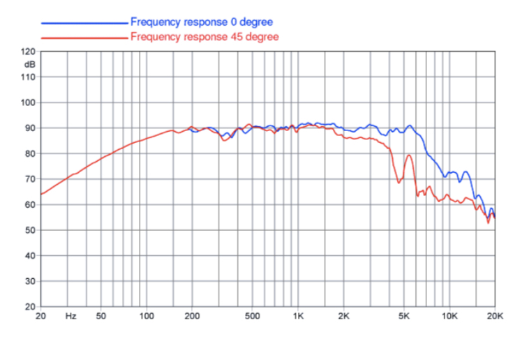

Faital 5FE120 would be a good candidate for this.....flat to 5.5k
I was going to try that driver next. Excellent looking response on factory data.
No need for FIR or DSP. I bet the 5FE120 with electrical 2nd order will combine with natural rolloff circa 5k5 to 6k to produce an overall electro acoustic 4th order BW which is perfect for combining with 2nd order tweeter for a Harsch XO.

Another driver that has been on my radar for some time and I have never used is the Peerless SDS-135F25CP02-06. Flatish to 5k but then does break up fast after that. Cheap as chips here in the UK at leas than £10 including VAT.
https://cpc.farnell.com/peerless-by-tymphany/sds-135f25cp02-06/sds-woofer-5-25-inch-6-ohm/dp/LS05113
The Peerless 830656 seems to be the same thing and that is available from PE for about 15usd i believe.
No issues with flush mounting either.
I think Michael Chua has had some success with this driver and he was massively impressed, especially given the cost

Thanks for the tip Jimk04, I have seen these before but not in light of a high crossover.
Looks promising. Butter smooth response and 99Hz in 5.7L sealed is ideal. $16ea is very nice price. A little lower sensitivity than DC130A though.
https://www.parts-express.com/pedocs/specs/264-1078--tymphany-sds-p830656-spec-sheet.pdf
