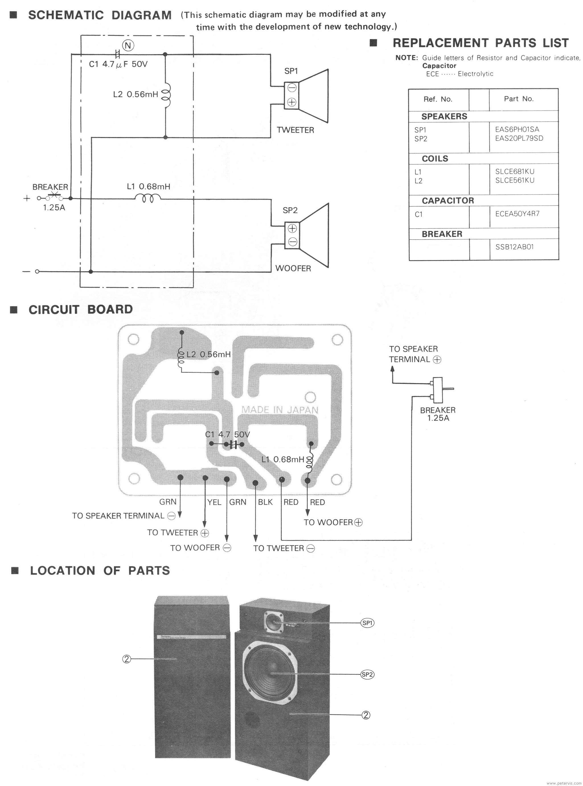

Just saw a pair of these old school things on ebay. Interesting FAST type design with stepped baffle for time alignment and separate enclosure for the 'fullrange'.
Admittedly the XO is 2500hz so a bit more '2 way' area than a true fullrange assisted jobbie.
1st order on the woofer and 2nd on the HF. Probably sound 'average' as is but would be a good project to stick some modern drivers in there!
It's just a cone tweeter. Quite common for many years, sadly only a handful made today.
Don't kid yourself about the 'modern' drivers part -some of those old Technics linear phase models were actually quite good. Crossover caps may be shot now if they aren't film types, but that's a straightforward fix so if otherwise in good shape, they'll still make decent music for somebody.

Aw, the speakers on post 122.........
With the "stepped" baffle, i thought it was a 6db, time / phase aligned loudspeaker........
Unless it is a weird 6db / 24db thing.
I see a 6 and a 12 (out of phase), and I"ve no idea what natural driver roll offs are.
I'd like to see a driver 6db down at crossover point and 12db down an octave away.
Am i wrong ?
I've got to do some digging on my understanding of crossovers........
Am i wrong ?
Look at my 10F/RS225 FAST thread. I have an 8in and 3.5in 1st order XO. The driver choice for woofer is critical - must be smooth and flat with breakups at least >2 octaves above the XO. RS225-8 in unique, very few other 8in woofers are as flat and have breakup at 7kHz (nearly 3 octaves above XO point).
