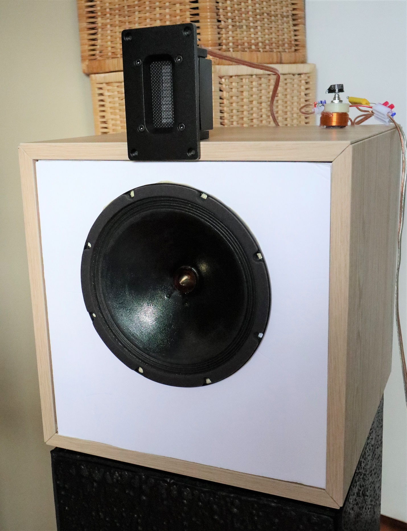

I just ran across Adason’s super Betsy WOW with a ribbon. The Betsy is 8in fullrange running fullrange with BSC and crossed to a ribbon around 8kHz. Looks like a superb result.
betsy wow and ribbon
Definitely a STAFT.
Definitely a STAFT.
Interesting crossover. What does the vertical look like with both drivers playing (polars)?

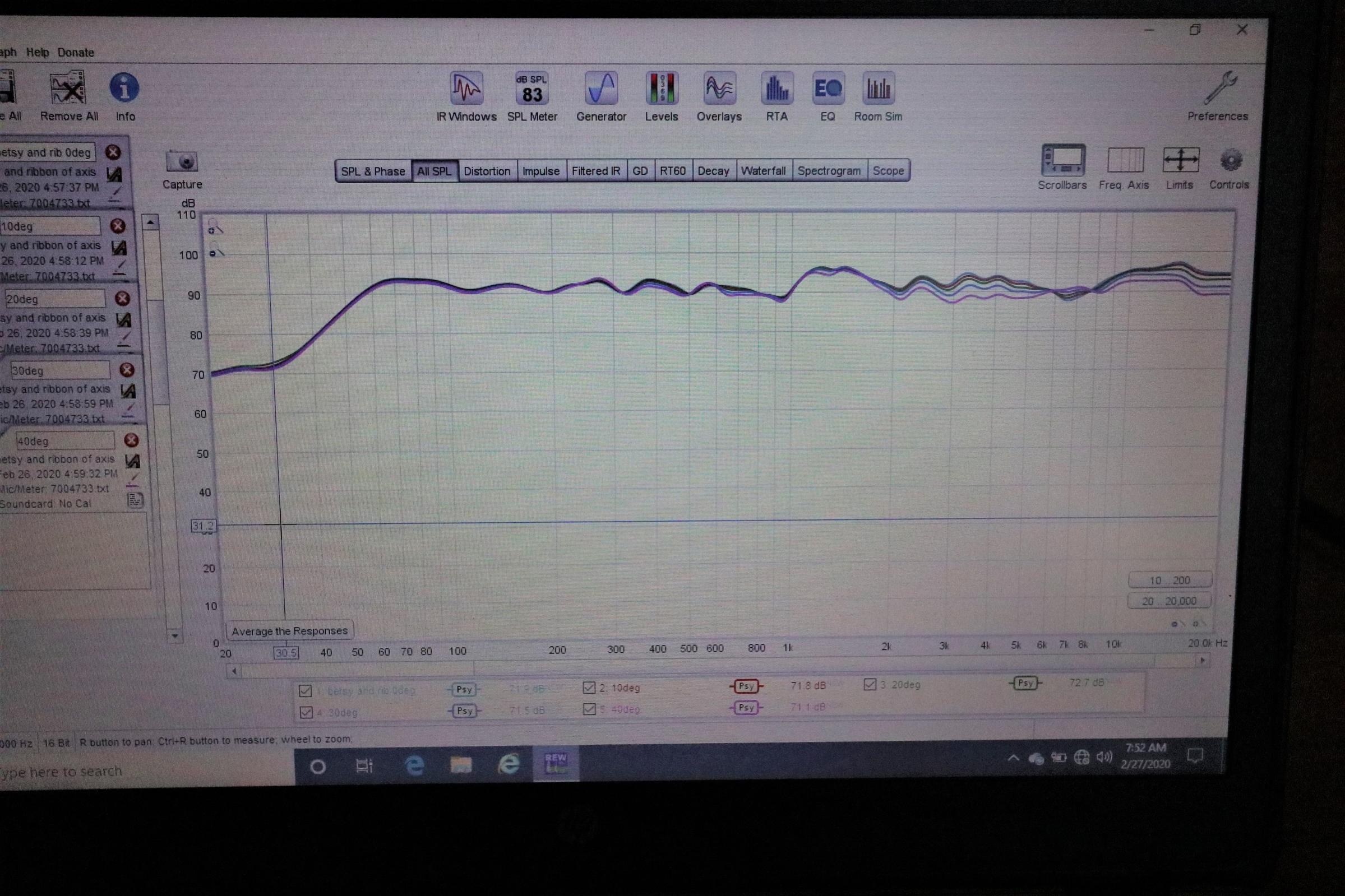

Here are the polars for the Rockville (Foamcore homage to the LS3/5A). Horizontally looks great - almost no beaming if you are in +/-30deg zone. For vertical, make sure you are -5deg to +15deg of the tweeter axis or the response has deep nulls. Many non point source speakers have this issue with regards to vertical polars. More info here:
https://www.diyaudio.com/forums/mul...0a-foamcore-homage-ls3-5a-13.html#post6371457
Horizontal polars at 0.5m and 2.0Vrms:
Vertical polars at 0.5m and 2.0Vrms, -ve means below tweeter axis and +ve means above tweeter axis:
