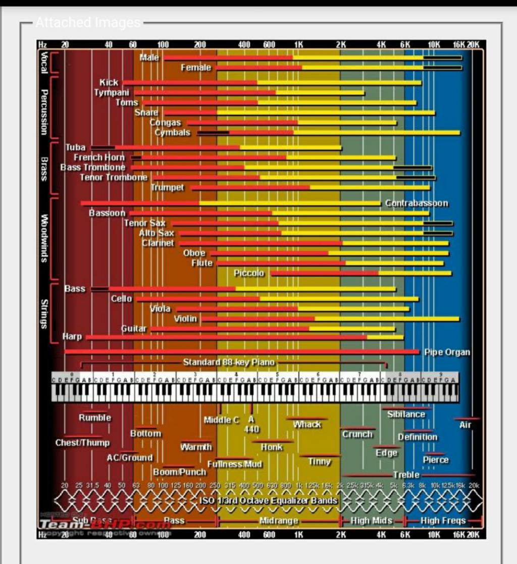

I thought I chime in on this. This is a graph many of us would have come across at one time or another. I mentioned it to X in the original thread on musical instruments, but didn't provide any information. For sale of completion, I thought I add in this chart.
As you can see many instruments end by 5-7K. And a different set of instruments might take over from there.
So the issue of instruments crossover is a lot less of an issue than at 2kHz.

As you can see many instruments end by 5-7K. And a different set of instruments might take over from there. View attachment 880537
whilst the fundamental produced by an instrument may not reach that high, the harmonics will extend by several octaves and it is the harmonic structure (magnitude and relative phase) that gives each instrument it’s characteristic sound. I imagine preserving the harmonic structure through a XO transition going to be a challenge ?
Hence the need for a decent relatively flat phase crossover like a Harsch or 1st order. I am using a Harsch XO variant so that the phase is not wrapped like many traditional 2-way speakers that use a 2nd or 4th order LR crossover.

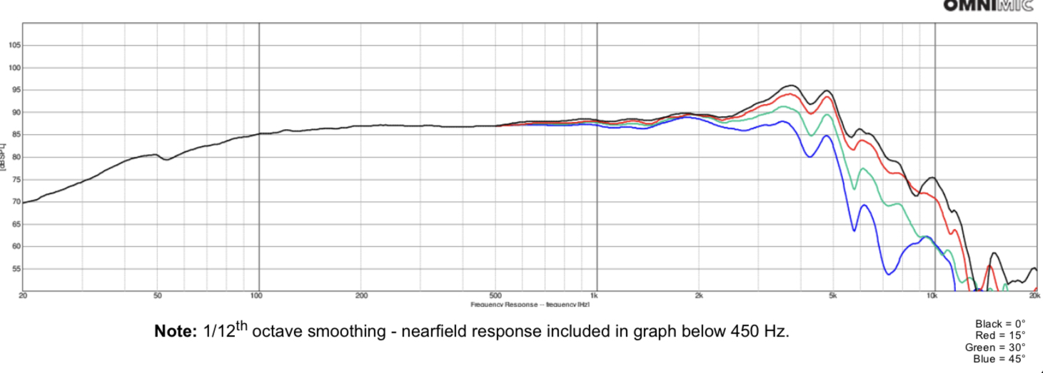

We can look at the factory measured polars for the DC130A and see that angle dependency is about around the >5kHz range. Depending on how the tweeter integrates with this region through the crossover, will determine how smooth it is off-axis. I suspect that it might not be as bad as people fear. I certainly don’t hear anything objectionable when I move around a bit - the field seems quite uniform vs frequency. Better than most 5in full range drivers that’s for sure because the highs emanate from a 1in diameter dome.
I went to look into the graph I put up to see what is really inside. Went to Google it and find out more as it turns out the yellow part of the bar already is the harmonics and the orange is the fundamentals. So even the harmonics will typically end by that frequency...
